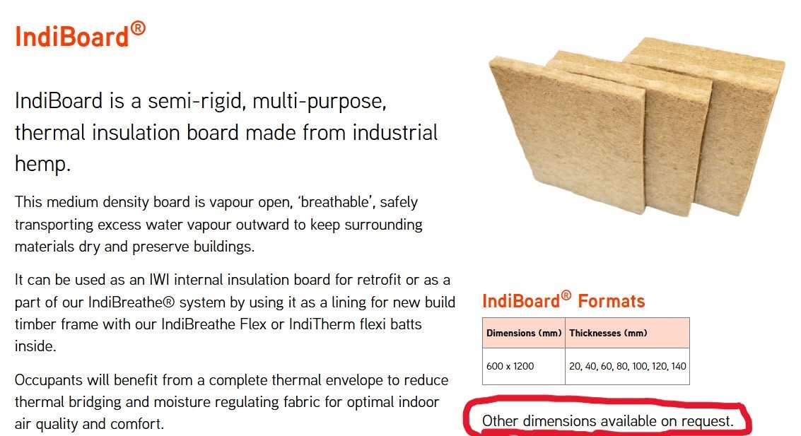

Yeah, reporting back, I can see just one 50mm offering:
Savolit Plus - Wood Wool Boards  https://bio-space.co.uk/products/savolit-plus

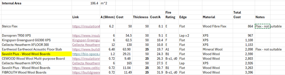

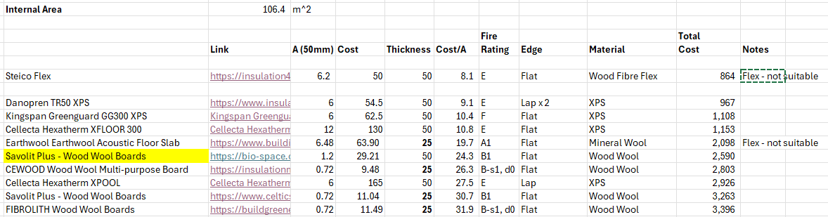

This is my list for anyone going down the same path:
We could use much cheaper XPS, but it's flammable as f..k.
