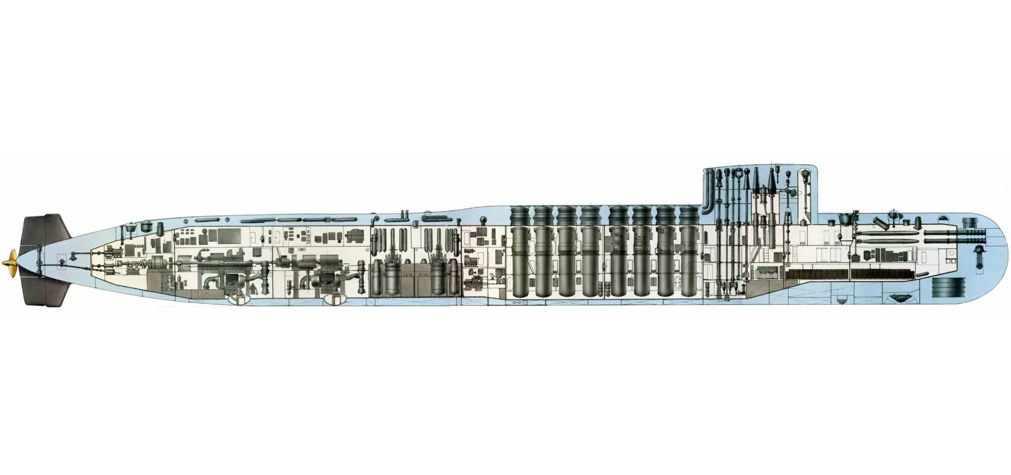

Subs are hard because they are very very tight on space. AFAIK the sub reactors aren't actually that much bigger than a container. That's why they need to use highly enriched uranium to get them small enough. But they are very much part of the structure of the boat (especially the shielding).
On a big container ship you have a lot more space. IIRC the idea is you could design a ship so that the traditional smoke stack area through to the bilge is a fairly open area to allow a big module to be craned in and out. Much bigger than a container and obviously needs to be done at special facilities (but you wouldn't work on nuclear stuff outside a specialist facility anyway) but very doable. Craning in 100-200 tons is very feasible if you plan for it in advance.

The French submarine reactor, which is a sub 20% enrichment design, is about 3m diameter and 5m height.  So comparable to a large abnormal load like a big transformer or a wind turbine nacelle. It could be road transported (albeit with some restrictions)
Obviously the safety margins for military vessels are somewhat different to civilian use.
But if the "reactor factory" near a deep water shipyard the ships could come in, have the reactor craned out ,new one dropped in and be on their way. This is essentially what happens to nuclear subs except it:a all  about more fraught with the whole 'cutting open the pressure hull' thing.
All that said, i'm far from convinced that nuclear powered shipping is going to be a thing.
