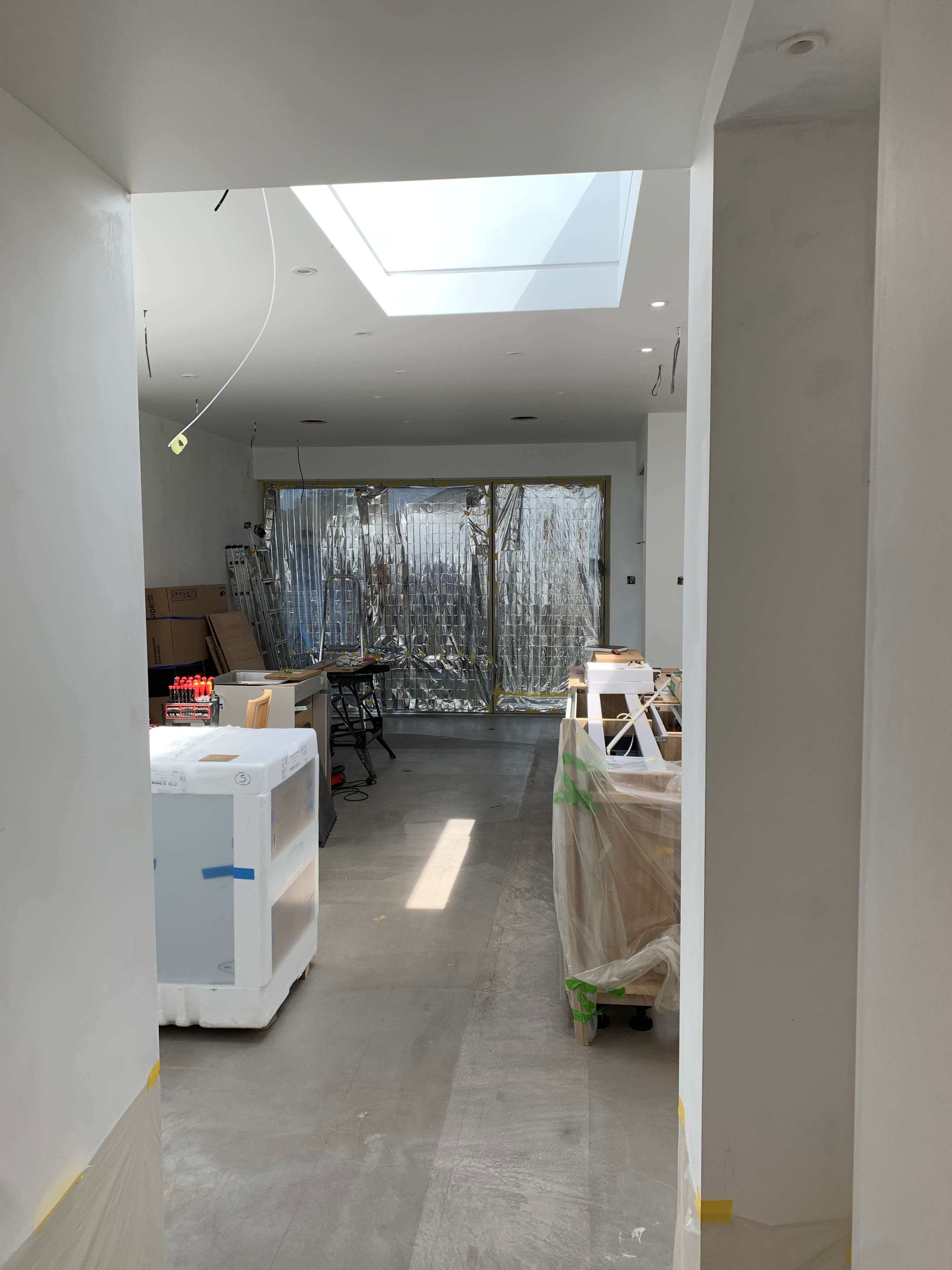

Spinny Posted July 3 Posted July 3 Need to temporarily stop the solar gain throught my bifolds to keep the temperature of the floor down while LVT is laid. Looking at window film ? Wouldn't it best to put this on the outside though ? Silver side outwards ?
marmic Posted July 3 Posted July 3 anything to reflect will probably help and yes outside - but better to stop sun hitting glass at all. Brise soleil can take many forms. if only temporary a cheap gazebo outside maybe? but may be worth looking at something more permanent if solar gain in these heatwaves is an issue.
mistake_not Posted July 3 Posted July 3 An option (not saying it's good) is silver foil. Mist spray the glass with water from a sprayer and it will stick perfectly. Just make sure you don't scratch anything.

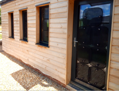

marmic Posted July 4 Posted July 4 just put some cheap car sun shades on windows (from halfords - cheaper than amazon etc!) - temporary measure until we decide how to build brise soleil. not going to block it completely but should make some difference. if they stay up! 1

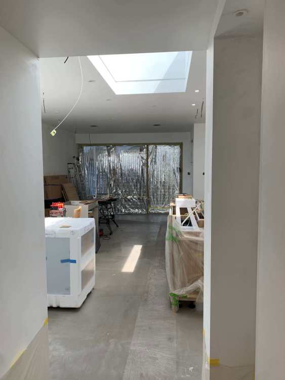

Spinny Posted July 6 Author Posted July 6 On 04/07/2026 at 13:31, Nickfromwales said: Have the installers asked you to do this? Yes Have a laugh at the pic. NASA operation sun screen - see pic - £10 off Amazon but too flimsy to tape to the outside in the breeze. Not sure it was doing that much but today was cooler. A bit like that foil they wrap round people with hypothermia.
Spinny Posted July 6 Author Posted July 6 Chat GPT... (Gonna be above that every afternoon from Wed through to the middle of next week. FFS. How long does it take to lay a floor ? About 6 months. 2 Weeks work and 5.5 months playing the hokey cokey.) Quote For Amtico Signature, Spacia, Form, First and Safety ranges, the installation guidelines state: Ambient room temperature: 18°C to 27°C. The flooring, adhesive and subfloor must all be stabilised within this range for at least 24 hours before installation, throughout installation, and for at least 24 hours afterwards. If the materials have been stored outside this range, Amtico recommends extending acclimatisation to 48 hours. So if the room temperature is above 27°C, it is outside Amtico's specified installation conditions. In practice, installers should cool the space (using air conditioning or ventilation) and wait until the temperature is back within the 18–27°C range before laying the floor. If your question relates to underfloor heating, that's a separate limit: The subfloor surface temperature (at the adhesive interface) must never exceed 27°C. The heating should be switched off 48 hours before installation and remain off for 48 hours after installation.

fatgus Posted August 7 Posted August 7 In case we get another heatwave, I can wholeheartedly recommend foil emergency blankets. Put them on three sets of east-facing patio doors and the difference is amazing. Even better, you can see through it (to a degree). Less than a quid each too 👍👍 1
