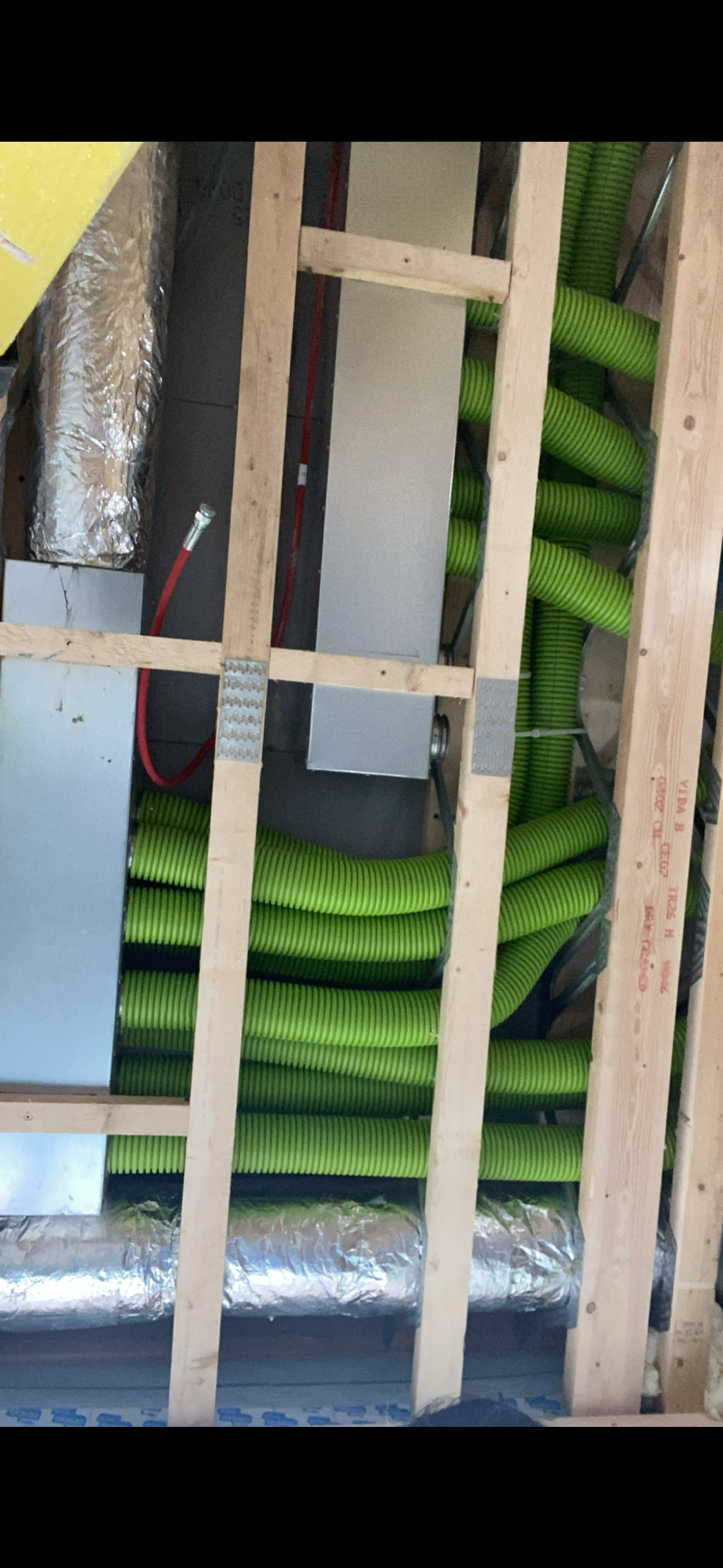

If you go for the semi rigid radial ducting as recommended by @Nickfromwales, in a timber frame with metal web joists, what do you need to do regarding planning the duct runs. Assuming you're going to buy the kit and organise the installation yourself. Can you get duct layouts done? Who does that?
Thanks
Posted
Thanks

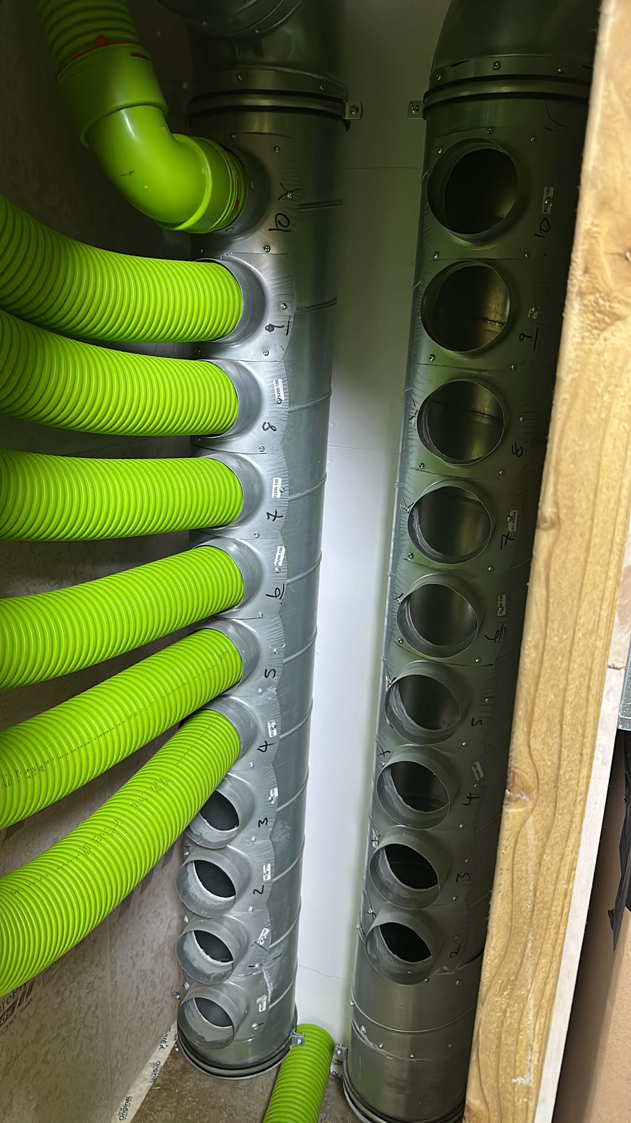

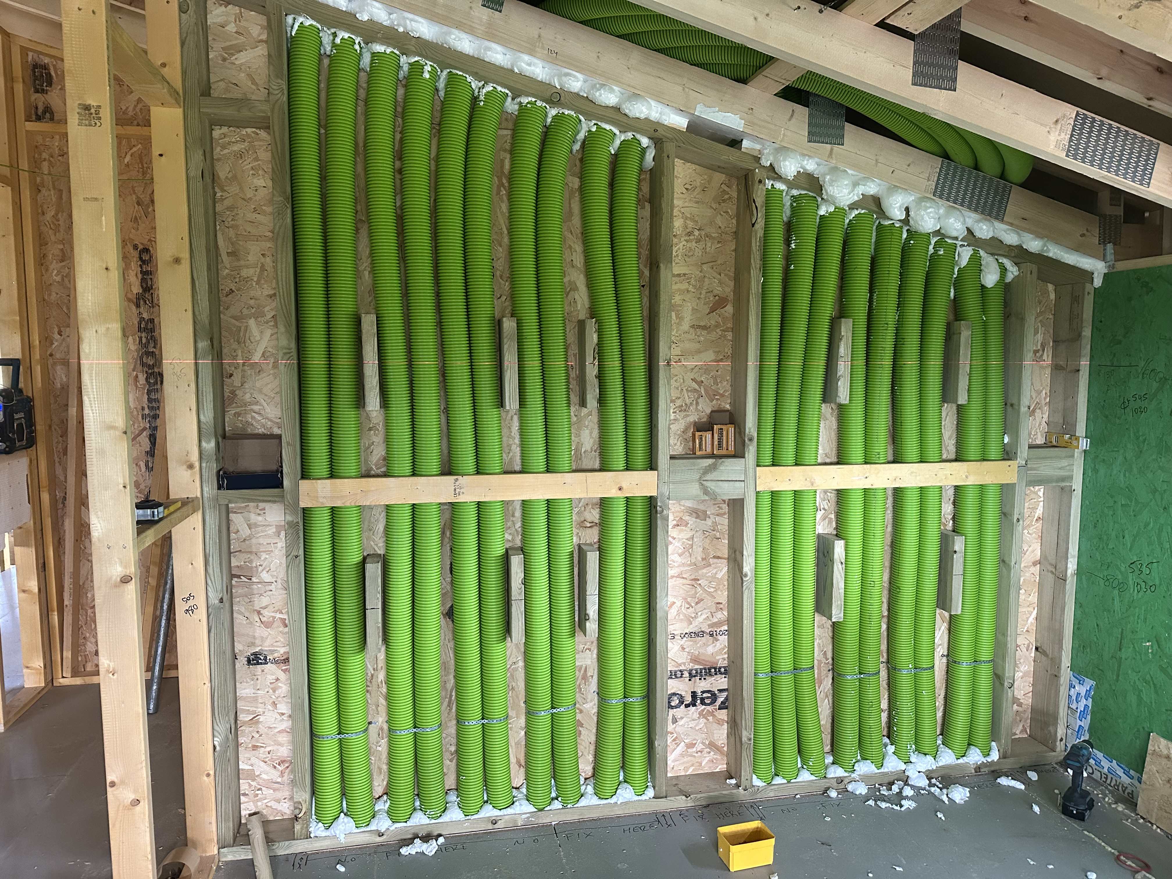

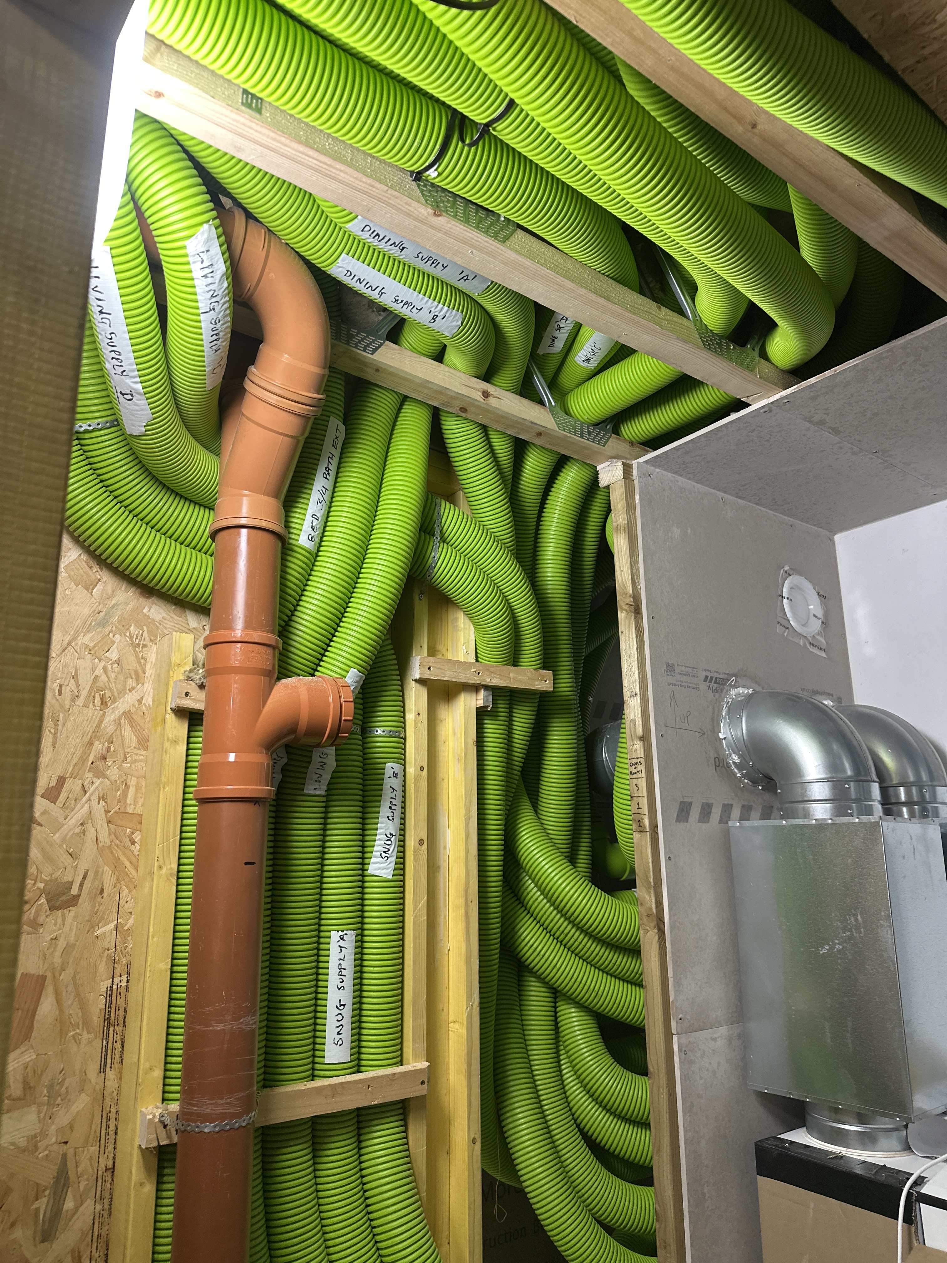

Current plant room design:
image.png.2650bc7b67fab7f6491ef431349ef010.pngimage.thumb.png.51229ba43cbc9f58a16f7140e4e2e6ed.png
Designs via CVC Systems, Oxon, supported and then installed by some good looking welsh fella:
Ground floor
First floor

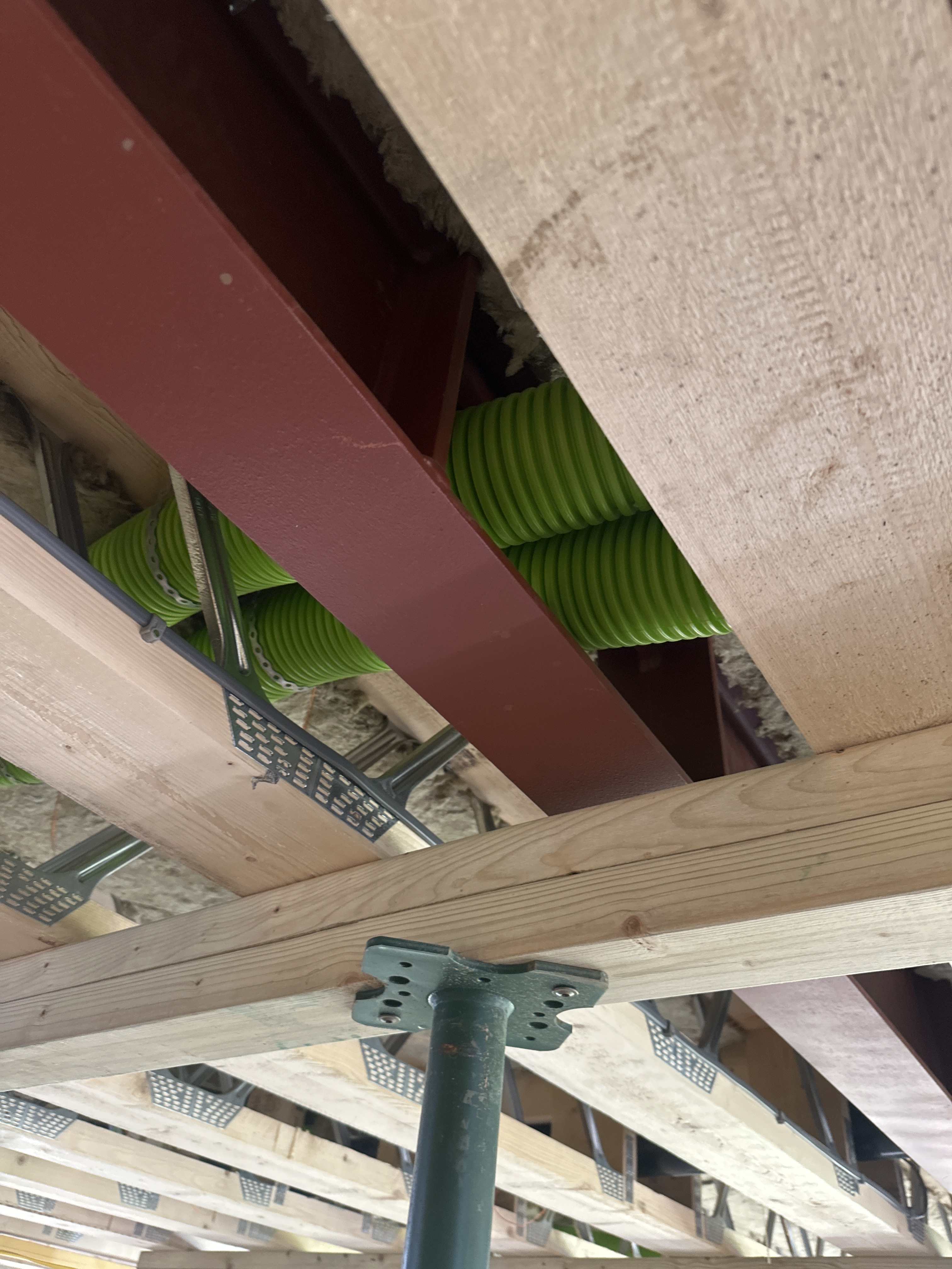

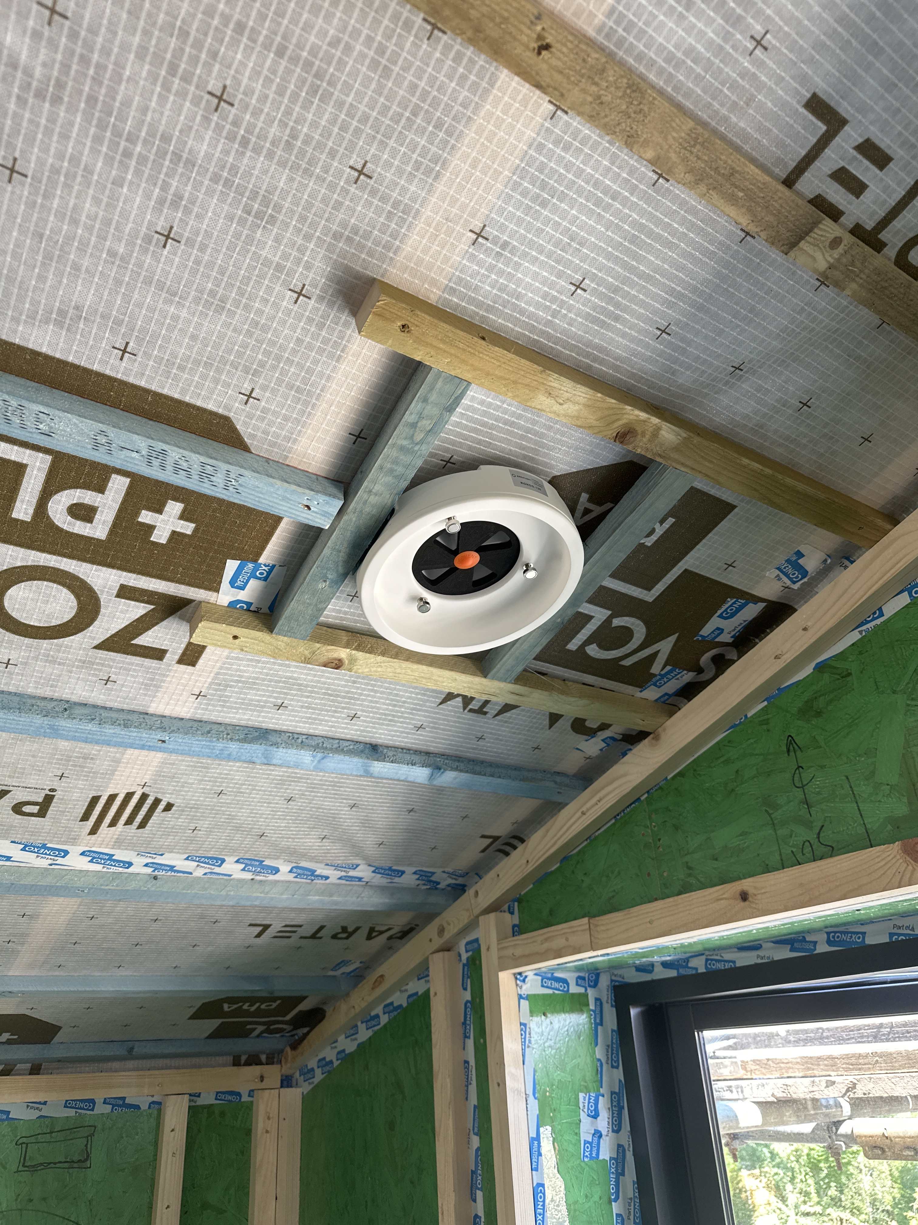

7” wide service riser for 18x 92mm ducts for FF into posijoists.
Then plaster-in ceiling outlets through, bar a few cheaper ones for where they don’t need the extra time/money.
Basics of layout at the design stage gives me the number of ducts / outlets and then I just crack on basically, adapting to suit reality. Steels were designed in by me, many months before concrete went down, which makes life easier with penetrations where they’re needed; all considered to delete any boxing in or loss of GIA whatsoever.
Tres bien 👌

Posted
@Nickfromwales
So your distribution boxes are hidden behind walls if I understand the diagram and the photos.
Ours ended up being above the (lowered) plant room ceiling (daft fire concerns as there's no gas)   But....     If you do need to clean each inlet and outlet connection through the semi rigid pipes, how do you do this?   Or is it not considered necessary?
Posted
4 hours ago, LnP said:
No doubt you're Welsh and the jury's out on the good looks 😉.... but I imagine you need to be an olympic wrestler to manipulate all that ducting into place. I recall your preference for radial systems but don't recall the reason. Might a branched system have been easier to accommodate in the building structure and to install? Or is it down to performance? Grateful for a reminder why you prefer radial systems.
Thanks

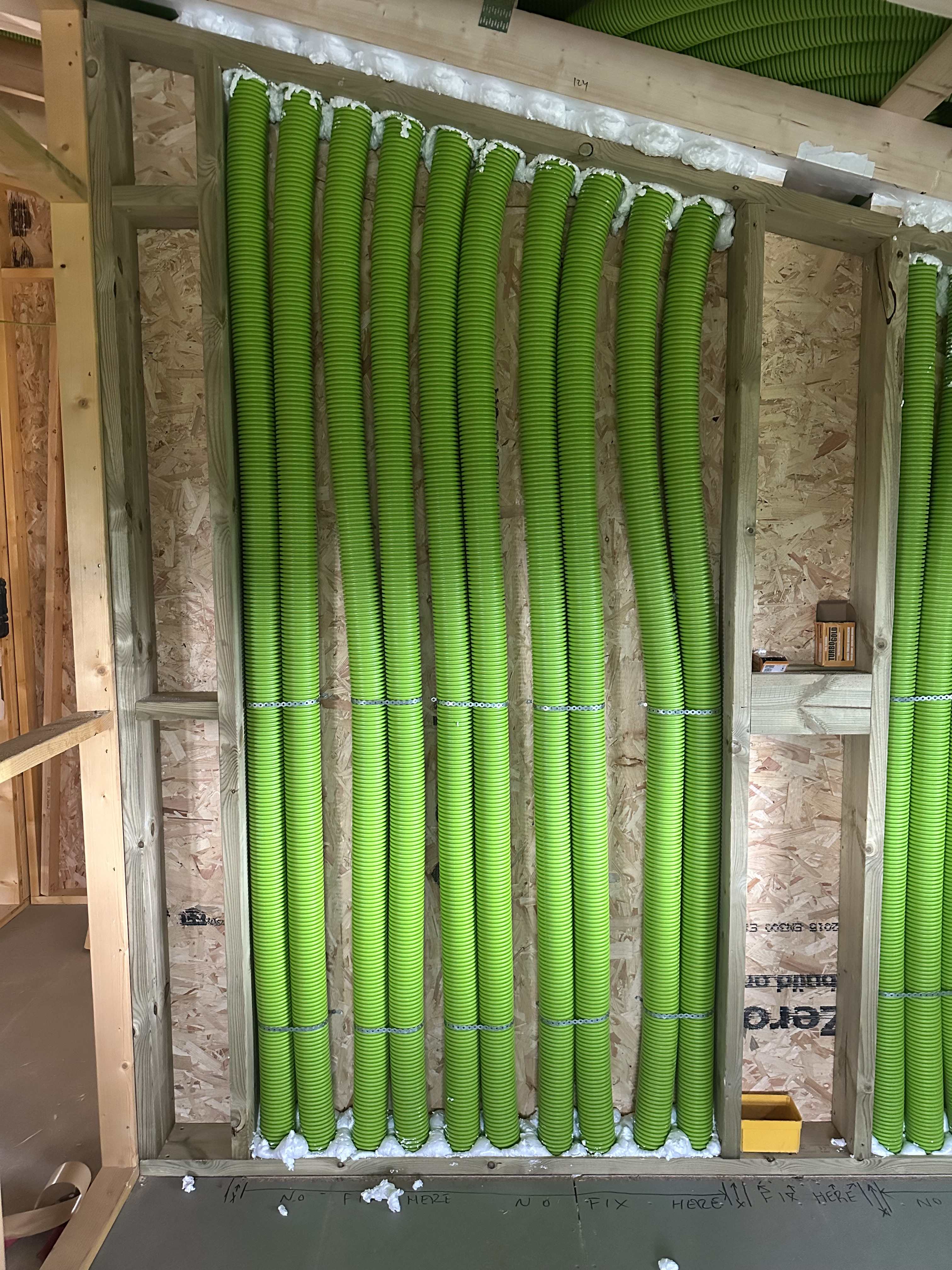

There’s no way in hell I’d have got 200mm > 160mm > 100mm spiral metal ductwork in here, plus all the soil and waste pipes, just zero chance.
I prefer the radial as I can fit the stuff in pretty much with zero impact on the layouts, and zero cross talk etc. Seems to run a lot quieter too; this one is a whopper of a system but is absolutely completely inaudible in the rooms on 25% fan power (not commissioned yet, but I expect we can run closer to 20% on trickle).
Pulling these flexible (enough) ducts in, one by one, needs thought but is relatively easy for 2 people. Don’t dream of doing this on your own as that’s just too much hard work. It looks ‘lots’ because it is! 40 ducts in total.
  • Thanks 1

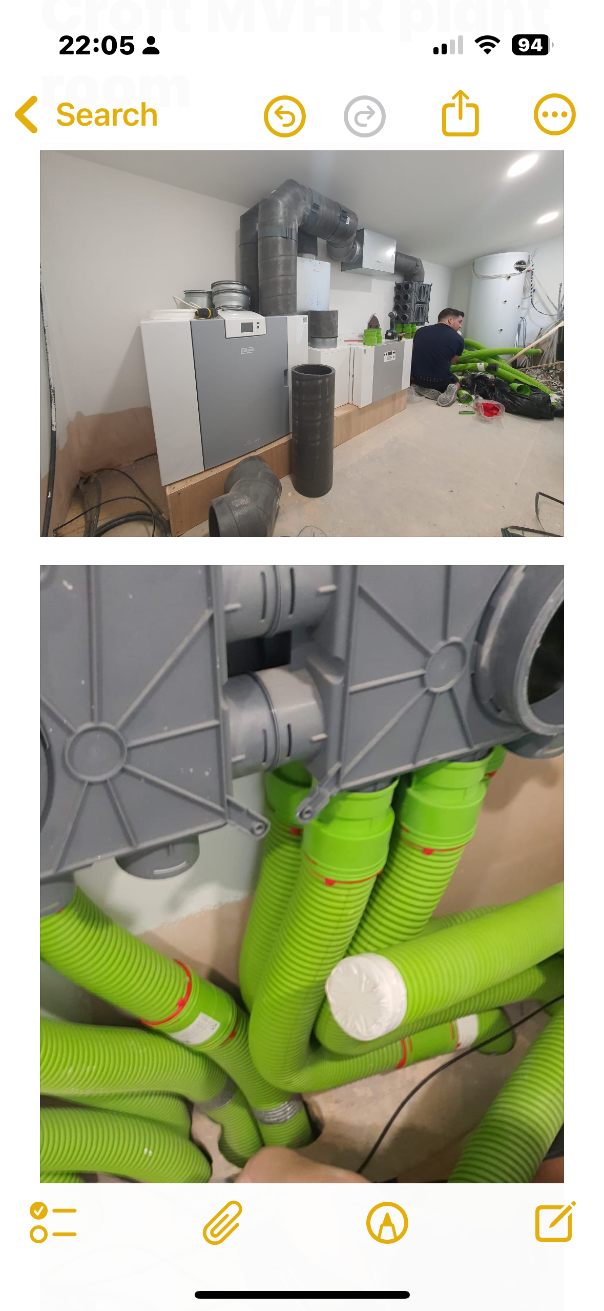

Posted
5 hours ago, Bramco said:
@Nickfromwales

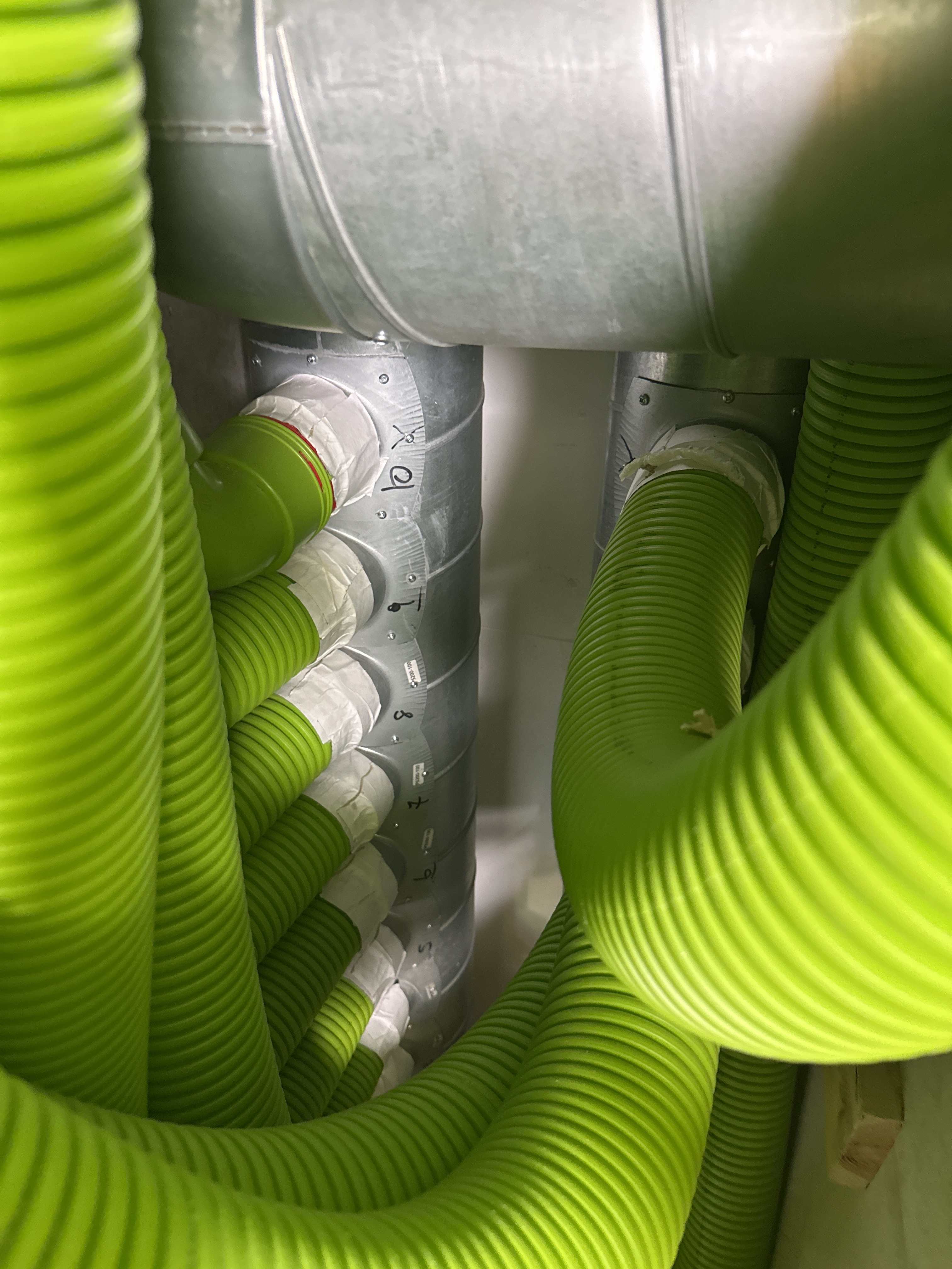

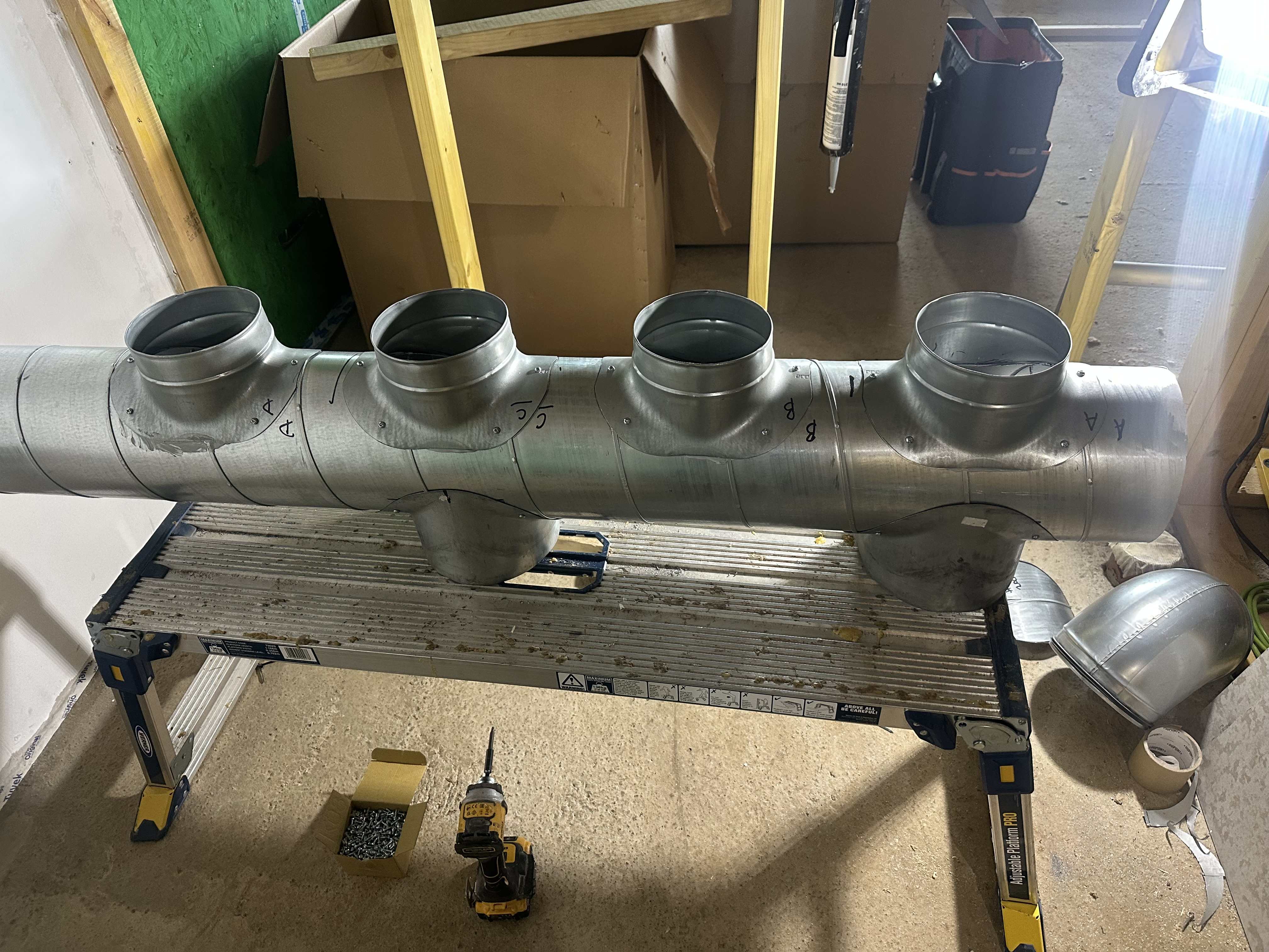

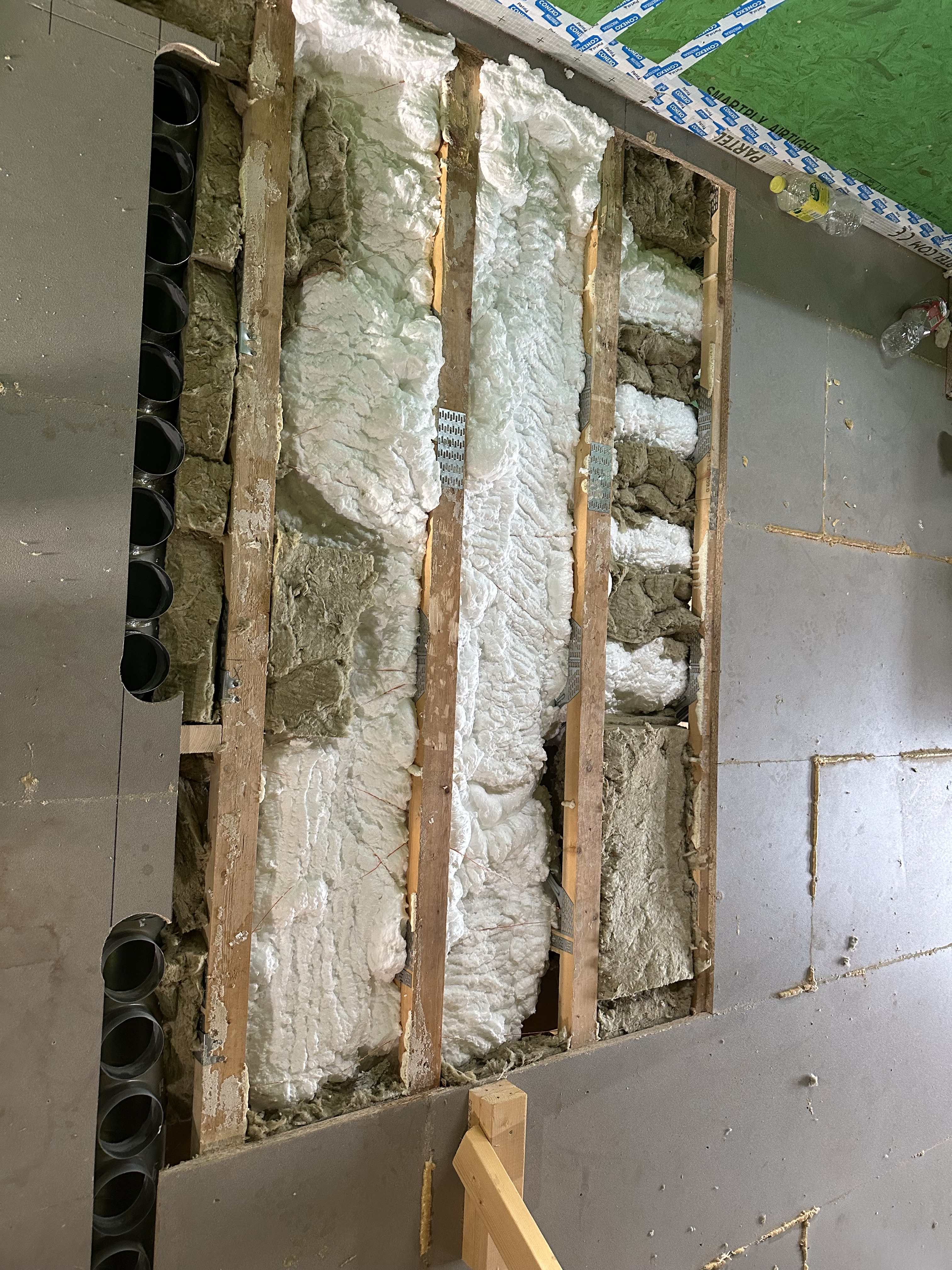

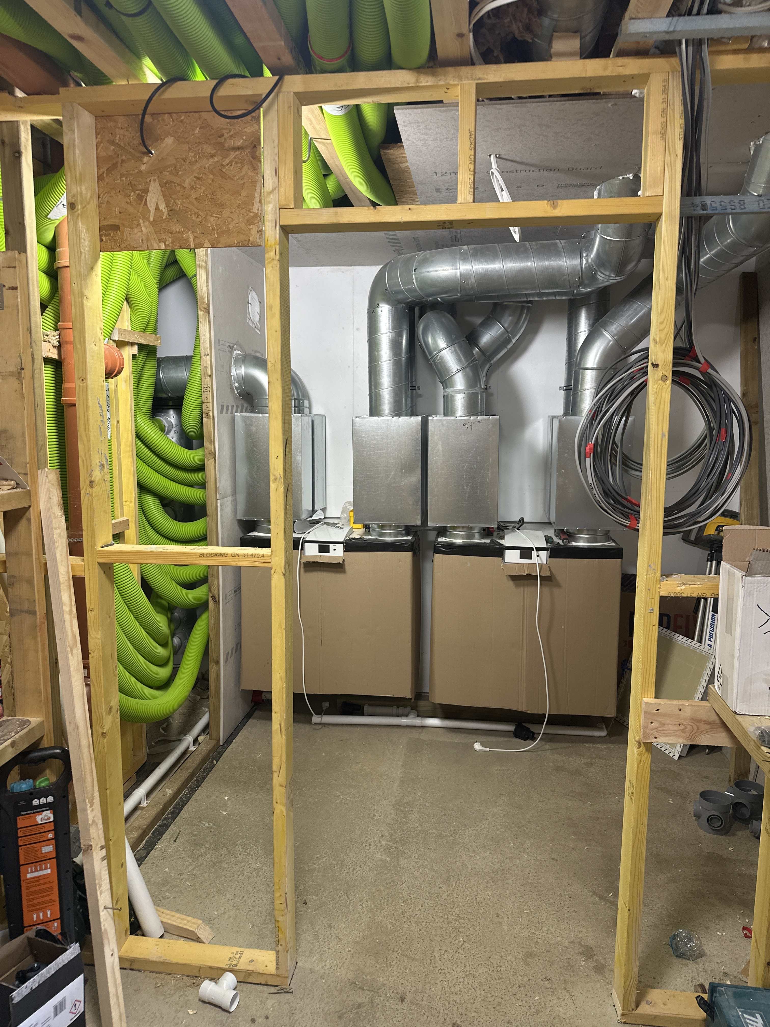

Made them all myself on site. 4x 160’s over the office to outdoors (vs out next to the front door, yuk!) to 2x 200 (1 per unit), probably lost 2 pints of blood with all the sharp edges…..all part of the ‘fun’. :/
Doubled up on the black rubber o ring seals and then 2 full turns of AT tape for good measure.

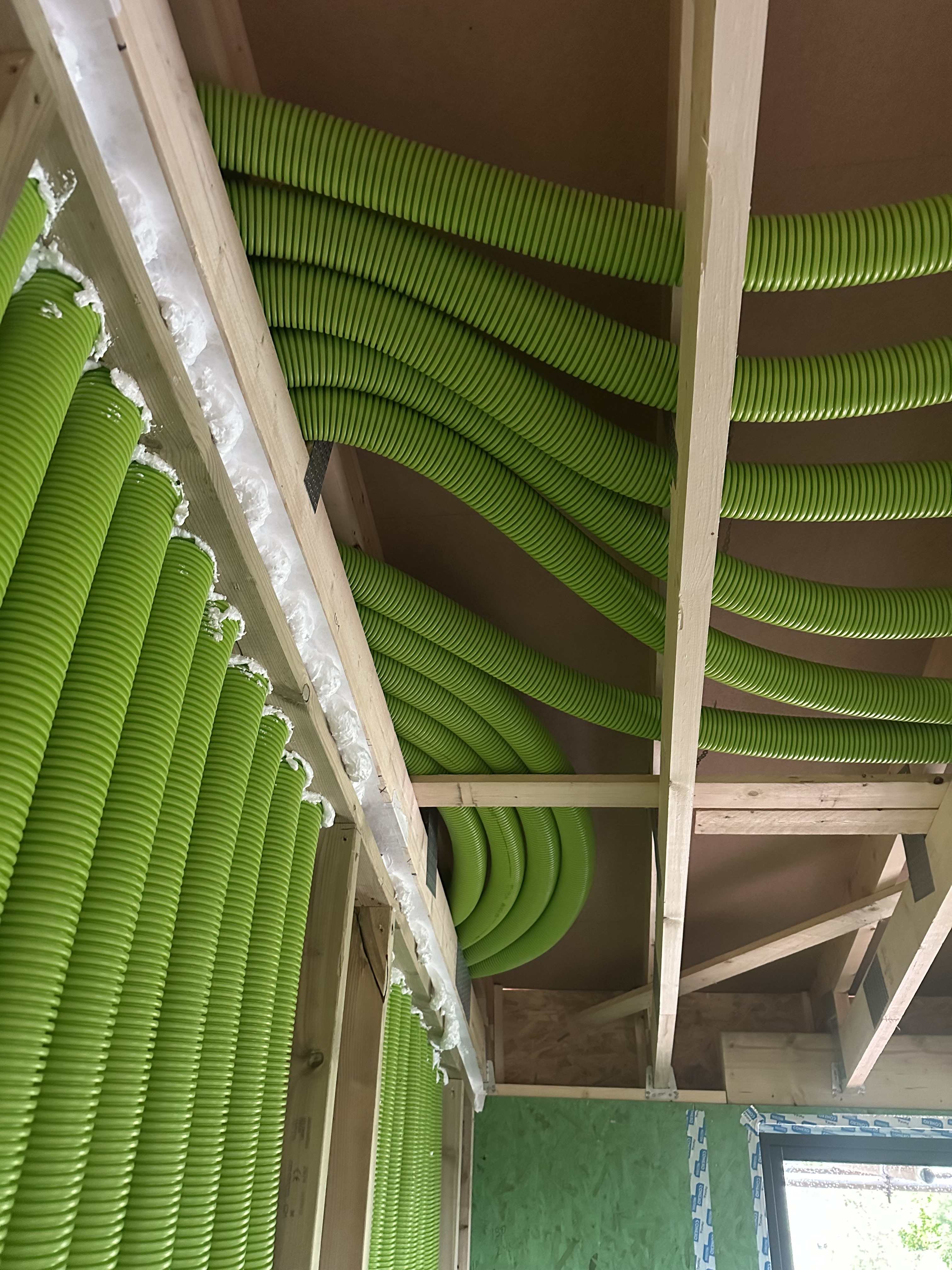

And in the plant room posi joist voids I made 2 more 200> (x)qty 100mm ‘manifolds’ which were facing upwards, for supply and extract on the 1st floor.
Where it was near impossible to apply the foil insulation to the fresh intake I just used cans, lots of cans, of expanding foam aka Kingspan in a can.
Mummified it as you can see, to deal with 0°C incoming air temps / condensation control.
Air-tightened with FM330 and green smartply, so MBC could tape to my bits without losing any integrity (scored 0.35ACH on the test last week :)).
Zero need to get into these ever again, as the distribution systems are all zero maintenance.

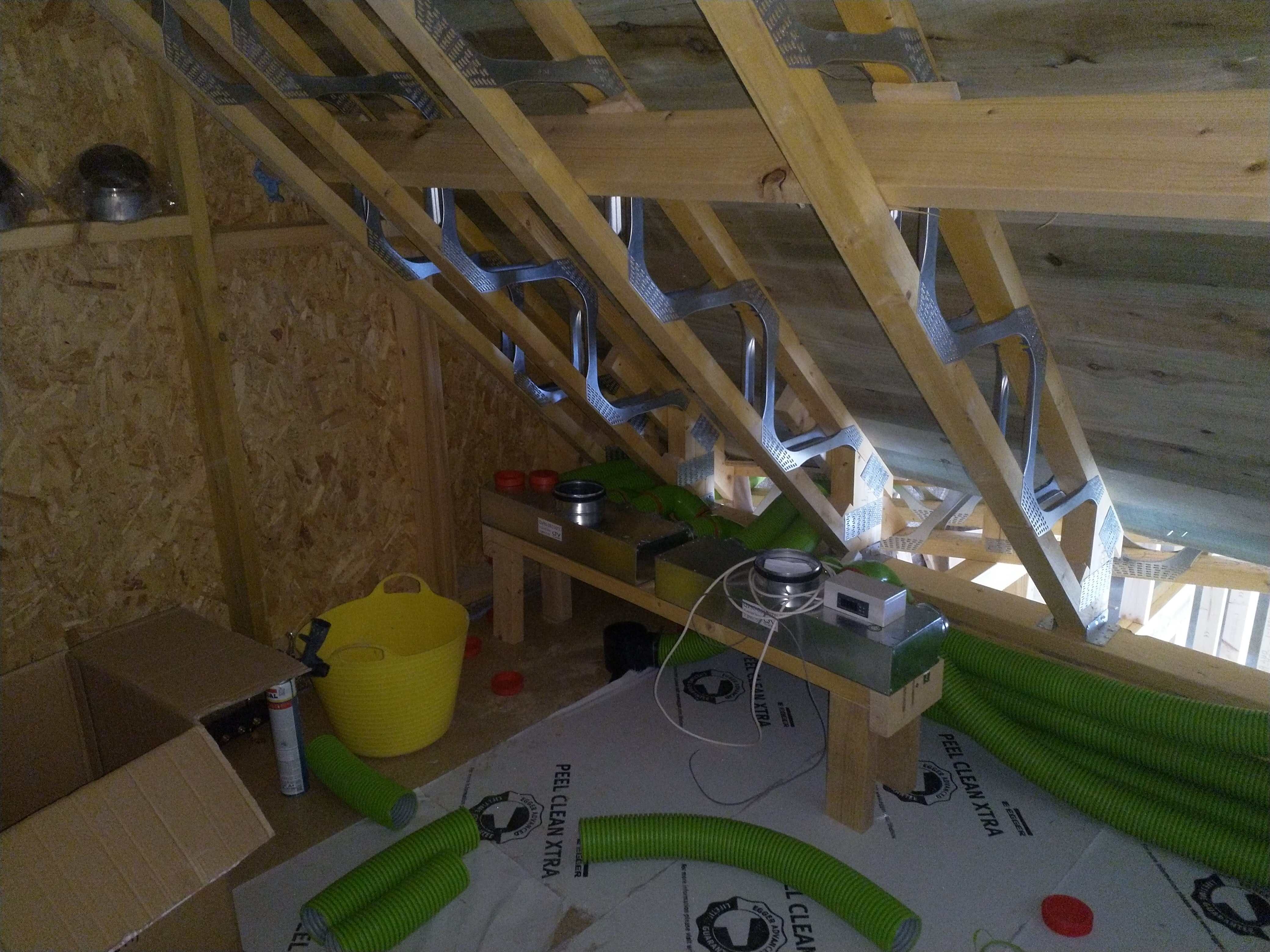

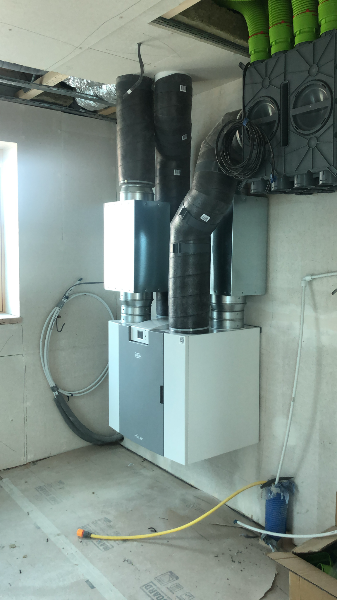

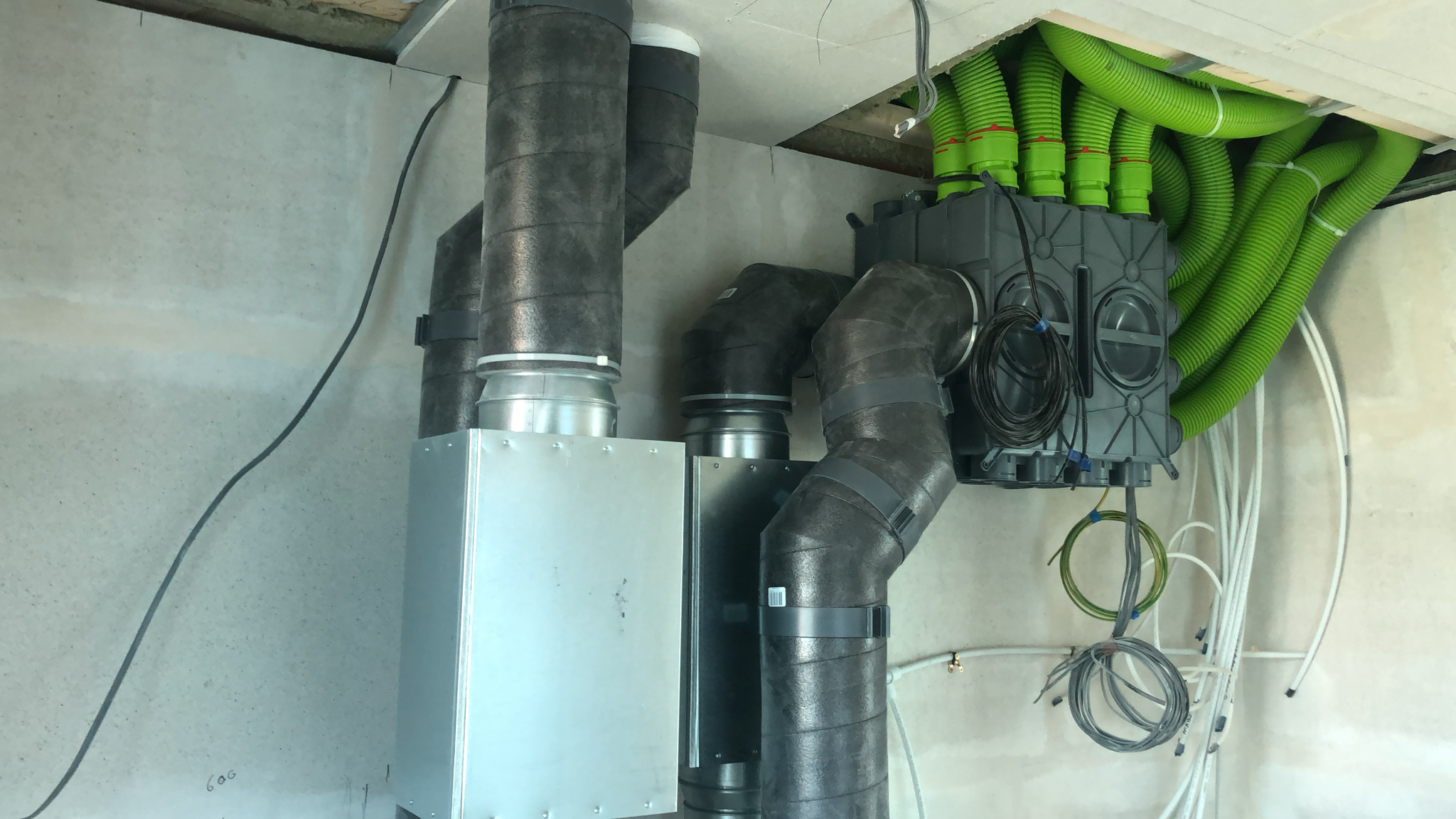

Or a more modest normal install. I have a 5 flow and returns on one unit and 2x on the other. IMG_20210210_104816.thumb.jpg.96ca032dcd1379d8a47d3cd715161905.jpg
Posted
I have 9 supply and 6 extract of 90mm Ubbink, which is what those pictured above seem to be. My MVHR unit is in the loft.
To get from the loft to the ground floor ceiling i had a double stud wall designed into the Potton kit with a 100mm gap. This allowed me to hide the vertical drops neatly. Potton said ' oh thats a good idea'.
Manipulating the ducts 90 degrees to get them into the Posi joists at the ground floor ceiling was the hardest bit. And remembering to lay them in the correct order such that they weren't needing to cross each other as they distributed away to the ground floor rooms. The trick is ,you need to try to get the twists out as you go because its a total bastard to think ' i'll sort that once its in'. Ask me how i know.
Only other real issue was trying to remember and calculate what end pieces and joins you might need to clip it all together. Waiting for the little bits that you forgot to order is painful.
I have to say the Ubbink ducting is brilliant. If you ever played with Lego as a kid you will appreciate the way it just works and clicks together 'just so'.
  • Like 2
Posted
Where it was near impossible to apply the foil insulation to the fresh intact I just used cans, lots of cans, of expanding foam aka Kingspan in a can.

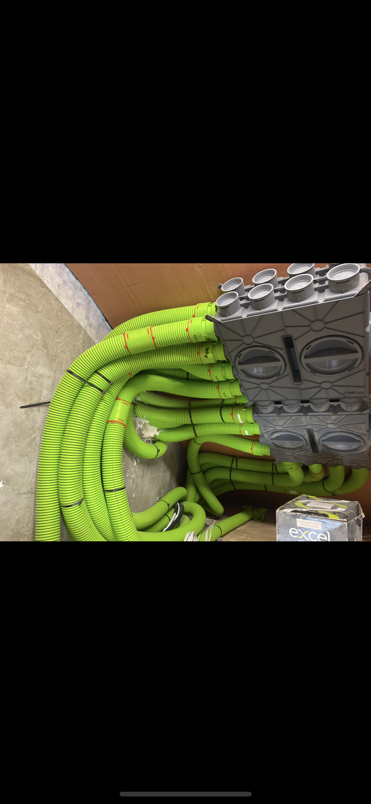

Congratulations on your metal bashing skills. Is it a normal part of an install to have to fabricate distribution boxes? What is it about the off the shelf ones which makes them not suitable, like these Ubbink ones?
Posted

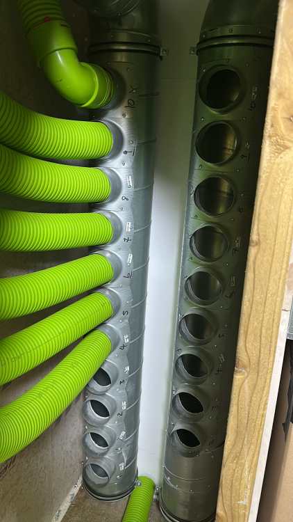

Nothing whatsoever wrong, if they fit in the space you have.
We had to preserve space here for the mist system box-o-tricks, 19” rack for LAN, 3ph CU, (and more), in that one plant room, ergo I had to get inventive and make space.
The original design had the 24 port Ubbink manifold boxes specified, but it meant encroaching into the adjacent coats / boots room which wasn’t going to fly.
Happy to use them where you can though!

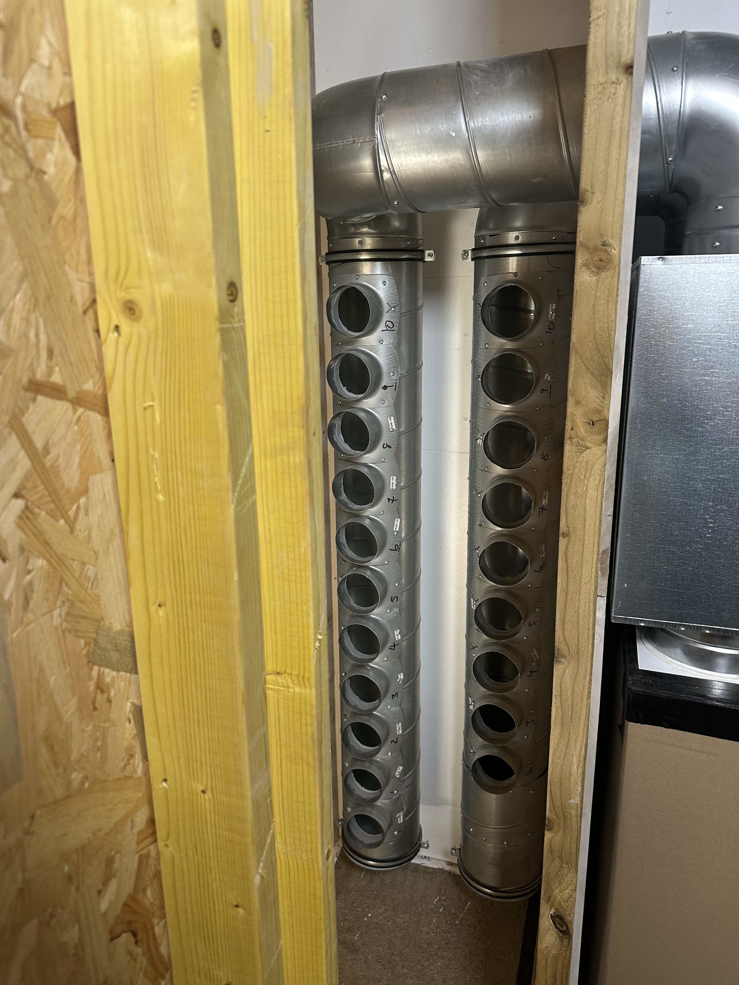

And you can get bespoke box manifolds made up to fit in the posi joists too:
I offer up the bare boxes, mark the metal webs onto the side of the box with a sharpie, then drill and fit the top hats to take the 92mm ducting. IMO there’s a lot of real estate up there so why not utilise it vs lose GIA / have to make boxing in etc?
  • Thanks 1

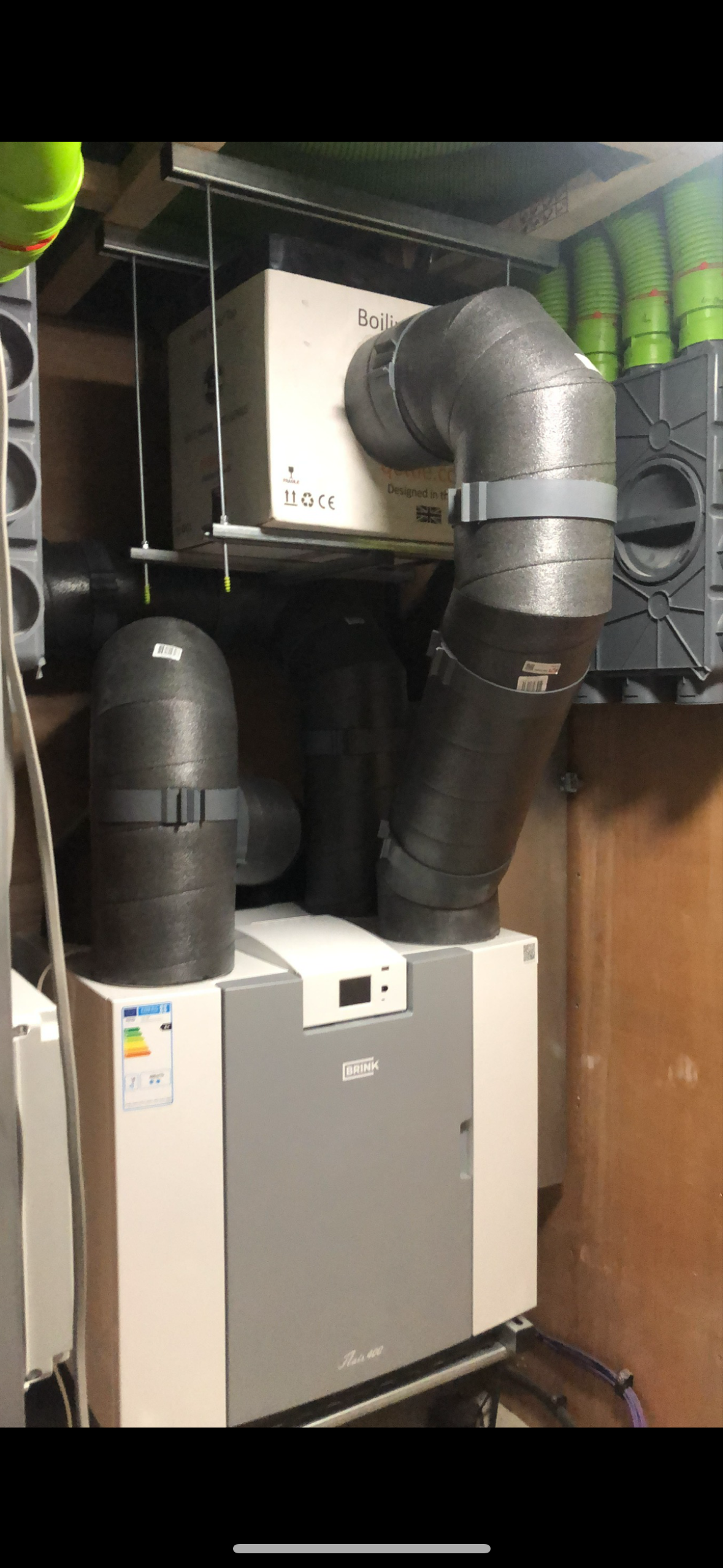

As already stated, nothing. I have the 16 port versions of the Ubbink distribution units. But i was also advised, on here, to install the large rectangular inline 'one in one out' silencers as well.
