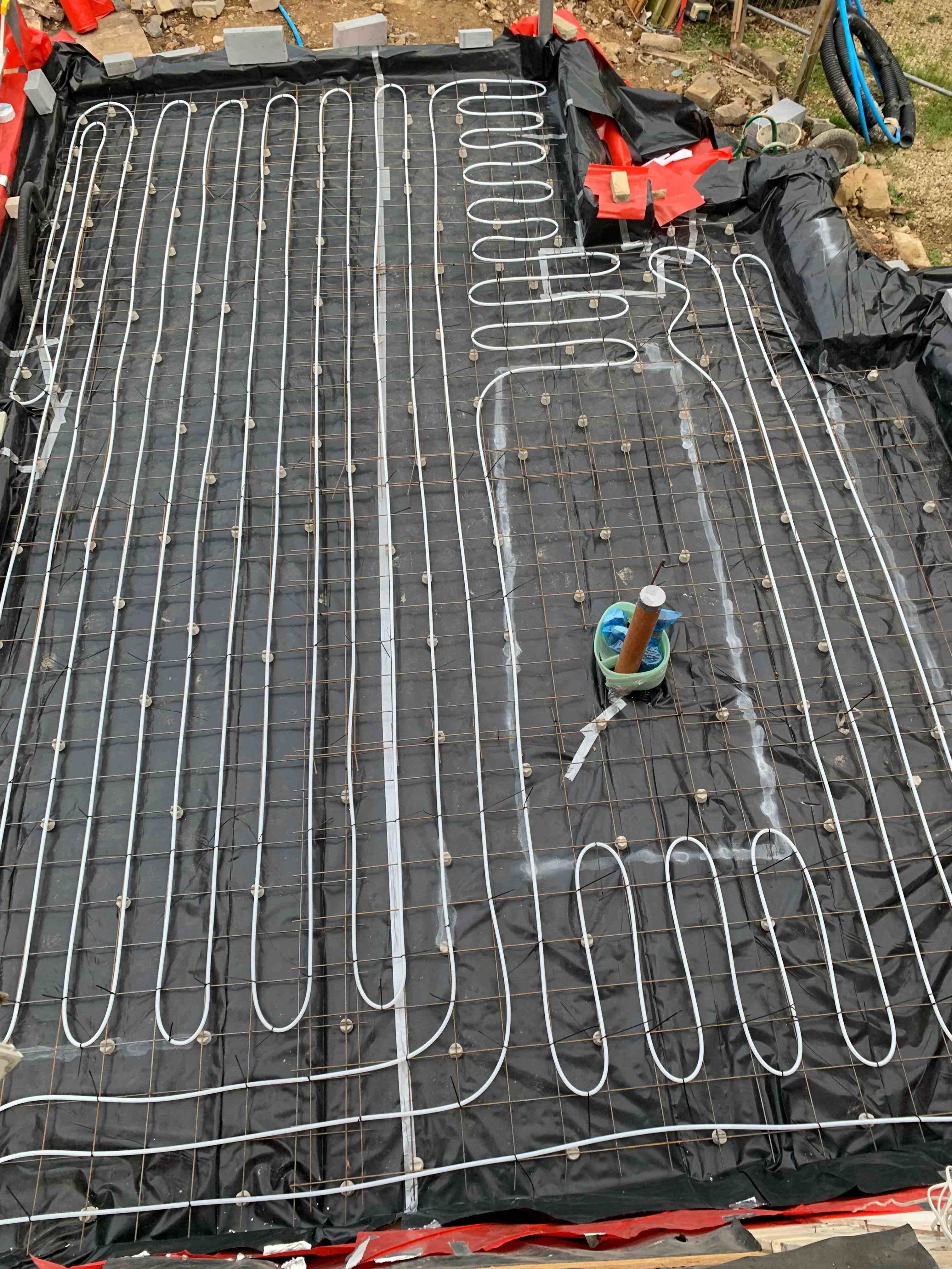

I know @Oz07 has used it before, but has anyone used it with UFH attached to the rebar mesh and then simply tiled or used engineered flooring directly on top of the SCC

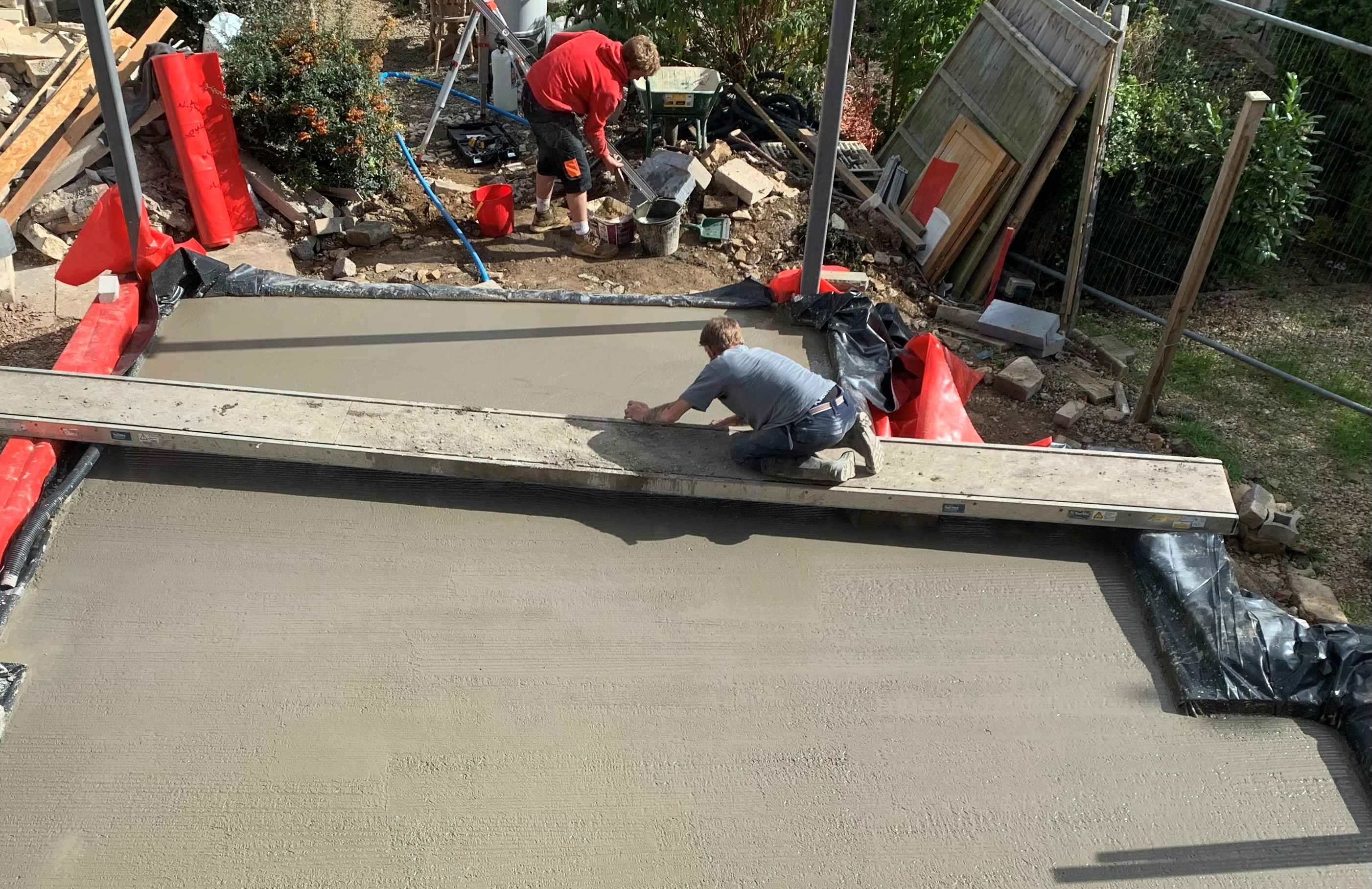

For our extension we have the heating pipes in the concrete slab. So the makeup is hardcore with sand blinding layer over, DPM (in our case also a radon barrier), 150mm PIR, Vapour Barrier, about 120mm readymix poured (pumped) concrete slab with reinforcing mesh and heating pipes attached to mesh.
This was the preferred method of our architect who advised this was more efficient for heating given the higher thermal mass of the concrete slab.

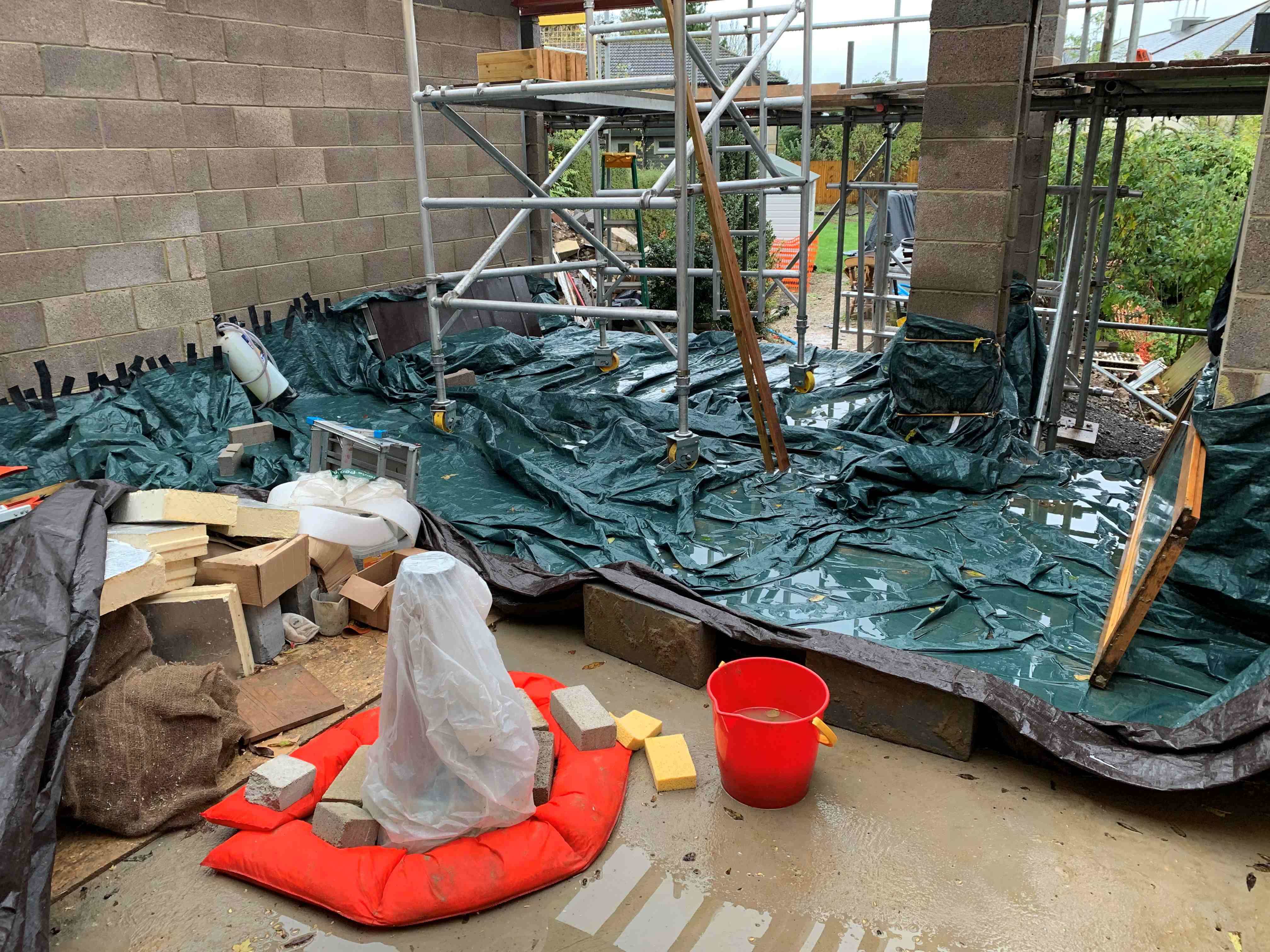

There are some challenges associated with putting the pipes into the slab, particularly arising from the fact the slab is constructed at an early stage as the build is coming out of the ground...
1/ You will need to know your pipe loops and layout and have it installed before the slab is poured. Including connecting the pipes to a manifold and ensuring they are pressurised and the pressure in monitored/checked.
2/ The slab needs to be protected from water ingress. That is stop water from being able to get onto and under the completed slab and into the insulation layer underneath. It might soak through the PIR edge insulation, or enter through apertures for conduit and services etc. The walls and roof structure are not in place. So you need to keep rain off the slab whilst you build the walls and the roof structure. A seperate temporary roof over the site is much preferable at this point - but our builder did not quote or provide for one. Consequently we spent money and time protecting the slab as best we could as the build went up. The risk is the insulation layer turns into a small underslab lake necessitating cutting out pieces of the slab and pumping it out etc - mucho cost and delay if this were to happen.
3/ Is a slab laid outdoors by ground workers ever going to be properly flat and at the right level ? A slab that is too high is potentially a major problem. You need good professionals with the right equipment, experience, and verifyable skill levels to get a good result. Do you know your FFL ? Are all your door openings at the right level ?
4/ You need to get your conduits and services/apertures in place before the concrete pour.

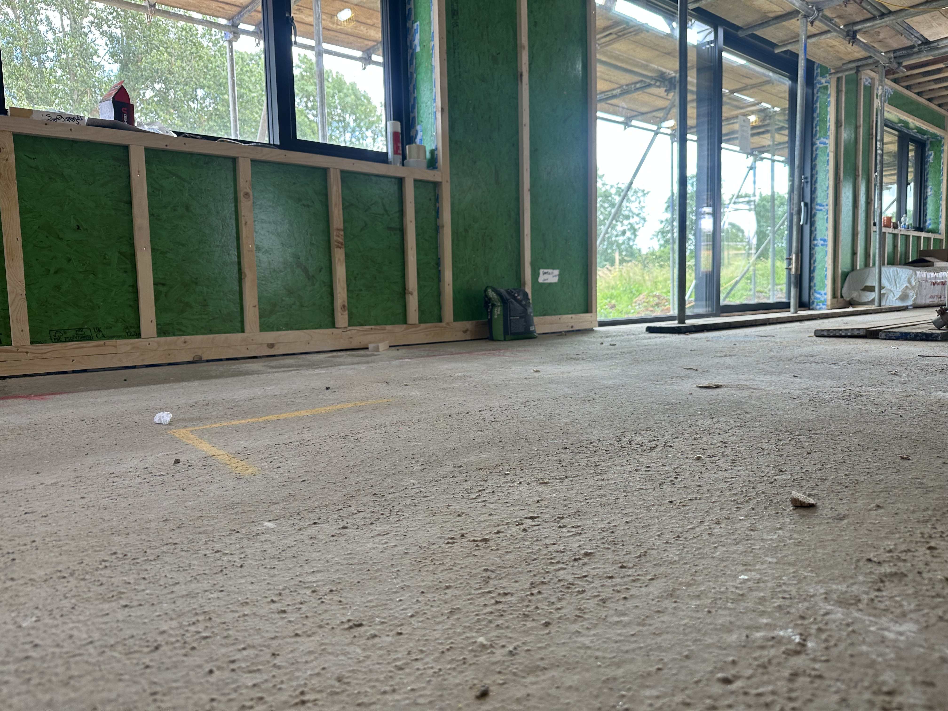

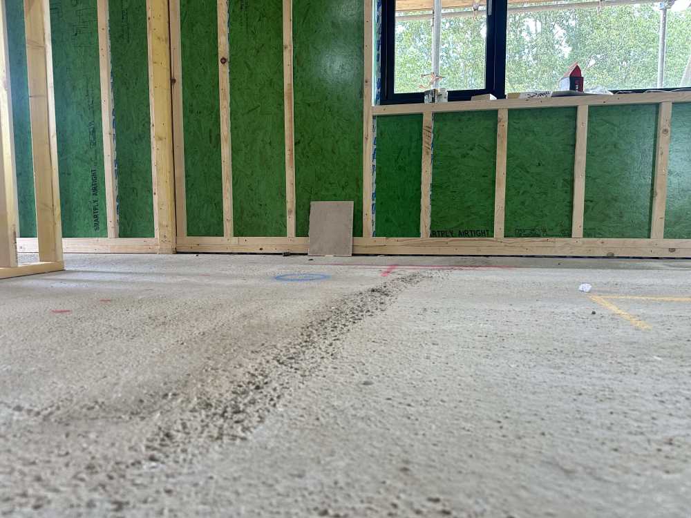

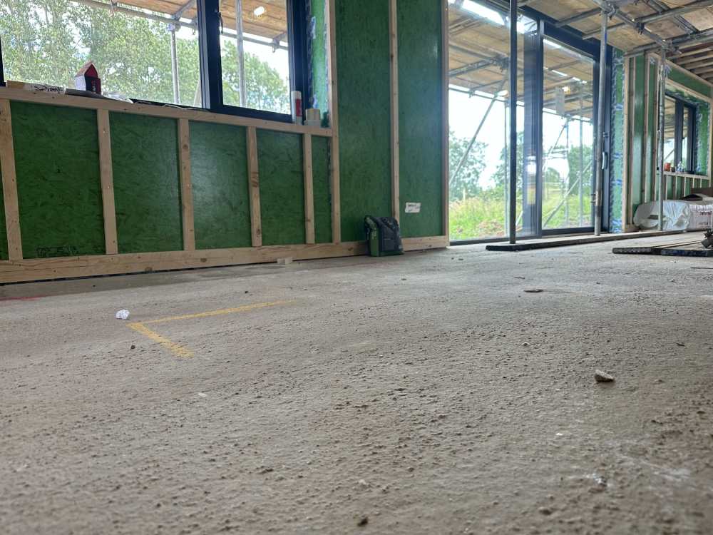

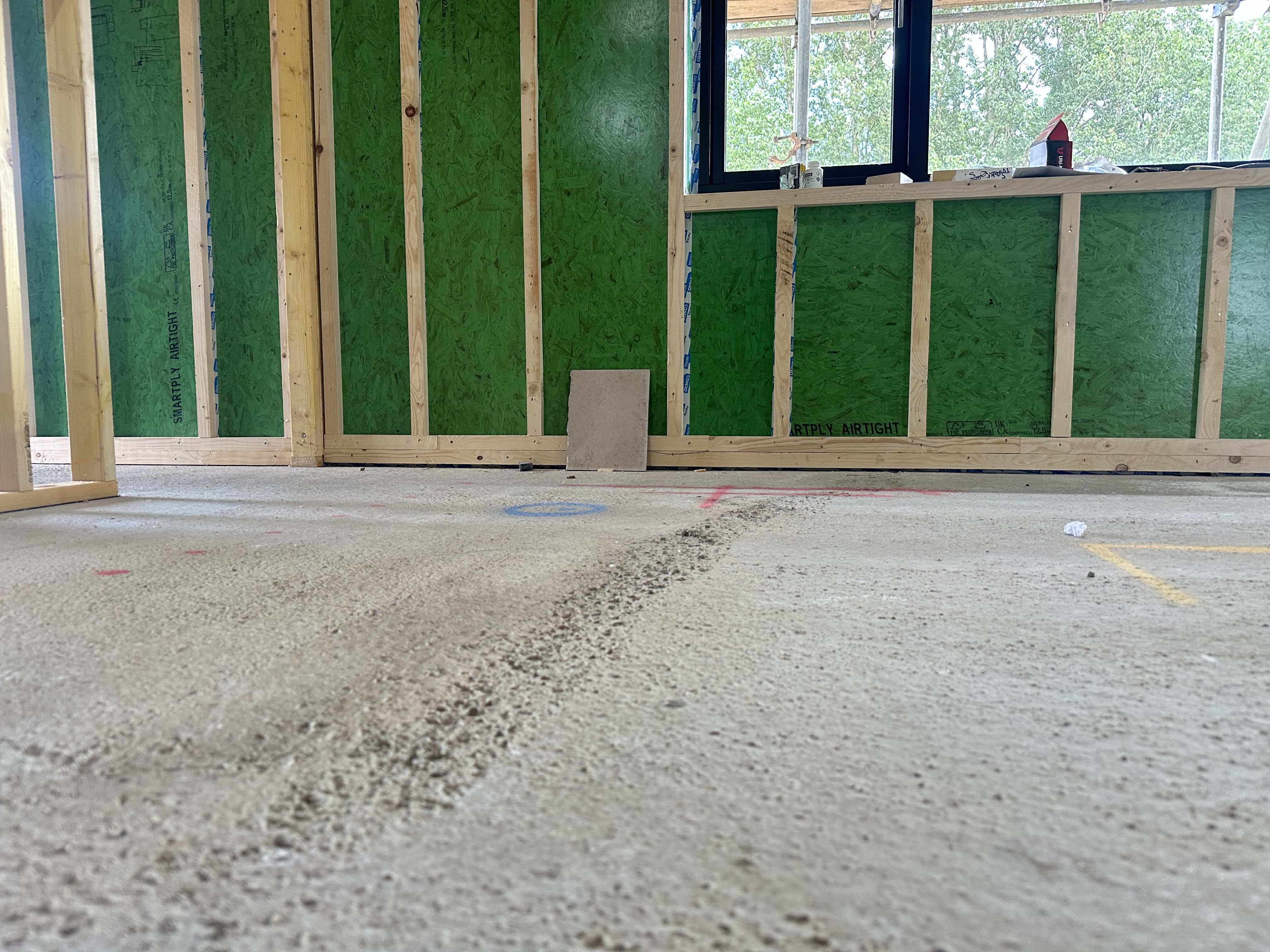

Current MBC one, great guys, SCC:
 IMG_4520.thumb.jpeg.0dd536822e00774930c8906b82b72fb5.jpegIMG_4519.thumb.jpeg.70c5fb6fe7cf4622385b525a972b0da4.jpeg

Thanks @Nickfromwales the manufacturers state that no further finishing is required, eg power floating.  Looks like they are being slightly disingenuous with that claim.
Nope, just you’re misinterpreting what they’re saying.
It gets “finished” by the dapple bar, and that is not ‘perfect’, but is as near to ‘shit hot’ as you’ll ever be getting.
FYI, power floating also goes seriously wrong if the person using it is a numpty.
You’re not going to get anything like you’re expecting, so realign yourself with whats to be expected in reality, as it’ll need ‘refinishing’ no matter what you put down; unless Jesus is on the bullfloat.

assuming 'slab' not structural have a look at liquid screeds. Finish that good we just needed primer and tackifier adhesive + suitable LVT straight on top.  No 'leveller' (which should be called 'smoother' in my book anyway - that's another topic and daily conversation for me!).

believe me it was good. we had planned to use smoother (leveller) but was pointless!   Not your normal LVT with trowelled adhesive -  more like a carpet tile without any fluff.  (Interface)

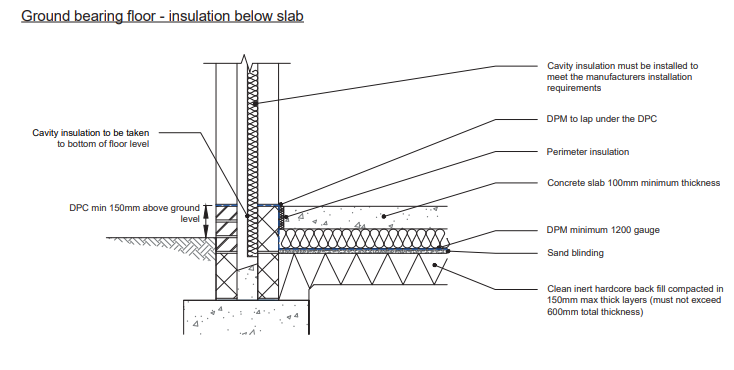

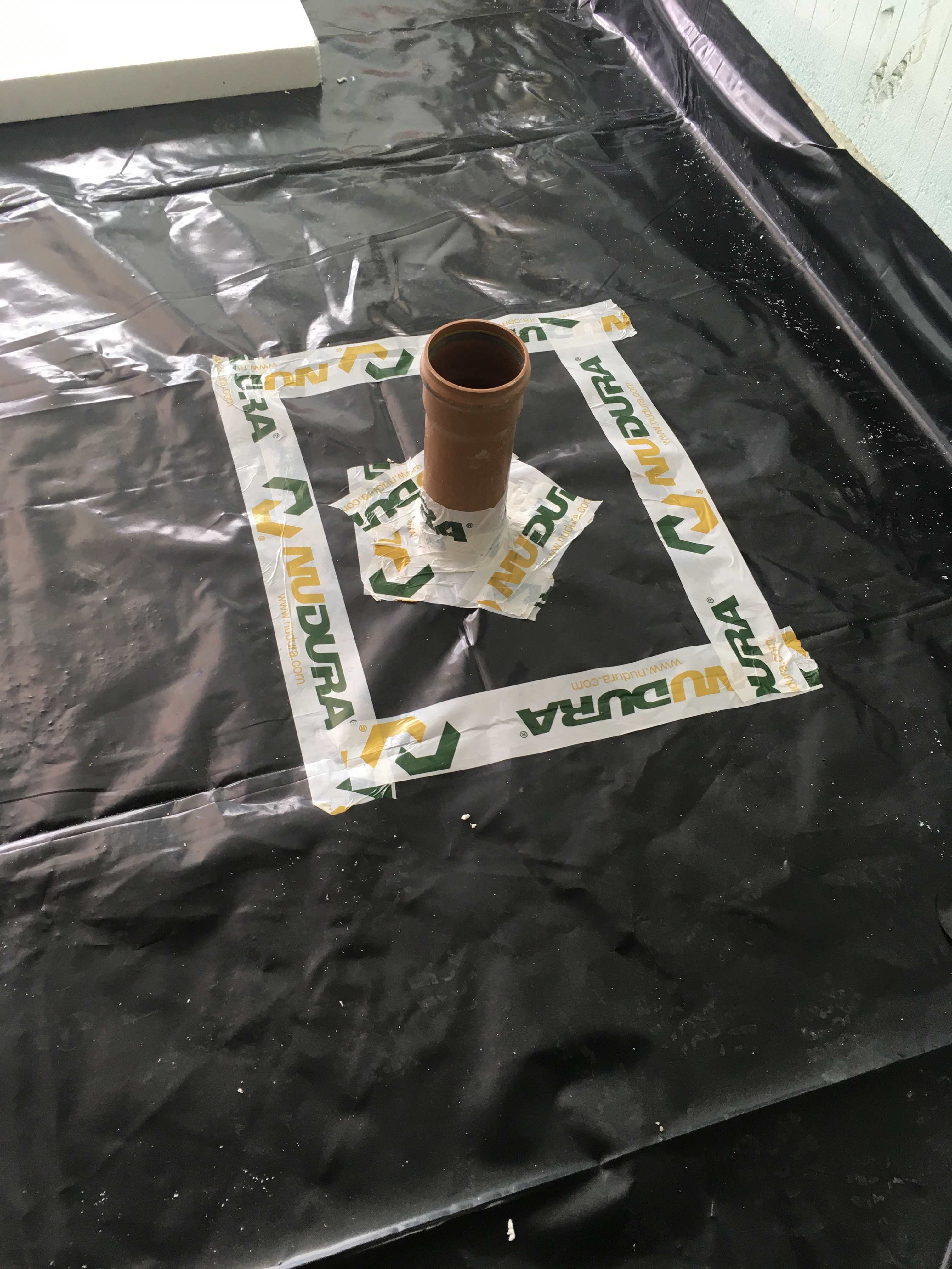

My plan is to put the the Radon membrane on top of the slab and a sacrificial DPM below the slab.  The utilities are quite high and if Radon membrane goes below the slab, it's going to be a hatchet job sealing around the pipes, due to the fact that at that level I am either on the start of the curve of the rest bend, or sat directly on the rest bend collar.  Going above the slab puts me on the vertical and will mean I can use the top hats for sealing.
has your detail changed?
Stop trying to reinvent this job.
sealing around the service pipes is easy.
you do not try and cut a hole in the membrane and seal that to the pipe.
cut a 300mm hole in the membrane, poke it over the pipe, then cut a 600 mm square of extra membrane, cut a 120 mm hole in the centre, poke it over the pipe and tape it up, then tape your patch down to the main sheet.
easy, each pipe penetration will take 15 mins max.
why buy two membranes to do one job.
if your finish concrete is rough the pir insulation won’t give a monkeys it will just deform to the shape of the slab when it has 15 tonne of screed on top of it.
I am obviously overly complicating these things.  It's not my intention, to but I spent nearly 2k on Visqueen membrane, pre formed corners and top hats as I thought it needs to be done with precision.  I get the impression that it's a case of just do a Heath Robinson job on it.  The PIR tip is useful and I naively thought it needed to be flat and smooth.
Having been a furniture maker in a previous life, this hackery is not something I am used to.
If you have the top hats then use them they work.
the problem is these things get designed on a computer by a bloke who wouldn’t know what end of a trowel to hold.
on site you very rarely get perfect conditions as you have found out with the pipe collar being exactly where you need to seal it.
so you will probably find you chuck a couple of top hats away and just use more tape.   Hardly heath robinson this one, it’s just done, finished move on get the concrete on top and it will become a distant memory.

We recently had self compacting concrete insulated raft with UFH fixed to the steel mesh. We were told it is as good as a power floated finish. It is not. Dapple bar ridges prominent, high areas needed grinding back. Not happy - should have ignored the hype and stuck with power floated.
Sorry to hear that.  Thanks for sharing your experience though.
