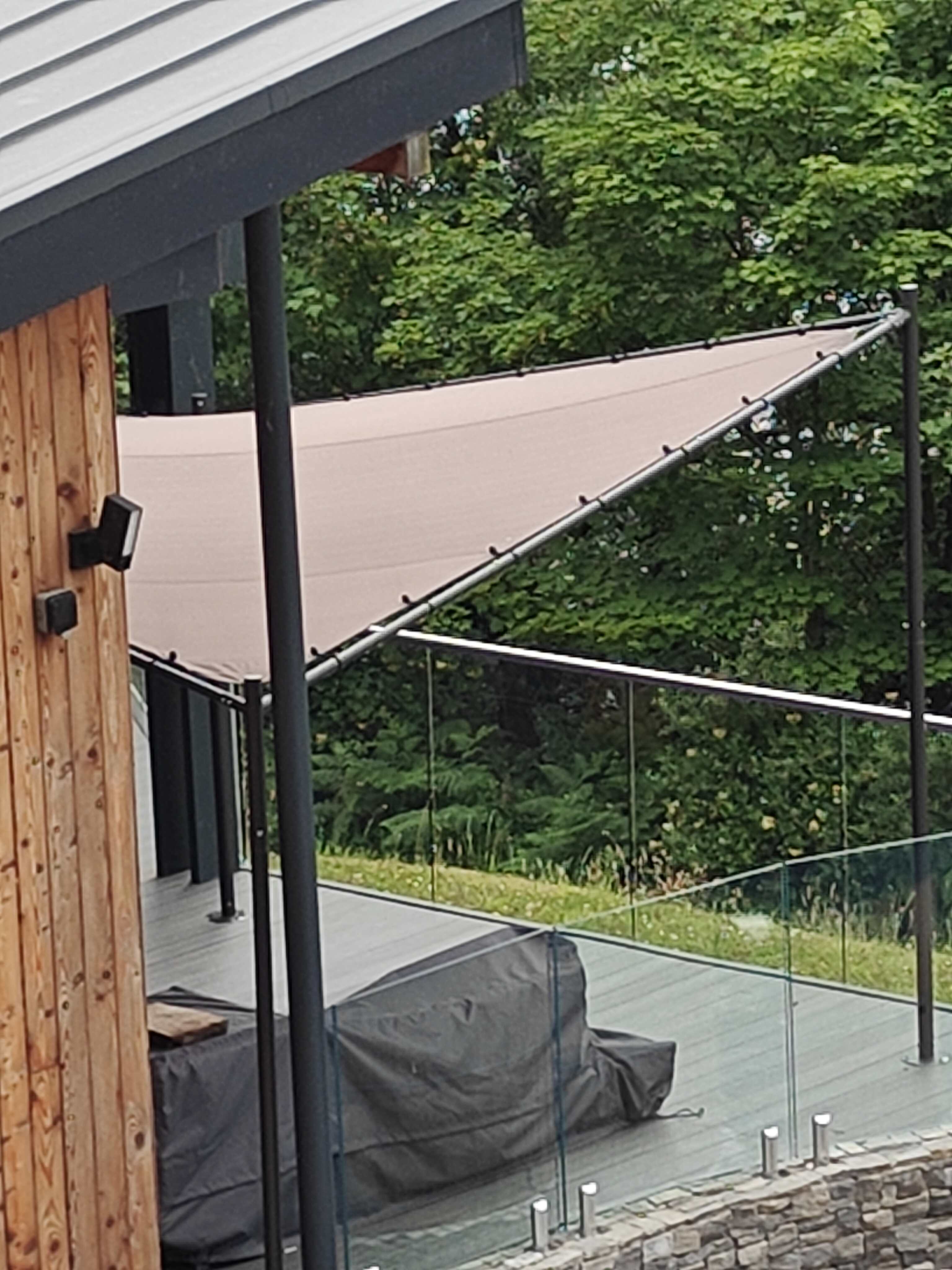

We have a sail thing which covers a seating area outside. But it does provide shade to a set of french doors also.
Whole sun exposed front of house has a large roof overhang, depending on time of year, time of day is quite good other times not so good.

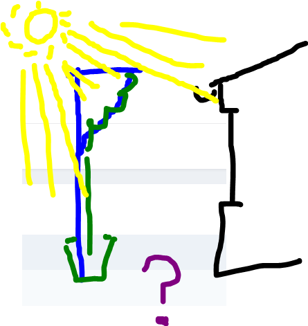

for the kee klamp/scaffold with vine wires idea thinking maybe even at an angle to reduce width required at top? dumb idea or not?  thoughts appreciated - as brutal as you like !!

49 minutes ago, marmic said:
A long narrow pergola effectively!  Possibly a temporary canvas /  bamboo screen on wires whilst plants
Selected with care and a view to the long term, plants are the best shade. But they weigh much more than I thought they would.
thank you JohnMo - i have been toying with something like this as nice and simple - how does it get on with the wind?  off the shelf item? Or kee klamp type tubes etc?
We are very exposed location and if high winds expected I remove the sail.
Off the shelf item from local garden centre. Thin wall tubes rock about in the wind. Have thought about changing the steel work for some thicker walled and more robust.

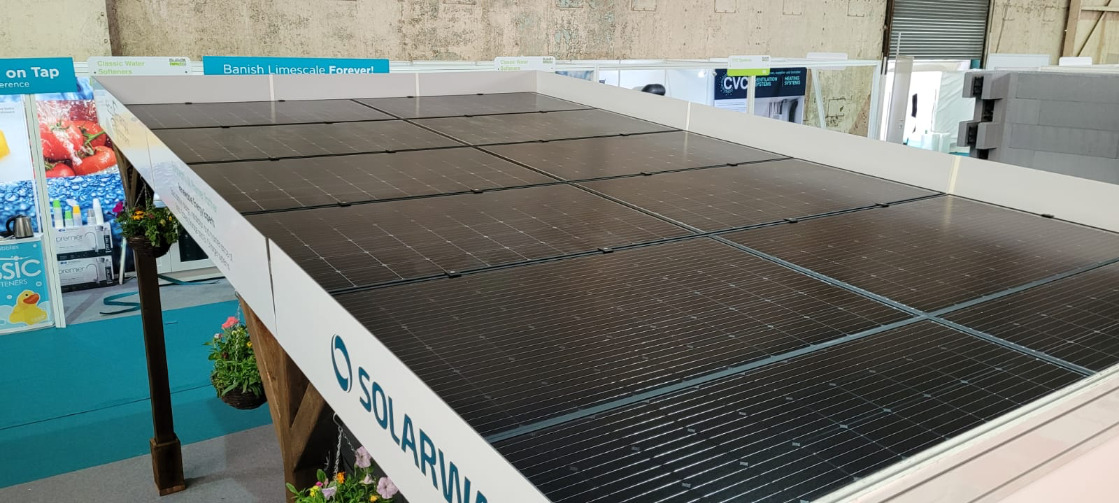

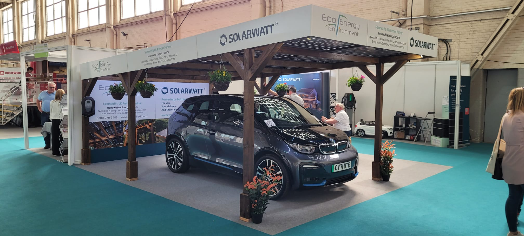

How about a strip of double glass PV panels on a free standing wooden frame to provide shade and electricity? Double glass look the same from top and bottom (black glass). Add a flat narrow walkway near house for doing your gutters?
Ummm   good point. Moreso when wet. And thinking further more leaves for the gutters!  So maybe not such a good idea! Exmet??

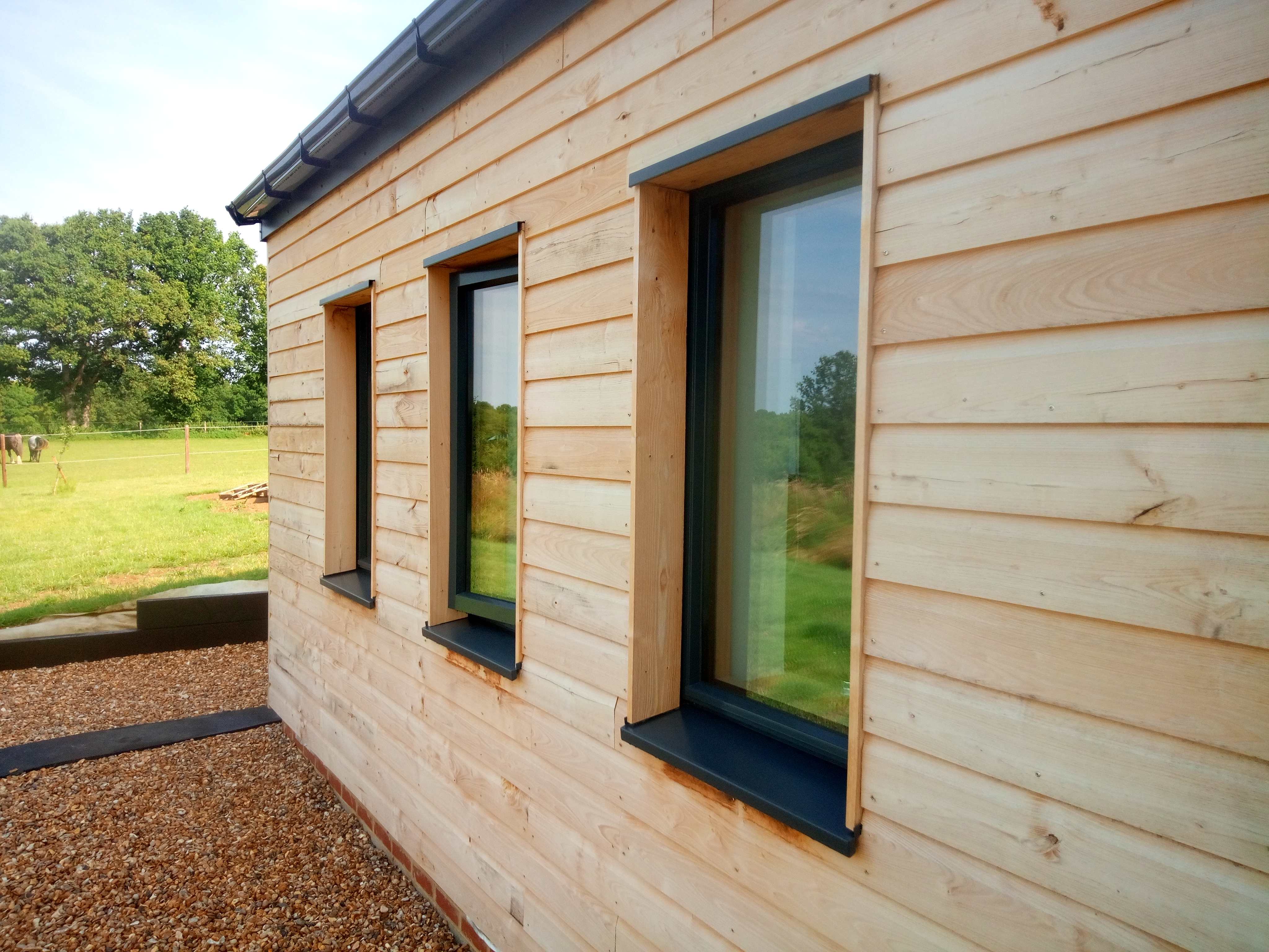

If it’s for those 3 windows in your pic I would go for shutters on a sliding rail above the window
like an old barn door sliding mechanism thing.
I think it would fit that exterior perfectly.
nice idea - but pricey and we're already generating more we can use from PV on roof!  Probably some fins out there with pv too - like the stuff tata offer as option on standing seam??
Also a door, and 2 more windows, 1 larger, 1 smaller - going to get costly as would need to be bespoke, probably aluminium louvre panels. I too think potential to look smart particularly if same colour as windows - but having now measured / visualised going to look too much on the elevation!

Not really all DIY, 2x 500W panels cost £60 each, inverter £150 and an  isolation switch. Wood not that expensive and brackets.

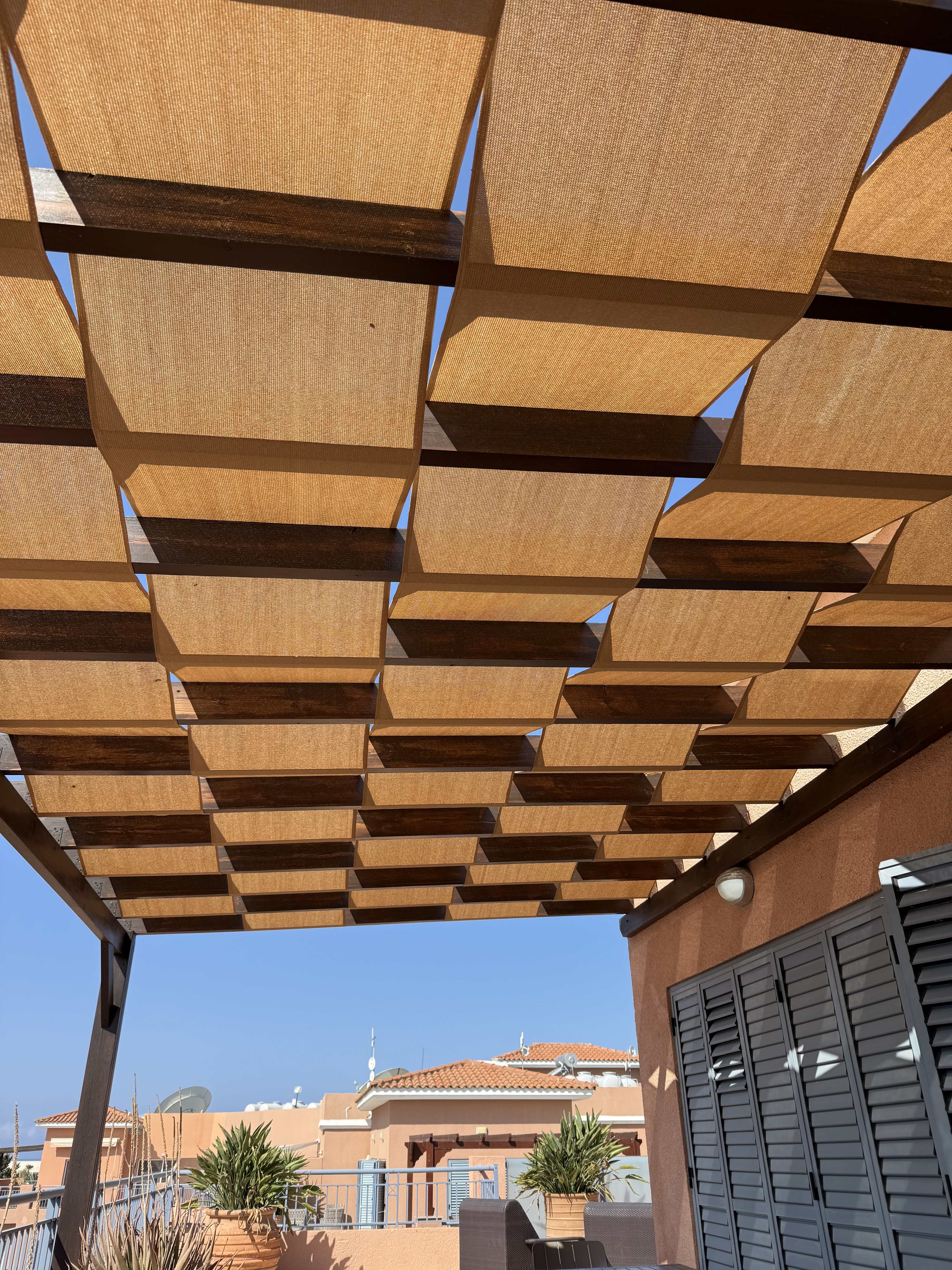

We just got back from a holiday and the apartment we stayed in had one of these.
thought it was a great idea and something we’re thinking about building. The good thing is the wood beams are far apart so removing the fabric in the winter will still allow the solar gain whereas the tight spaced pergola fins would probably still reduce solar gain in the winter as well.
