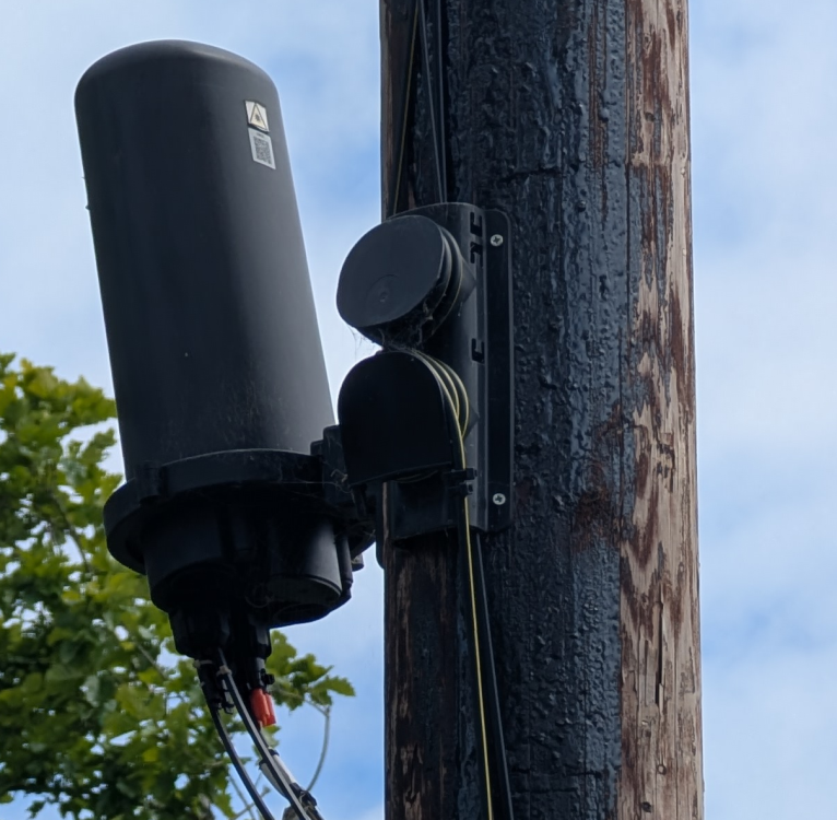

hello. BT say there is no full fibre for my new build, except they installed fibre along the telegraph poles 3 years ago. Before I shout at them I want to ask if this connection point (pictured), which is next to my house can service more than 2 properties (which are already on full fibre). Is it a case of "computer says no" or is this connection point only capable of supplying two properties? I would be very surprised if that is the case but there are only two "round things" next to the vertical box. Does anybody know what goes on inside that thing?

I would guess at 4 or 8, more in a densley populated area
If you can get a clearer shot of the connections on the bottom you might be able to get a better idea
That said even if there is capacity at the pole, there might not be upstream
Good luck with BT / Openreach - very frustrating to deal with

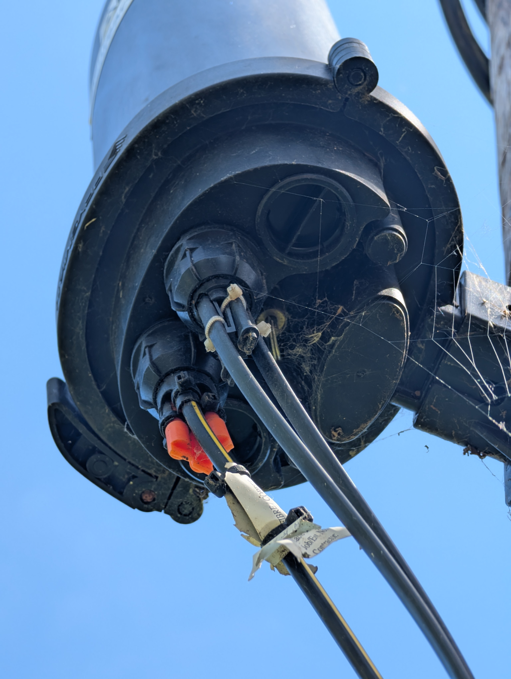

Posted
So there are 3 cables coming down the pole. 2 black flat ones and a round one with a yellow stripe. Does this picture make any more sense? This is a very rural area with only 5 houses along a 1 mile stretch. My step father's connection on the next pole along is up to 900mb so it would suggest there is bandwidth. I'm trying to establish if they simply counted the number of houses by each pole and allowed for that or whether they allowed for expansion.
Do they run 1 fibre cable per house up to the pole or is all the data carried on 1 fibre channel up to the black box on the pole and distributed out from there?
I'm trying to find out if it is worth pursuing because no service provider is going to do anything other than say what's on the screen in front of them.

My understanding is that is an splice CBT enclosure that should be able to take at least 12 connections (3 are used already). The double cable is probably the network feed loop coming from and going back to the overhead public cable. The yellow stripe cable is a single private connection to a building.
It does mean it's more work for OpenReach to add an additional connection (since it is a splice enclosure, not pre-terminated), but should have capacity to add additional connections.
