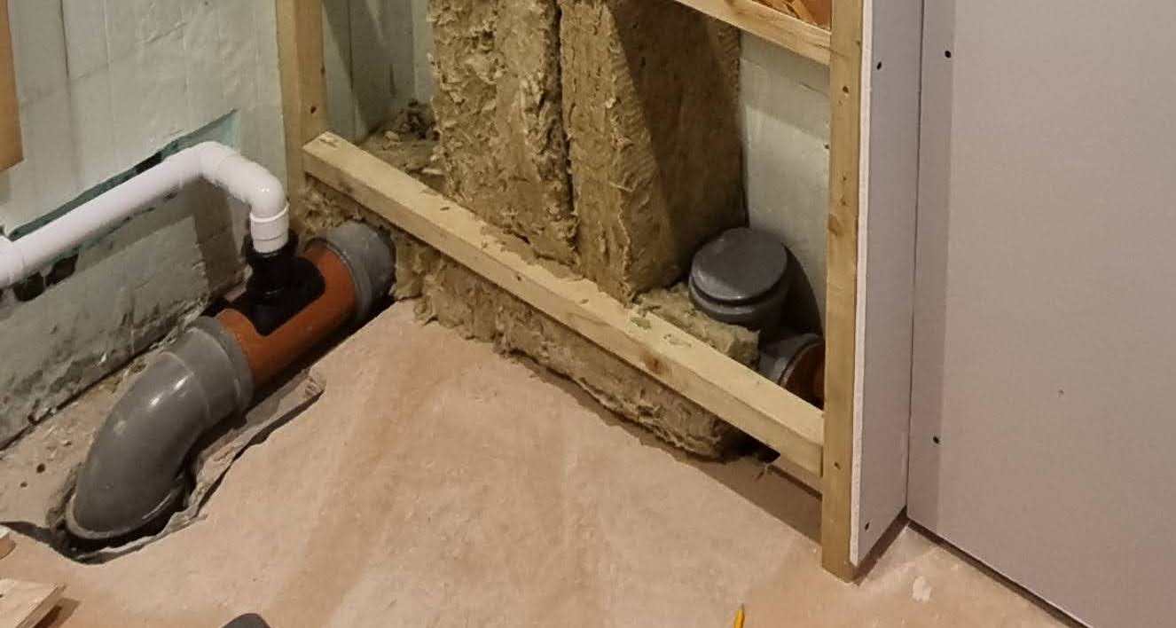

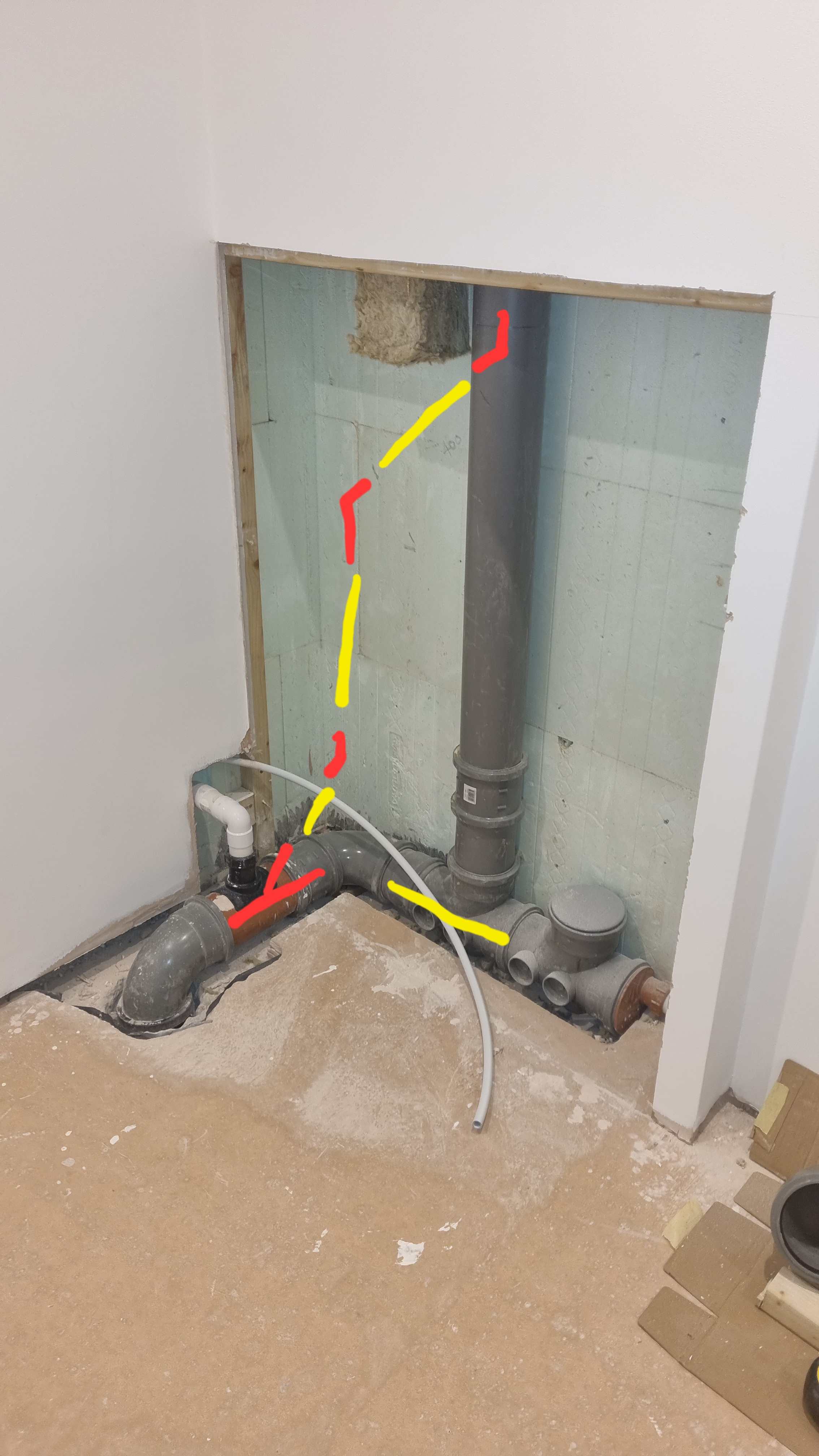

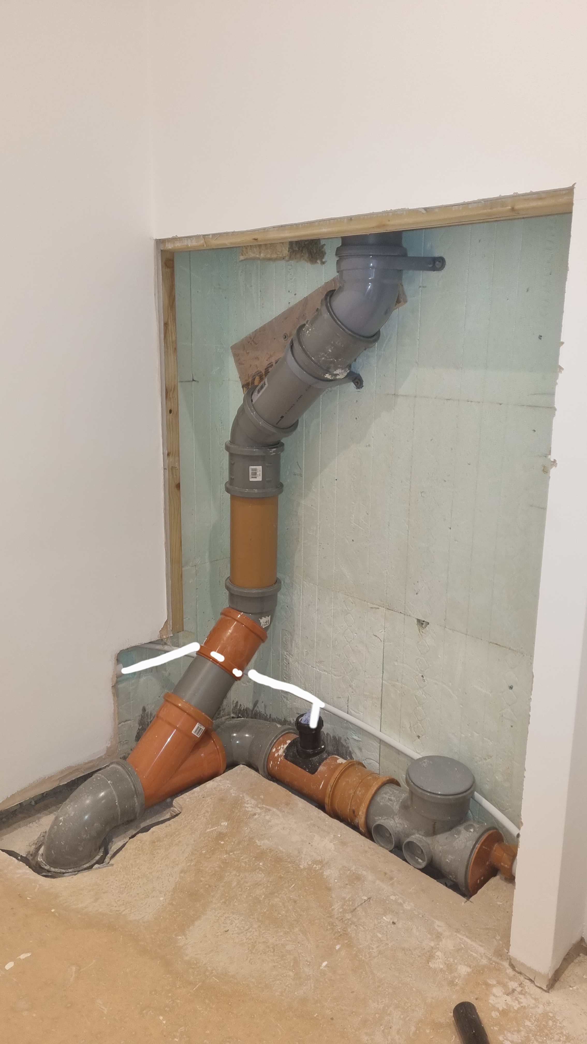

BotusBuild Posted 8 hours ago Posted 8 hours ago (edited) This serves as a warning to all new self builders, who will likely see it when too late, and also to try and get myself out of a bind. TL;DR - make sure the outlet of your pan (typically at 180-185mm centre !!!!!!!!!, or roughly 130mm from floor level) can be connected to your soil pipe without having to go UPHILL!! Basically, I have a swept T where the T part comes up to 180mm (maybe a little lower) from the floor level (the one with the cap to the right in the picture below). By the time we have fitted the final floor it might be about 170mm, so still about 40mm higher than practically every floor standing pan available on the market. Second major mistake is that lot is now behind a plastered wall. Honestly, I don't think I could have f&*%ked this up more. I am furious with myself. Anyway, options as I see it are: Lower the soil pipe into which the swept T is fitted. I am not going down this route The swept T has a seal on it. Option 2 is to cut the part with the seal away from the pipe, shortening the pipe, maybe by enough to get to about 150mm from dfloor level Raise the floor level "locally" by 40-50mm for a floor standing pan to sit on (SWMBO's preferred type of toilet pan) Fit a wall hung toilet pan which I can set to the height of my choosing (SWMBO thinks they look too commercial. It has been discussed and there may be a chink of light in the armour 🙂 ) Completely rejig the en-suite layout and pipework, which would include having to re-route the soil pipe from the cloakroom that is directly above this mess (it's currently behind that insulation). So, apart from calling me an utter f*&%tard, which I deserve right now, please can anyone provide some kind enlightenment to the snivelling self builder in the corner? Thanks Edited 8 hours ago by BotusBuild Changed subject 1

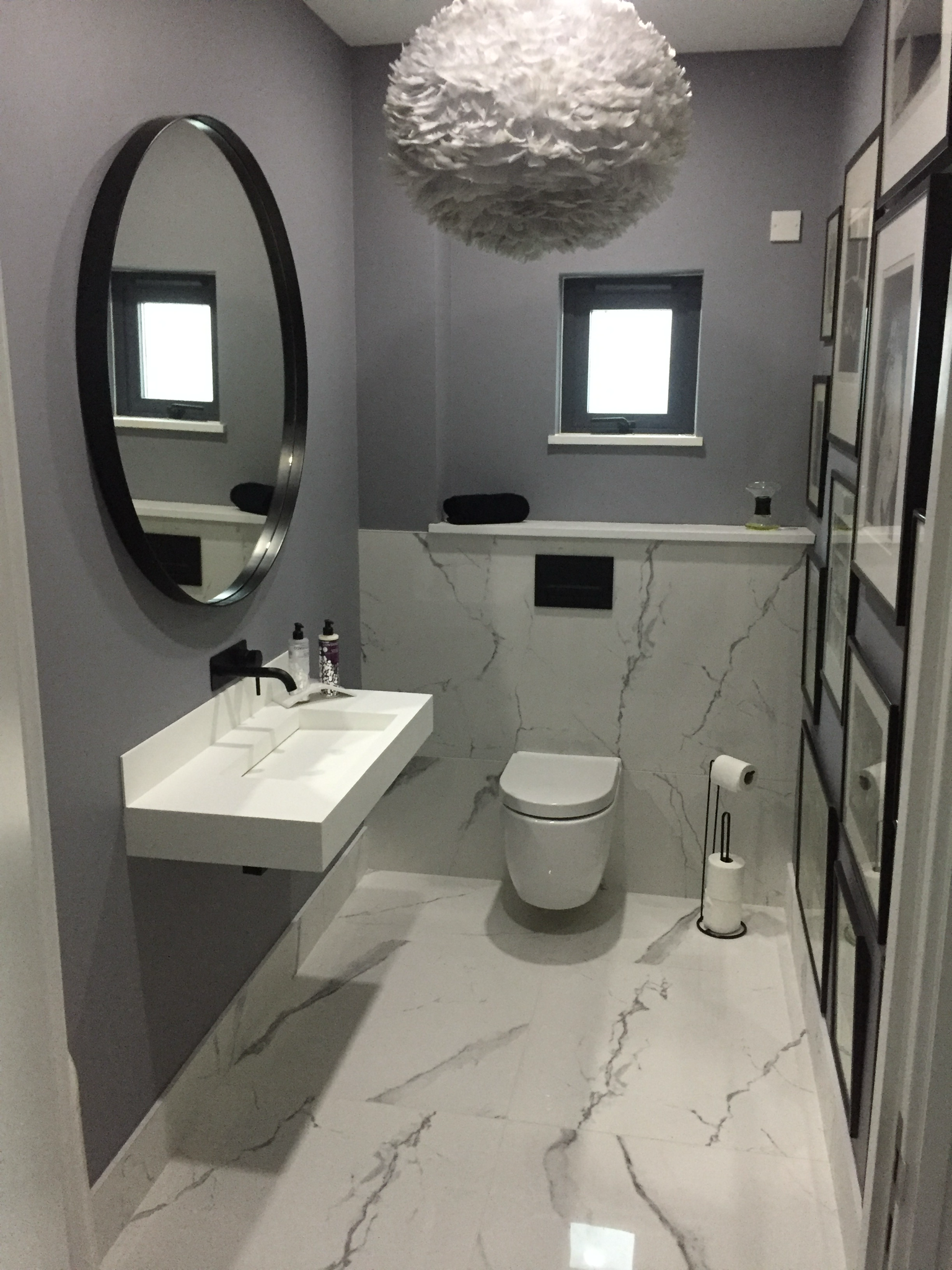

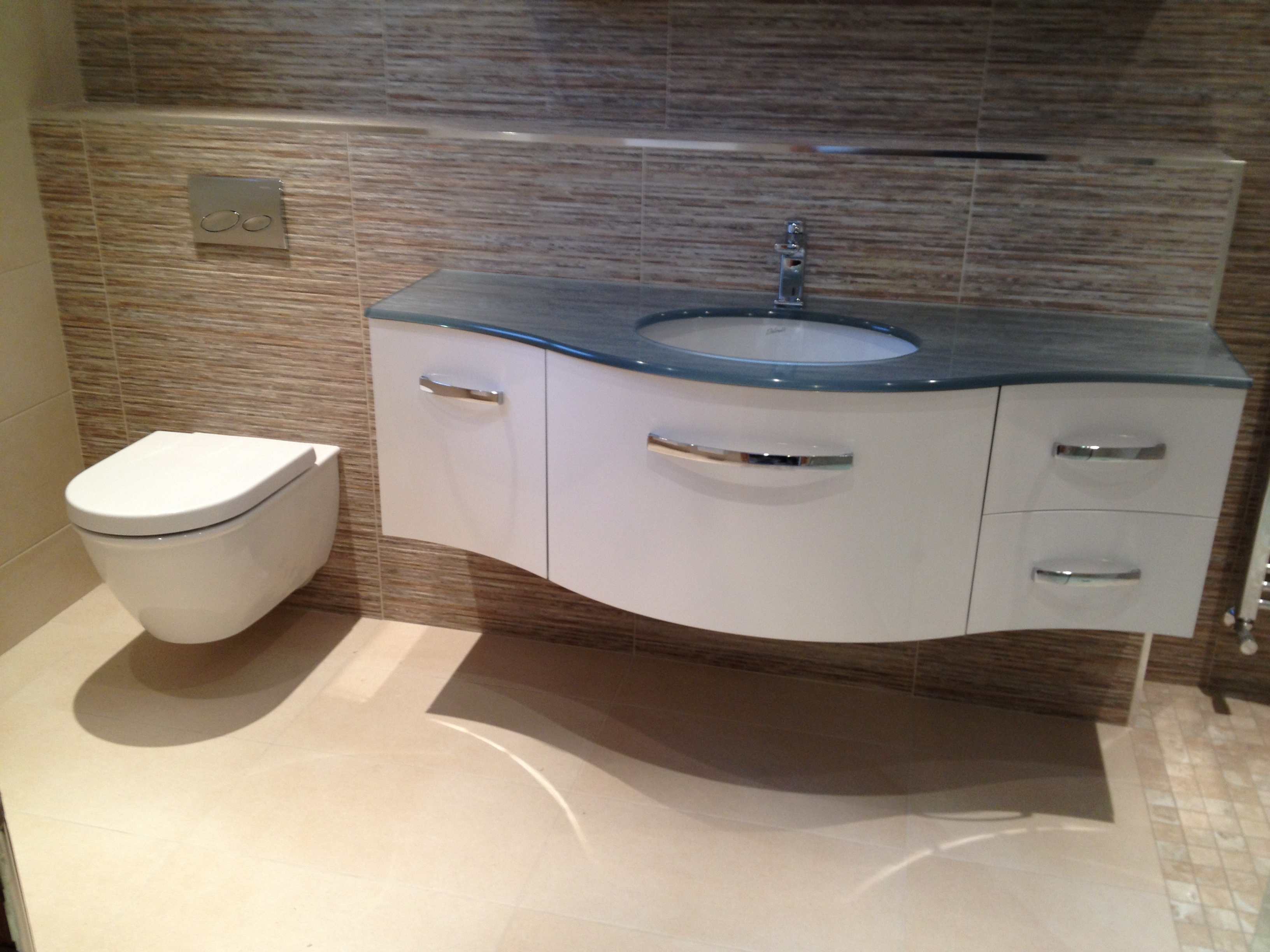

Nickfromwales Posted 6 hours ago Posted 6 hours ago 1 hour ago, BotusBuild said: Fit a wall hung toilet pan which I can set to the height of my choosing (SWMBO thinks they look too commercial. It has been discussed and there may be a chink of light in the armour 🙂 ) Vanity was an Italian import, but imo the hung pans look very exclusive. Plenty of shapes and sizes to choose from. 4
-rick- Posted 5 hours ago Posted 5 hours ago 46 minutes ago, Nickfromwales said: imo the hung pans look very exclusive. Easier to clean around too. 2
Nickfromwales Posted 5 hours ago Posted 5 hours ago 49 minutes ago, -rick- said: Easier to clean around too. Yup. No grotty silicone to scrub the pee from Beer reduces accuracy……. 1
