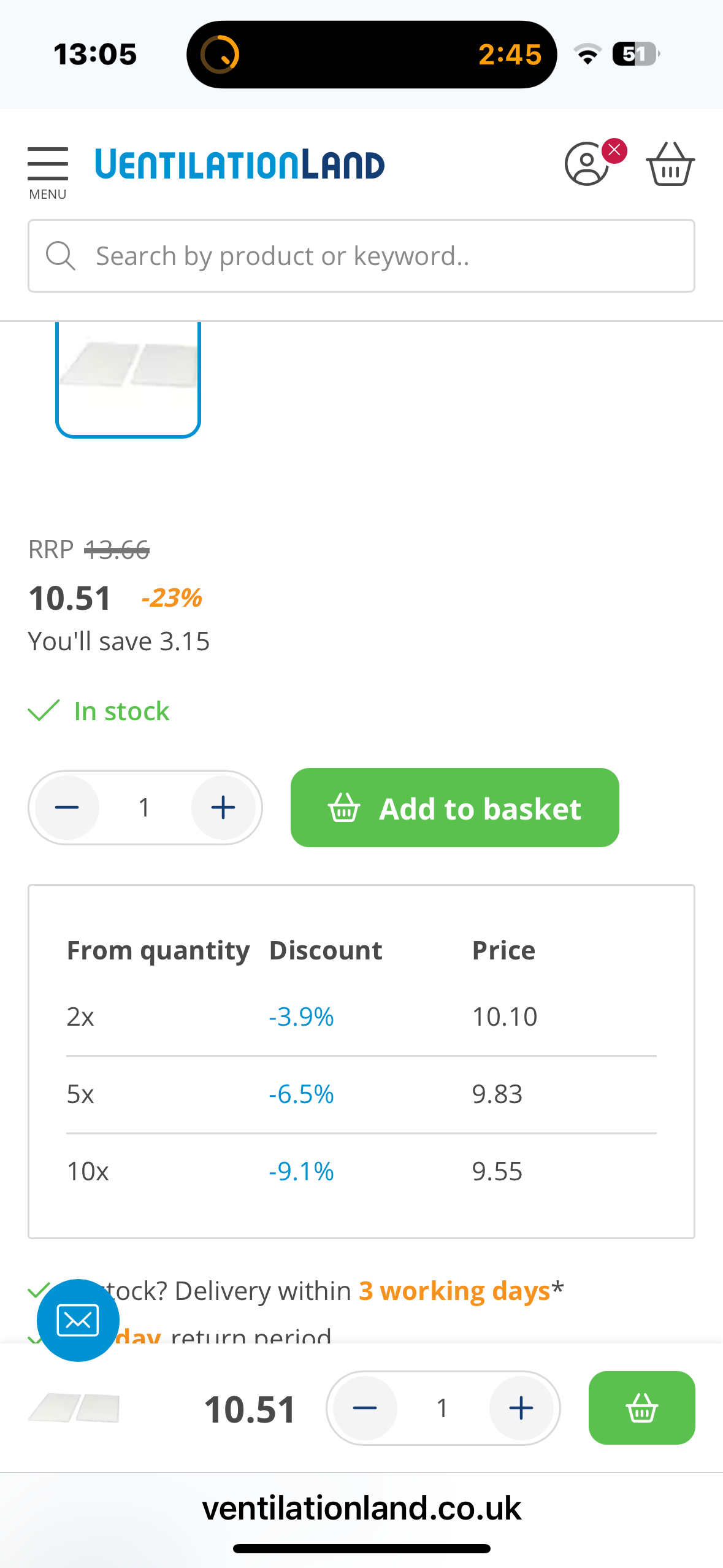

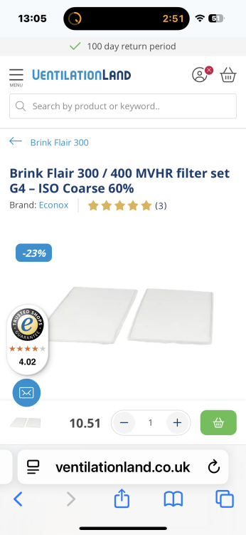

Cleaning or replacing the filters
Your preferred Brink MVHR, filters from a quick look are £70+, depending on area you live, that could be twice a year expense. So may only take the time it takes to make a cuppa, but it becomes an expensive cuppa.
Had a dMEV fan running in a summer house a couple of years, nothing has been done, nothing has been needed, could replace the whole fan nearly twice for the cost of your filters.

IMG_4179.thumb.png.38ff7b2379ddc45303298010371cd791.pngIMG_4180.thumb.png.9aab5c75d80a2aecf1378c410f0f4f8a.png
I did look harder and dismissed G4 for both supply and extract as that is not the normal offering, for a new unit, it's the supply filter that bumps up the cost.
But OP wants to go MVHR route anyway.
