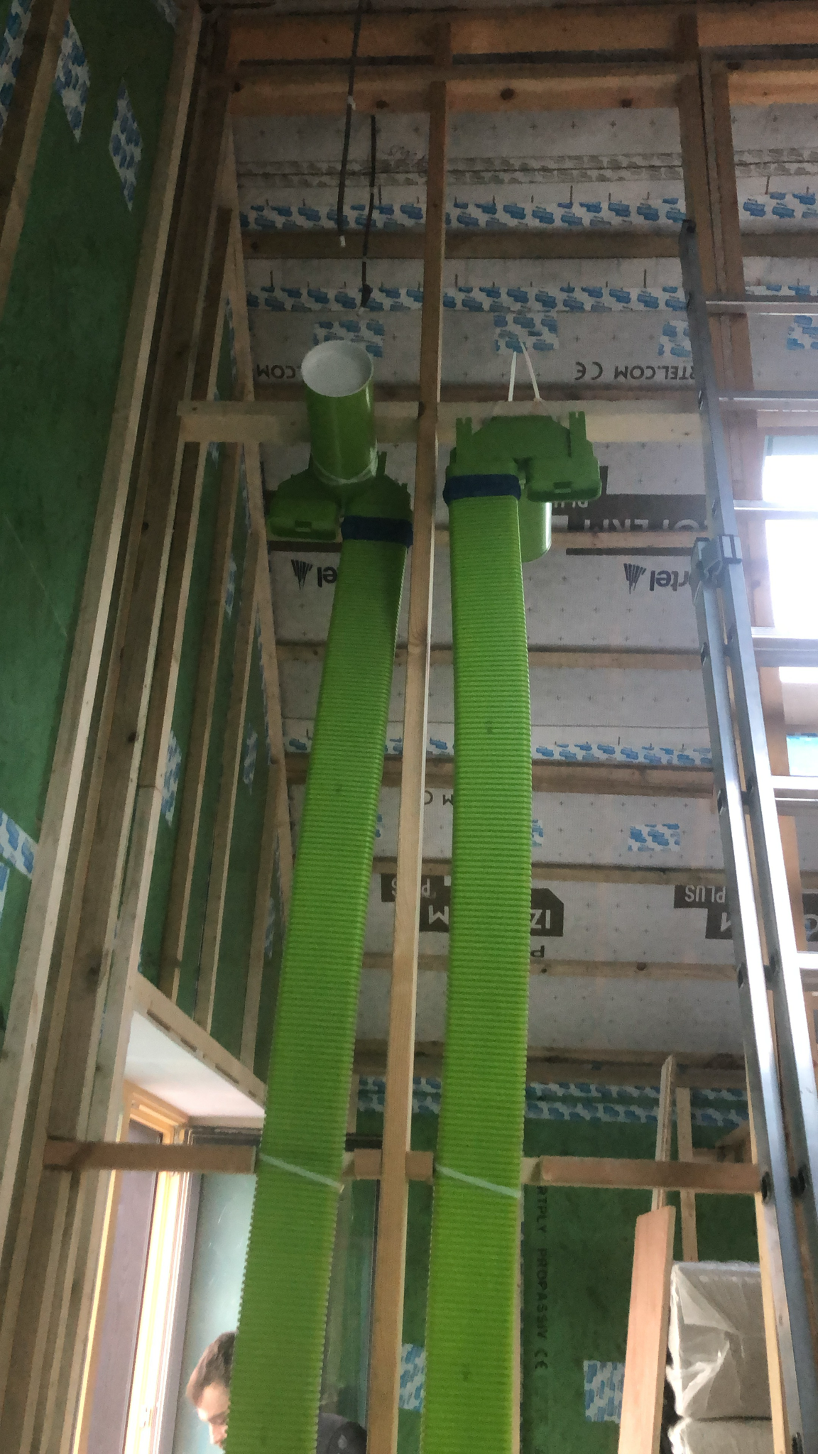

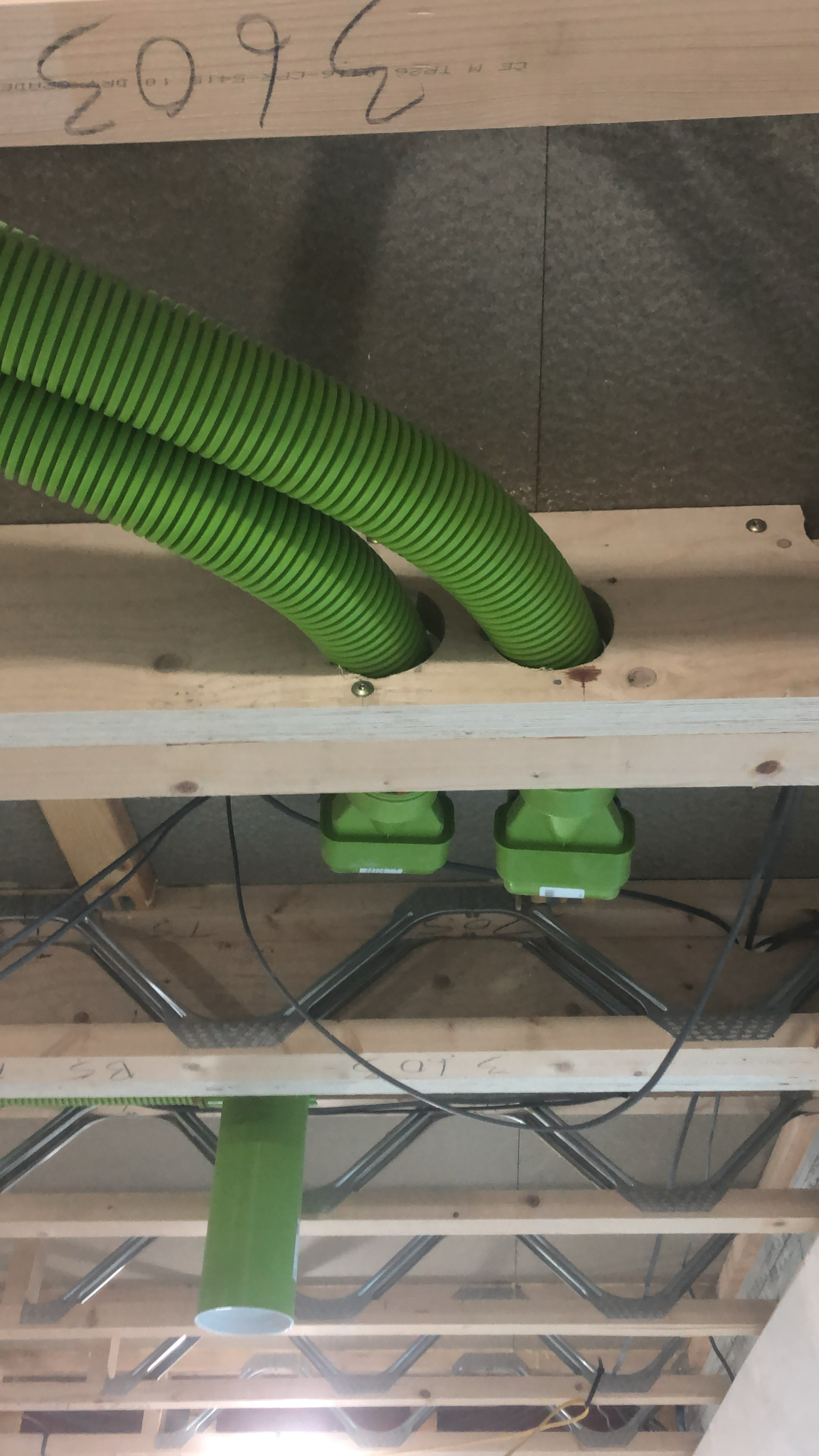

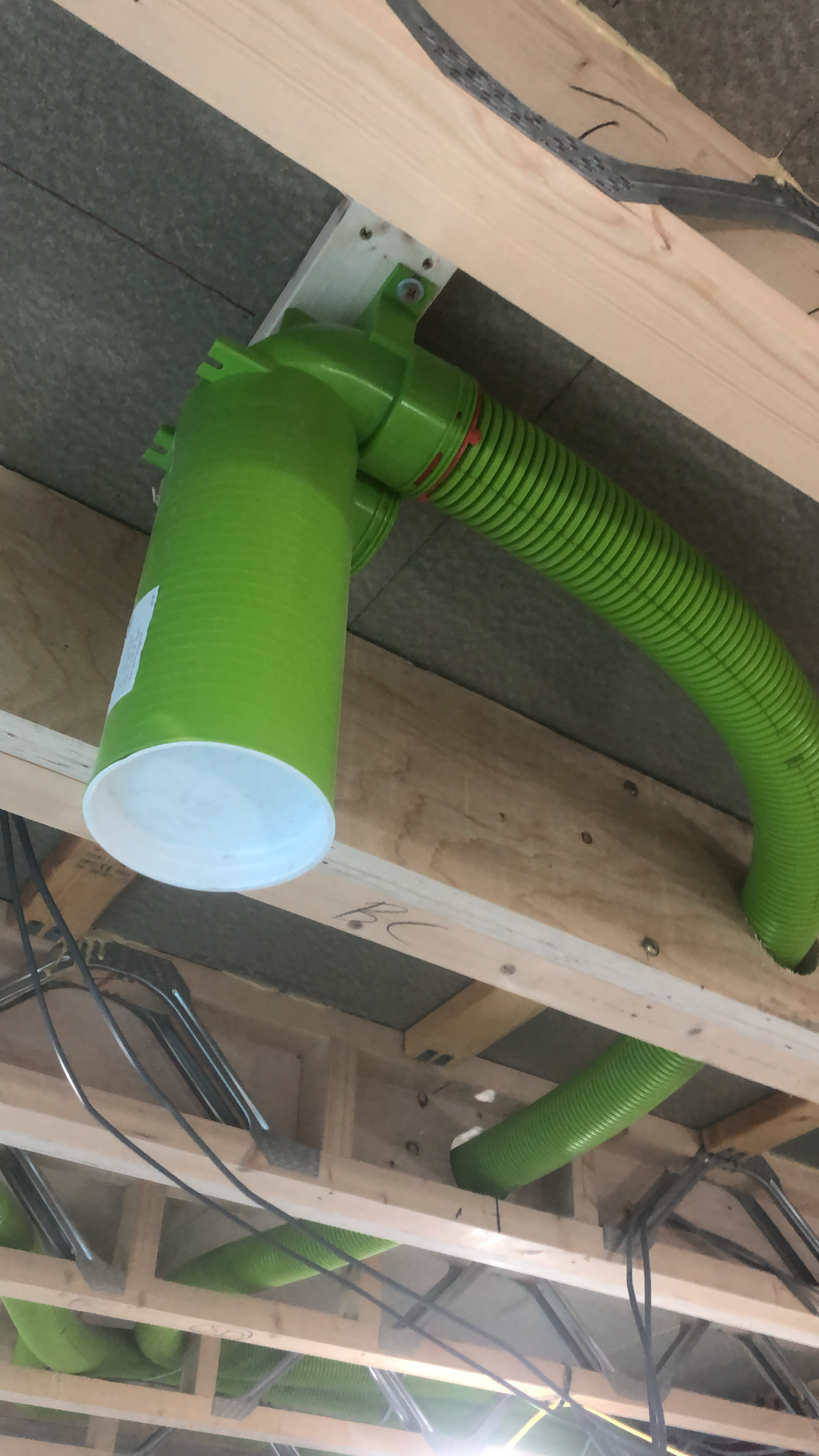

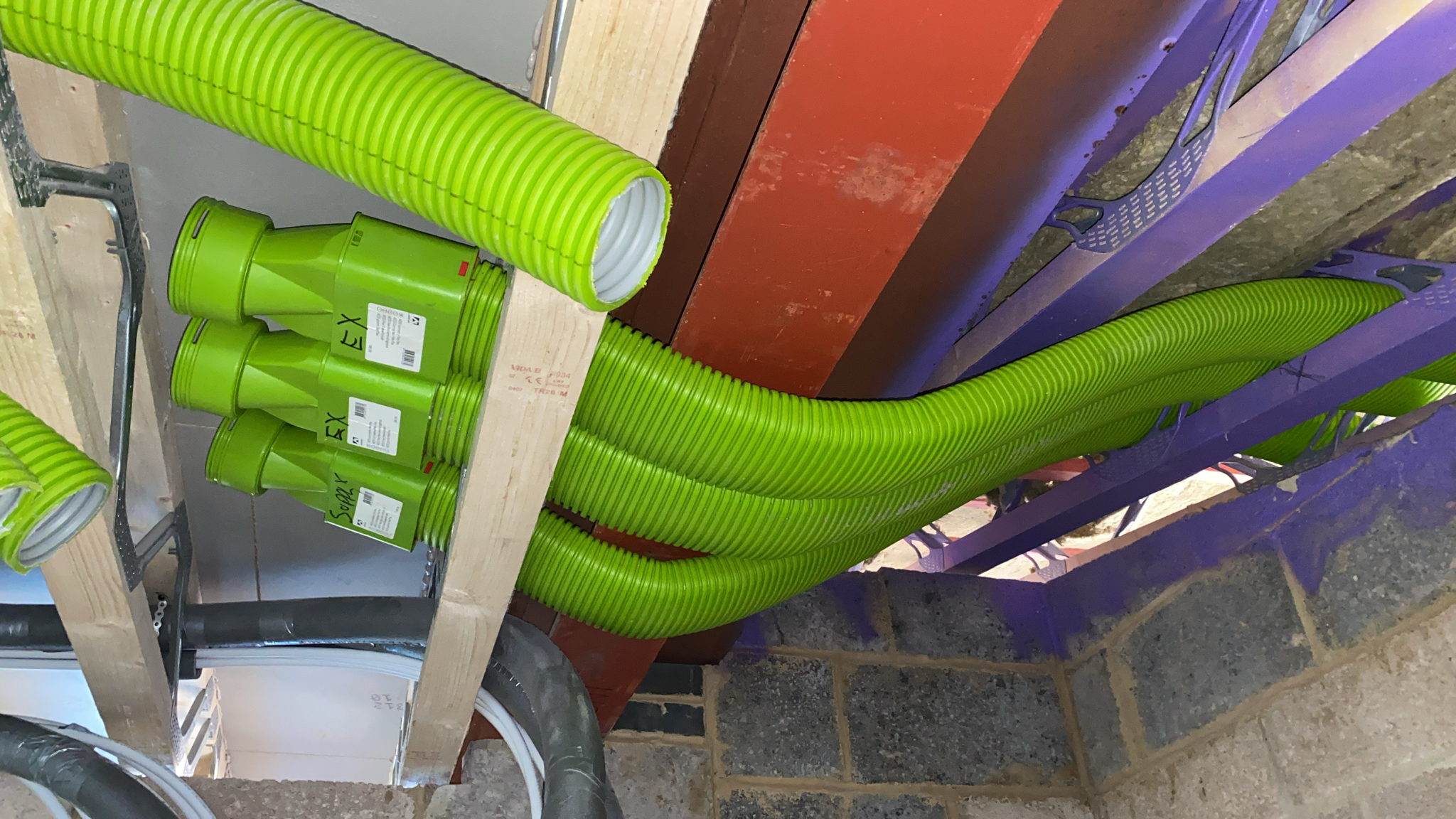

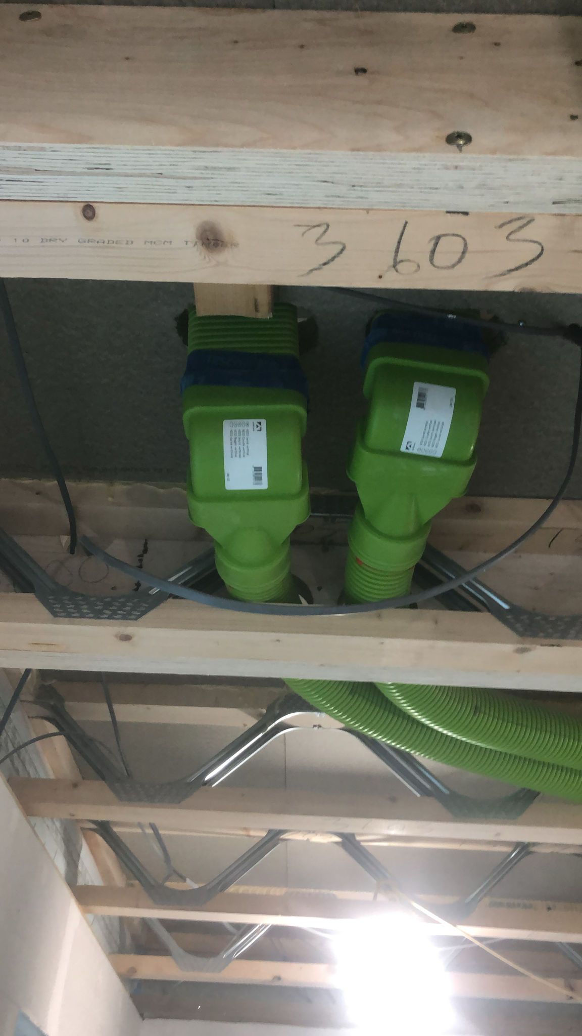

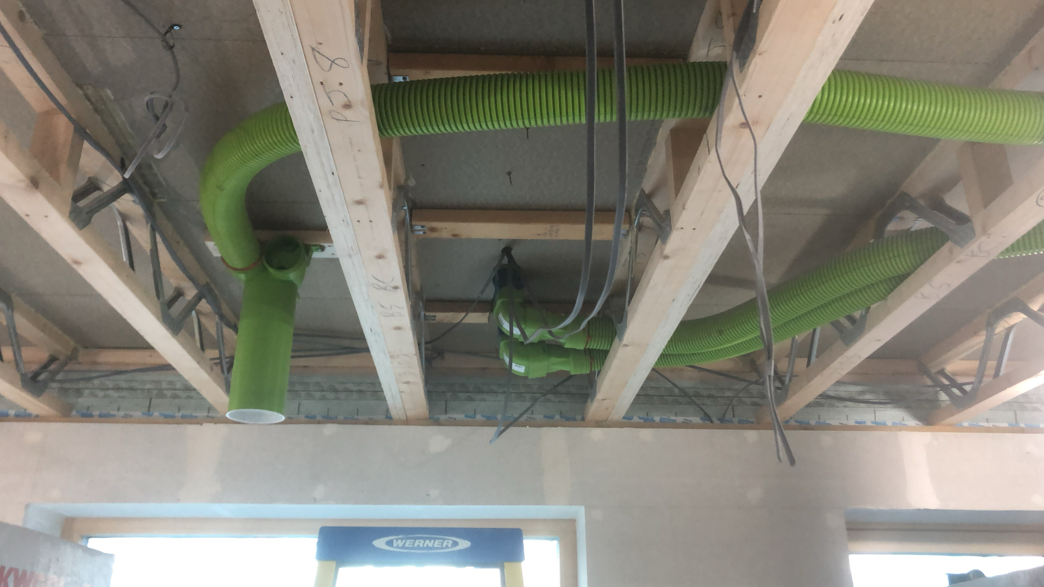

Just swap from 92mm round to ‘oval’ (rectangular) duct to pass the steel and then covert back to round. Done it plenty of times.
Some examples of my MVHR installs…
Hope these examples help. 👍
