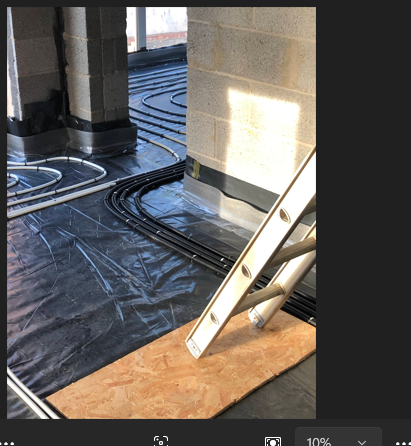

crikey, good job, well done you!  I've got a very rough idea where my pipes are... and they are encased in conduit.  So if it comes to it I could cut and excavate, but only really as a last resort.
there's the 4 in question, you know they are there because the staircase is due to have a wind at the base, and I left a nice big gap for a standard timber staircase to bear down away from pipework....

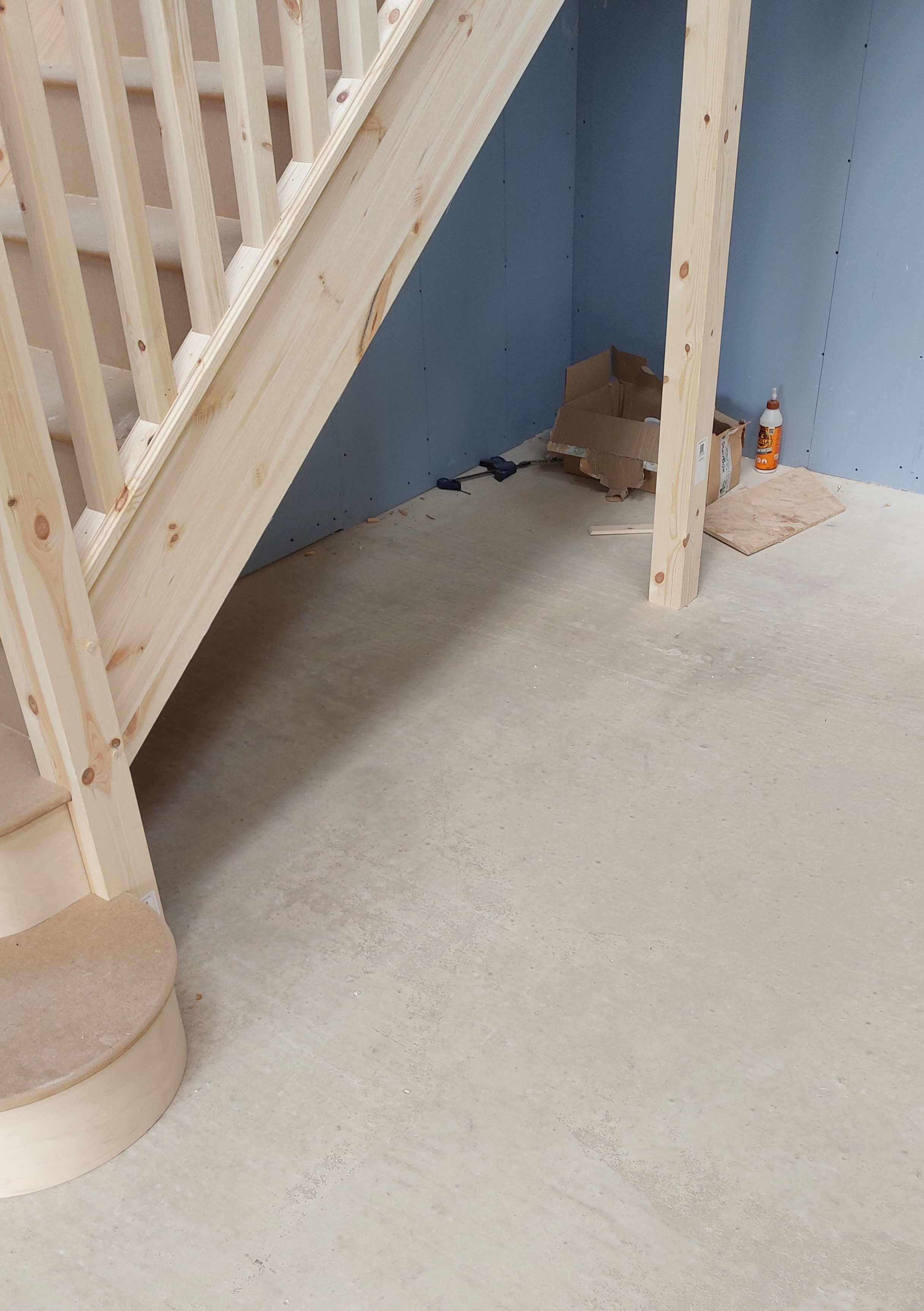

For a little comfort. We put this stair in as temporary access. The post is really too small to bear directly on the screed. A permanent solution will be to have a much bigger bearing area by plate, or by forming a footing in place of insulation.
But do notice that after a couple of weeks of burly builders and carrying materials,  there is no damage and the screed is only 40 to 50 thick.
So it's not a panic but does need a considered solution, as already discussed.
