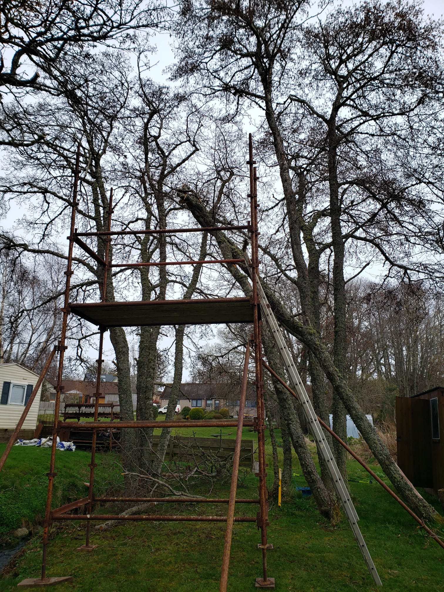

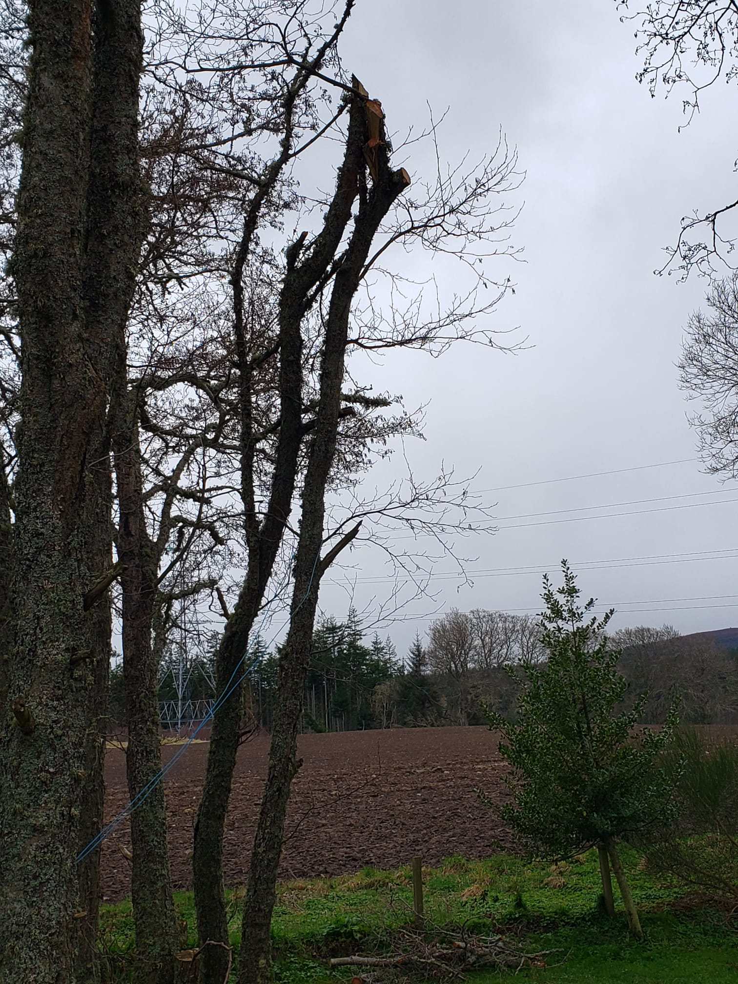

April 2Apr 2 Just an example of my inventive DIY tree felling. These 2 trees, the right hand one had failed at the roots and was leaning over onto it's neighbour. All the tree men that looked seemed to suck air through their teeth, but all agreed both need to come down. I suspect none really knew how to do it. To fell them in one go, it was likely the tops would reach the house or static caravan. I suspect nobody wanted to climb a compromised tree to take the tops off. My inventive solution was put up a scaffold tower next to the trees and working from that with my extended pole saw I cut the tops off. That now just leaves the two mostly bare trunks to fell. Now short enough that they won't reach anything they can harm. Again not advice, just how I did it myself. I would really really love a mini spider cherry picker for this sort of work, but silly money for something I would use once in a blue moon, so the scaffold has to do, even though it is a lot of work to put up for a 15 minute job then take down.

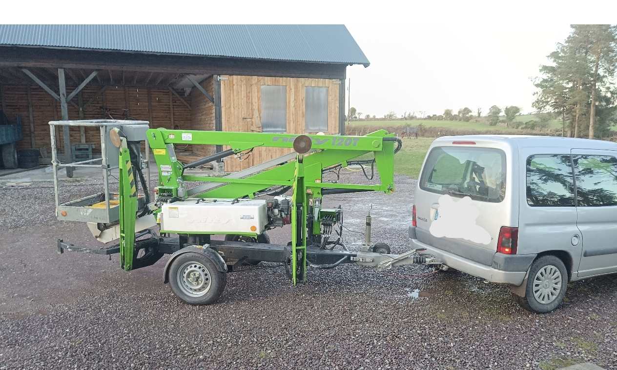

April 2Apr 2 If you've got a reasonable head for heights and are willing to take your time and be careful you can do it yourself. Tree surgeons are charging around €1500/day near me for 2 men and a chipper. This was I think €175 per day. It's 12m reach but that's pretty much straight up so it's hard to chop anything higher than 9-10m without it falling near the base. For your situation an 18m machine would be ideal.. Keep the cuts reasonably small and you won't go too far wrong. Get tempted to reach out cut something big that you can't quite control and it'll bite you. Trees are dangerous, we all know that but don't be too swayed by the "can't do that mate" "need a pro mate", "Need to pay a weeks wages for a days work mate". If you're sensible and confident have a go yourself. Edited April 2Apr 2 by Iceverge

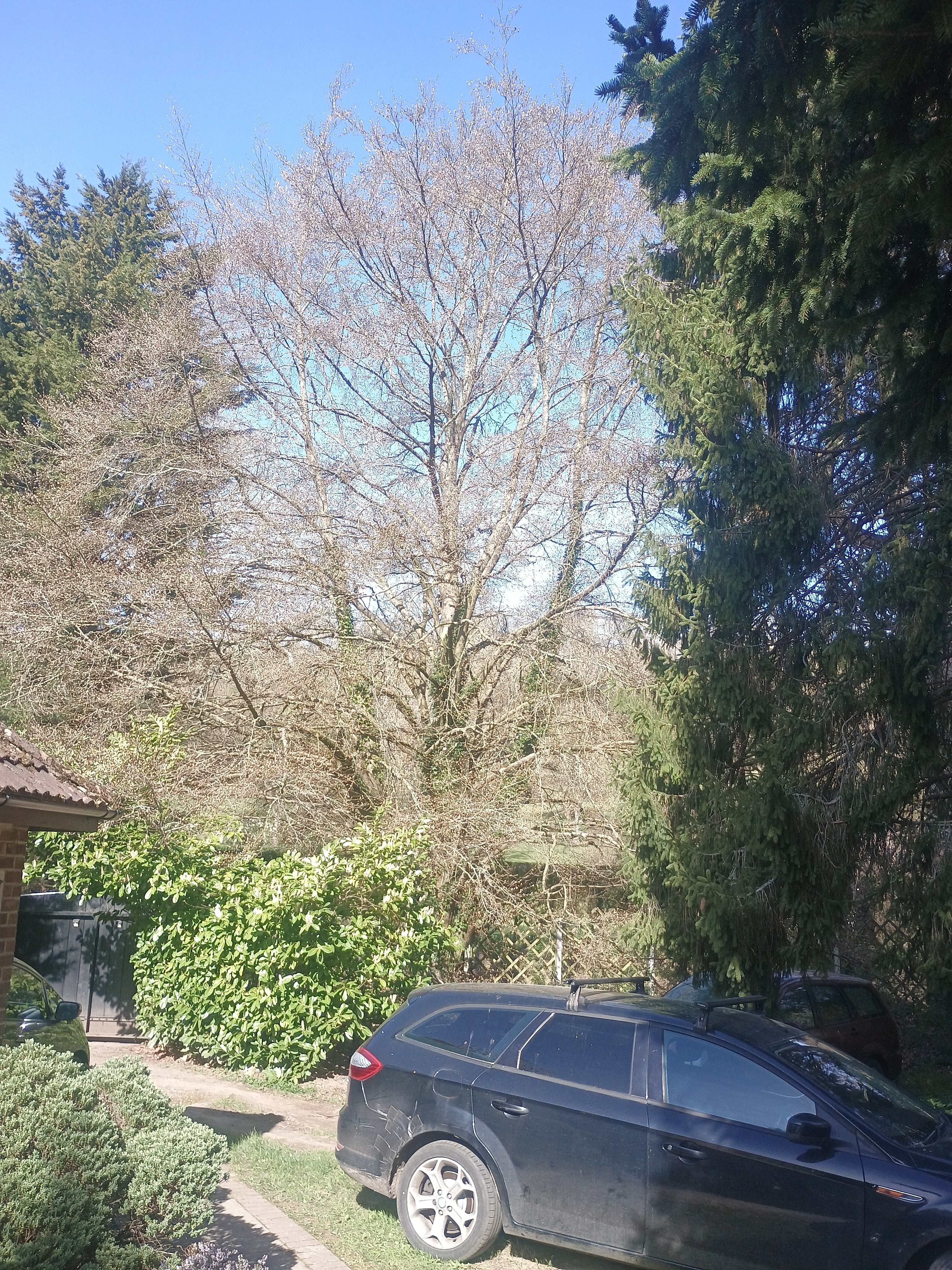

April 6Apr 6 I have a mate, a slightly special, albeit fully qualified and insured tree man. He's itching to sort all my trees out which is happily let him do but for the cost even at mate's rates. My beech is immense!
