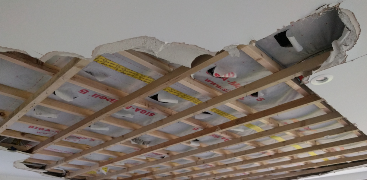

March 13Mar 13 Hello all its been a few years. I hope you are all doing well. Managed to reactivate my account and hoping you clever people can help me once again. I have an MBC house, single storey, flat roof. During the January storms snow blew into the void between my ‘warm roof’ (the MBC flat roof) and the decorative shaped cold roof that sits on top. The snow melted and water down through the ceiling. Insurance repairs, freak event. Top roof has been checked all sound the problem is from the snow melt in the void. Insurance appointed builders will do all the building side its just the insulation part we need help with. My flat roof has no access into it we need to cut out plasterboard to access. There is just the service gap approx 40mm below the VCL and insulation. I have circa 500cM depth of pumped in loose cellulose insulation that has been wet and Im told will need to be replaced. An area of approx 1sqm but until exposed we cant be sure of extent. I contacted MBC to see if they could help with this. Their tech manager was helpful told me the VCL would need to be slit, the damaged insulation removed, new pumped in and vcl taped and sealed. He said MBC could give a price for the work etc. I passed his details to the builders and almost 2 months later we are no further forward. Finally today they had feedback from MBC to say they were not able to help and the tech manager is now on holiday so I cant contact him to find out why they have now said they cant help. I cant get my house repaired until I find someone who can deal with the insulation part of this. Beyond frustrated as you can imagine. Has anyone got any suggestions of contractors who can do the MBC cellulose type of job who could help with this. As I say its insurance job so costs covered by them not me. Im in the Midlands UK. Many thanks Lizzie

March 14Mar 14 17 hours ago, lizzie said: Hello all its been a few years. I hope you are all doing well. Managed to reactivate my account and hoping you clever people can help me once again. I have an MBC house, single storey, flat roof. During the January storms snow blew into the void between my ‘warm roof’ (the MBC flat roof) and the decorative shaped cold roof that sits on top. The snow melted and water down through the ceiling. Insurance repairs, freak event. Top roof has been checked all sound the problem is from the snow melt in the void. Insurance appointed builders will do all the building side its just the insulation part we need help with. My flat roof has no access into it we need to cut out plasterboard to access. There is just the service gap approx 40mm below the VCL and insulation. I have circa 500cM depth of pumped in loose cellulose insulation that has been wet and Im told will need to be replaced. An area of approx 1sqm but until exposed we cant be sure of extent. I contacted MBC to see if they could help with this. Their tech manager was helpful told me the VCL would need to be slit, the damaged insulation removed, new pumped in and vcl taped and sealed. He said MBC could give a price for the work etc. I passed his details to the builders and almost 2 months later we are no further forward. Finally today they had feedback from MBC to say they were not able to help and the tech manager is now on holiday so I cant contact him to find out why they have now said they cant help. I cant get my house repaired until I find someone who can deal with the insulation part of this. Beyond frustrated as you can imagine. Has anyone got any suggestions of contractors who can do the MBC cellulose type of job who could help with this. As I say its insurance job so costs covered by them not me. Im in the Midlands UK. Many thanks Lizzie I can PM you Gordon Lewis’s number if you like? He does the majority of MBCs cellulose work. Maybe you can get him to undertake the whole job, as he’s capable of cutting into and reinstating the airtight layers.

March 29Mar 29 21 minutes ago, SteamyTea said: Some of this blown cellulose (chopped newspaper) has a binder in it (blown in wet). I would think that would be almost impossible to suck out. But look on the bright side the heat capacity will go up. Some say that is a good thing (I disagree). Goes in bone dry. Comes out with more enthusiasm than you’d ever want. A Henry would remove it in seconds. I’ve had to chop into a few MBC homes retrospectively and it’s a pig of a job, especially ceilings, as the second you cut the AVCL you’re wearing two bin bags worth of it. Not so bad with walls where it’ll stay put, if you’re very careful.

March 29Mar 29 19 minutes ago, SteamyTea said: Was a decade ago. Not saying I am certain, just seem to remember it being mentioned at the time. Easy way to find out is to pull a fill hole plug out and see. Sometimes it is quicker just to try things out than constantly speculate. No need to I’m on these projects full time so the last time I had to do this was less than 2 years ago. AKA “hands on”. On walls it’ll stay put, give or take a few handfuls, but if it’s overhead then it’s going to drop out like confetti. Removal is simple with an AVCL, as you just make a 2” incision into the membrane and poke Henry’s pipe in there and keep sucking and swinging the hoover pipe about until you’ve got the worst of it and then open up a section. From there you can go to a dustpan and some bin liners.

April 1Apr 1 Author Thanks all for helpful comments as always. My very grateful thanks to Nick from Wales for pointing me in the right direction. I'm all sorted now. Ceiling reinstatement next week and decoration to follow then all good as new. Have a good Easter all. Lizzie
