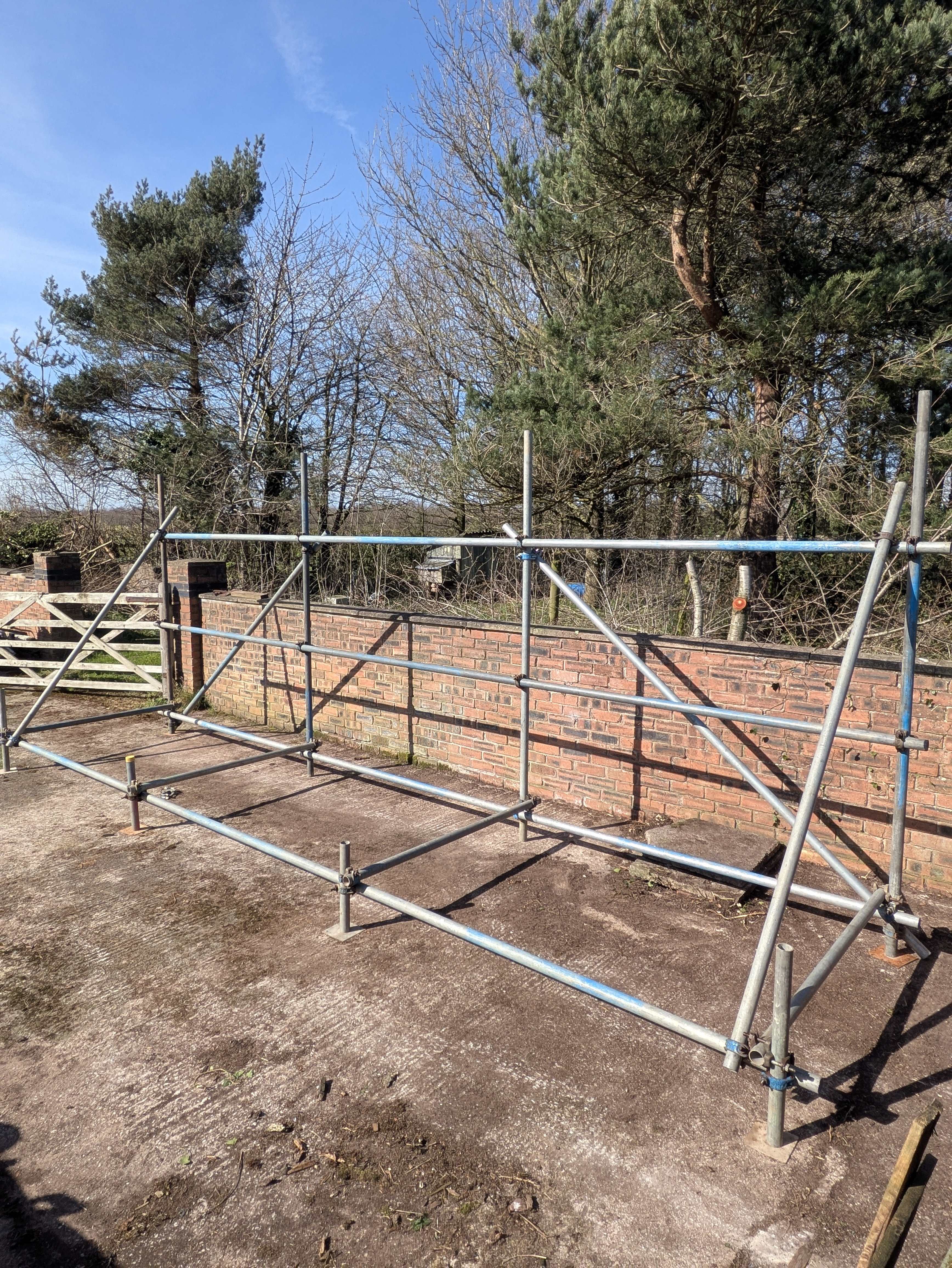

March 17Mar 17 20 hours ago, TedM said: I'm going to try and copy that if you don't mind! Ha! I copied it from a plan I found on the Interweb for a kit you could buy! I searched a few days ago to see if I still had the pdf but couldn't find it. Should be pretty easy to create a plan from the photo I posted though. We used bits like below to fasten the panel clips to, you can probably see from the photo if you zoom in. Think we bought the panel clips from somewhere like Midsummer Solar - but there's probably plenty of options on ebay. Give me a shout if you want any more info. One of the advantages of key clamp for this is that most of the suppliers have a free cutting service, so it all turns up ready to put together. If you've never used them before, then it's best not to tighten things up too tight to start with, then adjust to get it all lined up properly and then tighten the screws up. Have fun. Edited March 17Mar 17 by Bramco

March 18Mar 18 Author Frame starting to go up. Two diagonals and horizontals (ledgers) still to be fitted which the panels will clamp to. I'll need to alter a few bits after they've gone but it's much easier and quicker than doing it myself! 😁

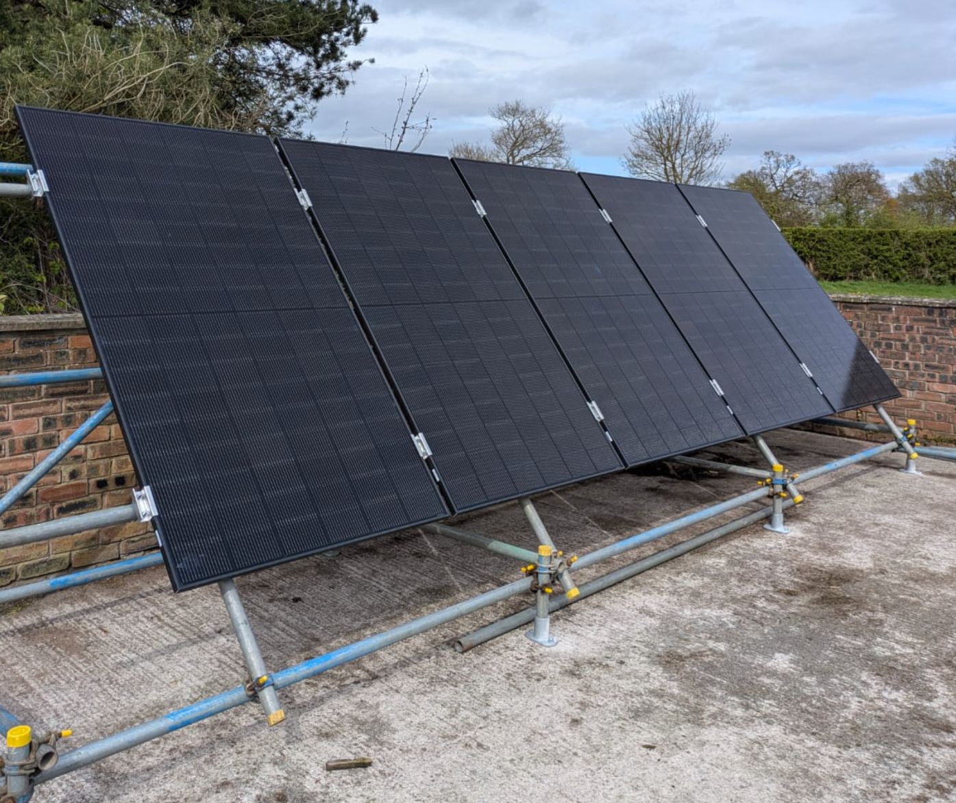

April 16Apr 16 Author Well it's been a while - mostly because I've been at our other place ripping out the kitchen! Anyway, panels arrived this morning 👏 It took a while to alter the frame slightly so the panels were clamped in the right places - and then to figure out how best actually get each panel onto the frame singlehanded without breaking it or me 😩 but once the first panel was on (and level) the others weren't too tricky. Now to get some 6mm cable 👍
April 20Apr 20 Author 13 hours ago, Beelbeebub said: How did the clamps work out? They're OK. I actually bought directly rather than through eBay which saved some money. They need the panel to be a minimum of 35mm thick but mine are 30mm so I put some plastic spacers between the mounting pole and the back of the frame which worked well. The clamps on the end tend to sit at a bit of an angle [as they seem to be a bit better with a panel on either side] which isn't the best but the mid-clamps work well.
April 21Apr 21 @TedM, In your latest photo, is that shading by the wall of the lower right corner of the furthest panel? This will reduce the performance of the whole string at that time of day. You seem to have around 0.5m of spare frame to the left of the panels, so could they not all move over, or are there other shading issues?
May 4May 4 Author On 21/04/2026 at 18:08, BotusBuild said: Looks like a reflection I think Well you're both right! What you see there is a reflection from the wall, but there is a small amount of shading until about 9:30am in mid-April - this time will become earlier as the sun rises earlier/higher. Yes I could move the panels left a bit but it would be a royal pain in the a**e to do mostly because of the clamps and spacers I've used. If I feel the need I'm more likely to remove the concrete bolts holding it all down and drag the whole frame left a bit. BUT just to the left of the array is a gate that opens onto the frame.... So the further left I go the less the gate can open - which is an issue as I need it to open fairly wide so I can get my boat in and out of the barn that's in front of the array [only twice a year though]. I had given a small amount of thought to putting an optimiser on that one panel but I'm not Ure it would be worth it or even work! Anyway, I finally got round to finishing off all the DC cabling today through surface mounted conduit over the concrete yard and then up into the barn and along the roof steelwork to the inverter, AC isolator and into the barn consumer unit via an RCBO. Total run of about 45m each way The inverter has a DC isolator built in and I'm not sure whether I need to fit an external one as well - I had read that it's another point of failure and wasn't really needed if the inverter has one. Edited May 4May 4 by TedM
