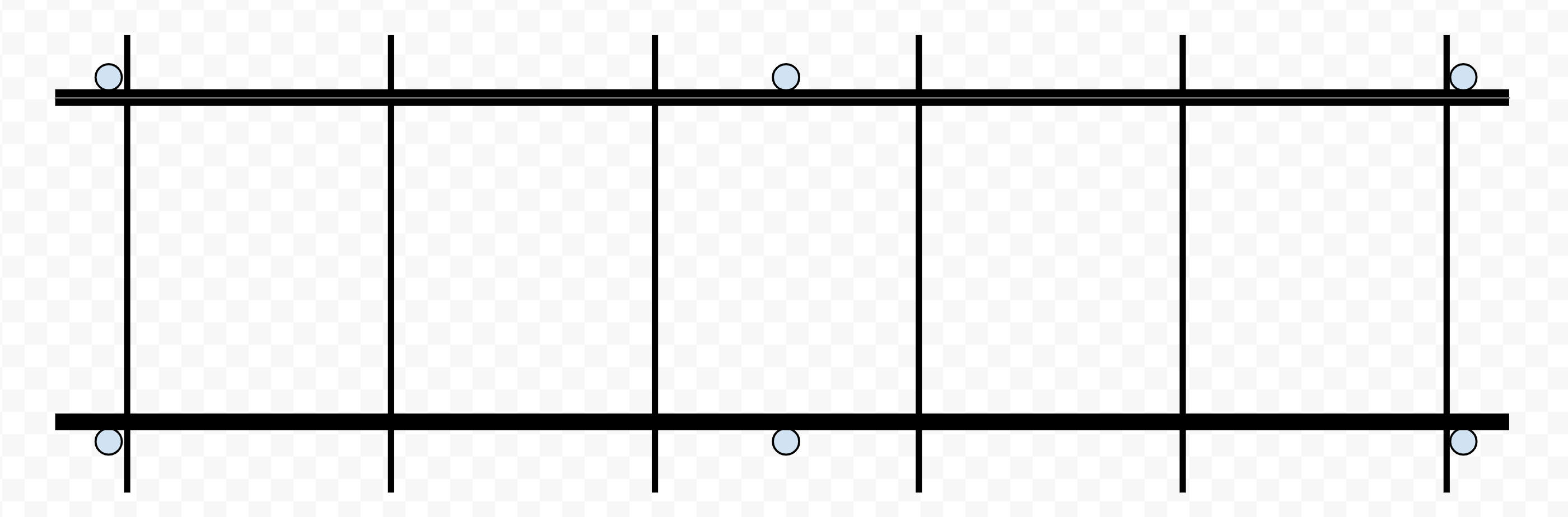

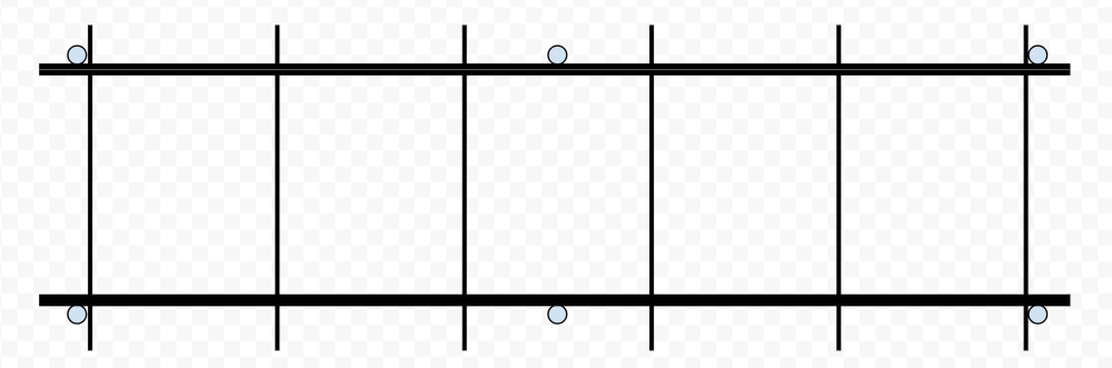

You need to make sure that you add enough support to the unistrut rails with the scaffold poles - a proposal sketch would be useful.
If you have large overhangs with unsuported unistrut then use 41 x 41mm unistrut instead of 21 x 41 mm.
I'm actually swinging back towards all scaffold pole construction using those ebay clamps (price comes down when you buy 12) as it will handle overhangs better and the poles are free.
I'll see about doing a sketch.
Edited by TedM
Something along these lines.
Front will be around 500mm high and the back will be around 2000mm high (whatever to give 45-50 deg angle).  There will be two diagonals on the rear uprights for bracing.

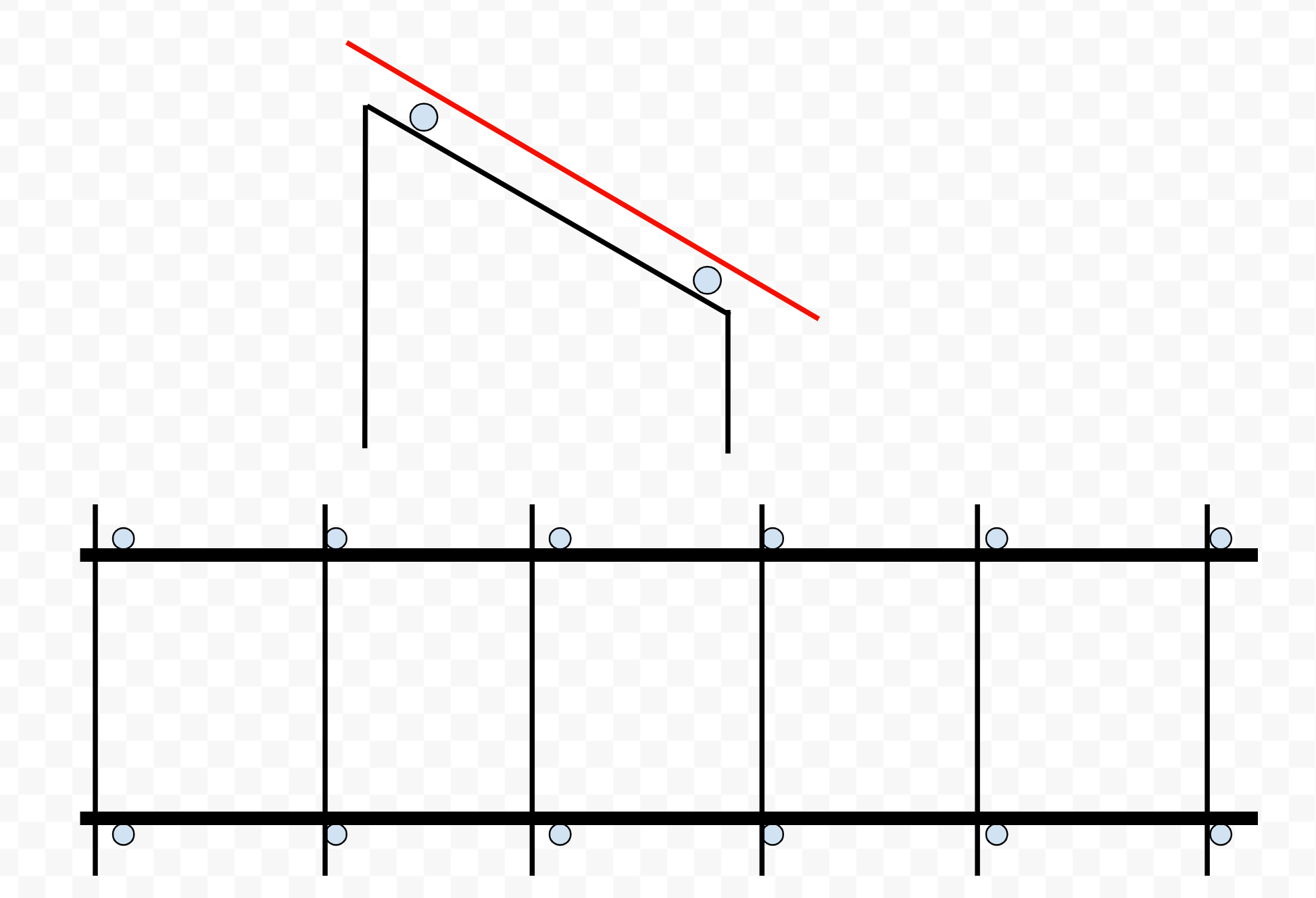

I have literally no idea why I drew the ground mount like that..... so many uprights!! 🤦‍♂️
This is how it's actually going to look with just 6 uprights - 2m between each set should be fine, but I can always ask my mate who owns a large scaffolding co (hence the free poles 😉)

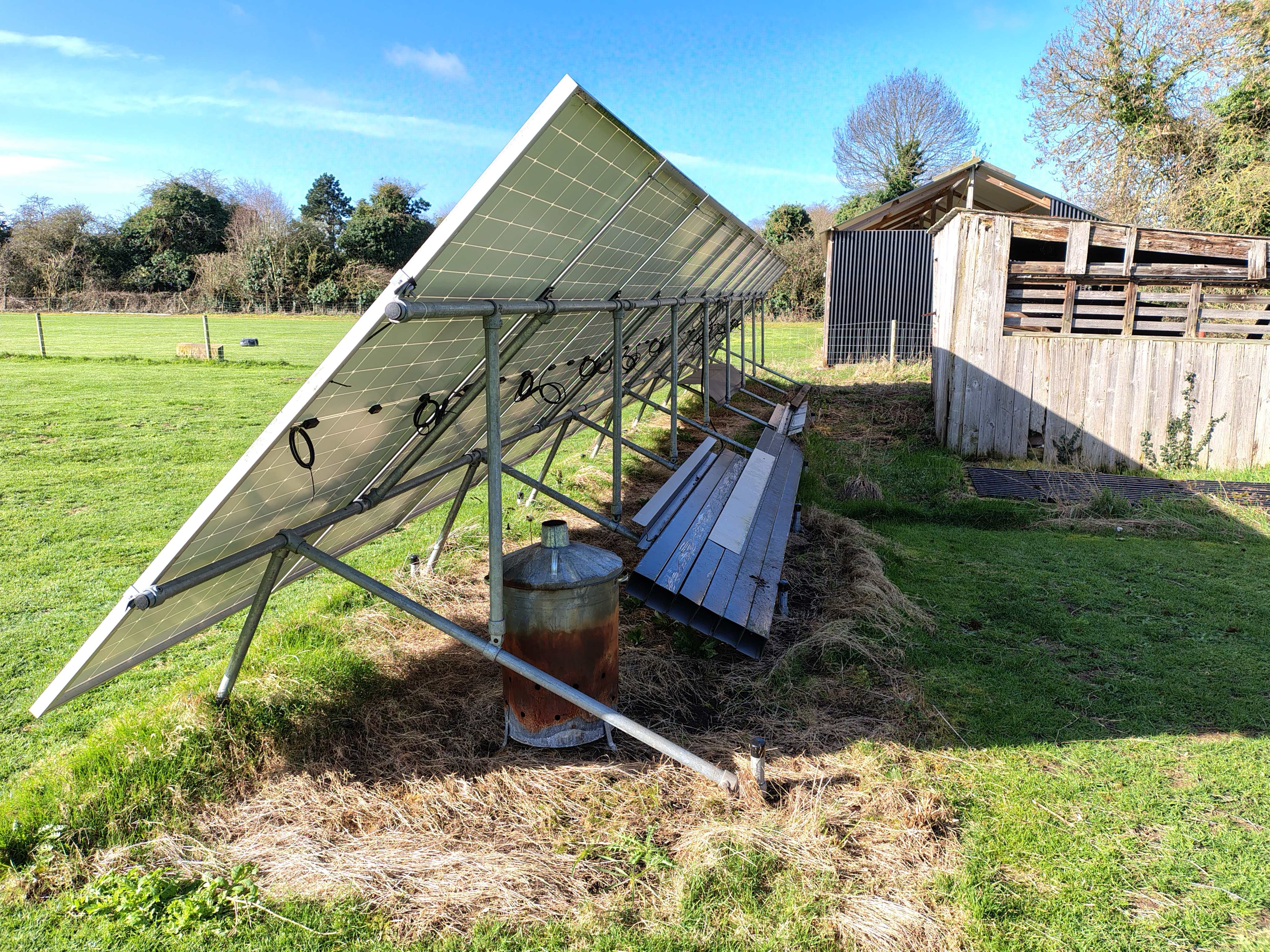

In true Blue Peter fashion - here's one we did earlier...
Ours was all done with standard key clamp bits and some solar panel clamps.  Can't remember who we used for the poles and clamps but we did work out how many of each length of pole we needed, so they were delivered ready to start construction.
The poles in the earth are 1m long, whacked in by our builder for a flat pack of beer...
EDIT - should have added that we set the panels at 45 degrees to maximise winter output rather than the 35 degrees that PVGIS suggested. The actual annual total for 45 degrees was only just under the PVGIS 'optimum' but output was shifted away from the summer towards the winter.

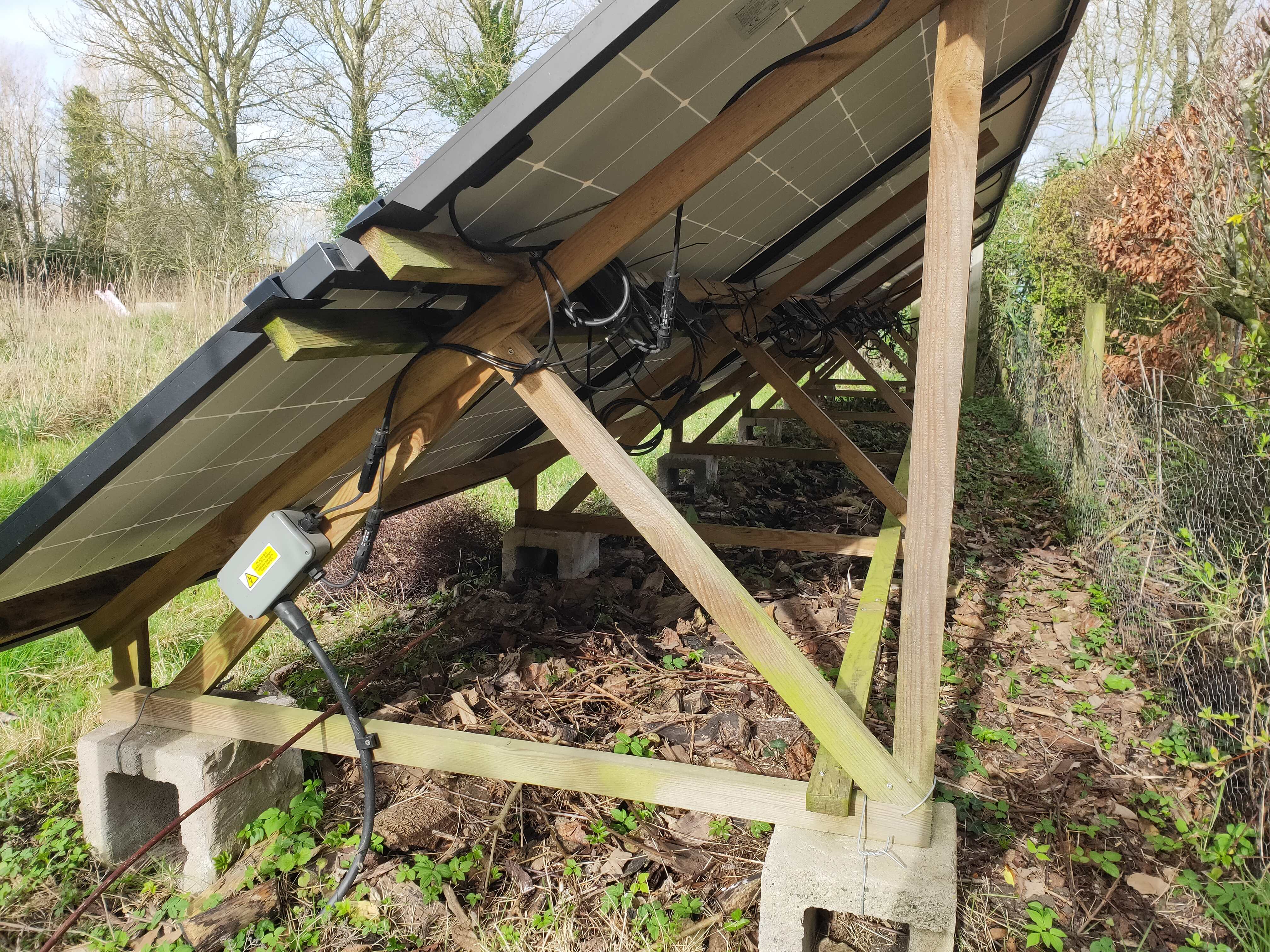

Here's a roofing batten version. Old hollow concrete blocks set in the ground keep it all on the floor and have done for 3 winters so seem OK. Under £100 for batten, panel clamps and stainless screws.......already had the blocks, DPM and fencing wire for diagonal bracing

I'm going to try and copy that if you don't mind!
Looks like it should give good access to the back of the panels - there's a wall at the back of mine but I want to get in a keep under the panels fairly clear.

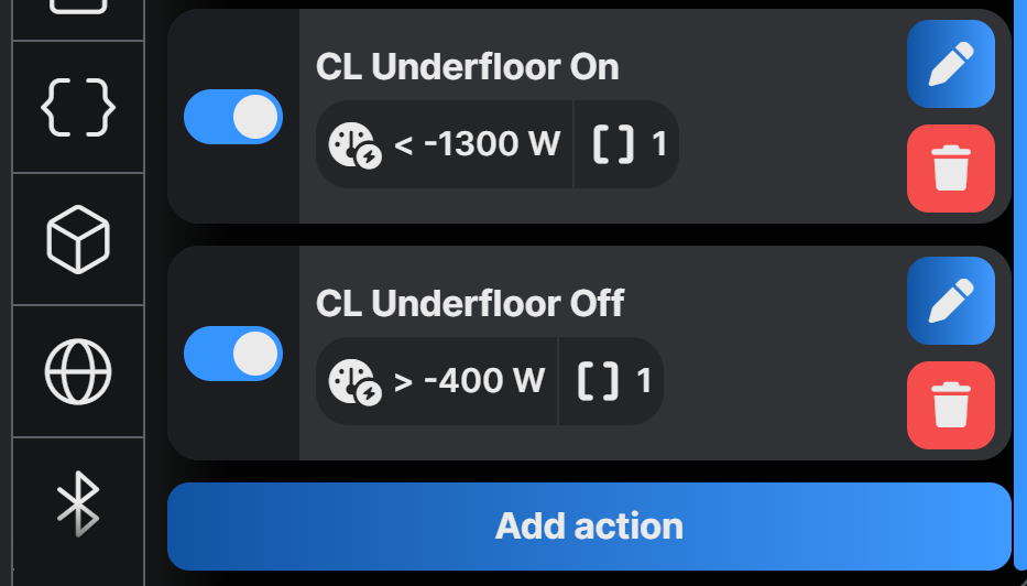

There's an Immersun that heats a 250L Megaflo after which spare power will go into the electric unfloor heating in the kitchen which takes 2kW when it's heating.
I also have electric underfloor in the bathroom plus a few electric heaters around the house all of which are controlled by Shelly relays.  I have a number of Shelly Actions set that will switch various devices on and off depending upon how much power is being exported - such as this one:
I've also got another E/W facing array that gets the original FIT payment (for every kWh it generates) I'm not bothered about exporting anything really.
