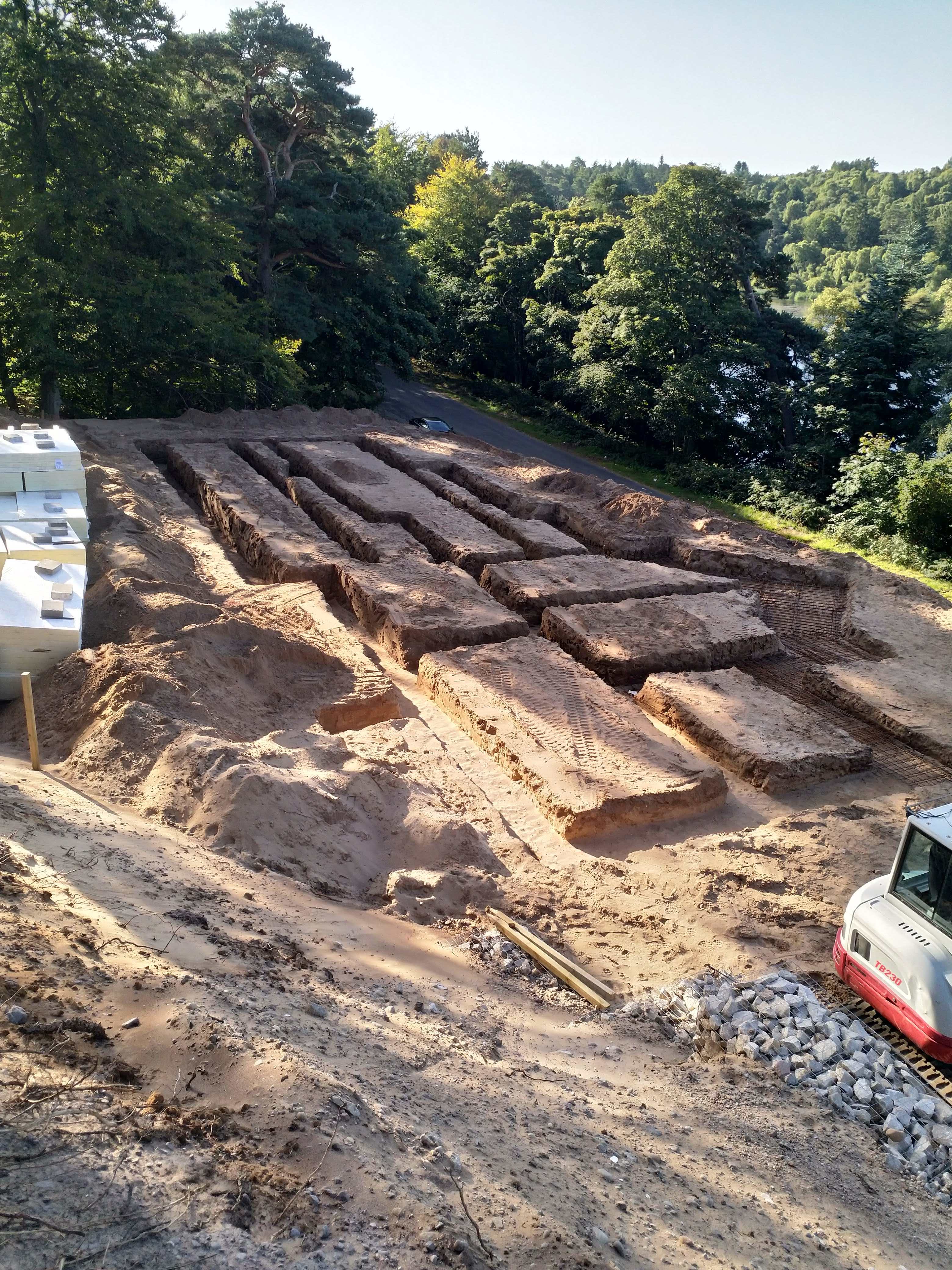

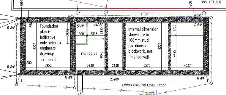

My original plan here for excavating the footings is as follows.
1). Pull the North footing to depth.
2) Pull the 6 vertical footings to within 1.5m of the South footing
3). Pull the south footing
4). Join up the remainder of the vertical footings with the south footing
If I do this or do get the groundworker to do this, it would mean that the North footing will be exposed for a few days before the concrete is poured.  Would people do it this way or would you pour and shutter multiple times to avoid leaving footings exposed for a few days?

Here is what I would do if I was you.
Find the best and well repute self employed 3CX digger driver with their own machine that works local. Pay the extra. Get them round and ask them how to do it! Ask them how they want the found marked; inside, outside, centreline or all of the preceeding.
Assume the weather is going to be pish and some marks get lost by accident. Set some pegs well outwith the dig so if the marks get lost you can run a string line to get you back on track.
Work out what you are going to do if you hit soft spots. An experienced digger driver is going to be your best friend here. They may also say they will pitch up during the pour and can use the back actor to get the concrete in place.
Make sure you take plenty photographs. Be careful not to over dig. There are some horrible examples on BH where over dig happens and it just makes things ten times worse, they fill with water, hit even softer ground deeper down.
Go and have a look again at what your SE is expecting in terms of ground conditions. If in doubt ask. Ask your SE if they can be on the end of the phone or just come to site if you get stuck. Yes, I know you probably don't want to pay for an SE visit but at the end of the day it can save you a pile of worry and cash.
You only get one real chance of making a good job of this so don't take daft risks. Take time placing any reinforcement mesh.. many ground workers just fling it in.. and you pay for it.. but it is worse than useless if not properly placed.

What I would do now.
look for an experienced owner operator who has his own 5 tonne smallest 8 tonne nicer digger, he will have his own transportation or know a company that brings his machine to site.
he will probably have a mate who helps.
you can find these on a Facebook site called 8 tonne and below.
you will need a surveyor or you ( surveyor best ) to set everything out all pegs in the ground ready.
you need a 3 tonne dumper minimum.
you need 2-3 muck away companies in your phone who you have chatted to.
you need building control to have been notified and ready to inspect as soon as you start.
you need to have priced concrete and have it all ready just waiting on a phone call
you need a concrete line pump for the pour day.

I eventually found a chap with a nice 2022 3CX JCB.  He graded the whole site today and has told me he'll pull the footings in 2 days next week.

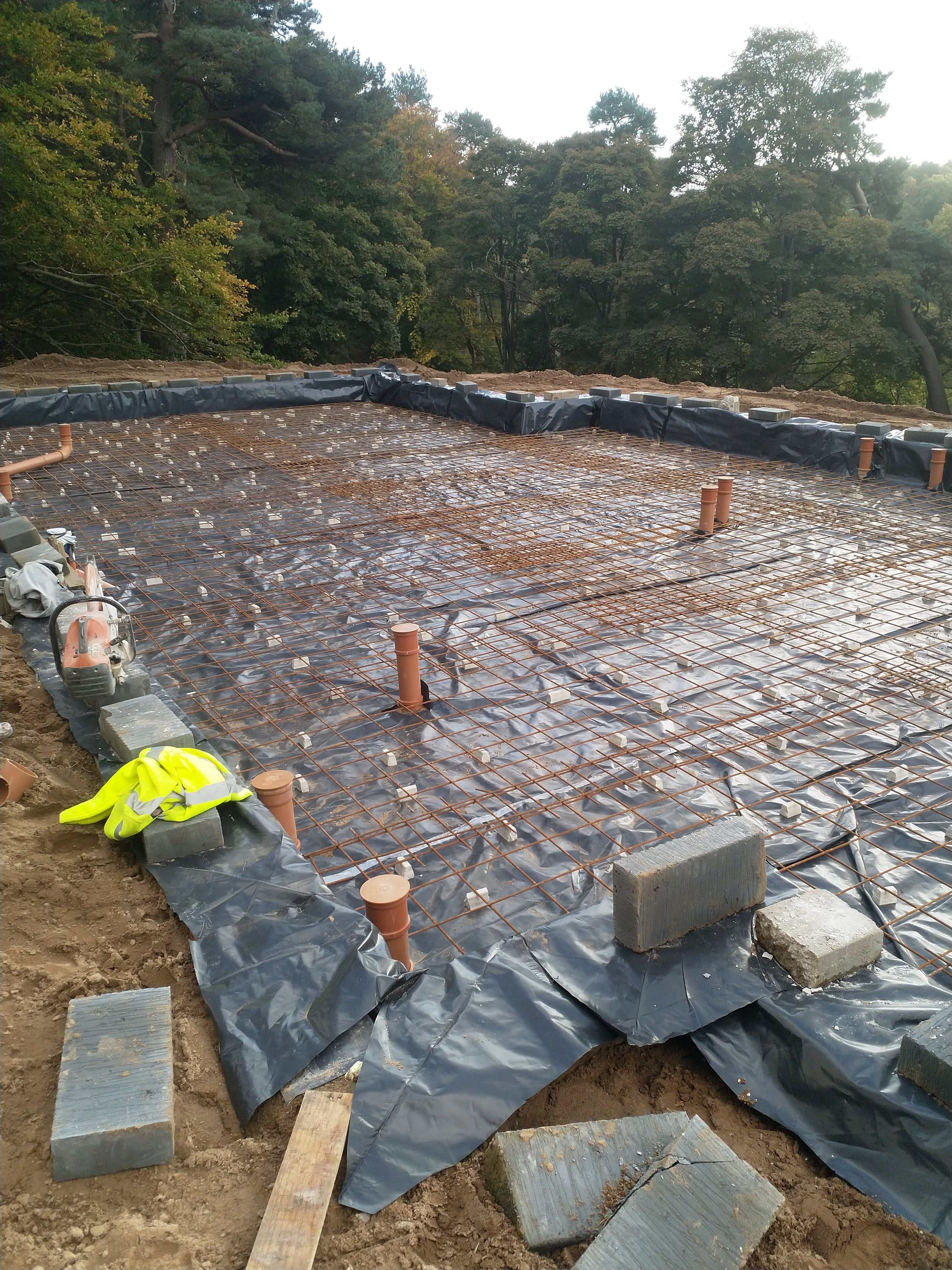

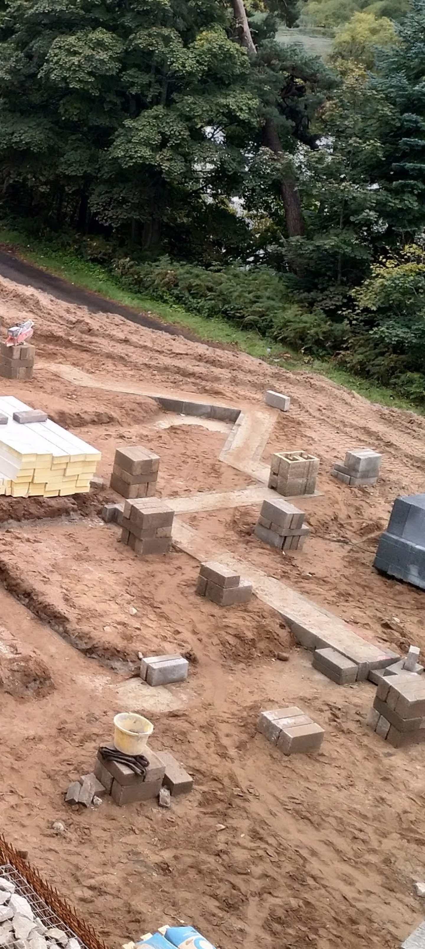

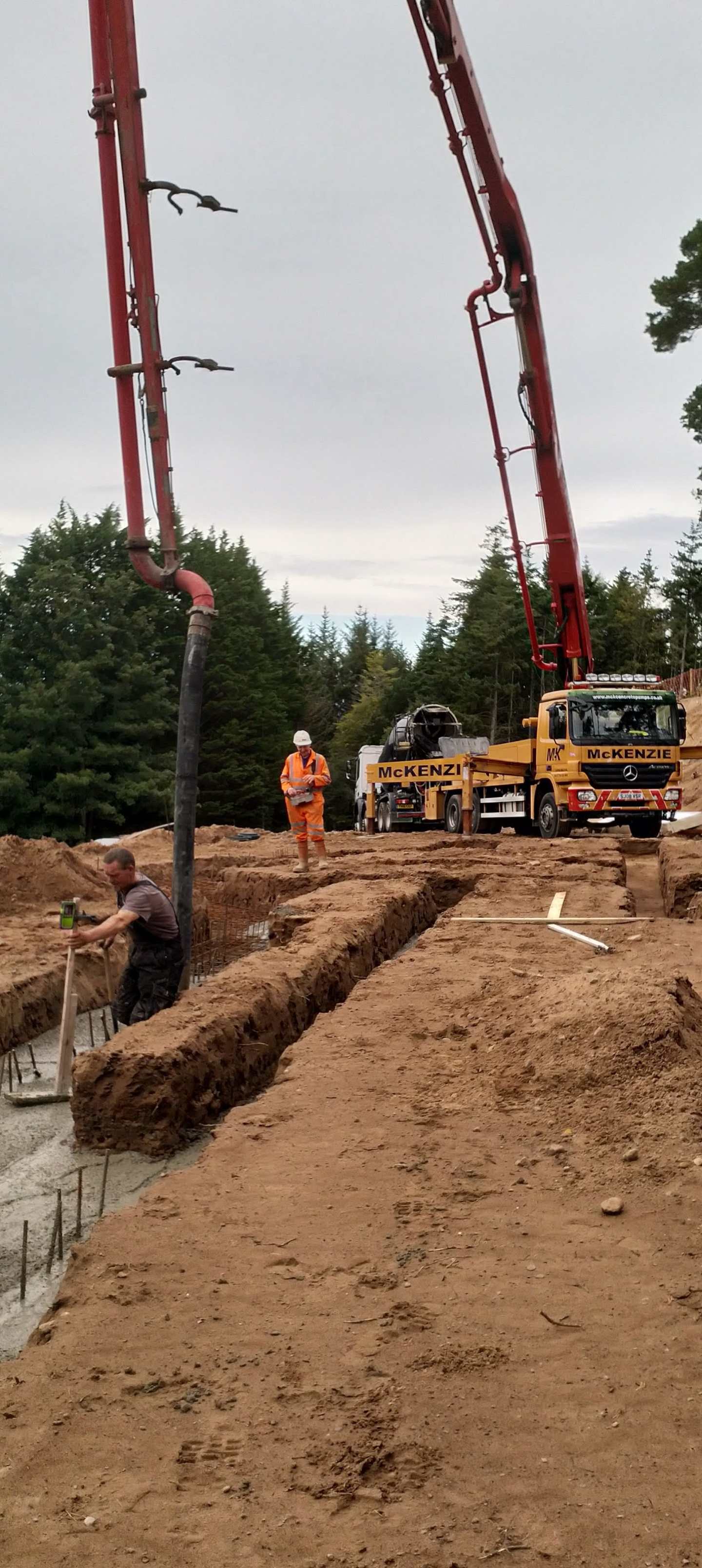

We used a pump lorry - we had a stretch of 30m with no real access any other way.
IMG_20200912_095106.thumb.jpg.aea1c6b3067c9059ba983f70d2700425.jpgScreenshot_2026-03-11-21-58-48-14_965bbf4d18d205f782c6b8409c5773a4.thumb.jpg.51169de0eb5e0d6787c237fc782d841a.jpg

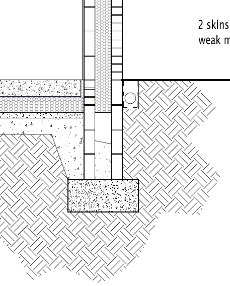

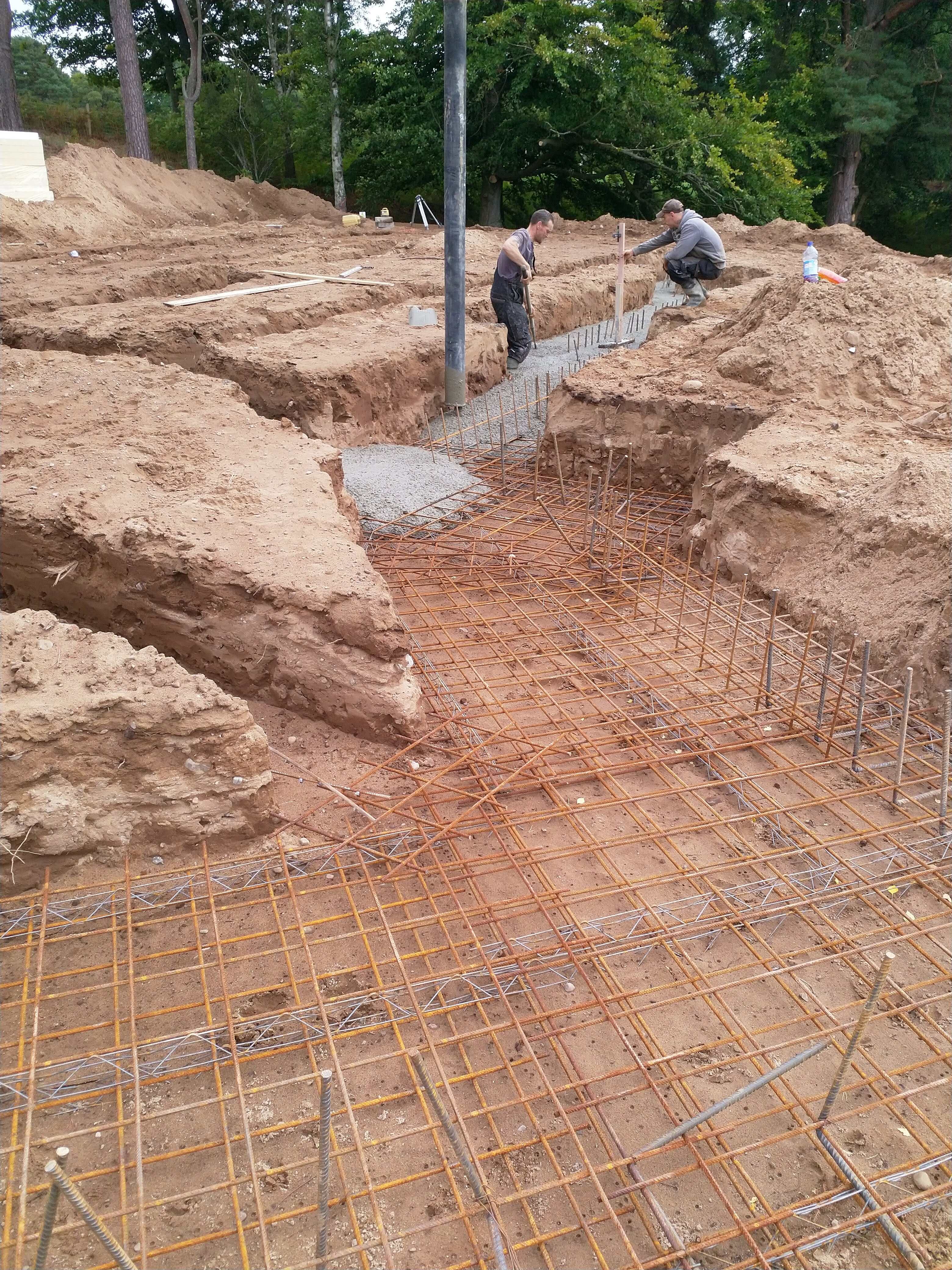

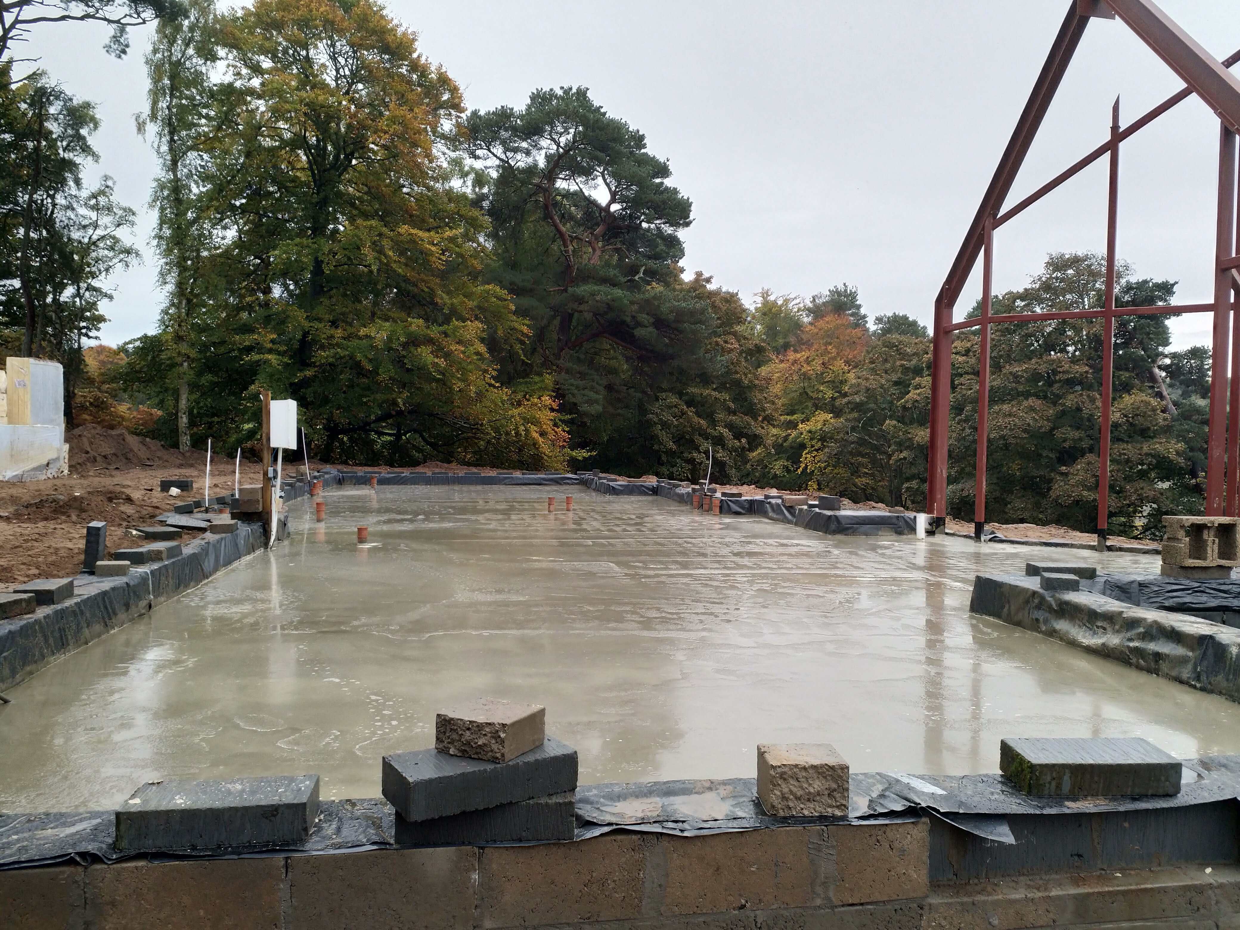

Can I ask why you had the vertical rebar in the foundations?
It's a complex foundation by normal standards, due to being on the side of a hill.
There's also whole heap of horizontal rebar below that, plus another cast vertical section 500mm wide of concrete foundation to go at the front of the house. The vertical rebar is to join the two sections together.
Screenshot_2026-03-12-06-02-46-19_965bbf4d18d205f782c6b8409c5773a4.thumb.jpg.232e43c34c44d71d403040e80e2933e5.jpg
Then more rebar (2 layers) and a 200mm cast concrete slab.
3 days later
Then 200mm.of insulation, UFH and another 100mm of fibre reinforced concrete instead of screed.

I would want building inspector on site as soon as you have a 5 m length pulled to full depth, you will quickly work out if it isn’t deep enough, agree a depth and carry on, get the inspector to pop back before the end of the day or first thing the next morning.
ask your jcb driver what he normally does and what is normal for the area.
pump wise a line pump is cheaper, but will need moving manually during the pour, the lads that come with the pump will do that, a boom pump the one in johns picture is dearer and a lot bigger but doesn’t need the pipe moving during the pour as it’s all done by the operator using his remote control.
do you have a foundation section drawing as it doesn’t sound like a lot of concrete, are you having too many courses of trench blocks.
Just had a look at your original post, that’s about 80m of trench without looking too closely are you only putting 500mm of concrete in the bottom, if so then you will have  loads of blocks up to floor level.
this is normally an expensive way to do it instead of more concrete and less blocks.

I have started to realise that using the TA recommended by my brother in law was not the best decision.  He has drawn the footings as below (300mm strip)
My plan is to increase the depth of the footing by another 225mm.  This means I would have effectively 3 courses of block below FFL.  I want to avoid having to put soil pipe through the trench and ideally want to have the pipe go through the blockwork via lintels.  Otherwise, I need to get some oversized pipe in place for when we pour (next Friday).
The invert level of the lowest IC is 550mm below FFL, so I cannot go too shallow, otherwise, I will have to put the soil pipe through the trench footing.

Plan was to pump the footings in one go.  24m3 of concrete. Is this not possible?
1 hour ago, saveasteading said:
Ahhh. That depends on so many other factors.
Also note the cost of several visits with pump hire.
Why several visits, mass pour the foundation in one hit, then decrease the blockwork.
30 mins per truck to unload into the pump.
So, on that basis it should be viable to pour in one hit
