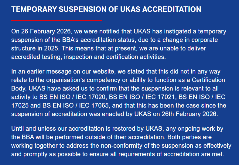

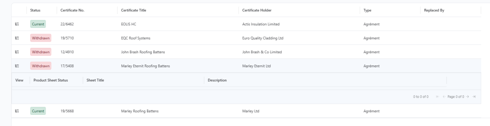

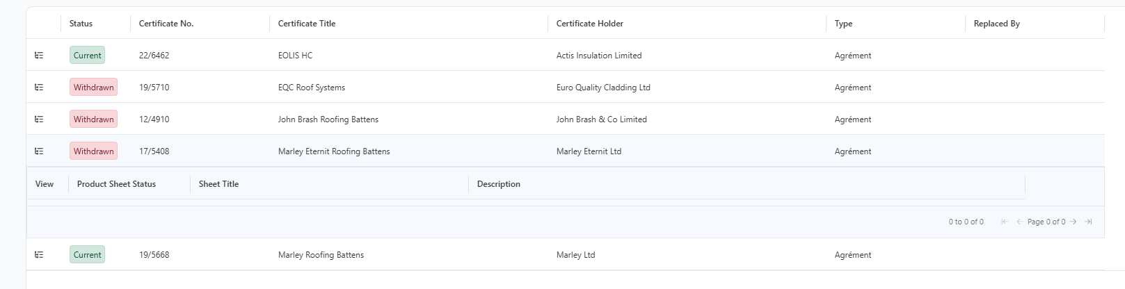

Alan Ambrose Posted Monday at 08:02 Author Posted Monday at 08:02 In my search for longer lasting battens, I called the guys above, who say those are no longer available. I also called Kedel re their plastic battens: 50 x 25 Roofing Battens, Recycled Plastic Battens ... to ask whether there's any BS5534 adherence/ certification. They'll get back to me. In the process, I looked at the BBA site. Oddly, there's this weird note (below). WTF does that mean, and who are UKAS - I mistakenly thought that BBA were the authority. To add a little spice I see on the 'myBBA' search that only Marley has a current BBA cert for their battens. ?
Alan Ambrose Posted Monday at 08:04 Author Posted Monday at 08:04 p.s. maybe this is the explanation, but does it not then leave the building industry up the creek? Inside Housing - News - UK certification body for construction products has accreditation suspended
andyscotland Posted Monday at 10:31 Posted Monday at 10:31 2 hours ago, Alan Ambrose said: In the process, I looked at the BBA site. Oddly, there's this weird note (below). WTF does that mean, and who are UKAS - I mistakenly thought that BBA were the authority. BBA are an authority that certifies building products (the most common/accepted one, but technically speaking not the only way to prove that a product meets standards). UKAS are the authority that certifies anyone that wants to be an authority in testing/certifying/calibrating in any market. They basically check that organisations have the right governance/systems/processes in place to be trustworthy. So e.g. you might have a bolted structural fixing that has a BBA certificate, and install it with a torque wrench that has a manufacturer/tester calibration certificate from some other UKAS accredited organisation. It looks like the BBA issue is a paperwork technicality - likely BBA just need to update some documents or it may be that their corporate restructure means they're technically speaking a different legal entity and therefore need to be reaccredited by UKAS even if nothing much "on the ground" has changed. So I'd imagine it will be resolved before too long. 1
