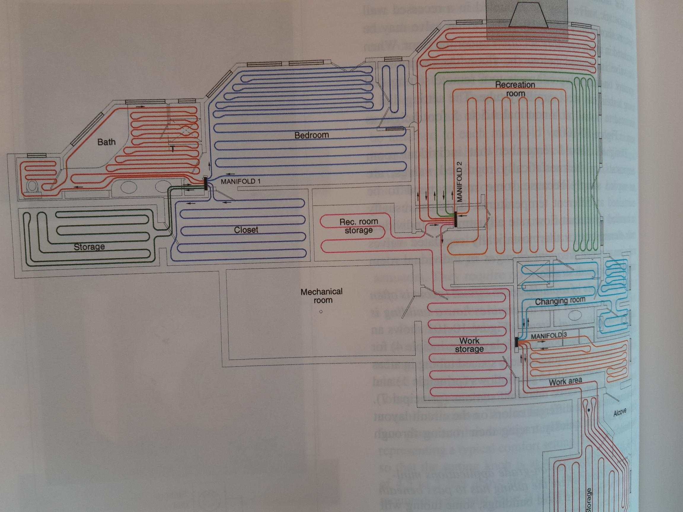

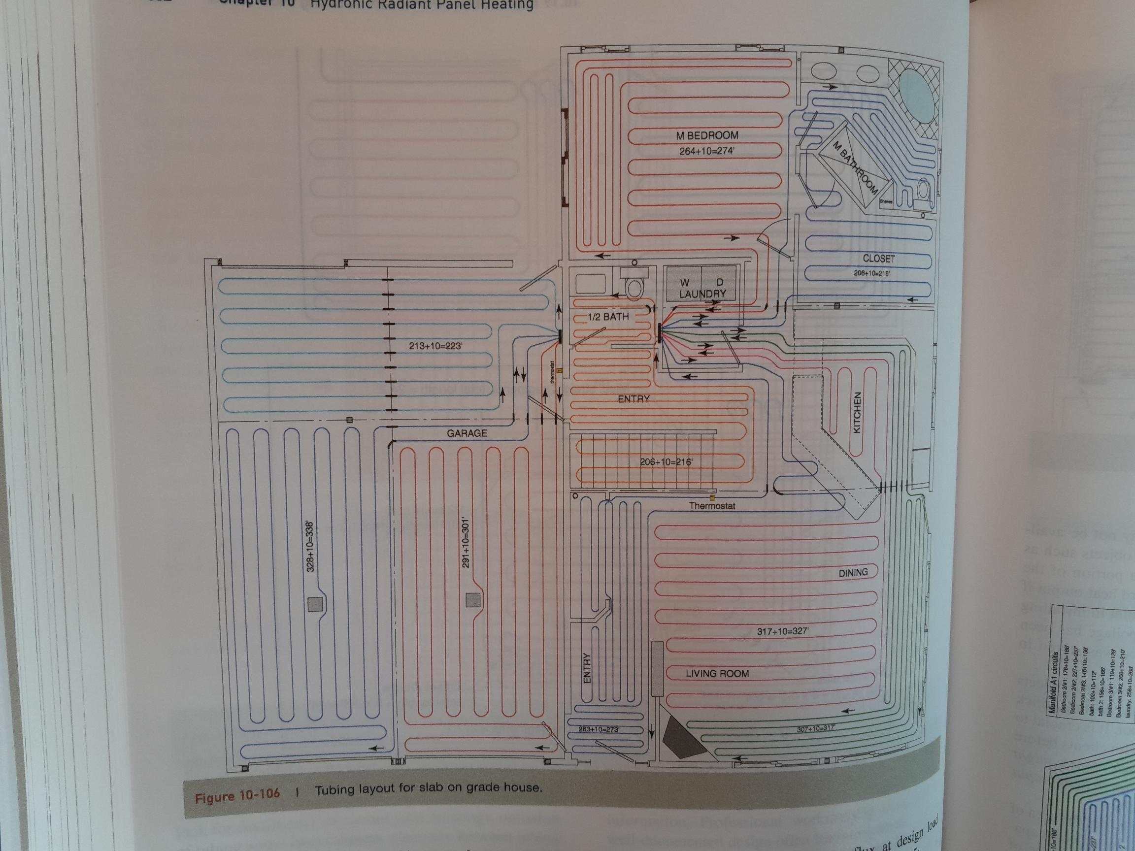

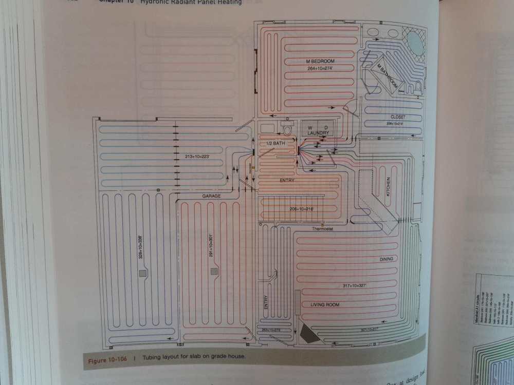

March 6Mar 6 On 04/03/2026 at 18:50, Great_scot_selfbuild said: @SimonD I'm interested in doing my own calculations on this. Whilst I head off and do some searching, can you help me expedite this by directing me to any resources / reference material that takes me through the process specific to sizing UFH to a room / heat loss etc? It sounds like this should be a lot easier than trying to dig out my thermodynamics notes from 20+yrs ago (I hope... never was my favourite, but now I'm more motivated 🤣). Yes, so the paper manuals and guides I used for all my basic training are (no great thermodynamics knowledge needed with these, thankfully 🙂). The underfloor heating design has lots of tables to referencing outputs and floor temps etc. and dovetails in the the CIBSE industry guide for sizing and designing heating system. The low temp guide has lots of easy win nomographs which can save a lot of time for ballpark figures: On 04/03/2026 at 18:50, Great_scot_selfbuild said: In an earlier post which evolve into a focus on the UFH layout / sizing I had actually asked about this - I was wanting to understand if I should be looking to tailor the UFH pipe spacing and design to each room, which largely received the response "it'll all end up at the same temperature, so don't bother" (I'm heavily para-phrasing). However, I do like to learn a new aspect of engineering and although I have no available time, I'll happily sacrifice some of my sleep to work this through myself. Would be grateful for a steer... (btw I did look up Rob Berridge and in the YouTube interview he mentioned that he provided training material but I can't find it; I've reached out to him, but no response yet). This links into the above question. As the output of the floor depends on pipe spacing, it seems weird that we can just discount that in design and just not worry about it? Output depends on the balance of several factors, including spacing flow rates and flow temperature all together. The calculation regarding the output of buried pipes is actually quite complex calculation, simplified here in this image: If you have significant transfer across the centre lines, then you're going to have problems with the balance of system output. Here is some images from a much more detailed hydronic books, which illustrate correctly varying the pipe spacing - look for example at where the spacing it closer at certain external parts of the rooms (this is also covered in the ufh design book above but to a much lesser detail: These and the illustration of pipe centre lines are from Modern Hydronic Heating & Cooling by John Siegenthaler. It has a very detailed section of UFH design, but the book costs nearly £100 and it's all in imperial so you need a way of looking up the metric constants etc. for SI unit conversion. HTH
