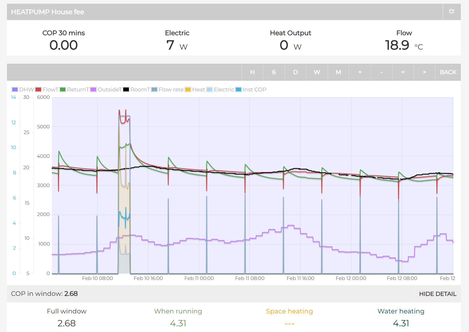

Interesting couple of days with the new heat pump.

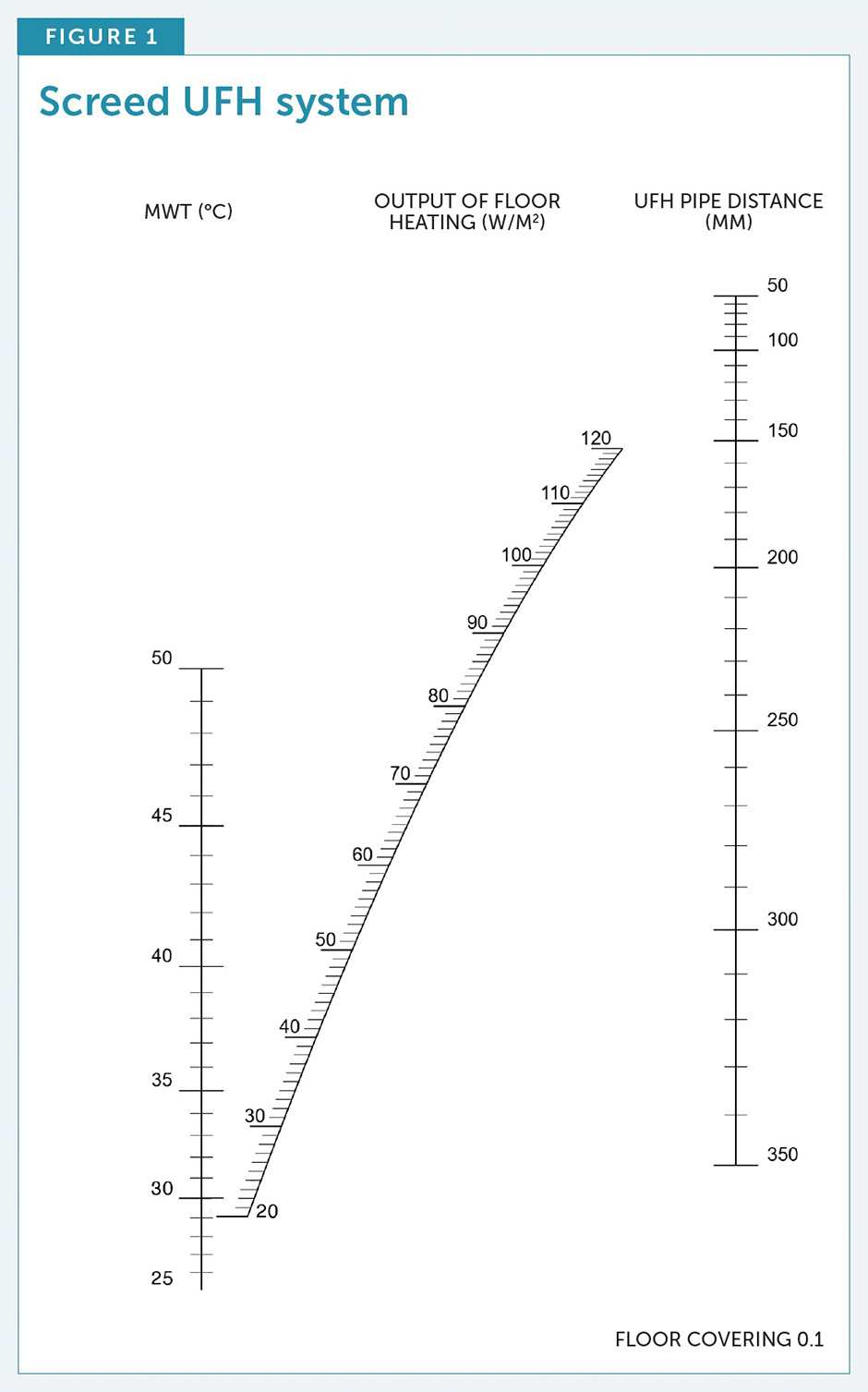

You can work it out knowing your heat loss and then W/m²
Just use this as a baseline, you may need to extend the W/m² and the MWT - mid way between flow and return temperature.

Mike, it looks very much as I'd expect, that is no surprises.  I did warn you about the consequences of the 185s before you poured concrete but that conv obviously went into the information overload bin, but this falls into the 'it is what it is' category rather than something that needs fixing.  The main consequence is that the flow speed is double what it would have been, with the increased circulation noise, and hit on your pump life.
Your return temp is still 5°C more than room temp, so the avg slab surface temp is prob 7+°C warmer than the room env, and so you are dumping ~100W/m2 from the slab into the house, which seems to be heating the house by maybe 5°C per day.  That's a hell of a lot for a passive class house, and you'll need nothing like that once the internal fabric is at target temp.
You might want to experiment setting the house set-point to say 18°C and let the system reach equilibrium, leave a day or two; then step up the set-point another °C; rinse and repeat.  That way you aren't going to be stressing anything too much.

Yes I recall now you mention it. To be fair the heat pump is, for the most part working well. The house is over warm now, so I have turned it off until I can get some more info from the manufacturer about controlling the curve. As it stands although I thought I had control of the two endpoints on the 'custom' curve I don't so I am awaiting an update on how to get control of it. I did think today, in the midst of my frustration with this, that now I have my MCS certificate I should just pop a Willis heater in to run it when the output required is less than the heat pump minima - how cheeky would that be?

Think you maybe over thinking stuff.
A heat pump cycling is a reasonably normal thing. If it runs for 10 to 15 mins it over comes any startup losses. As long as it's not 5 mins later you have no issues. Quick restarts are down to setting startup dT correctly. Don't get bogged down, thinking it's bad in mild conditions. It isn't.
Mike, one thing that you might try is get an idea of the time constant for the house at some point.  Heat the house to some set-point and keep it at that for a couple of days, then tiurn off the heating for 24 hrs, say, and track how the house cools.
We have low overall U-value loss, but high internal fabric total specific heat ("thermal mass"), so we lose maybe 1°C / per day with the heating off.  This means that we can shift the heating windows to pretty much any time that the electricity costs are cheap and make maximum advantage of a ToD tariff.

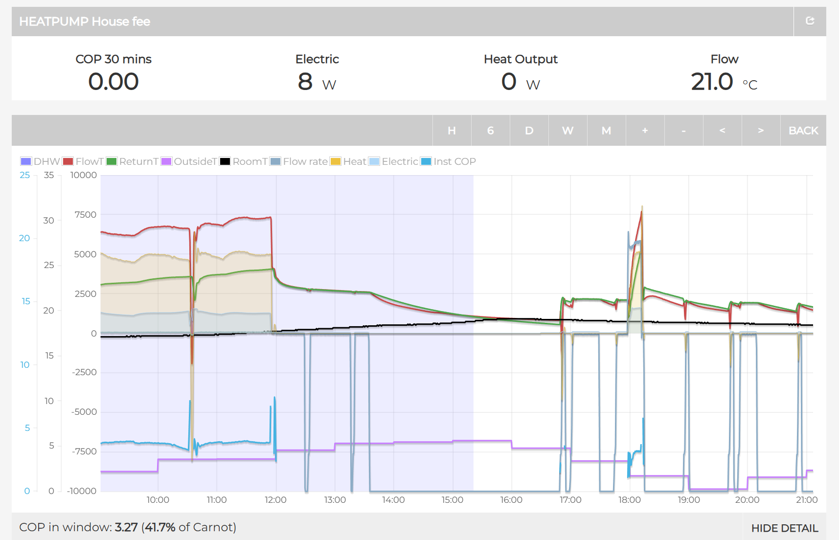

It's been a busy weekend family wise so have not had a chance to talk about any issues but you may have hit upon one I saw on Saturday. I was running with normal settings 28 degree flow and trying not to fiddle so as to limit the number of variables as @SimonD encouraged me to. (Remember I am not using WC as I cannot control the end points of the curve yet and I am awaiting a response from the manufacturer as to how to set them - hopefully tomorrow.) and for some reason at 12ish the system just stopped. Well when I say stopped I mean it stopped producing heat and just ran the pump.
Those dips at about 12:30 & 13:15 are me turning off and on again - making no changes. It was a sunny day so the room temperature is rising as is the outside air temperature (OAT) but the heat pump (HP) knows nothing of the Room Temperature and it has no 'stat' anywhere. Initially I thought that the problem was the OAT sensor of the HP because it is in direct sun - something that will be sorted when the bin house is complete but for now I may have to shield it. It was up at 24 deg C. So I left it and went out for the afternoon with my Valentine! Came back at 5 and tried to start it, now the OAT sensor was normal, about what the EMON trace shows (remember that the EMON trace is derived from the local weather station). Still it would not start and I was now quite worried - I have broken it! However at 18:00 I thought OK lets see what happens if you call for a domestic hot water (DHW) cycle. That started first time so the main workings of the HP are in order something else must be preventing it from delivering heat. Anyway while watching some telly across the evening I just prodded it with reductions in the flow temperature, a few times to no avail.
I slept on it and this morning I decide to go the other way - upped the flow temperature setting to 31 and off it went. Nothing broken but something odd going on - now all I need to know is why this occurred. Reflecting on it all I think there are aspects of two things hitting the issues in this chart. The first is the OAT sensor - If it gets too hot it won't allow the HP to run anything but the pump, so I am going to have to shield it for now.  ( I do assume it will allow the DHW cycle to run however even though I did not try this.) This ties up with your experience above @JohnMo. Secondly if the delta (Δ) T is less than some value, I think around 5, it won't allow the unit to start although it might allow less if it was already running. So as I lowered the setpoint down in the evening it was too close to the return temperature because the slab (hovering across this whole period at around 22 deg C) was feeding back return water at too high a temperature. If I increase the setpoint enough it would start without issues.
I managed to trip the same behaviour on Sunday evening and it is clear that for this heat pump it won't start if the return temperature, after perhaps couple of minutes of the pump starting up, gets too close to the set point the pump won't start but that you can get it to start by upping the setpoint, letting it run for a few minutes and then backing the set point off to where you wanted it to be in the first place. So now all I have to do is find out what setting(s) causes this behaviour, perhaps its some sort of overlap between dead bands somewhere in the system or some such.

Your seeing pretty normal behaviour amplified with a thick screed.
Your set point is 28, heat pump runs until it gets X degs above set point, then trips off. Will not restart until it gets to X degs below target.
So your adding heat to slab it's is very slowly released, leave it long enough heat pump will restart. If your not running WC, outside sensor has no input to ASHP running.
certainly with the older coolenergy units there is a selectable overshoot as well as the PID settings being accessible
