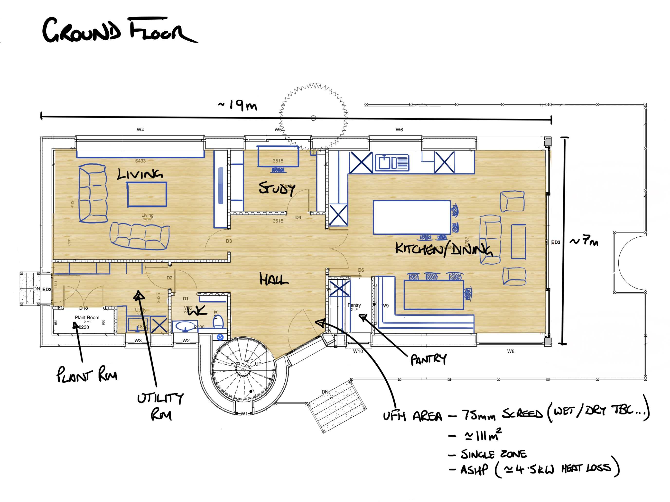

  1. We need an ASHP, 300L DHW cylinder and UFH design.
  2. Passive-level of insulation & air tightness (MVHR planned - DIY, Zehnder Q600). Ground floor height = 3m, First floor is into the roof space (steep pitch) - ceiling = 4m. Open void at the entrance to a double-height space.

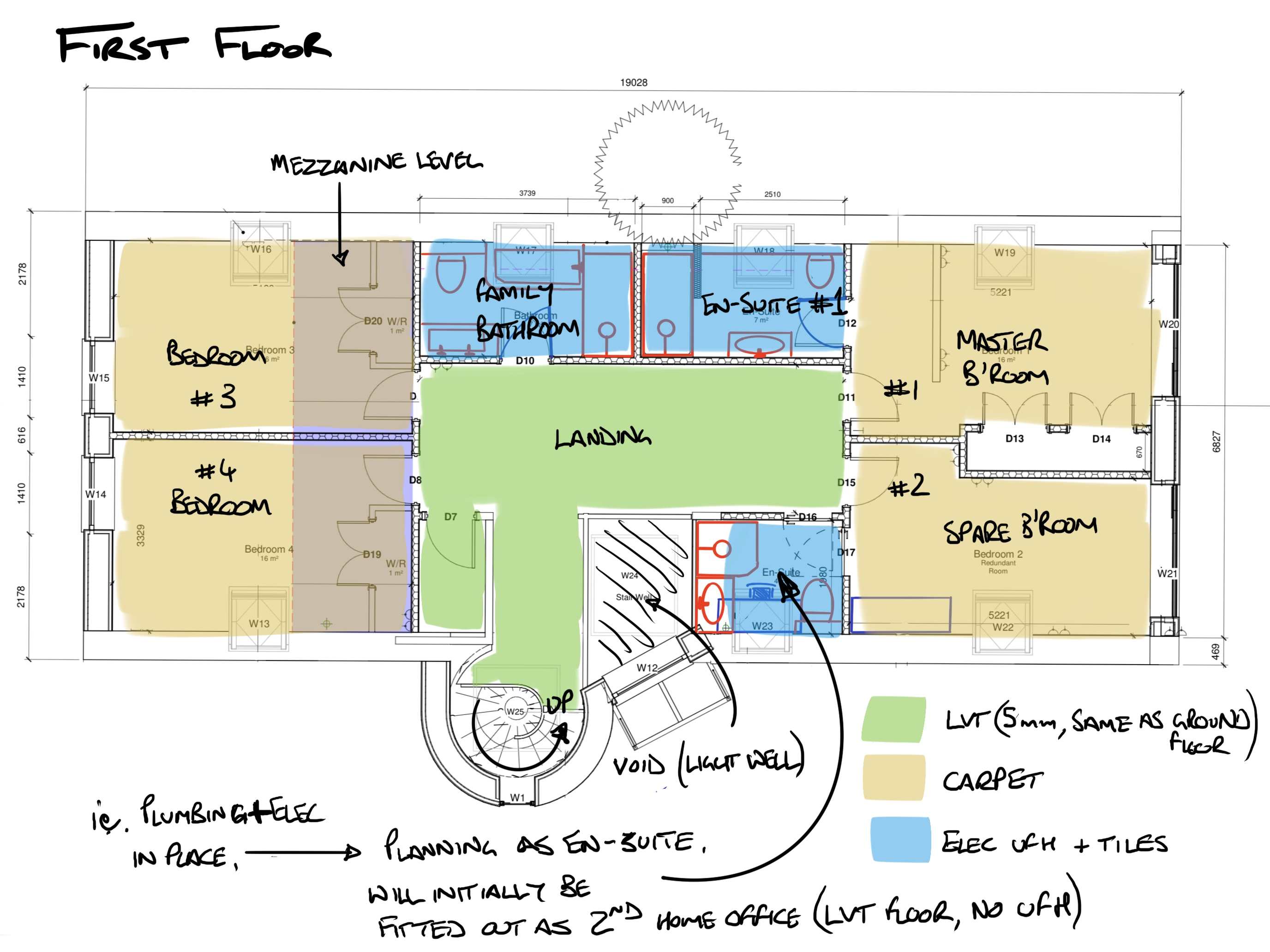

  3. UFH - 111sqm ground floor only, single zone, spiral pattern, multiple circuits. Upstairs will have electric towel rails and UFH mats in bathrooms just for the ‘warm floor’ feeling rather than to heat upstairs. I’d like to vary the spacing so that the single zone system heats the rooms at a different emitting rate (bear with me) - the thermostat will only be set in one location, whilst there are 5 separate areas (living room - no opening window), study (small, has an opening window), hall (massive tbh), WC (tiny), Utility room (clothes hanging to dry), Kitchen/diner (massive and huge sliding doors). I’m suspecting that I may struggle to get this ‘done the way I imagine it could be’ as all the companies just roll out a default - same spacing everywhere plan.
  4. AC - detailed modelling shows we don’t need cooling, but we’ll install power to the locations where an AC unit could be installed, but we plan to live in the house without it. Shade is ‘not a problem’ we have plenty.
  5. Smart home integration - we’ve managed to get a KNX designer on board at a manageable cost and so want to ensure we can integrate the heating into it as the KNX controller could negate the need to duplicate having an ASHP controller separately. KNX is a protocol rather than proprietary system and so is widely compatible, but I’m looking to choose one that is directly compatible rather than via a 3rd party controller; I understand Vaillant and Panasonic are just 2 examples that are compatible.
  6. ASHP - I’m no plumber and lots of threads (here and elsewhere) refer to ASHP only being any good if they’re set up well, and getting someone who knows the specific make will know how to get the most out of it etc, etc. I’d love to learn this stuff, but I don’t have much time and this feels like something we should be getting done by an ‘expert’. The plumber (via our builder) doing the rest of the house is not familiar with ASHP and just needs a flow and return to connect up our UFH, but his only experience is system that have a buffer and when I started describing having a simple / optimised system with no buffer, it wasn’t clear to him. He’s clearly practical at all other aspects of the plumbing, but not one for designing a system.
  7. We’re approaching the point of laying floor insulation and being ready for UFH will be straight behind that. I’ve got UFH quotes for design and supply, but I’d prefer to  need a plan, and the relationship between the UFH.
Options (there are undoubtedly more that I can’t think of - it’s late…):
  1. Contract one company for ASHP design, supply & install, with UFH design & supply (some of the MCS quotes have insisted on having upstairs emitters as the calcs won’t work otherwise (apparently - I’ve got no way of knowing if this is correct).
  2. Rely on my heat loss spreadsheet calcs, purchase ASHP direct from a supplier (not sure how to install - is it as hard to set up as I’m led to believe?, do they come with instructions), get a company to design & supply UFH, lay the pipework myself and get our plumber to help connect it up, if we need.
  3. Something else?…
Grateful for your collective advice on ASHP options that will be KNX compatible, and how to go about our design/install.

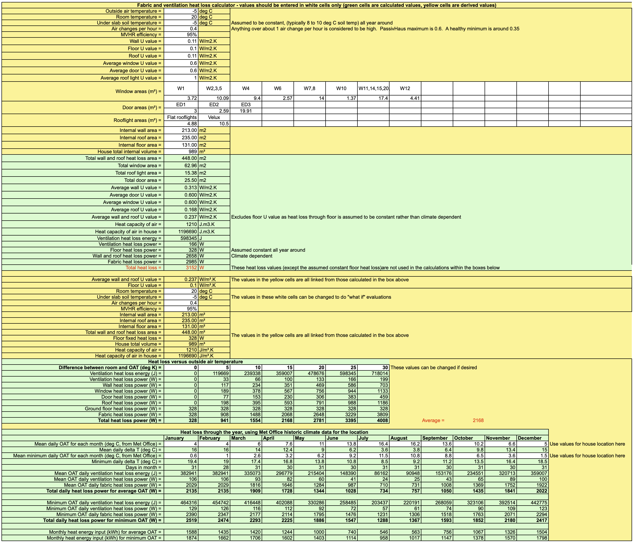

Jeremy’s heat loss spreadsheet - https://forum.buildhub.org.uk/topic/439-fabric-and-ventilation-heat-loss-calculator/#comment-4407 (everyone seems to find their way to this eventually; I put this off for a while tbh, I deal with too many spreadsheets at work, I wasn’t actively searching for more). Measured everything up, ran the numbers, ~4.5kW before factoring in DHW.

    I have not had a chance to work out, how to pair heat requirements of individual areas, into a simple system for my ground floor yet. So i am at the same stage as you, with perhaps a little more time

5 hours ago, Great_scot_selfbuild said:
Missed off @jimseng from here.
How do people learn about calculating the heat output from UFH for a given room size and heat loss? Any recommended books/reference material/youtube accounts/online courses?
I’ve been wondering how the downstairs heating might perform if we had wider spacing in the living room compared to the other areas, and where to put the thermostat as the whole of the GF will be single zone 🤔🧐. Even just as an exercise, I’d like to be able to work through the calculation as an exercise.
Has anyone done this before?

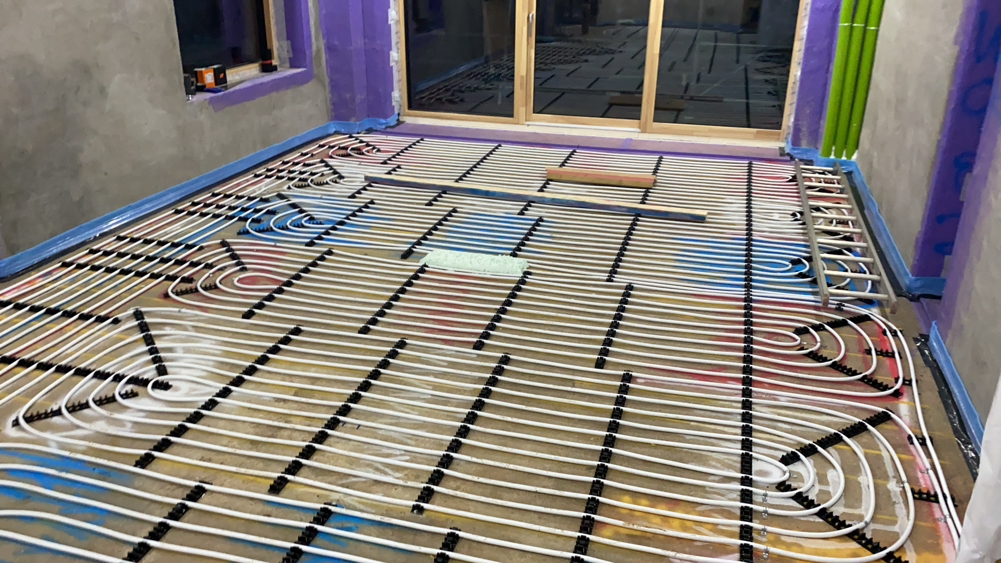

Am i correct in thinking that a snail layout is better than an up and down ? In my head it is, as the heat is more evenly distributed.
Yes and no. If the flow goes to the ‘coldest end’ of the room first so the heat lessens as it comes into the centre of the room then pretty moot in these circumstances tbf.
The time you lose the choice is when the cc of the pipes are less than the minimum bending radius of the pipe, eg at 150mm cc you will seriously struggle to perform a U -turn at the end of every serpentine loop.
If you lay ‘snail’ or inverted loop then you are only performing 2 U-turns per loop, with all others just a 90° turn (if the space is a perfect square or rectangle eg).
At 100mm cc as per this…
…you’d have zero chance of going serpentine.
TBH, unless it’s a job with 200mm cc, I’d just go to snail layout as default. Just a better job imho.
This was at 150mm cc iirc…
…still note just the 2 U-turns at the centre of each loop. Much easier.

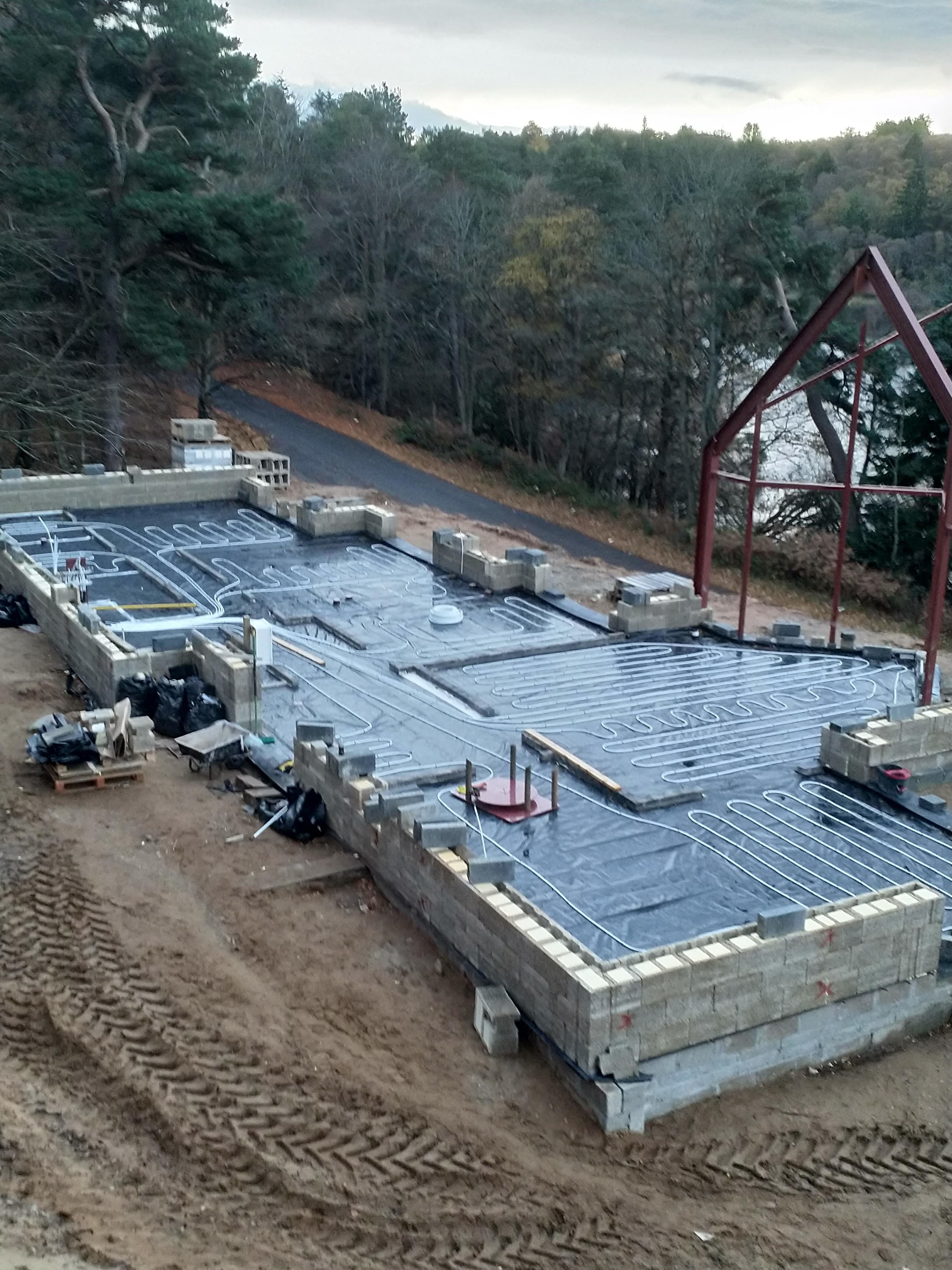

Low flow temperature makes little or no difference, what layout you do, as dT for loops is so low. It's currently 2 degs outside and on 300mm centres our flow dT is closed to 2.5 degs. Our pipes are 100mm down, so by the time the heat has migrated to the surface, there is very even surface temperature. I have just up and down pipes, nothing fancy.IMG_20201114_152847.thumb.jpg.3b39131469575142f8442e390eb694f5.jpg

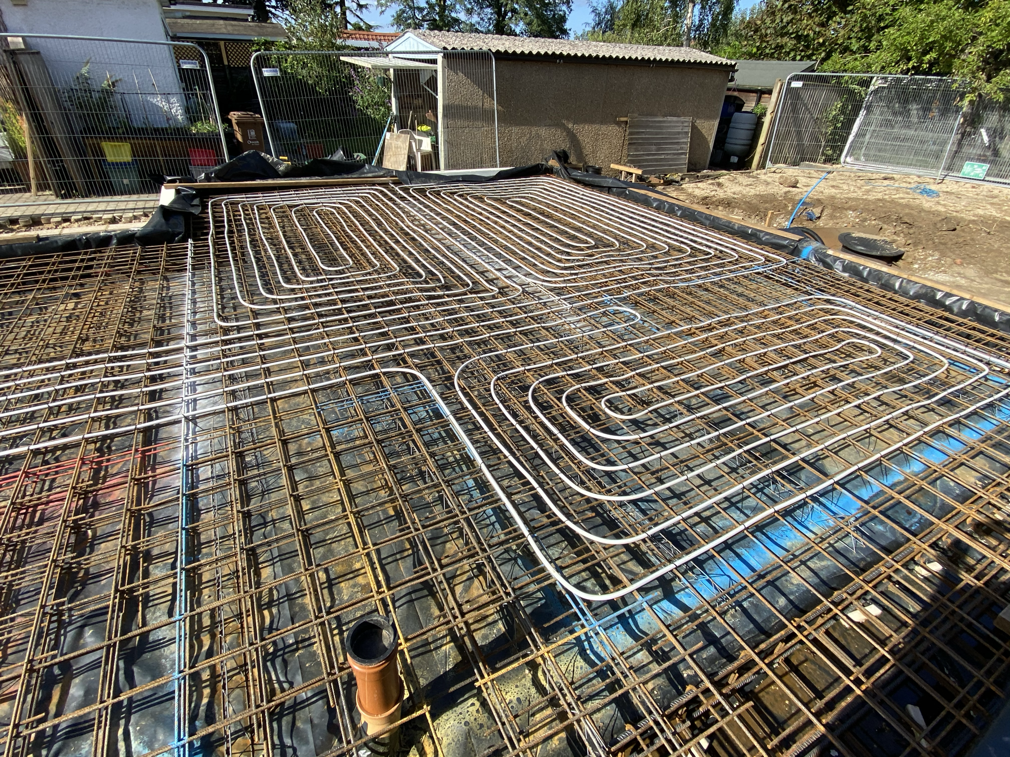

Ok many will disagree with me but here is my take on it. I did my first UFH heating system when many here were in short pants. I'm now a designer. My appoarch is pragmatic and absolutely driven by what is achievable on site, buildablity and cost driven. I honestly despair when I see folk trying to desing pipe layouts room by room! I can go on at length but it is complete bonkers! Thoery is taking over reality.
To start. You are going to install pipes in a screed say and that has to be made as simple as possible. You want someone that is going to do this right, that is experienced and they will need a labourer. Take the experienced person at £300 a day and a good labourer that is going to uncoil the pipes and and not be a bit hung over, (kink them) at say at "£120.00 a day. So the labour is £420 a day. Save a day and that extra can get you more pipes.. for 50 years!
Now to save labour and reduce risk its easier to make all the pipes at the same centres. Design for the nearly worst case.
In real life the concrete guy turns up and may squash a pipe. You won't know.  So you want some more loops as a bit of redundancy. There is a thread about how folk cock stuff up.. take my advice and avoid this scenario. Of course I'm not going to be BH angel of the month but best to be honest and give it to you straight about how things often work out on site for self builders. Yes you may think that you will be up to site checking everything.. but that is often wishfull thinking! Even then ask do you really know what you are checking.. do you have the experience / constructionknowledge to know how to argue if you find something wrong?
At the end of the install you want something that has some contingency built in. But if you consider the labour saving vs the extra length of pipe it is a good balance of risk when you consider that the pipes need to last 50 years.
As an SE that is used to balancing real life cost vs risk, and done UFH long before BH was even invented, I must say that much stuff you see on BH about folk trying to save a few quid is frankly complete pish! But it's not my money!
My advice is to install plenty and easily buildable spare capactity in the floor and once the pipes pop up you can play with your controls to your hearts content. It's a good apporach as boiler and design technology develops.. to have spare capacity in the floor slab.. even if you don't need it right now.
Put in plenty loops as a guard against the builder catching you out or say in the heat of battle you are doing the screed concrete your self.. you can easily miss a trick here. Don't think for a minute that while it looks great on paper.. on site when the concrete is coming you will likely not have the experience to say to the concrete guys,, hang on.. the may bully you and play to your wallet.
So to finish.. I say to many armchair techy folk that are trying to refine UFH pipe layouts.. stop having a laugh and lets look as what happens on site and the labour cost of fannying about with different pipe spacing. Many folk on BH end up moving walls or end up with a diferent kitchen desing layout.
Self building is hard enough without getting over enthused about some hot water pipes in the floor.. keep it simple and that way you'll save on labour and reduce you risk of something going wrong.
That's my view in the round.

31 minutes ago, Great_scot_selfbuild said:
I’ve been wondering about the strength of these pipes once they’re laid (before screed goes down)
I filled mine with water glycol mix and pressurised - they are not get crushed by anything. My pipes were installed as part of the foundations, so pre walls. Survived a Scottish winter.
All I can add is that I checked the pipes on a Friday, with the screed coming in Monday. There were 2 x severe kinks in one room. Supposedly expert plumber declined to spoil his weekend to sort it.  Fortunately. I managed to straighten them.
Works nicely.
So I don't assume that other people care. Certainly not the £150 guy who poss has no experience.
How many homes still  have the kinks? Presumably it works well enough normally.
So I agree on some redundancy.
A pre-requiste before pouring any concrete is testing loop flow and pressurising the loops. If flow is not right it needs fixing before the pour. Ideally monitor the pressure during the pour. If something goes wrong (unlikely), then reaslising it as the pour happens likely makes it easier to isolate where the problem is. You obviously wouldn't stop a concrete pour but if you get on to the repair straight away before the concrete has full cured the job will be a lot easier.
Having said that, I believe that modern Pex-Al-Pex pipe is significantly more robust than pipes used in previous decades so as long as everything is tested in good condition before the pour then the pour shouldn't be an issue.
In terms of redundancy, what exactly are you referring to? Is it to run extra loops in parallel - for example, if I need 300mm spacings, I add additional loops so that I essentially have 150mm spacings - or is it something else?
I'd like to know more Gus as I'm keen to understand your perspective and reasoning for this. What are the thermal characteristics that are better and how is the system output controlled once it's in?
I'm from the school of calculating heat load requirements in the room and designing emitters to satisfy this at a low temperature as possible and avoiding external controls as much as possible although I recognise and use room influence where needed. This approach does use the method of designing both radiators and ufh to the demand of each space.
I'd like to understand more from your experience.
