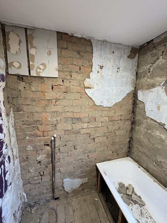

I am going to make a doorway between my bathroom and bedroom, making it ensuite.
I've been watching a few videos and reading about how to do it. It seems doable even for a DIYER.
This post is looking for any information people can share about making a doorway.
Points I've noted down, standard UK doorways are 826mm wide. Anyone go bigger? Lintel above the doorway is extra 100mm either side of the door. Would anyone go bigger? What thickness would be acceptable?
Above the wall where the doors going, there is only one beam across it. A builder had a look at it and said there no structural issues/its not supporting anything about it.
Any thoughts/information would be much appreciated. Thanks.

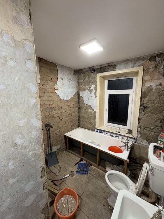

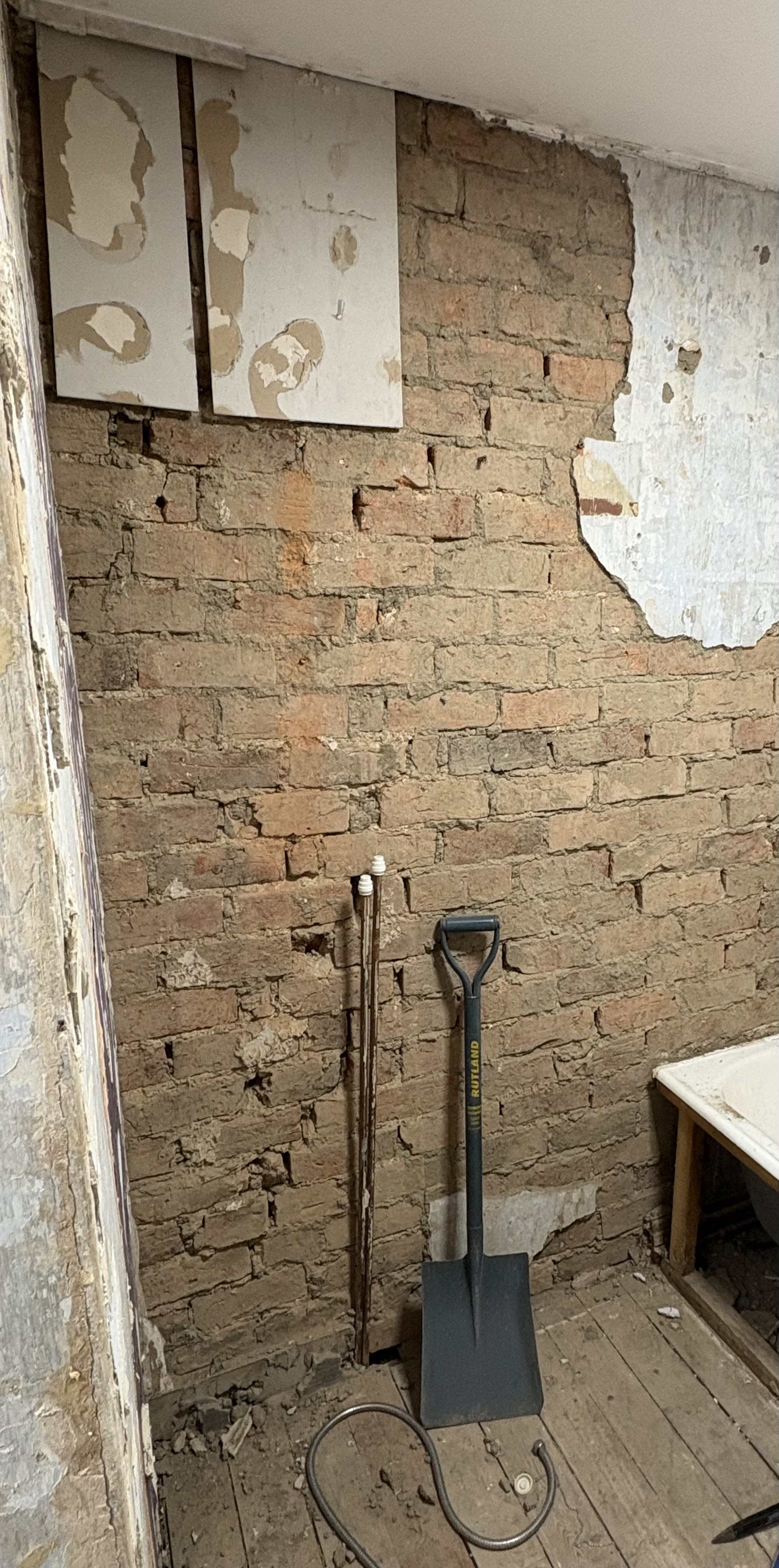

I have removed all the plaster from the bathroom side of the wall as it was all blown. I will be going from bathroom to bedroom side. So i can make my measurements and cut into half a brick and hopefully have it sat nice and neat.
Beware how you create the opening, as if it is the thin / old / frail brickwork then disturbing it can be the beginning of a long journey.
You may very well need to line this with timber stud frame, and then dress the doorway into that, to give strength back locally to the cut brickwork (drilling fixings into each course, and possibly bonding too).
Some pics would help.
I’ve added some pictures. I am going to remove the bath and go from the bathroom side into the bedroom. The still plastered side is the bedroom I’m going into.
