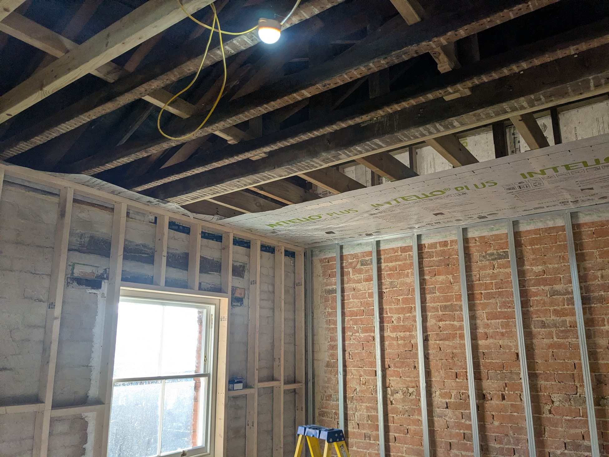

Annker Posted January 14 Posted January 14 (edited) In summary I am fitting an intello plus AVCL to 1st floor ceiling joists, these rooms will have downlights fitted in the ceiling which are about 120mm in length. I cannot create a service void below the AVCL to accommodate the downlights, therefore they will be located within the ceiling joist void, hence above the level of the AVCL. There is an off the shelf solution like these however I do not see any mention of them being used by builders on this forum. I am a carpenter so I could make plywood boxes into which the AVCL is folded up into. I'm sure this must be a common detail but I can't find much detail on solutions so keen to hear what others have done to maintain the air tight layer in this situation. Edited January 14 by Annker

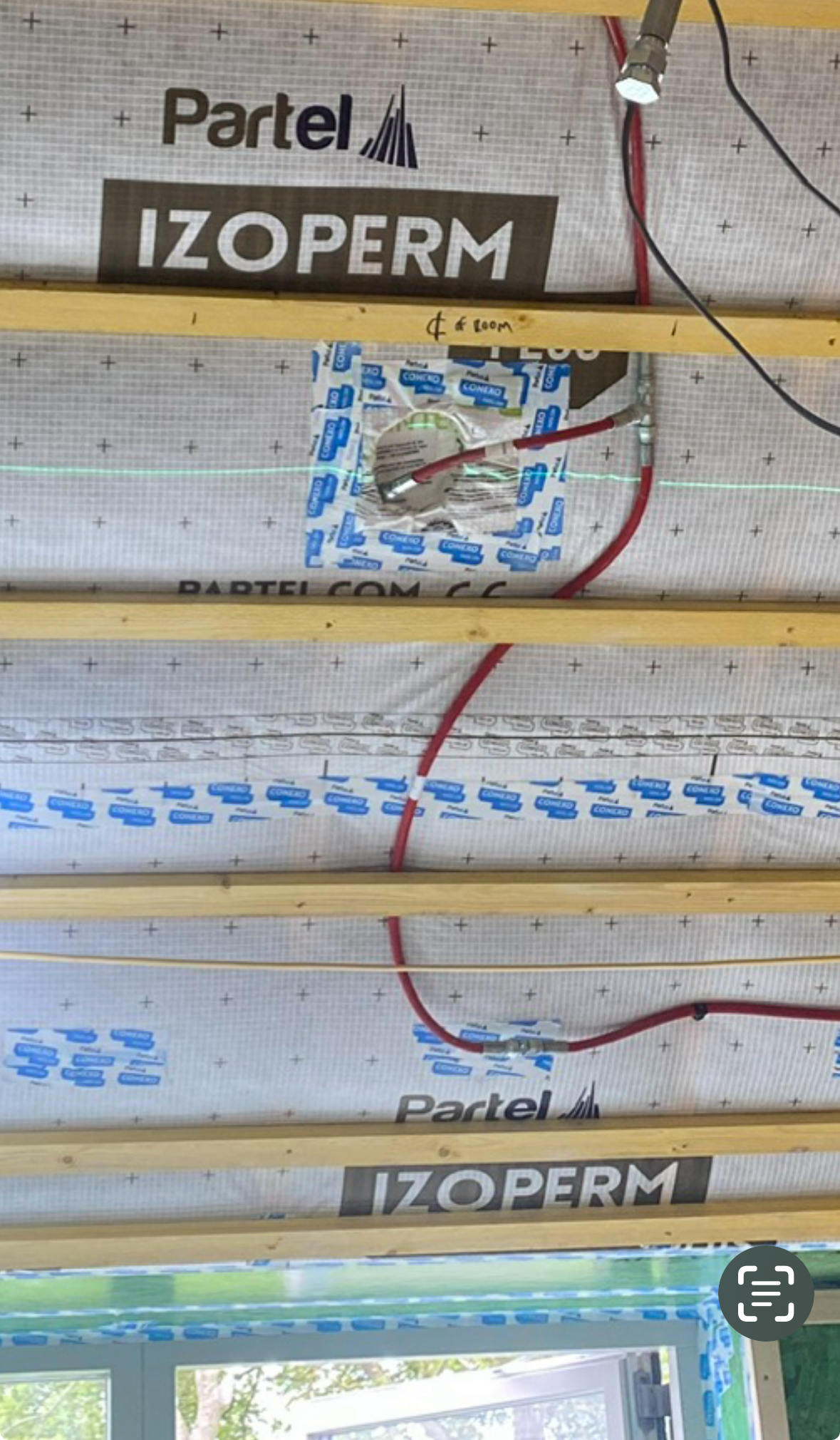

Iceverge Posted January 14 Posted January 14 I had to recess the mounts for my MVHR terminals. I just ran a piece of OSB between the joists on battens. The bottom face of it was about 50mm above the lower face of the joists. I folded my airtight membrane up and taped it to the OSB . 2

Annker Posted January 14 Author Posted January 14 9 minutes ago, ProDave said: What stage of the build are you? Why not put the VCL across the top of the joists? Or as above slim downlights. Some will literally fit in the thickness of plasterboard. Its a retro fit/renovation. I think it would be near impossible to seal the perimeter of the VCL if it was fitted above the joists, and also more difficulty to fit the insulation to be laid between the joists. Photo below for reference, as you can see its very easy for me to fit the vcl from below. I have a thread going on IWI, my design was largely gathered from very useful info received on the forum and I will updated it once that phase of works is complete
Nickfromwales Posted January 14 Posted January 14 For a clients build which had some deep lights and mist heads, I just used an off-cut of duct (125mm for mist heads iirc) and some AVCL to create ‘top hats’, and then taped these into cutouts. These were done after the cellulose had been blown in, but wasn’t too difficult or messy as I could push back and compress it enough for it to stay in place for cutting the membrane. A bit of cellulose fell out, but prob not equal to what I needed to remove to create some clear area for the recess, so all good. Doubt you could do this approach before insulation gets blown in, unless you somehow support these when the cellulose gets pressure filled; otherwise your inny’s would become outy’s. 2
