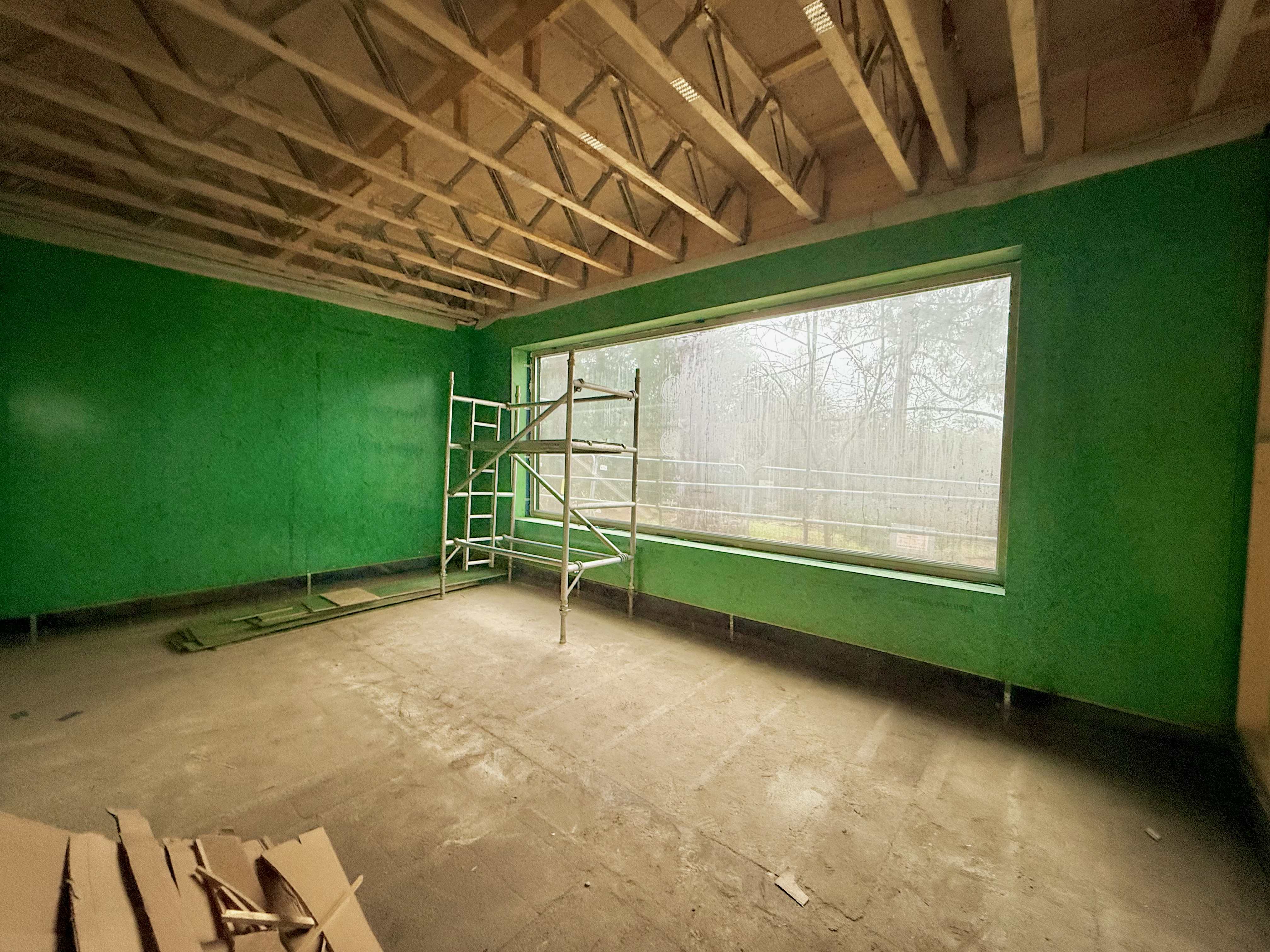

January 11Jan 11 Hopefully I’m overthinking this, but having read about the impact of small gaps in mortar on airtightness I just want to check… Situation: Timber frame build. Internal face of stud wall is Pro Passive Board. Intello airtight membrane used to lap joints and maintain airtight layer where PPB won’t fit. Timber frame company has a proven reputation for achieving better than 0.6ACH. They will install PPB & service battens, that’s where we pick it up from. Plant room: This is the first area where I will be installing 18mm ply throughout to give us a solid fixing for all the equipment that goes in here. I’m thinking that we can do away with the need for a service void here because all the wiring, piping, ducting etc is going to be on show anyway. I’m very keen to see how others have done their plant room fit-out. My questions are: 1. Should I still keep a service void in the plant room? (Why?) 2. When screwing through and into the PPB (which would be the case with/without a service void), this will pierce the airtight green coating on the PPB - will this affect the ACH performance? 3. There will inevitably be cases where screws are put in and then taken out, having gone through into the PPB layer. Will this affect the PPB? How significant can these piercings impact the air tightness performance? Photo for interest. This is ‘the big one’.

January 11Jan 11 Author The intention for plant room is that the 12mm green PPB has 18mm hardwood ply board nailed directly to it, then items will be installed into it, with screws going through both. My main concern is if screws are put in and then later removed (items moved), then how do I maintain the airtightness. All of this is, of course, easy to keep an eye on when I’m doing it myself - my concern is once I have the electrician, plumber and others involved who don’t get the significance of ‘its just a screw’. So, how important is it to fuss over this level of detail - am I right to be so picky? (Possibly my ‘default’ approach 🫣)

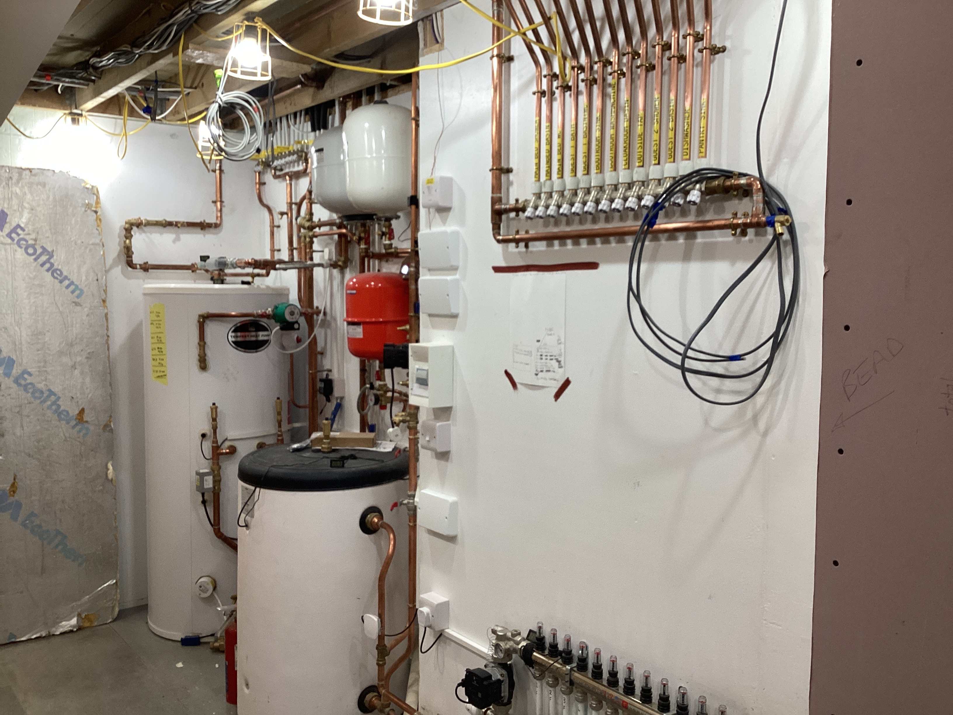

January 11Jan 11 Plant room 18mm ply direct to the walls then 2.4x1.2 sheets of fermacel jointed using their joint stick, then two good coats of eggshell paint. all the plumbers handprints and pencil marks wash off easily or a quick touch up and there gone. this is what I did. I cannot believe the amount of unpainted walls in plant rooms I see on here that then have ufh manifold fitted and tanks put in place before the walls are painted looks totally rubbish.
January 11Jan 11 21 minutes ago, Russell griffiths said: Plant room 18mm ply direct to the walls then 2.4x1.2 sheets of fermacel jointed using their joint stick, then two good coats of eggshell paint. all the plumbers handprints and pencil marks wash off easily or a quick touch up and there gone. this is what I did. Simple and effective, Needs putting in a memo and stickying at the top of this site TBH, then email it out to all architects and architectural designers to put in there schedule of works! I’m well behind on my build, partly because I haven’t yet had my plant room skimmed, and I refuse to crack on with all that on unfinished walls, this has had a knock on effect with plumbing, electrics, etc etc. Get the plant room done and ticked off first, then everything else can follow.
January 11Jan 11 7 hours ago, Great_scot_selfbuild said: . Should I still keep a service void in the plant room? (Why?) Yes, keep the gap behind the ply facing. To stop screws penetrating the airtight layer. Also it may allow you to run wires more tidily to plant even if you've still got everything else surface mounted. 7 hours ago, Great_scot_selfbuild said: When screwing through and into the PPB (which would be the case with/without a service void), this will pierce the airtight green coating on the PPB - will this affect the ACH performance? No. A screw in a hole is airtight from the purposes of house building. We didn't make 0.2 as above but 0.31 and we didn't tape any staples or screws. 7 hours ago, Great_scot_selfbuild said: There will inevitably be cases where screws are put in and then taken out, having gone through into the PPB layer. Will this affect the PPB? How significant can these piercings impact the air tightness performance? Keep your Ply facing spaced off the airtight layer for this reason with a service cavity. Have a tube of sealant and caulk the holes on blower door test day.
January 11Jan 11 Author 5 hours ago, Russell griffiths said: Plant room 18mm ply direct to the walls then 2.4x1.2 sheets of fermacel jointed using their joint stick, then two good coats of eggshell paint. all the plumbers handprints and pencil marks wash off easily or a quick touch up and there gone. this is what I did. I cannot believe the amount of unpainted walls in plant rooms I see on here that then have ufh manifold fitted and tanks put in place before the walls are painted looks totally rubbish. @Russell griffiths This has given me pause for thought - although I would like it a nice painted, clean room, the practicalities of slowing everything down for this room (when I actually like the natural finish of the hardwood ply) is something I'm weighing up. I also already realise I've built the garage before the house and if I tell my wife I'm going to board and paint the plant room, before we've guaranteed the kitchen and other family bits of the house, I may not survive the build! 🤣 Do you have any photos of your plant room for inspiration please?
January 11Jan 11 Author 5 hours ago, Iceverge said: Keep your Ply facing spaced off the airtight layer for this reason with a service cavity. @Iceverge This is the space I'm in atm, it will remove an inch of useable space from each wall, which on the end walls would bring it down to 888mm wide. My main specific challenge from a sequencing perspective is the following: Timber frame is a Larsen-truss wall, from the outside: Breather membrane 12mm medite vent board 350mm cellulose insulation 12mm Pro passive board (assuming I keep the service void) 25mm batten 18mm hardwood ply (fermacel/similar?) @crispy_wafer @JohnMo @G and J @MikeSharp01 @Russell griffiths @saveasteading So, I need to drill/core holes for the MVHR supply & extract ducts (~210mm dia hole). I've been pondering the challenge of drilling all the layers - I don't trust doing this by measuring, so I'd want the ply in place first, then I figure I would: Drill the ply and pro passive board Remove the ply so I have a (little closer access to reach through to drill to the outer medite-vent board. Once the duct is installed, I can then seal around the pro passive board, then re-fit the ply over the top and then think about painting / finishing. QUESTION: How do I drill through the propulsive board and then bridge the 350mm gap to the outer board? (for info, it is highly likely the insulation will have been installed already, though I'm going to see if I can delay this)
