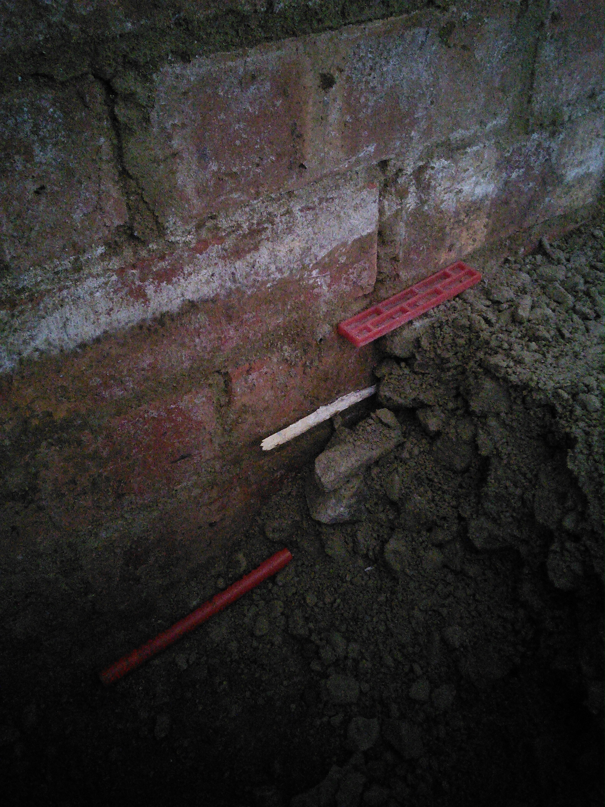

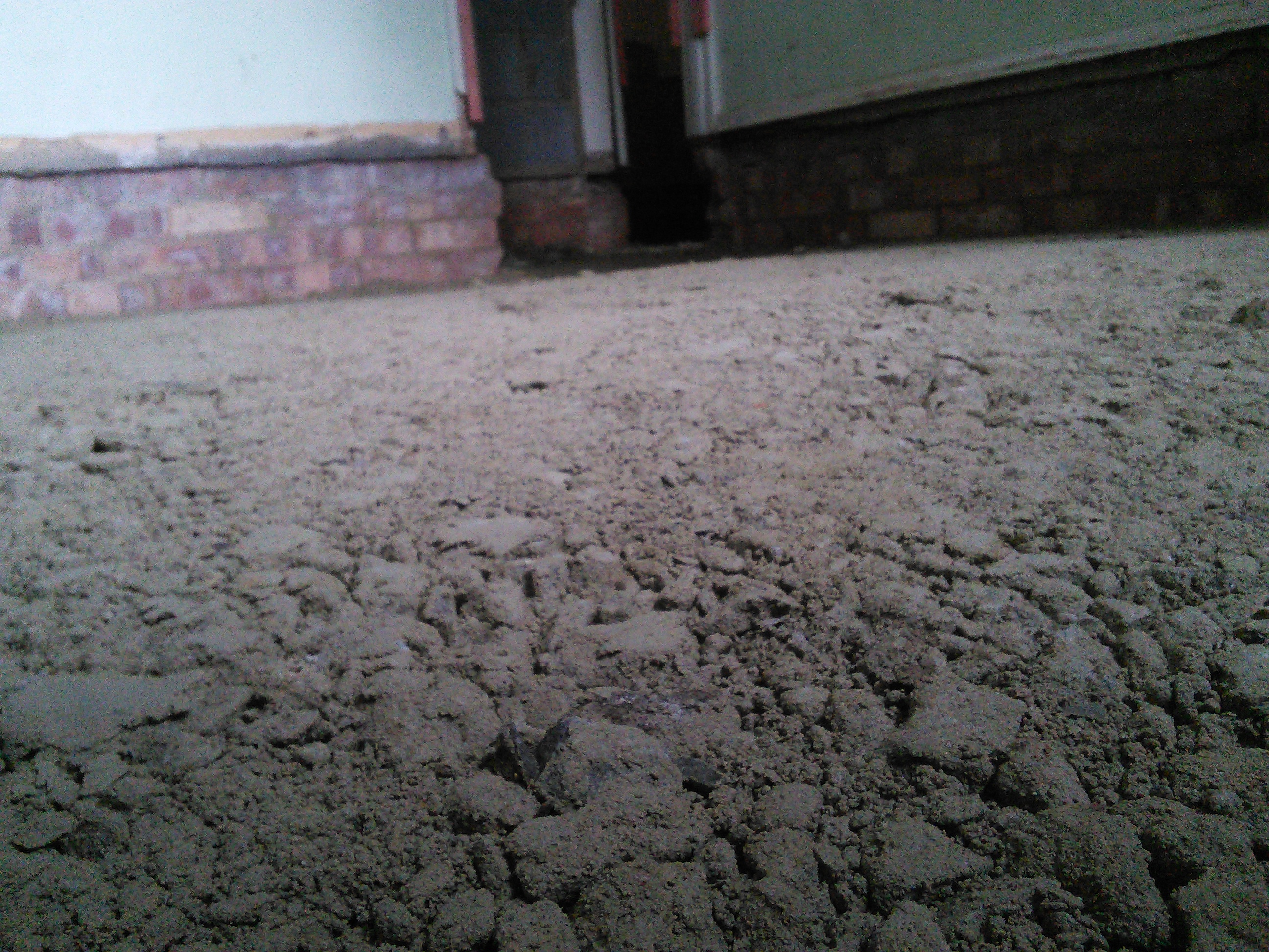

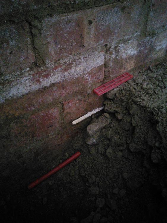

oranjeboom Posted June 18, 2016 Share Posted June 18, 2016 (edited) Admins, please move thread to another area if this isn't the best area! Okay, I had contractor to come and dig up my old slab (100mm) and then proceed to remove a further 375 of soil. They then barrowed back in 150-160mm of type 1. They proceeded to compact it with their wacker which IMHO was too small for the job. But they kept going....and of course they didn't get to the required 100mm compacted level. I spoke to the contractor and he said he would be back today (early!!!) and would come back with a decent whacker that they use for roads. I thought they'd use a roller for that, not a whacker but who am I to say what's best.... Anyway, looks like the £250 retainer that I kept back wasn't enough to get him back to finish the job off. The bar steward has not showed up and is not answering my calls. Should have retained a bigger amount but I stupidly trusted the man. And the two barrows and rake they left behind aren't going to make up for things. I could be livid, but I'm fairly used to it in this country that homeowners get shafted like this. It's a way of life. Just look at the TV shows that rely on these 'cowboy' trades. And trying to take things up via the small claims court is just not worth the effort and expense. So rather than get angry about it, I'd like to channel any negative thoughts into getting the job finished. And rather than get someone else in, I'll probably tackle the 88sqm myself. The small whacker they had was clearly not up to the task of crushing the 160mm down to 100mm. Think they used a 450mm plate (83kg). What do I need to get this done? In most places I will need to go down another 40-50mm. Would this baby do the job? http://www.jewson.co.uk/tool-hire/compaction/plate-compactors/products/2530/reversible-plate-compactor-500mm/ Do-able in a day? I need to go down another 50mm as otherwise I won't get sufficient EPS under the new floor slab.And that was the whole flamin' point in going down do deep in the first place Mr R. BlXXXMAA of AXXXFXXW, you !"£%^&*()_+ !!!!!!! Can't wait to write up my review on MyBuilder...... red pen = excavation level, white marker = 100mm compaction level, red marker = top of hardcore bloody uneven too!! not really clear, but room centres are a lot higher too. Ideally I don't want to remove any hardcore and then compact and then add a bit back in, compact...... Advice, options? No replies on cowboy tactics, my gulliibility etc pls. That's another thread-starter.... Edited June 26, 2016 by recoveringacademic Photos added, descriptions: tags tidied up Link to comment Share on other sites More sharing options...
AliG Posted June 18, 2016 Share Posted June 18, 2016 Googling this suggests that type 1 will compact down around 20-25% from the original depth. I don't think you could get 150-160mm down to 100m. People suggested to lay 130mm if you wanted to compact down to 100mm. Link to comment Share on other sites More sharing options...
oranjeboom Posted June 18, 2016 Author Share Posted June 18, 2016 10 minutes ago, AliG said: Googling this suggests that type 1 will compact down around 20-25% from the original depth. I don't think you could get 150-160mm down to 100m. People suggested to lay 130mm if you wanted to compact down to 100mm. That was my fear too. And I had reservations that they'd added to much type 1 in the first place. And that makes sense as the 18t originally shipped in was not enough for them! Cowboys! Link to comment Share on other sites More sharing options...
Declan52 Posted June 18, 2016 Share Posted June 18, 2016 80mm down to 50mm and then same again if it's a small Wacker. It would need to be a very large Wacker to get it down from 160 to 100mm. Think you are going to have to remove some hardcore and leave it maybe 10-20 higher than you need and then wack the shat out of it. Go up and down and then side to side with the Wacker when you are doing it. You need a fine sand or quarry dust to get it snooker table level. Link to comment Share on other sites More sharing options...
oranjeboom Posted June 18, 2016 Author Share Posted June 18, 2016 11 hours ago, Declan52 said: 80mm down to 50mm and then same again if it's a small Wacker. It would need to be a very large Wacker to get it down from 160 to 100mm. Think you are going to have to remove some hardcore and leave it maybe 10-20 higher than you need and then wack the shat out of it. Go up and down and then side to side with the Wacker when you are doing it. You need a fine sand or quarry dust to get it snooker table level. Thanks Declan. Not what I want to hear really. I think I will try and get that big whacker (140kg) and see what it does. I really don't want to extract all down to 80mm and whacker layer by layer. Hopefully a big'un will do it. @Onoff - what are you doing next week???? Link to comment Share on other sites More sharing options...

Declan52 Posted June 18, 2016 Share Posted June 18, 2016 Only way out of not digging out at least 40-50mm is to use less insulation in the floor. How much had you planned to use?? How much have you left from the top of the hardcore to the bottom of your door frame?? I am removing wood chip off my sister's walls so digging hardcore out would be music to my ears. Only thing left to try and remove it is petrol and a match. 2 Link to comment Share on other sites More sharing options...

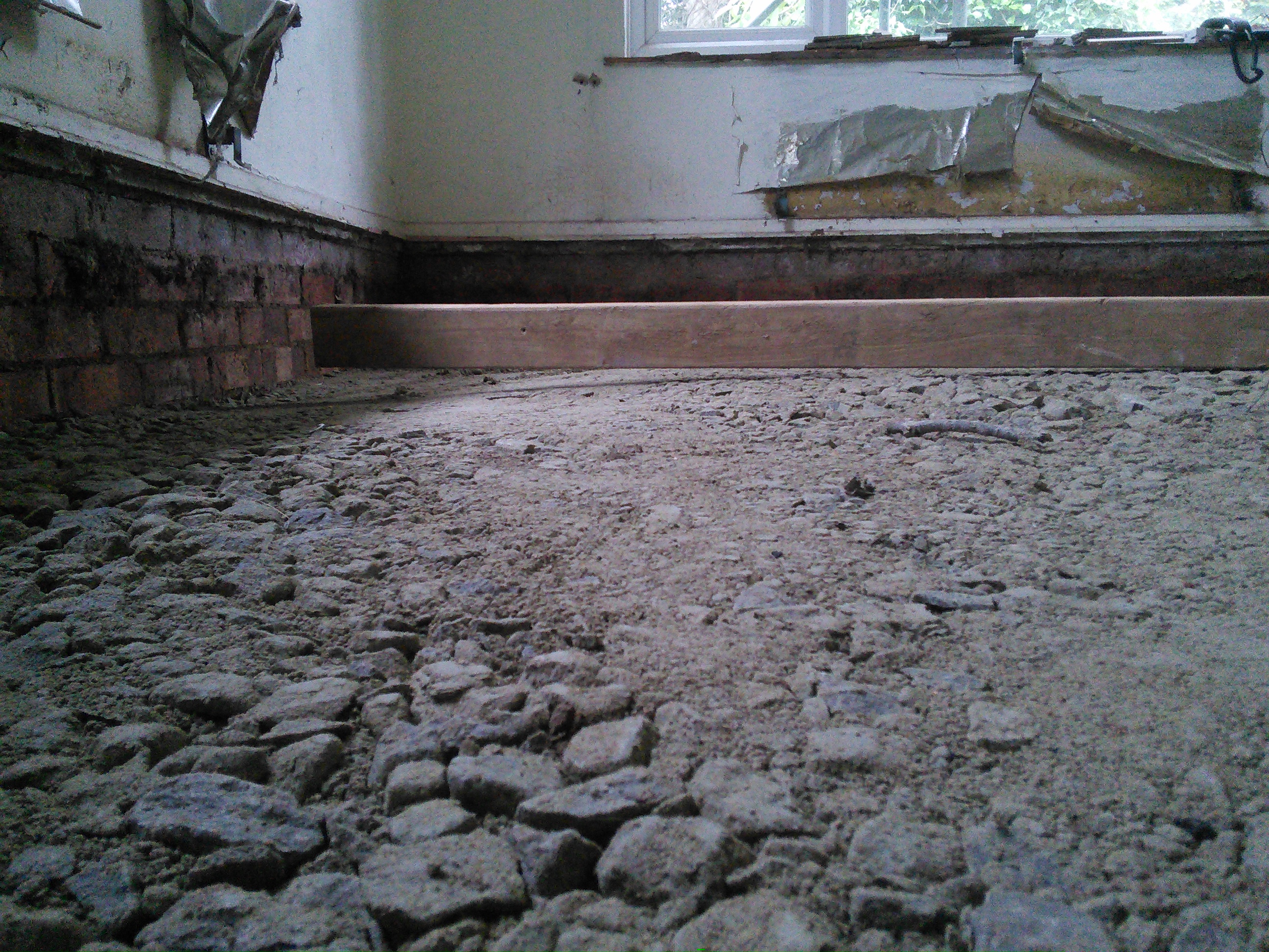

Onoff Posted June 18, 2016 Share Posted June 18, 2016 A quickly installed level drag board will give you a reference. It will also let you see your progress when the going gets tough. The danger with attacking a big area as a whole is you'll jump about with no real plan, take too much out here, not enough there and be doing unnecessary work. Link to comment Share on other sites More sharing options...

Onoff Posted June 18, 2016 Share Posted June 18, 2016 1 hour ago, Declan52 said: Level it out with sand like onoff done with a drag board end up with 250mm insulation or thereabouts. Use pir to get the u values up or get the pick out and get swinging, no other way out of it really. I used sharp sand. Felt soft sand might "filter" down through the Type 1. If it had been REALLY out of level then I'd have probably used some form of grit. Link to comment Share on other sites More sharing options...

TerryE Posted June 19, 2016 Share Posted June 19, 2016 Ferdinand, as I see it @oranjeboom has 3 remediation paths: (a) leave the wibbly high infill, levle and use a high U-value insulation, (b) dig out and relevel, (c) the external skirt option. 100mm of PIR might not be ideal but it will perform reasonably. Depending on the total area digging out and rewacking might only be a couple of days work and if necessary hiring a minidigger to avoid the backbreaking work. I would discount your external skirt option as it won't be as effective as the other two and is a major undertaking. So I would personally choose one of the first two, probably the second. This underlines the wisdom of the slab makers approach (and they used a fairly small wacker plate BTW) whcih was to lay the hard core in 50mm layers and level (using laser) and whack down each layer then finish with 50mm sharp sand whack and top up to final level using screed bars. I Link to comment Share on other sites More sharing options...
Declan52 Posted June 19, 2016 Share Posted June 19, 2016 Dig 30-40mm of the top of the hardcore or an outside trench round the room perimeter, know what option I would pick. A few hours with a pick, shovel and Barrow and it would be done. Only the Lord rested on Sunday, if you believe in fairy tales, so get cracking!! Link to comment Share on other sites More sharing options...
