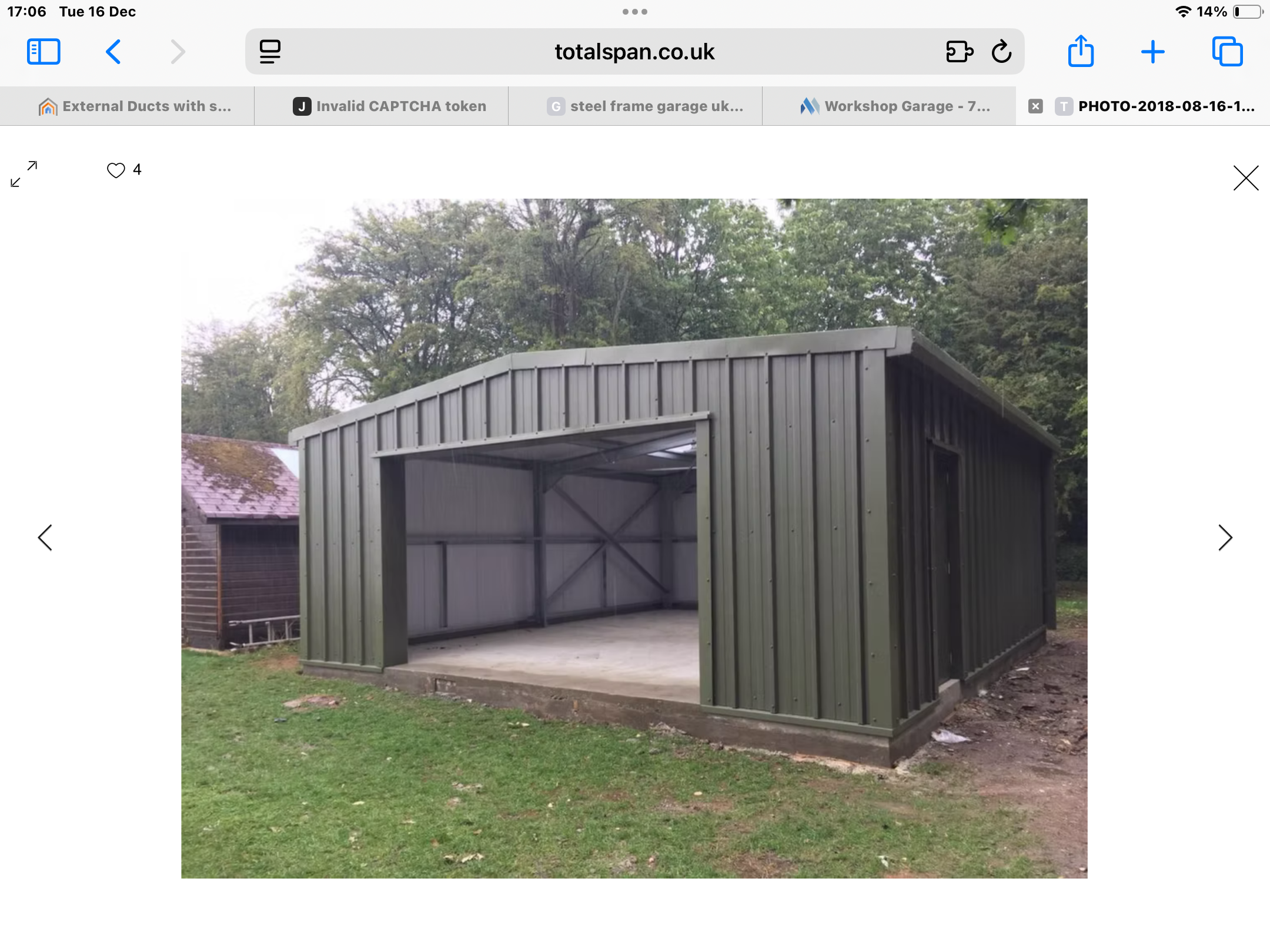

Russell griffiths Posted December 16, 2025 Posted December 16, 2025 Steel frame agricultural barn type thing. steel c sections bolt to the slab, clad on the outside so non flammable construction, insulation on the inside and then osb clad on the inside. im not sure of any regs for a garage apart from fire regulations close to other properties. as far as I’m aware there are very few regs for a garage. I would get the detailed drawings from the agricultural barn company and send that to the council.
Russell griffiths Posted December 16, 2025 Posted December 16, 2025 I’ve had a few of these, fairly straightforward to put up with one helper. 1

Garage build Posted December 16, 2025 Author Posted December 16, 2025 Hi Russel. that style of windowless metal clad agricultural building was just what I had in mind with a wooden frame to keep cost down. Steve
