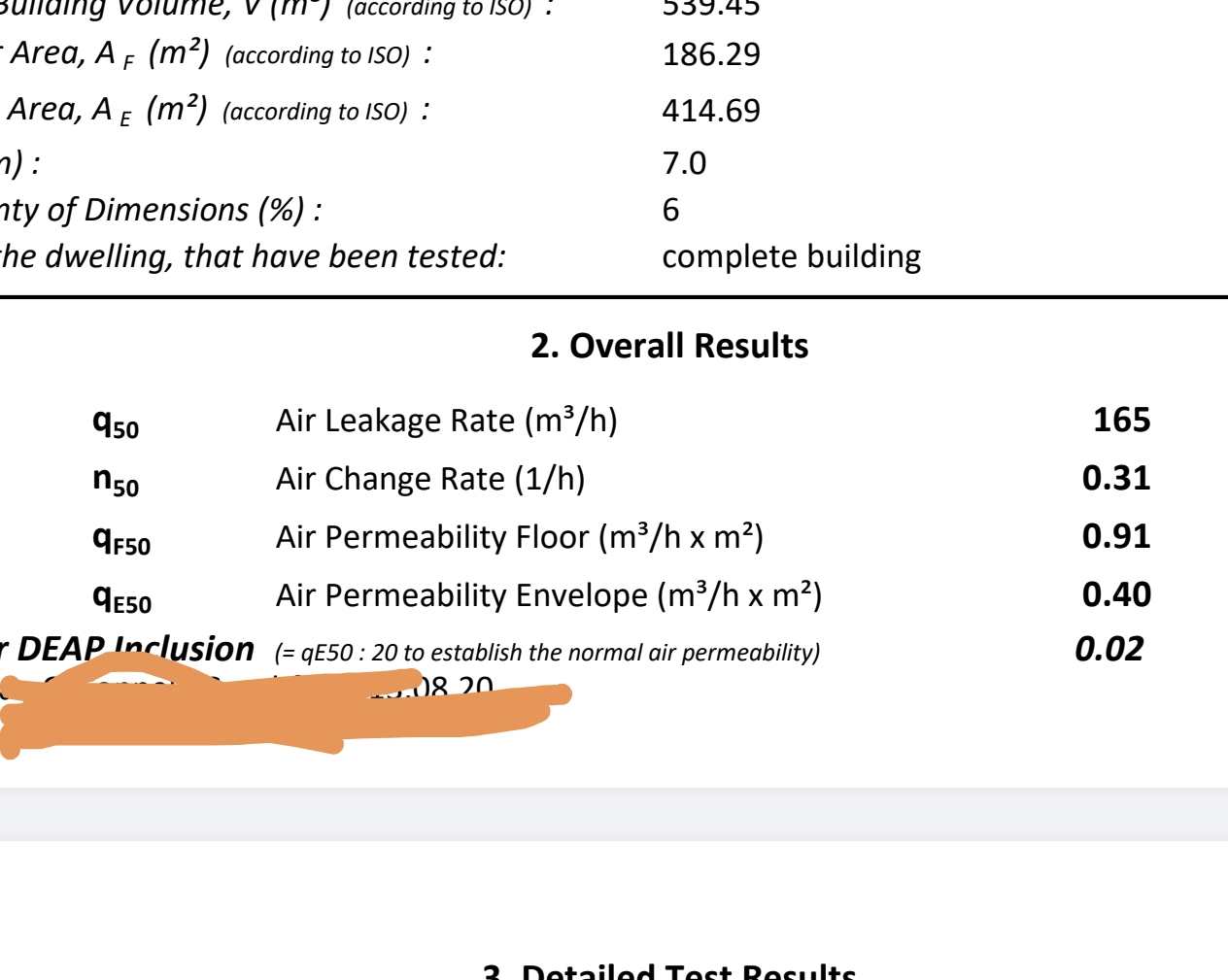

4 hours ago, SteamyTea said:
Half a cubic metre per hour per square metre of exposed area is considered quite good.
Has anyone managed that without filling the house up with glue?
Seem to remember that someone got a 0.23 m3.h-1.m-2.
................... sprints to trophy cabinet.........🏃‍♂️🏃‍♂️🏃‍♂️🏃‍♂️🏃‍♂️...............
.........unpacks golden framed airtightness cert................
............. Yells "I told you someone would care" at nonplussed family........
.......Tear runs down cheek.......... Tears of joy, tears of pride .....
Screenshot_20260108_224342_com_hihonor_hnoffice_PDFPhoneActivity0.thumb.jpg.f5d9c276282b1d1245413f0b7bbf77df.jpg
