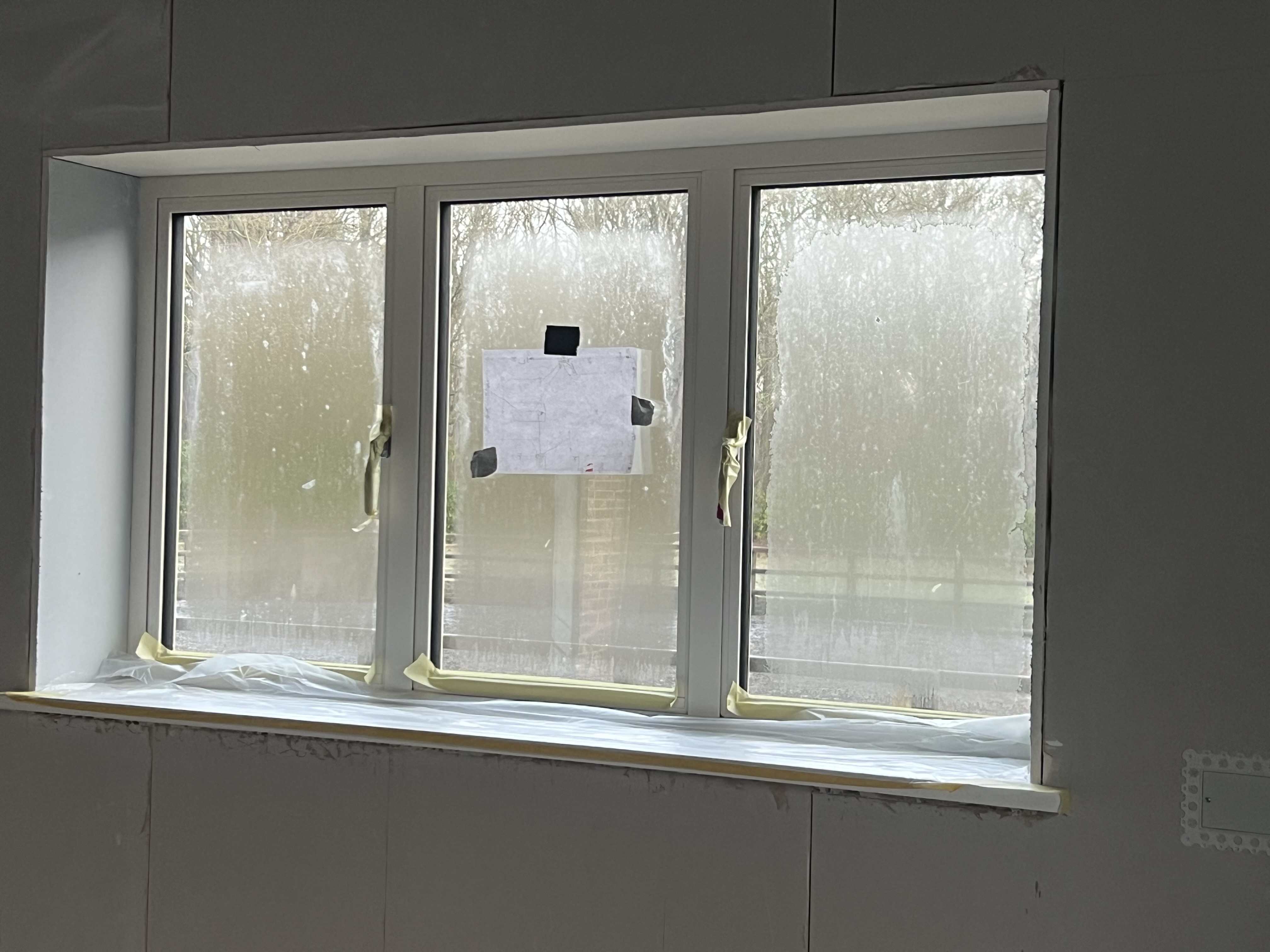

I was horrified when the team prepped and just laid 2โ€ masking tape

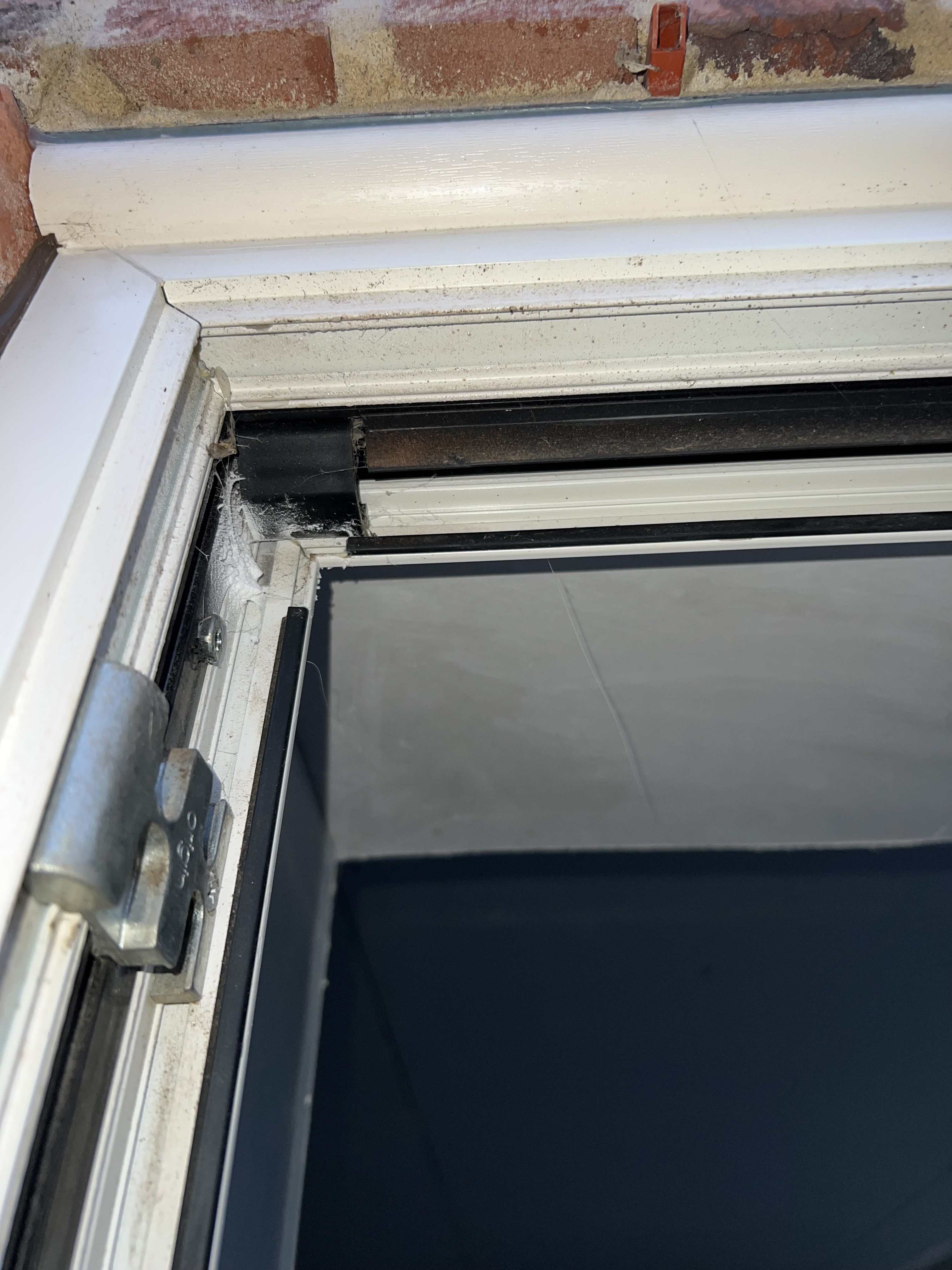

The stuff does get onto everything horizontal, i can attest to that. As it happens the spray nozzle connections to the tripods they use were a little leaky and sprayed goop onto 2 walls that required sanding afterwards. It is not visible on light coloured walls but feels horribly tacky if/when you rub past it. Check locations of the tripods if you use A/B for your build..
Do we know that this stuff will stay in place / not detetiorate as a permanent seal?
I'm wondering if some/ most of the seals are just a few fibres, because as soon as they cover a hole,ย  the draught ceases and no more fibres will adhere.

Youโ€™d need to see this for yourself, or accept my ramblings about just how good this is. Itโ€™s like pouring liquid PVA into a gap and it being left to cure.
ย
Itโ€™s nothing like fibres, just atoms of the โ€˜productโ€™ that hit each other, bond together, and then cure in situ.ย
ย
The depth of the gap / void / crack has the product disappear more deeply into, then as that closes less and less heads in, but when sealed itโ€™s a very good, penetrating seal. Itโ€™s like hammering more and more wedges into a gap I guess.
ย
In terms of longevity I would only think it would fail if left exposed and subject to mechanical wear and tear, but once covered over itโ€™s there to stay afaic.

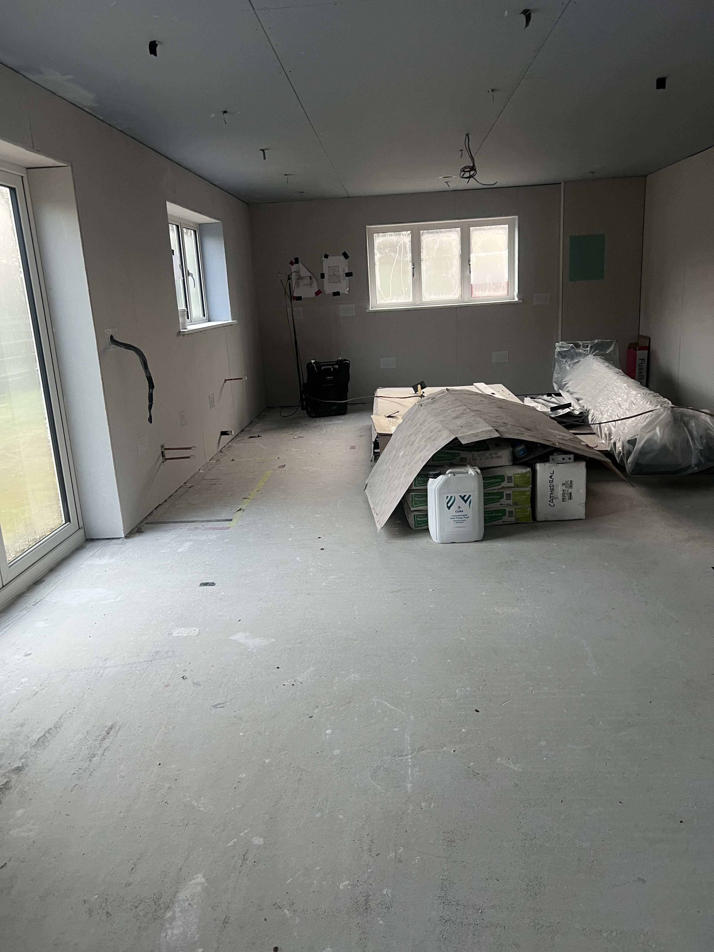

Is it done after boarding or post plaster skim?
Sorry, can be done before or after boarding, but Iโ€™d do it after boarding and all 1st fix, which iirc is what AB recommend.ย
ย
Doable either way in actuality, but youโ€™re responsible for then preserving the โ€˜treatedโ€™ exposed surfaces until theyโ€™re covered.ย

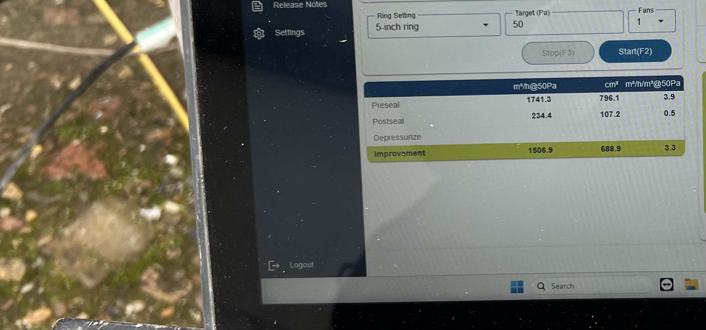

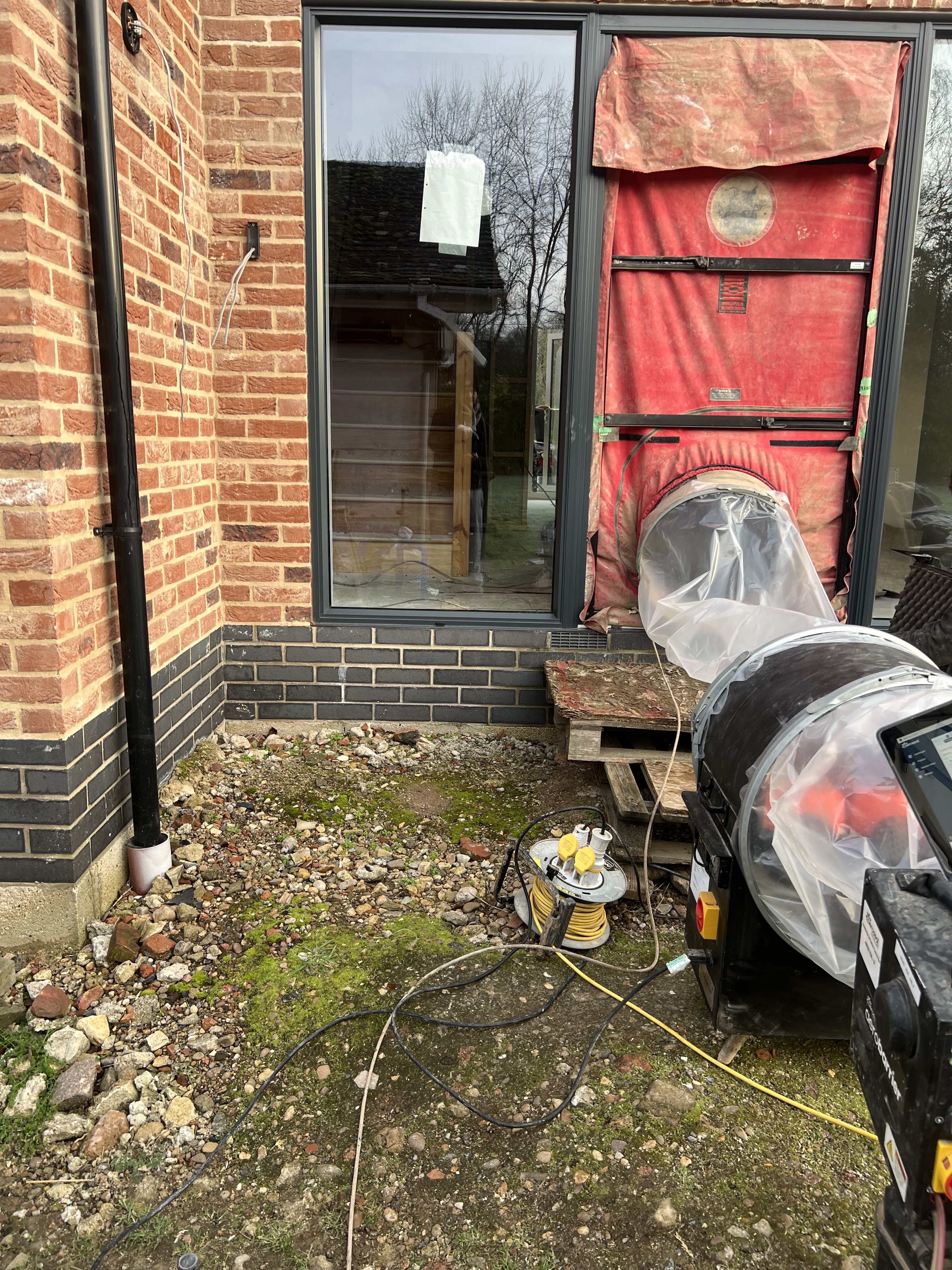

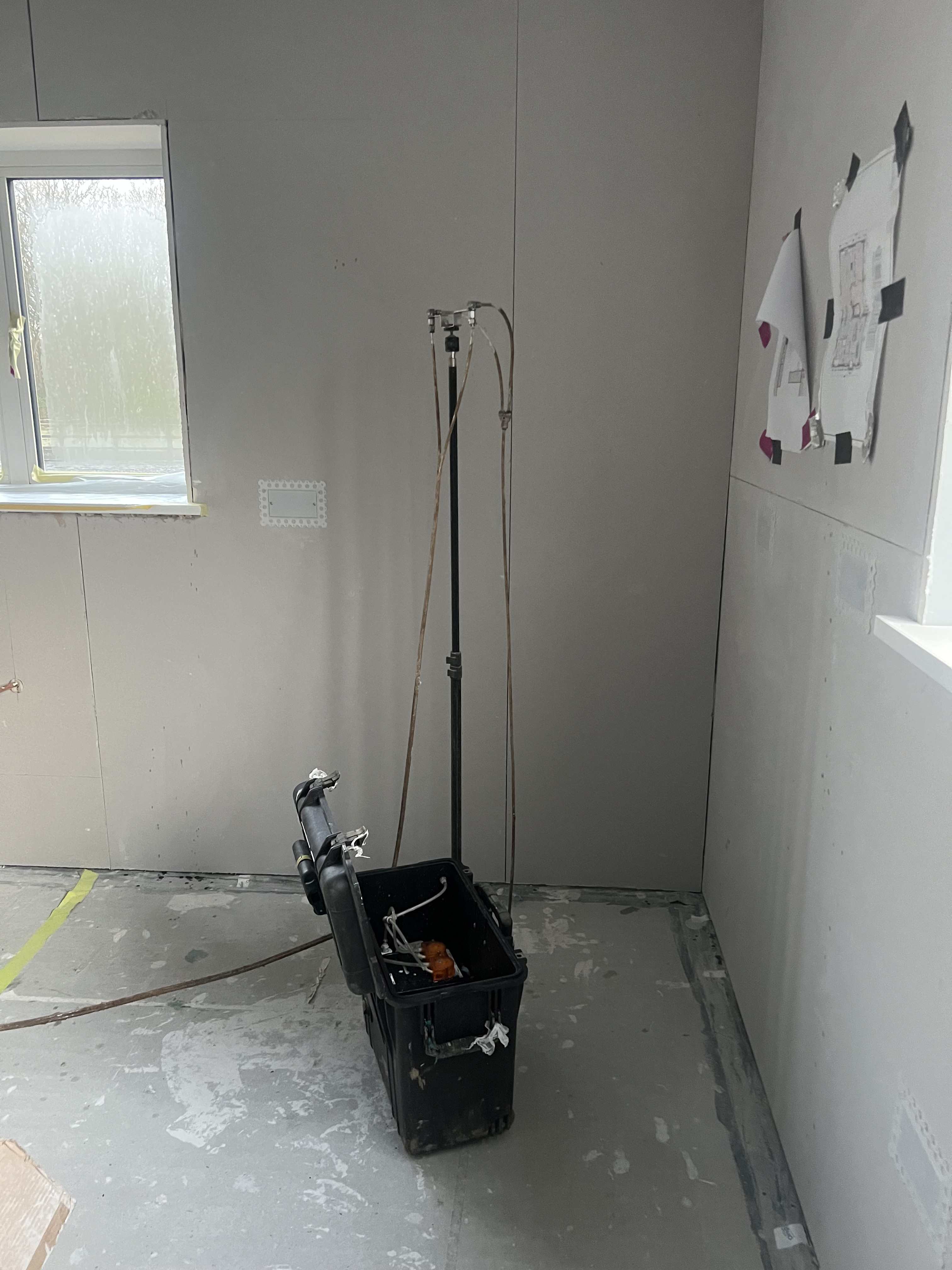

Big day today - Preseal @ 3.9, I guess i could have done a bit better - slapped wrist!ย ๐Ÿคฃ
Start and end, not measured in ACH, but once we get volumes the conversion can be made.
ย
ย
A couple of areas that need a bit of work, in fact most of the openings need attention.
ย
ย
An excellent improvement.ย
ย
That corner seal in the window is a bit gash though.ย I'd be having a word with the window man.ย
ย
Having gone to the hassle of manually doing this it's like climbing Snowdon and seeing there was a blasted train to the top when you arrived.ย

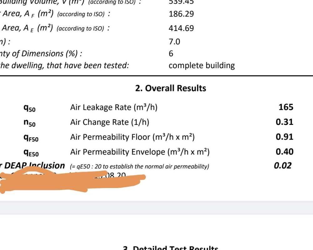

Half a cubic metre per hour per square metre of exposed area is considered quite good.
Has anyone managed that without filling the house up with glue?
Seem to remember that someone got a 0.23 m3.h-1.m-2.
Edited by SteamyTea
4 hours ago, crispy_wafer said:
A couple of pictures.ย
ย
ย
Is that pre-skim? Do you mind me asking how much they charged (per sqm?)
Yes, pre-skim, it was now or never really, plasterer starting next week.ย  AB managed to fit us in quite quickly.
