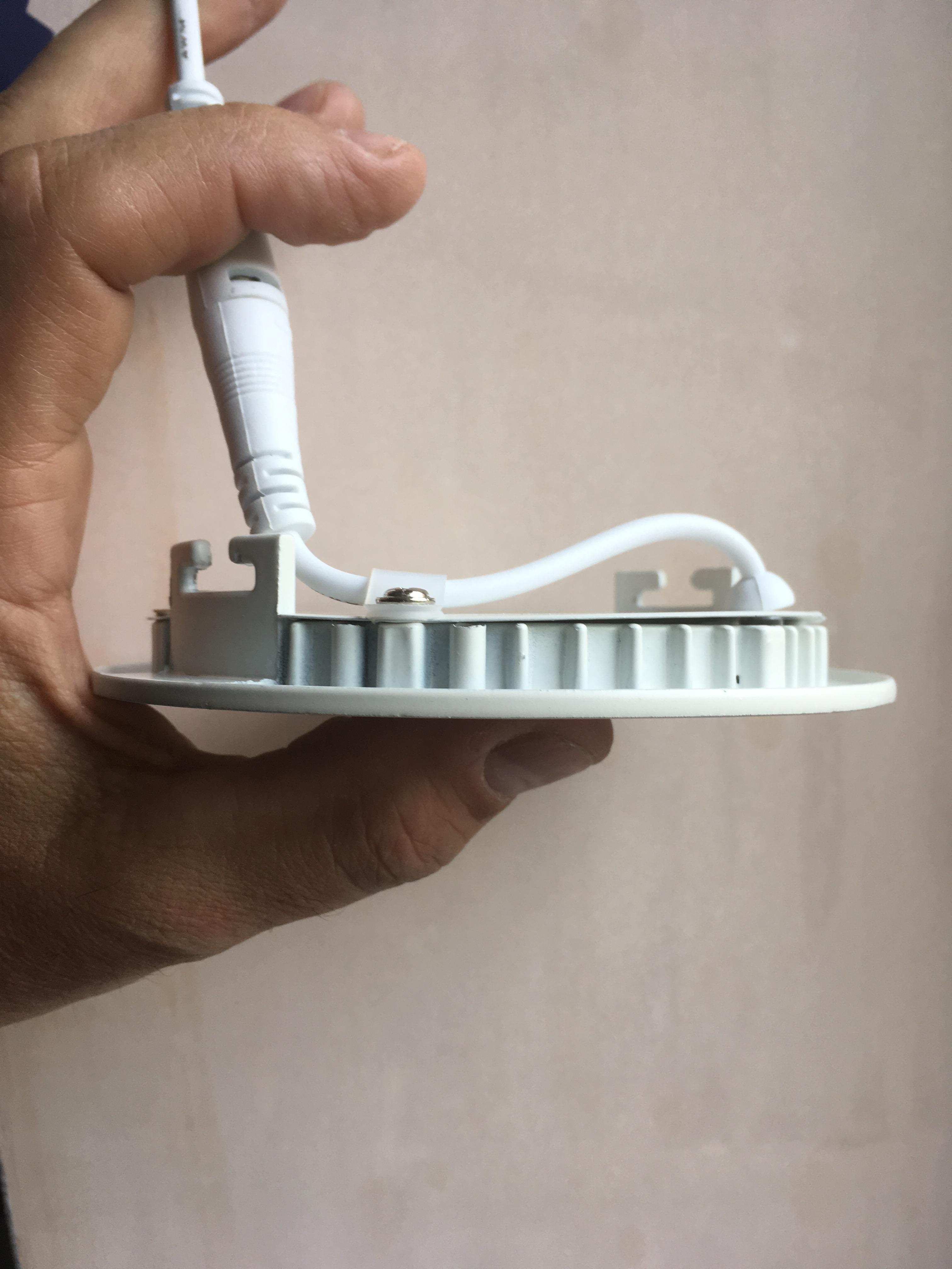

oranjeboom Posted June 8, 2018 Share Posted June 8, 2018 On 27/01/2018 at 18:47, Nickfromwales said: I use the recessed ones these days. They're only the thickness of the plasterboard + matchbox sized tranny, and the dispersion compared to spotlights is 10-fold better. Hi Nick - just dragging this back to the surface. I'm just insulating a vaulted area and want to minimise cutting into PIR (or at all if possible). Looking to see whether it's possible to just batten underneath the PIR, then fit the PB and simply recess into that using LEDs that have minimal height. Which 'recessed' ones have you used in the past. Something like this? https://cdn2.ledhut.co.uk/media/productattachment/1/2110/DLSLIM12WNEW.pdf Link to comment Share on other sites More sharing options...

oranjeboom Posted June 8, 2018 Share Posted June 8, 2018 2 minutes ago, PeterW said: I’ve got something similar on site - will take a couple of photos for you. Bear in mind that 28w led will be very bright ..!!! Thanks Peter, that'll be great. Hoping I can get away without faffing about on this one (VCL, cutting insulation etc). 28w - instructions from wife were "I want this area (hallway) really bright". Just following instructions. For once. Until I get the next set of instructions "These are too bright - why did you fit these???? I want something less harsh" Link to comment Share on other sites More sharing options...

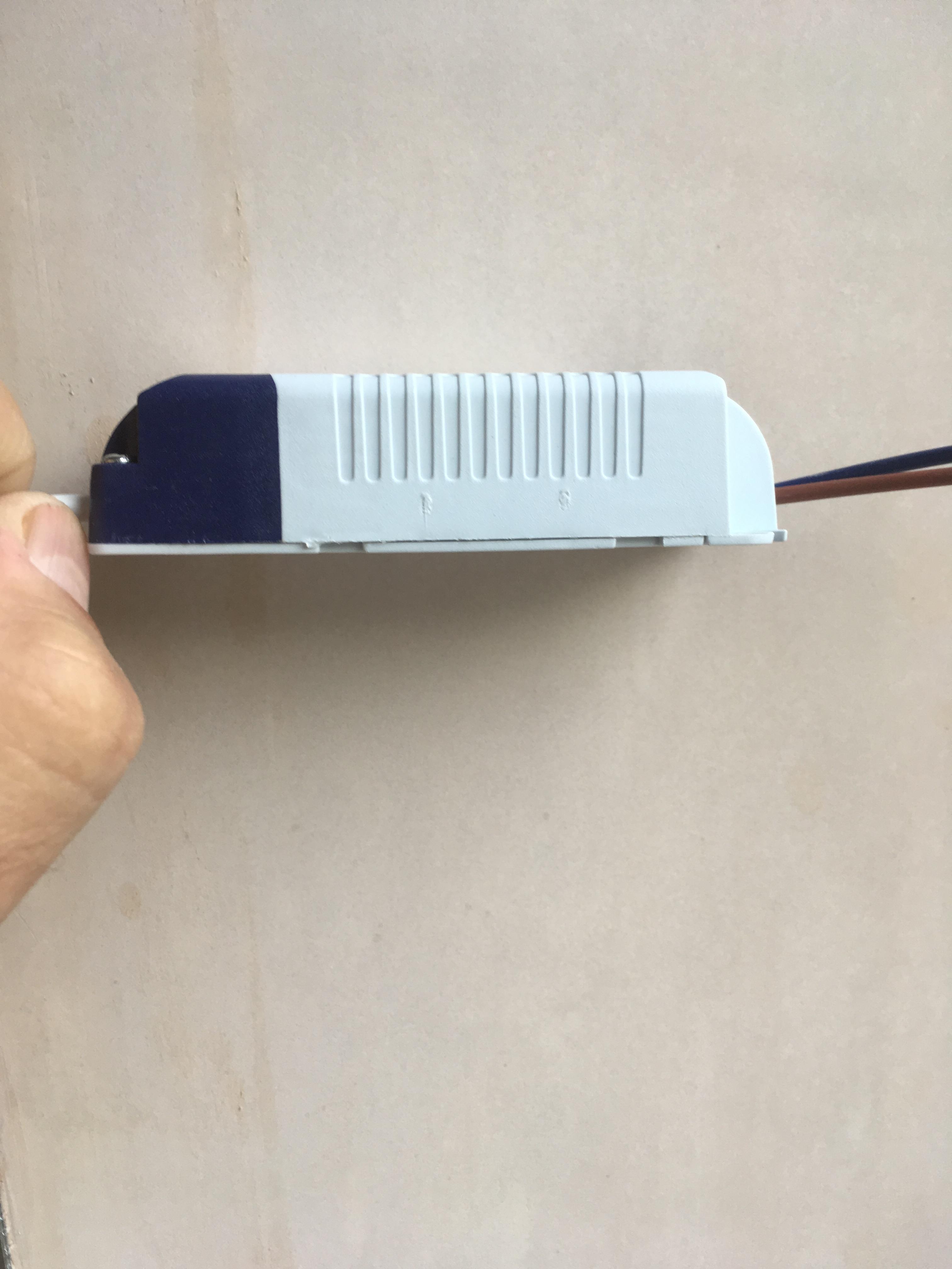

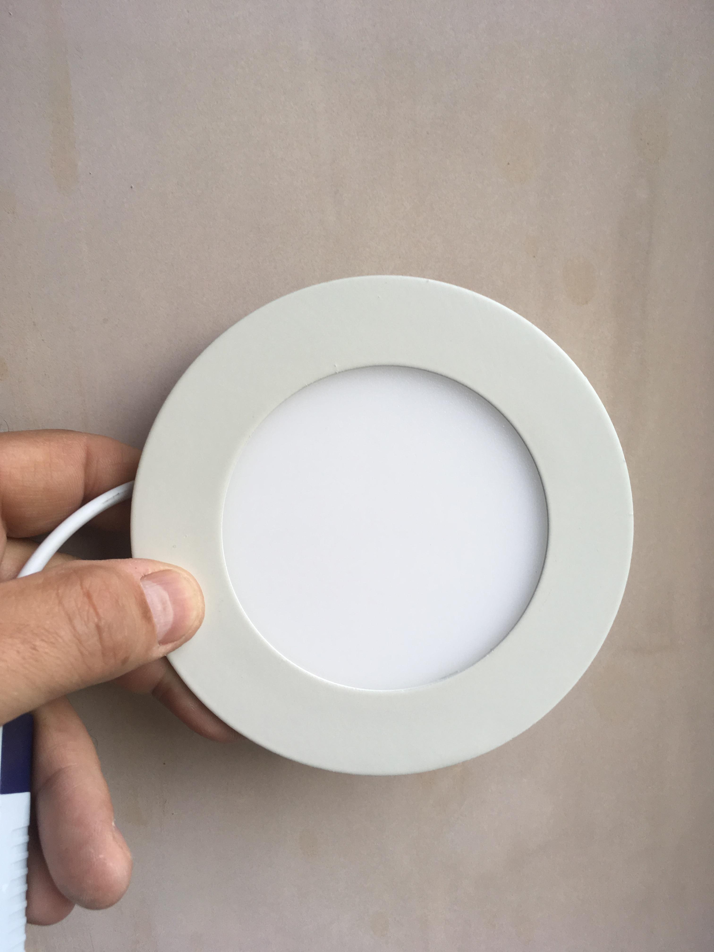

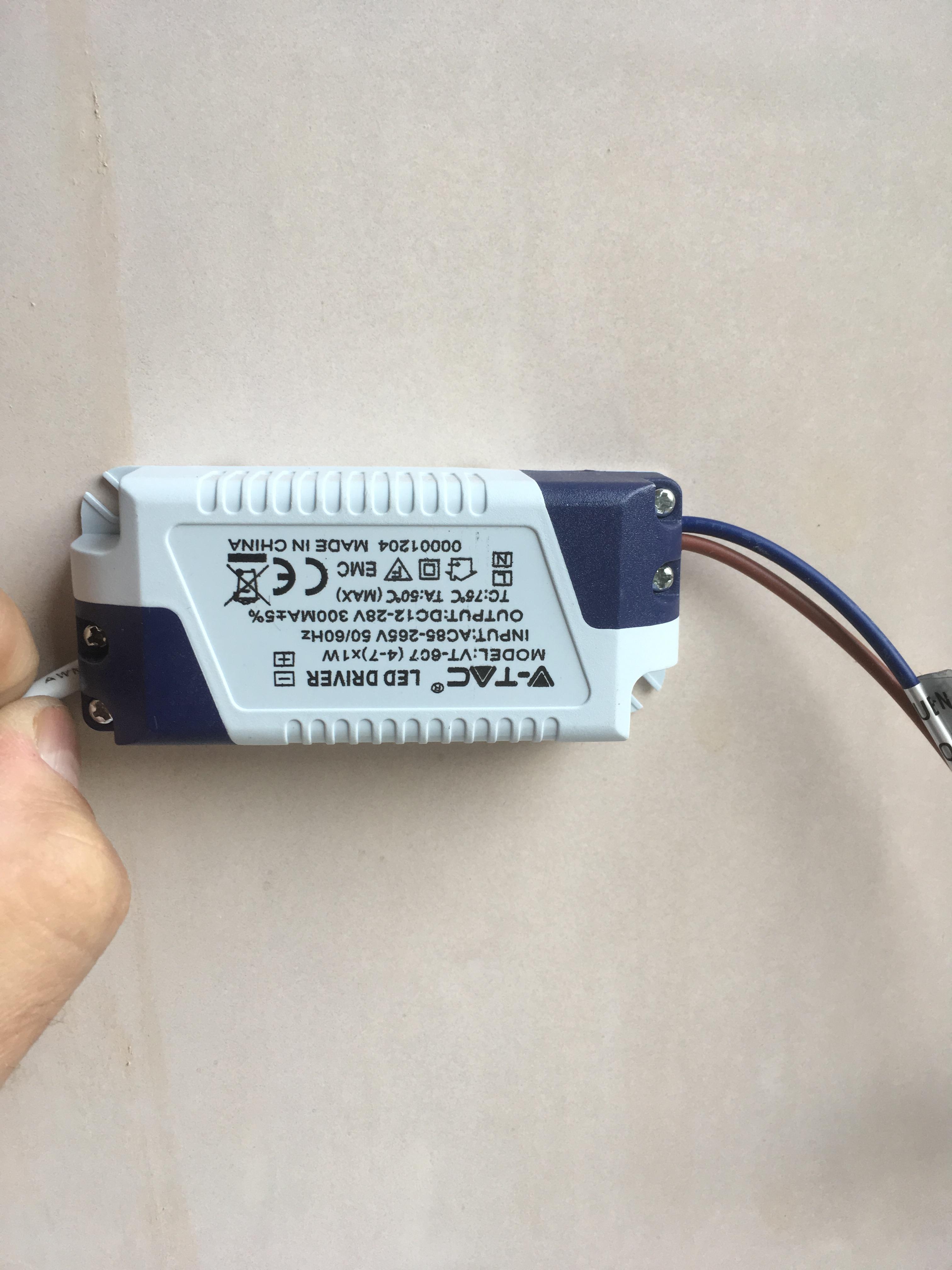

PeterW Posted June 12, 2018 Share Posted June 12, 2018 9 hours ago, oranjeboom said: Hi Peter....nudge nudge...☺️ These are the units - 6w 110mm cut out, 12mm thick Transformer is 90 x 20 x 35 mm Link to comment Share on other sites More sharing options...
Onoff Posted June 12, 2018 Author Share Posted June 12, 2018 So the 20mm high trannie will sit in his 25mm space? How warm does the trannie get? Are there any manufacturer's instructions as to clearances? Link to comment Share on other sites More sharing options...
oranjeboom Posted June 12, 2018 Share Posted June 12, 2018 @PeterW Thanks for the pics - that helps. I'll have to see how I can fix the LED unit into the plasterboard then as it appears it's a couple of screws 'sideways' that the bracket will slot into. Probably a couple of battens stuck to the underside of the PIR. Does each LED need a driver? And I guess they can be placed some distance from the LEDs? I was hoping to put them in an easy to get to location for future replacement rather then stuck between PIR and plasterboard. Link to comment Share on other sites More sharing options...
PeterW Posted June 12, 2018 Share Posted June 12, 2018 Transformer was not even warm after 20 mins - these are 6w LED panels so pulling 0.03A at 230v. I wouldn't even bother screwing into anything - makes it easier to remove ..! Transformer to light is about 180mm, transformer then has 80mm tails to a supplied push fit connector. Link to comment Share on other sites More sharing options...
Stones Posted June 12, 2018 Share Posted June 12, 2018 The ones I used were supplied with spring clips to hold the unit in position. Link to comment Share on other sites More sharing options...
PeterW Posted June 12, 2018 Share Posted June 12, 2018 Just now, Stones said: The ones I used were supplied with spring clips to hold the unit in position. Springs are missing off the light - think @oranjeboom is referring to the transformer. Link to comment Share on other sites More sharing options...
oranjeboom Posted June 13, 2018 Share Posted June 13, 2018 13 hours ago, PeterW said: I wouldn't even bother screwing into anything - makes it easier to remove ..! 13 hours ago, Stones said: The ones I used were supplied with spring clips to hold the unit in position. Was referring to the LEDs - I thought those brackets were for screws. But now I get it: So perfectly easy to fit if they come with clips. I was thinking it would be a right PIA to fit the buggers. @PeterW Did you get these from fleabay/online? If they are WA* on your side then I will be halfway correct already. *Wife Approved✔️ 1 Link to comment Share on other sites More sharing options...

PeterW Posted June 13, 2018 Share Posted June 13, 2018 36 minutes ago, oranjeboom said: Was referring to the LEDs - I thought those brackets were for screws. But now I get it: So perfectly easy to fit if they come with clips. I was thinking it would be a right PIA to fit the buggers. @PeterW Did you get these from fleabay/online? If they are WA* on your side then I will be halfway correct already. *Wife Approved✔️ Came from CPC along with the rest of the lights. Will see if I can find the product code as like most things if you order them in bulk they are cheap as chips ! Link to comment Share on other sites More sharing options...
