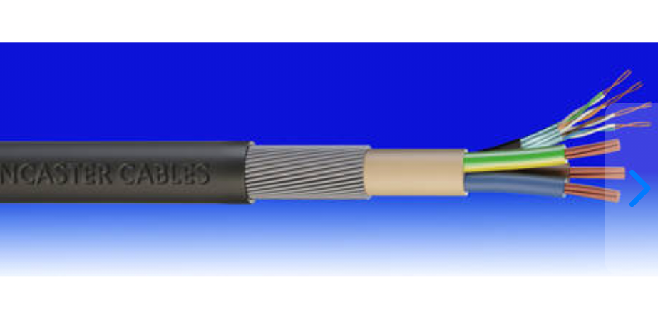

Here is an armoured AC cable.
Screenshot_2025-12-20-16-39-17-102_com.android.chrome.png.92a1b85d11552a3b7b820e2b830d3866.png
Notice you have:
Copper conductors
Layer of insulation (the coloured bit)
Packing material (beige bit)
Armour
Outer sheath.

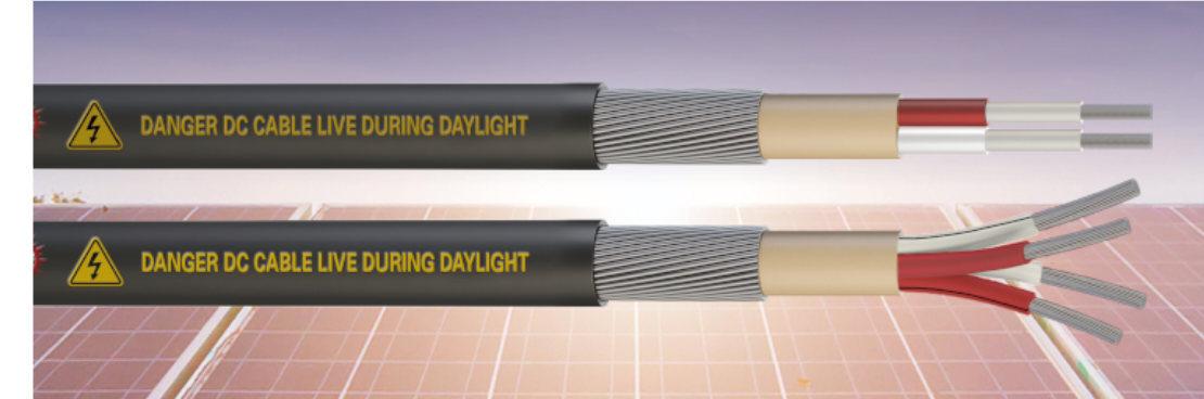

Here is an armoured DC cable
Screenshot_2025-12-20-16-37-16-659_com.android.chrome.thumb.png.ef15633e10ca999f492708e3d565fb8f.png
Copper conductors
Layer of insulation (white)
Layer of insulation (the red/white bit)
Armour
Outer sheath.
Notice the two layers of insulation around each conductor
You could use the top cable, it would physically work, in the same way you could just bury an extension flex in your garden to power your garage.
But it wouldn't meet the regulations.
For that you need the specialist cable.
