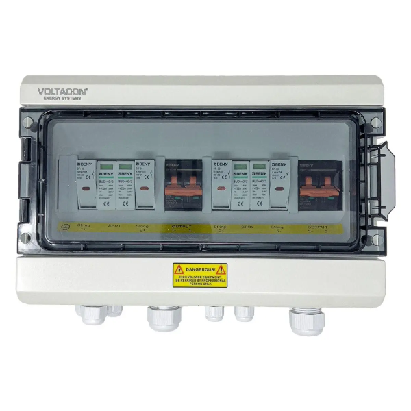

Surge protection, fuses and MCBs in loft from PV array.
Hi All
When I come to install my panels on my roof I was thinking of installing one of these in my loft (or something similar). I will have two strings:
Much of my thinking is that it would give me a way of terminating the solar cables and allowing me to fully connect up the array before I continue to do the rest of the cabling to the inverter on the ground floor. (Eliminating un-terminated high voltage cables seems like a good thing). I just want to check that this is a sensible thing to do. I have some nagging doubts:
The inverter already has class II surge protection.
Is the current protection and fusing necessary given that the arrays are inherently current limiting in their output?
If anybody wants to suggest putting in a DC islolator how does that square with the current advise not to fit isolators and rely on the inverter DC isolator?
Is there any alternative I should consider if any of this is unnecessary such as a simple termination bus bar. (Does such a thing exist?)
I am considering that I could probably do away with having to crimp my own MC4 connectors given that the Growatt PV input seems to be gland and screw terminal, not MC4 for the PV input.
Comments?

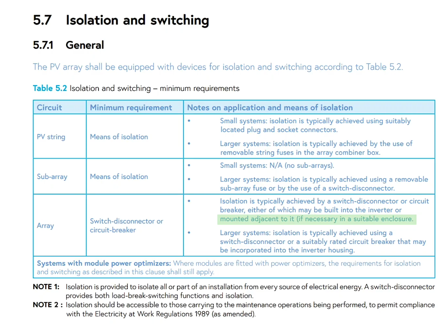

You do need to be able to isolate the DC supply from the inverter but you *don't* need a separate DC isolator *if* your inverter has a suitible one built in (which most modern ones do) Screenshot_2025-12-08-13-58-22-709_com.google.android.youtube.thumb.png.8615f8360fd50f5ea7766f9f7aacad6b.png
(The Institution of Engineering and Technology - Code of Practice for Grid-connected Solar Photovoltaic Systems)

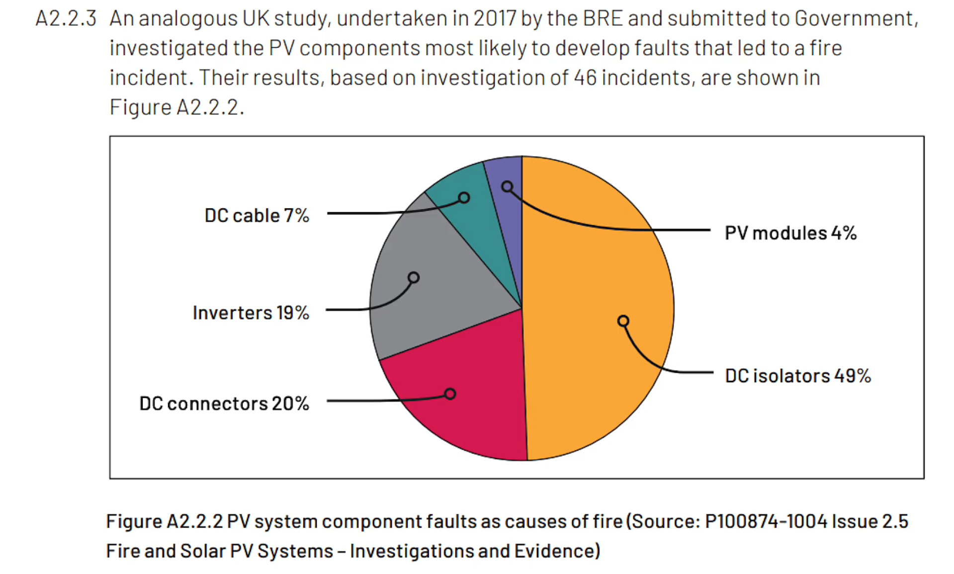

Statistically speaking, DC isolators have been the biggest cause of fires.
Screenshot_2025-12-08-13-59-47-923_com.google.android.youtube.thumb.png.57418f38eb22eaaaa87fa2f45414b0c9.png

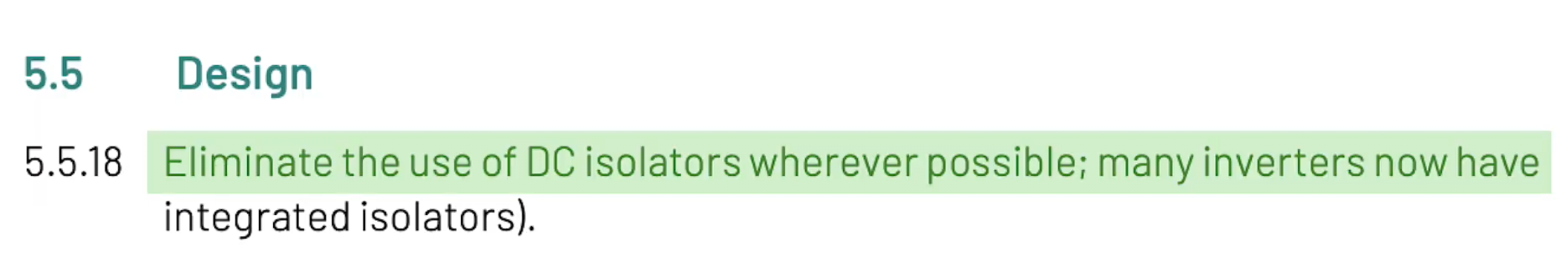

And as such the latest guidence says to avoid them (as long as you have a built in one).
Screenshot_2025-12-08-14-00-12-199_com.google.android.youtube.thumb.png.6b0e5ef477b9cf36b1af3b999465ff93.png
https://www.thefpa.co.uk/advice-and-guidance/free-documents?q=RC62 Recommendations for fire safety with PV panel installations

Elimination of DC isolators is generally accepepted, but unless the cables are surface mounted and identified with labels all the way to the inverter location you need a method of isolating the hidden DC cable run.  If you rely on the built in DC isolator in the inverter - and espescially if that inverter is fitted elsewhere in the property - that still leaves the entire run of field cables live.
Interesting figures on the failure rates of isolators.  I imagine this is mostly due to people not paying for regular electrical inspections.  For some reason the negative DC cable always seems to work loose over time in any screw connction, and its important to check and re-torque at regular intervals.   (The neutral connections on the AC side are prone to this too)
If this was taken out of the equation then the biggest failure boint would be the DC connectors - which sounds right to me as changing from MC3 to the MC4 'compatible' type connector was the biggest mistake ever made in the solar industry.

If you were desperate to have a "disconnection" point on the loft, might the solution be to have a fairly large enclosure with the DC cables coming in from the roof (having connected with the tails on the roof via MC4), through a gland and then terminate with MC4 connectors. Those then fit to mating connectors on thr DC cables running through the house (either in ducts or as wire armoured) to the inverter.
That enclosure could then be closed or even locked and a warning label stuck on it.
That would seem to be allowed by the table I posted. That would allow for the through house run to be isolated and use crimped, approved and maintainance free connections all around.
Assuming your inverter has the correct DC isolator built in.
