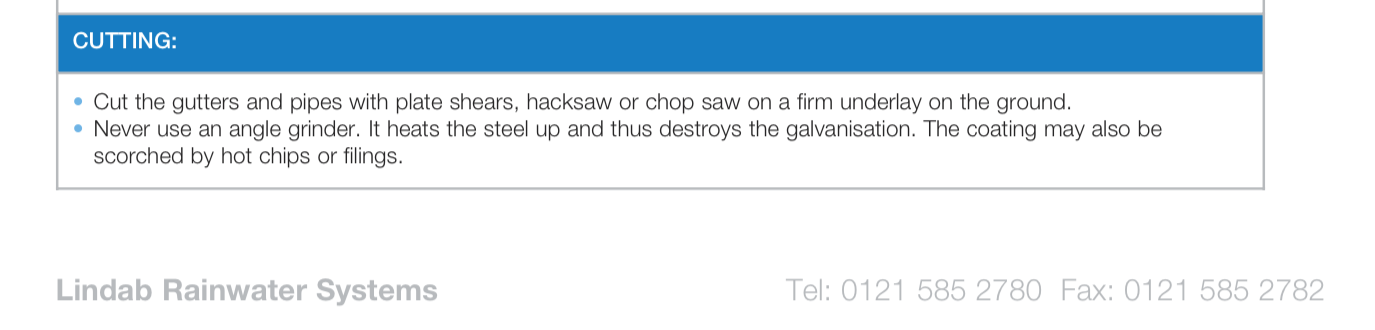

December 3, 2025Dec 3 fekkin' it up... I have some metal Lindab downpipe that needs to be cut - to install a diverter to a water butt. I'm happy about marking it out (use a downpipe bracket) , but I'm hesitant about cutting it. Why? 'Cos it's thin. Once it's been deformed (by me grabbing it and trying to keep it still) it never goes back into shape properly. Anyone know how to cut it cleanly without bending it at the same time? I've looked on Tinternet and on Lindab's own site without much success. Hence this post.

December 3, 2025Dec 3 16 minutes ago, ToughButterCup said: Anyone know how to cut it cleanly without bending it at the same time? I cut all our Lindab guttering system with a hacksaw as was recommended by Lindab.

December 3, 2025Dec 3 1 hour ago, markc said: If you need to cut into the down pipe, holesaw for round holes, dremel type machine with a cutting disk for straight lines / squares etc In the Lindab instructions they specifically say not to use power tools for cutting. The reason they give, is that using power tools destroys the galvanising around the cut. Apparently if hand tools are used then the galvanising is able to 'creep' back over the cut surface and maintain rust proofing. We didn't have any rust problems after six years.

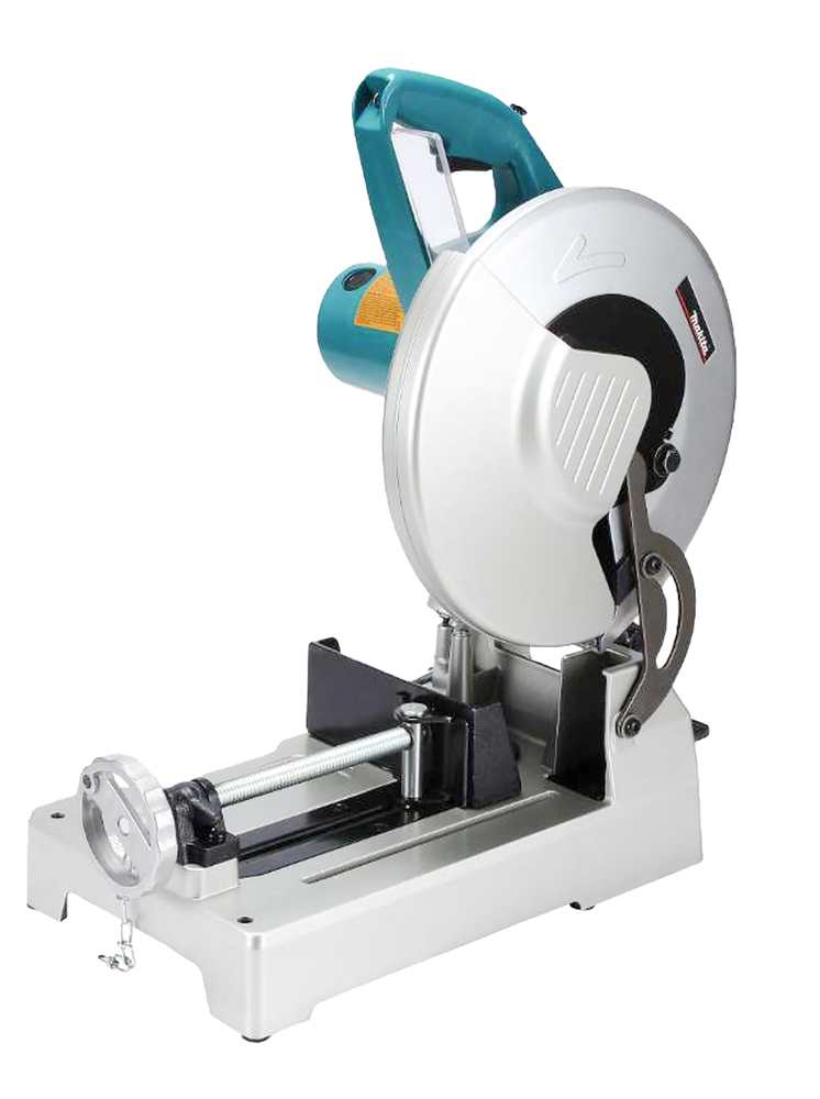

December 4, 2025Dec 4 Robin Clevett has a Lindab guttering install video on Skill Builder. If you fall down the rabbit hole far enough, you can find Lindab documentation that informs that you can use a metal chop saw for cutting the material. http://publications.lindab.com/UK/rainline-brochure/?Page=2&page=46 Even the product sheet for the downpipe mentions chop saws. https://www.lindabprofile.co.uk/wp-content/uploads/2021/06/Lindab-Downpipe-SROR-Data-Sheet.pdf Obviously a hacksaw is the simplest method. They also have touch-up paint for the cut edges and drill holes, how necessary this is, is anyone’s guess.

December 4, 2025Dec 4 I have used a chop saw. One of the Evolution multi material ones. Goggles are a must.
