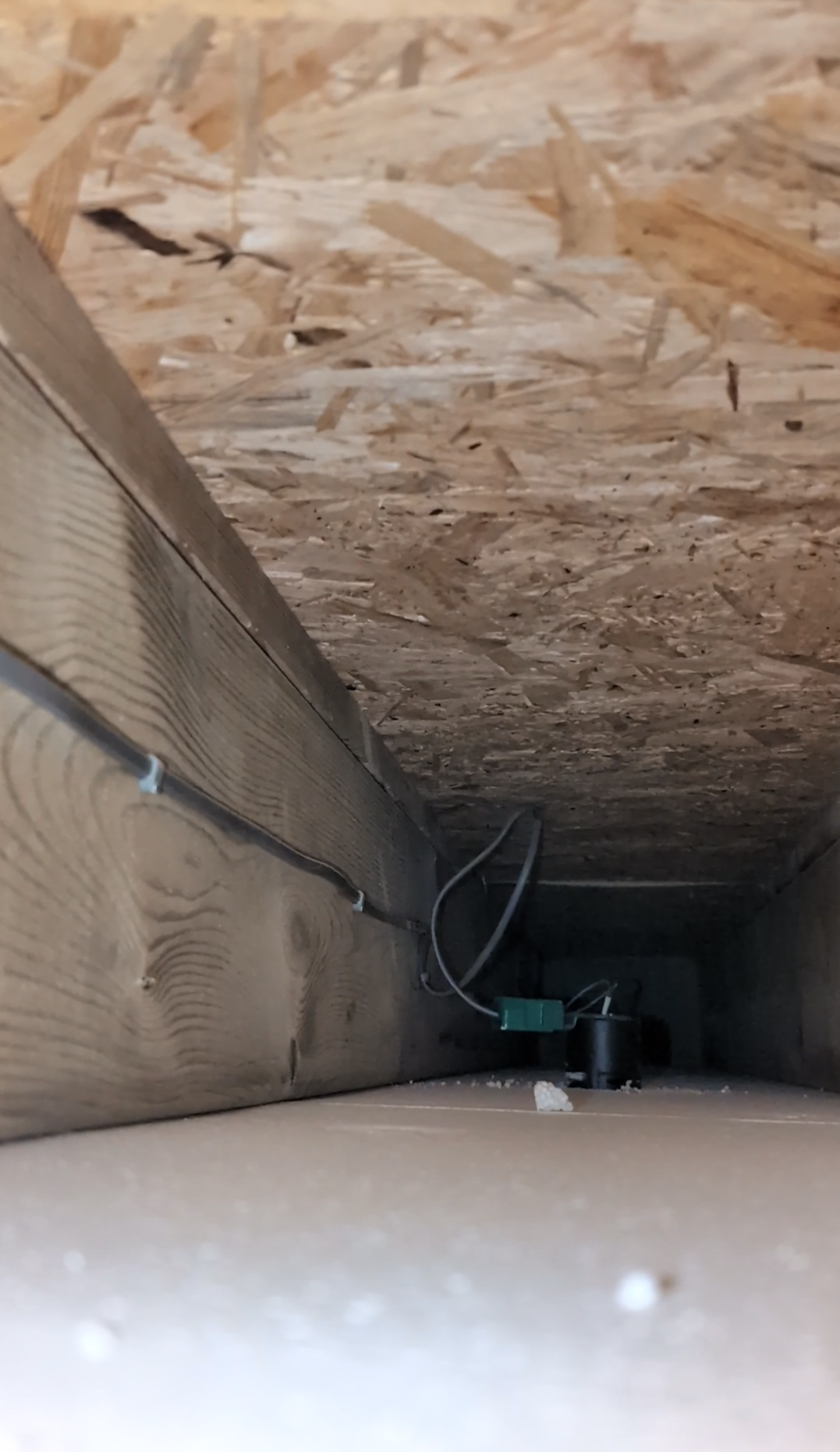

Hi, we moved into our house earlier this year which has a single storey flat roof extension on it. The hope was it would be lovely and warm, unfortunately we're finding it's not.

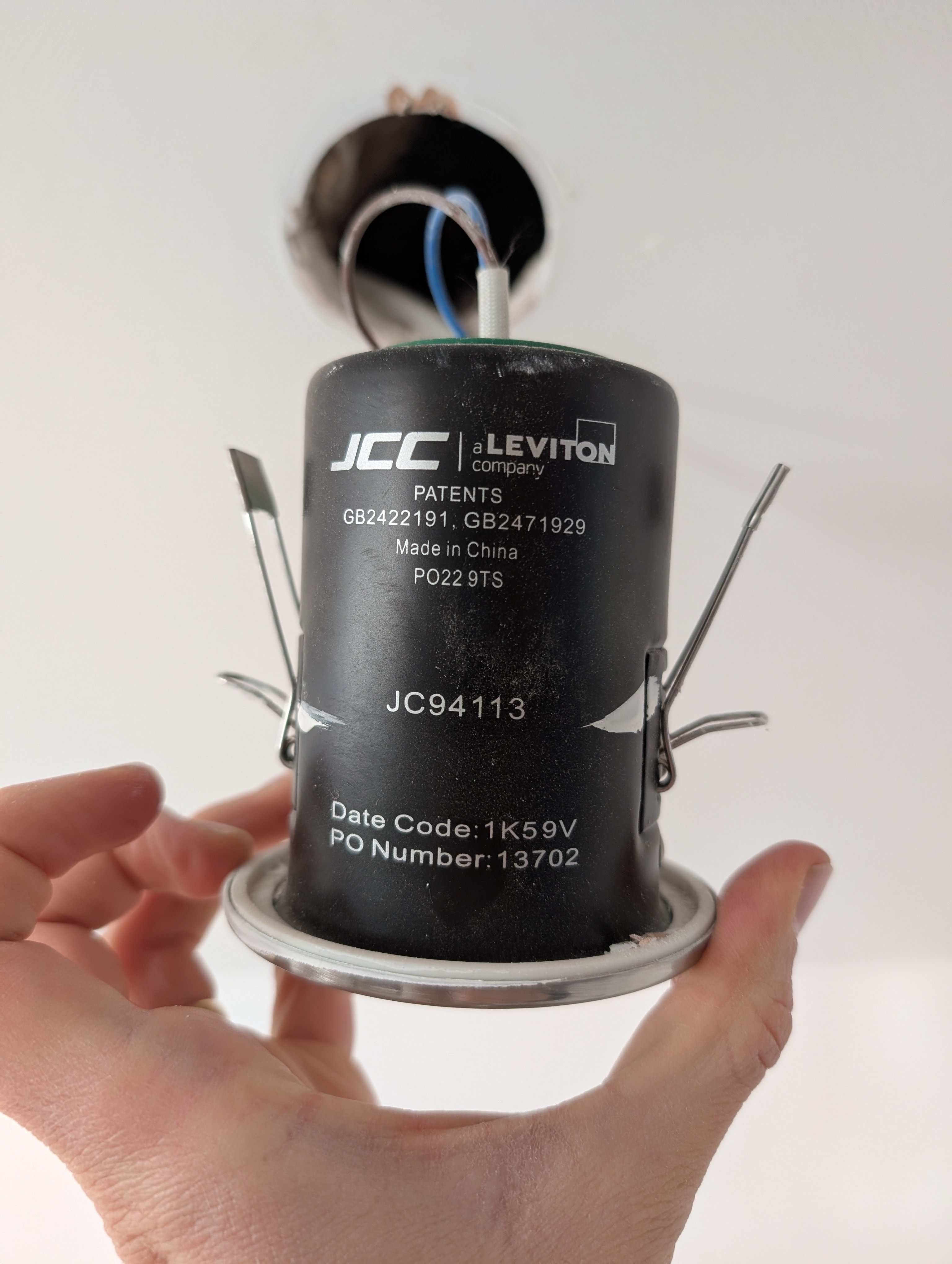

I took a downlight out yesterday to have a look into the ceiling void.

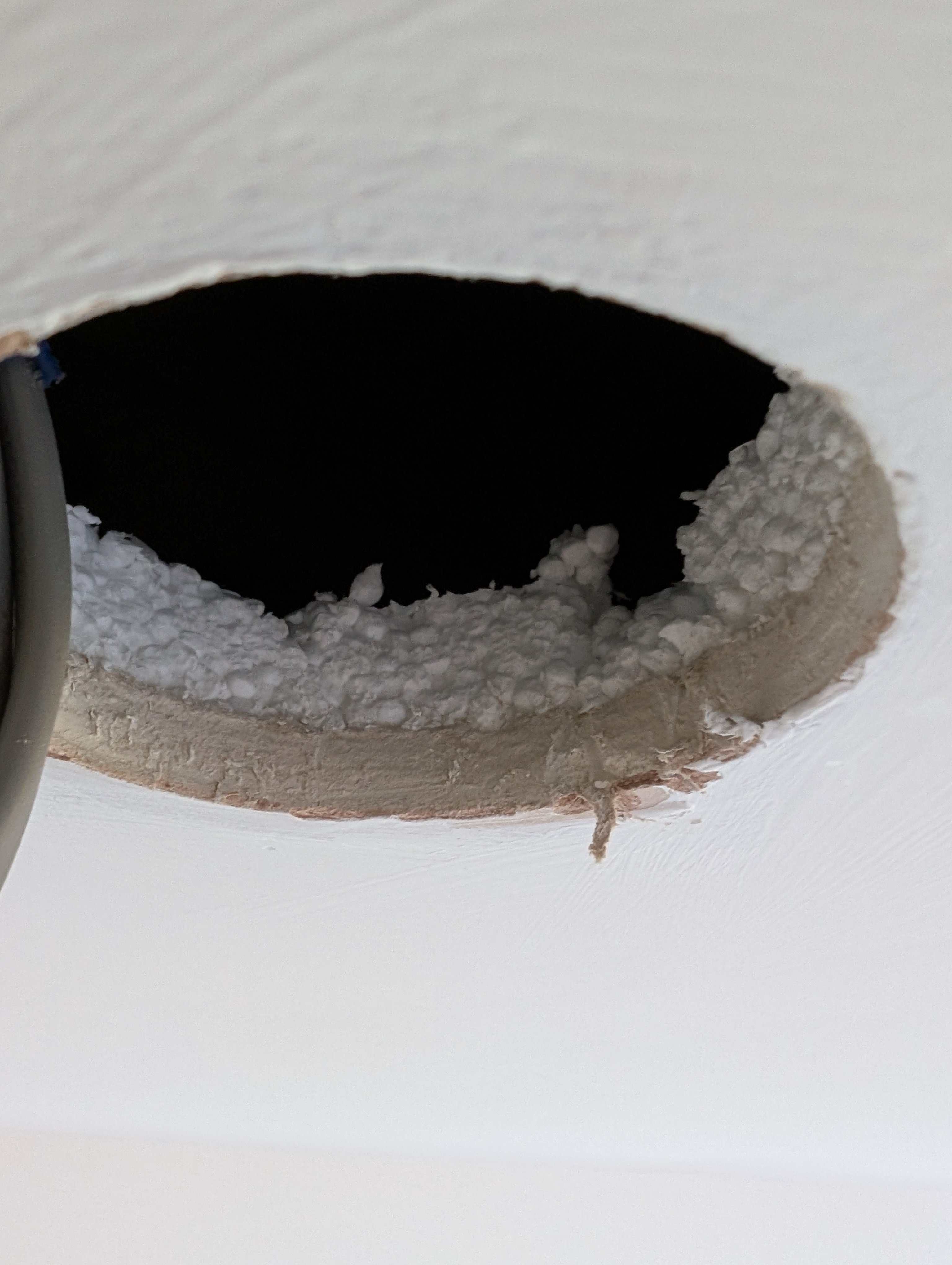

From what I can see this appears to be a warm roof. The ceiling is polystyrene backed plasterboard, there's then a void of around 200mm with a wooden deck. I am guessing (hoping) there is insulation laid above this underneath the roof itself.
The tiny amount of polystyrene insulation on the back of the plasterboard would not meet modern insulation standards and building control would not have signed it off (I am guessing).
This void appears to be pretty drafty and cool, so guessing there's some leaks somewhere. It's very difficult to find out exactly though as there's no access of course.
One thing I am considering is overboarding the existing ceiling and lantern vertical sections with 50mm backed PIR insulation and then making it as airtight as possible to minimise moist air reaching the cavity. We have plenty of ceiling height to do this.
Any thoughts on this approach?

Is the wiring in contact with that EPS insulation when it 'lies down'? If so you want to sort that. EPS leeches the plasticisers out of PVC cable sheathing.
How well-built is that structure? Do you think there is any risk that external air will circulate between the EPS and the OSB at the top of the joists? If so, even if it is a Warm roof (with, say, a minimum of 150 PIR above) the 'Warm' roof element may be doing very little.

If the void is drafty, then the top roof, even if it is a warm roof is not doing anything ! The first thing to do ia as @Mr Punter said. Take some measurements, and establish if you have a warm roof. If you have then it will be the usual, (seen it many times) the insulation will not have been carried up to the top roof level. So many builders dont seem to have a clue how to build a warm flat roof.
If you have a warm roof with a decent depth of insulation above that boarding, you would be better off ripping the ceiling down. Pir between all the joist ends. Foam the pir in with some decent air tight foam, (Not the crap you but in the sheds) You do have to get all around the outside walls, so if you find a joist close to the wall, come back to us. to get to these areas, you may need to remove the facia boards.

No.wasting your time IMO. If you have a draft in the void, and a warm roof above.......You have a badly built extension. certainly a badly built roof. Do some measurements and find out if you have a warm roof.

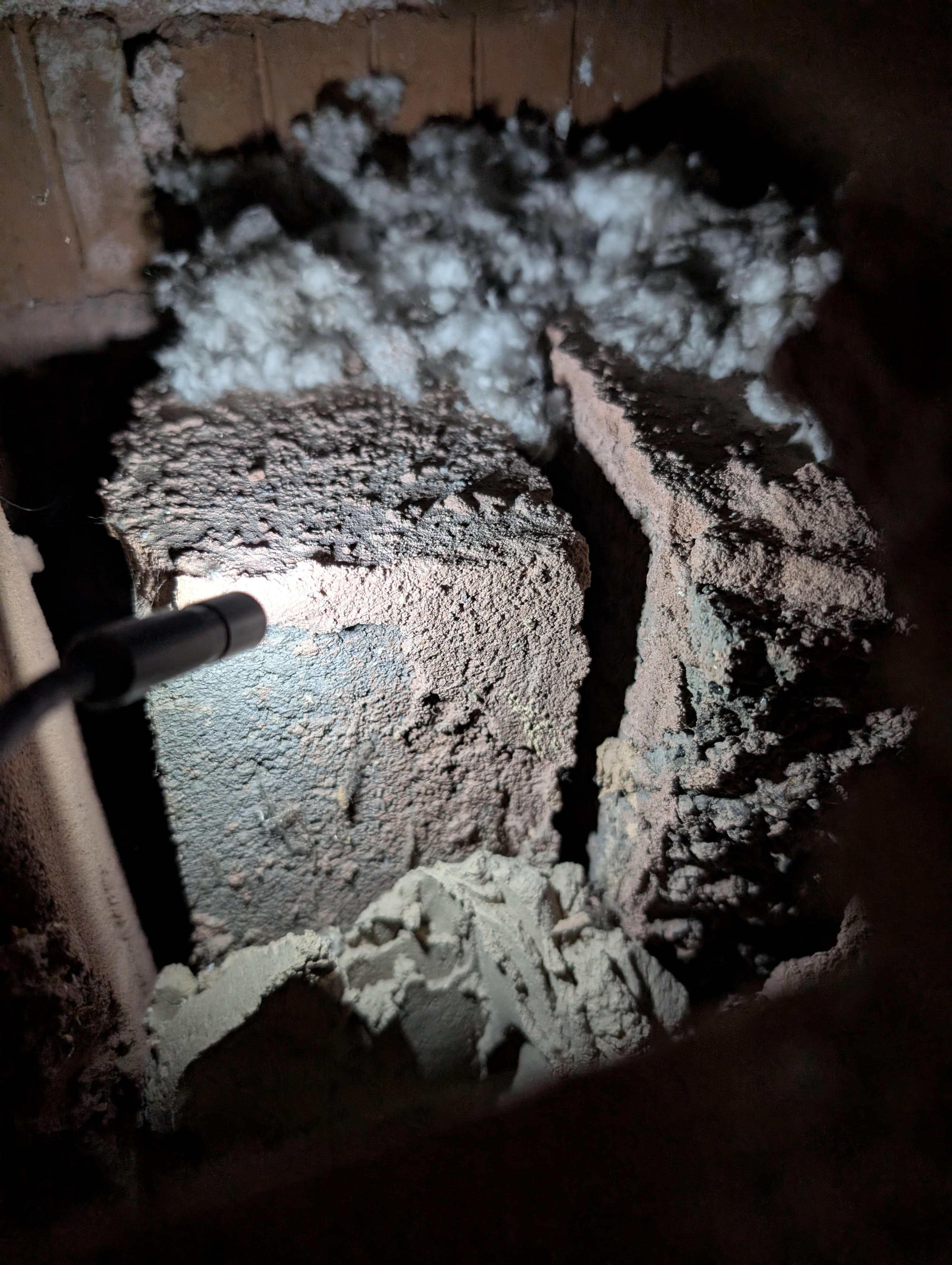

Back to it, I would expect there's 1-3mm gaps around your joists if they sit into the wall, and air is coming in here. Pack these with something, mortar, caulk etc, and when dry paint with the airtightness paint. Then carry on with Jimbo's instructions re sticking PIR in place, or fill the whole ceiling between the rafters with insulation.

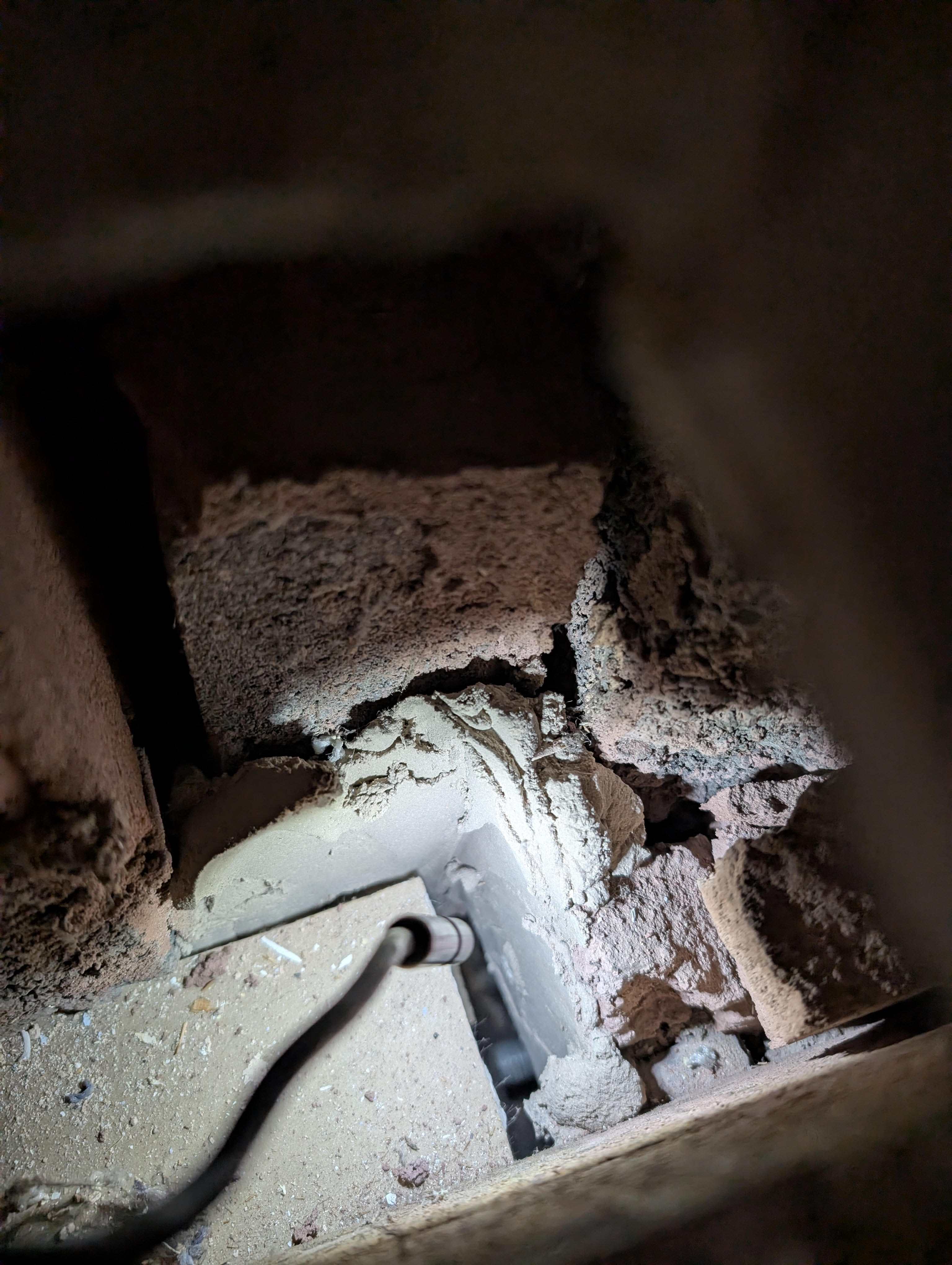

I got a reply from building control inspector along with a photo - it's a warm roof with 150mm PIR above the deck.
Interesting you say the leaks may be coming where the joists rest on the walls. I'm prepared to expose these to try and fill them but I suspect there is a bigger draft coming from somewhere to be honest. And on that, my sons bedroom in the corner of the 1st floor is freezing, and there's a draft. We've taken the skirting up and exposed the corner and it looks like a complete dogs dinner (see photos). The cavity is compromised, there's a draft coming in here and you can see down to the steel that was put in as part of the extension. I am wondering if the draft is actually coming from a cold roof, which is adjacent to the extension.
Any thoughts/suggestions? I have gone back to building control to see if they can provide details of the tie ins between extension and the property and asked if they would come out and have a look (slim chance but who knows).
Well that will save you having to measure!
It is now a case of identifying where it it leaking and I can see you are doing some decent investigation.  If you can Identify and seal the leaks with, say mineral wool, you will not need to add more insulated plasterboard.  Maybe a 100mm hole saw to remove some plasterboard around the perimeter will give you some clues.

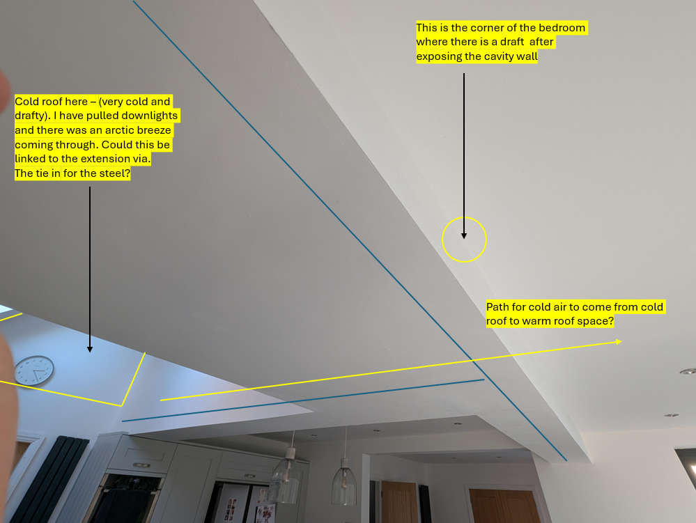

Before I start punching holes around the perimeter I wanted to sense check an idea the father in law had - could the draft actually be coming from where the steelwork has been tied into the existing house where there's a cold roof space. Is it worth putting a hole somewhere in this area, if so, where would you suggest? Assuming there is a crossover here between warm and cold roof spaces, how would I then go about sealing it properly?
Yes, the intersection is the most likely place.  Can you get any drawings from the Building Regs submission?  These may give you a clue where things have been left and just boarded over.  There is often no proper spec on the drawings for how these things should be detailed so they can often end up causing issues.

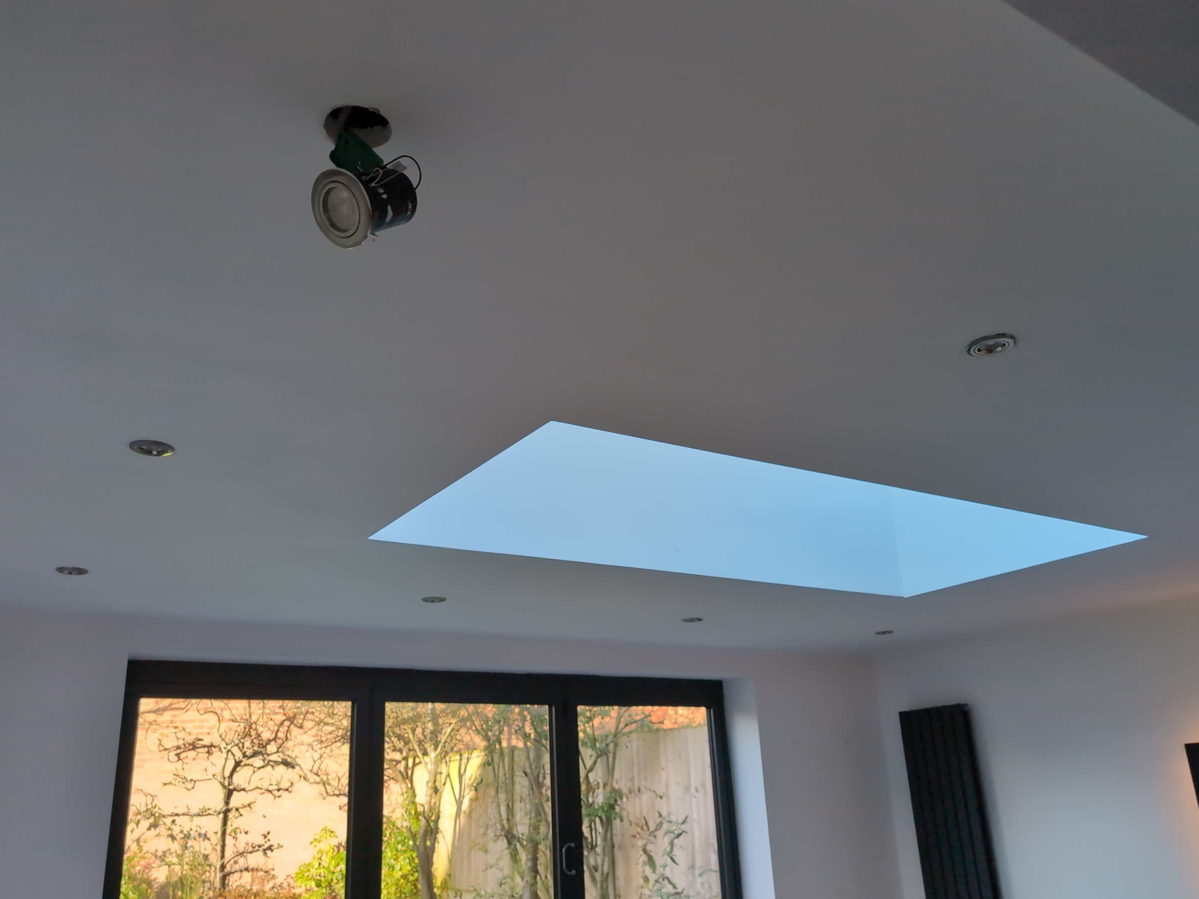

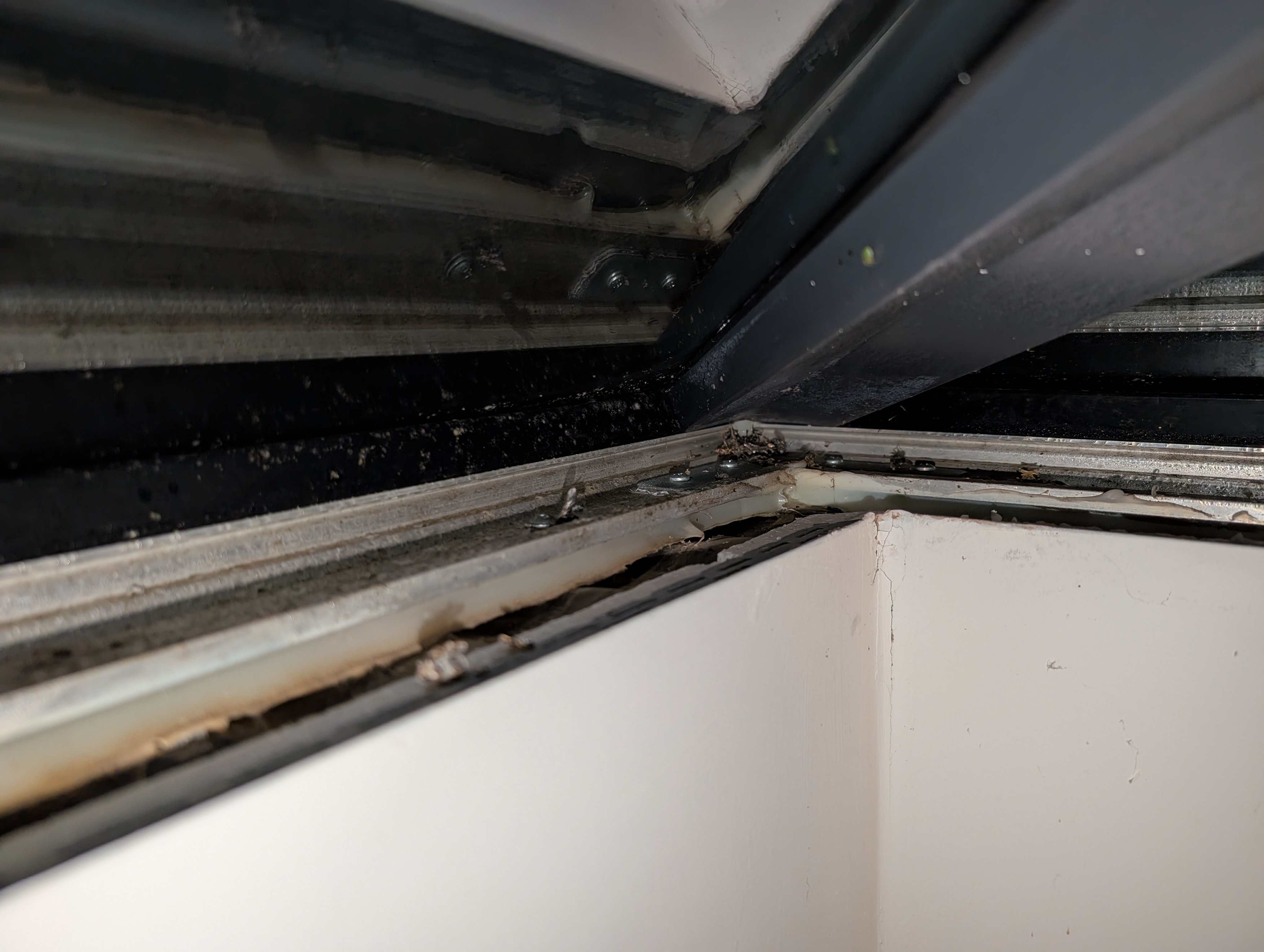

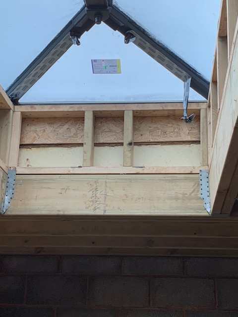

Decided to put a ladder up to have a look at the lantern yesterday night. Think I've discovered the main cause of the breeze! Fresh air coming straight in, condensation and some mould growth to with it. Going to attempt to weatherproof this over the weekend with a mixture of some low expansion foam for big gaps and then silicone over the top. Quality absolutely shocking!

Quick update I pulled as much badly sealed silicone out from the lantern as I could. Massive gaps where I could see daylight. They'd obviously attempted to bed it on silicone but it was so badly fitted mechanically it was never going to give a reliable seal long term
I've filled the void with low expansion foam and my plan is to silicone inside AND outside edges, so foam isn't exposed to UV/weather etc. would this make sense?
Appreciate the feedback and whilst it wasn't us who took on this building work really puts me off doing anything going forward as you say need reliable testimonies where you can actually go and look at the quality.
Makes sense to me! That'd be my approach to it I think.
