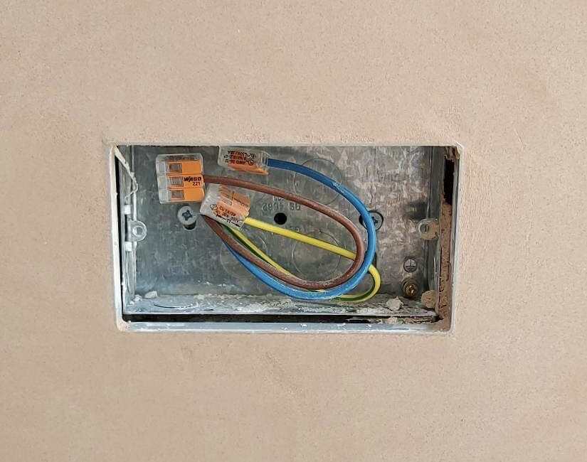

November 23, 2025Nov 23 1 hour ago, Lincolnshire Ian said: and maybe noggins to support the back box Aren't you using this sort of back box with plasterboard, so no additional supports are needed?
November 23, 2025Nov 23 24 minutes ago, Oz07 said: Normal as it is. I'd say it would be unusual to plasterboard 1 side first. They will bang their own noggins in as needed. No stress This. Dry lining/plasterboard boxes are not as good as metal knockout boxes and nogs in my opinion. If one side is already boarded it can sometimes make it slightly trickier to wire, so prefer not.
November 23, 2025Nov 23 It's a personal thing but I like dry lining boxes. Buy the Appleby ones like the picture above, they are good and reliable. Some other makes with different methods of locating them can be dreadful. My top tip. Run socket cables horizontally around the room at socket height all the way round, with a bit of slack in the cable every now and then. Then in the future you can cut an extra hole in the plasterboard anywhere and add an extra socket, you know the one you forgot you might need.

November 23, 2025Nov 23 11 hours ago, ProDave said: It's a personal thing but I like dry lining boxes. Buy the Appleby ones like the picture above, they are good and reliable. Some other makes with different methods of locating them can be dreadful. My top tip. Run socket cables horizontally around the room at socket height all the way round, with a bit of slack in the cable every now and then. Then in the future you can cut an extra hole in the plasterboard anywhere and add an extra socket, you know the one you forgot you might need. Appleby boxes have always been my choice as they are generally the best. It’s is annoying though trying to use them when it’s double plasterboarded. Also, when using dry liners in general, if you fit them before plaster skim, make them a snug fit or they’ll move and pull a lump of plaster out at second fix. Why they set the locking tabs on the Appleby boxes at roughly 15mm thick, rather than 12.5mm (so they wouldn’t move) I will never know!! If you fit them after skim, then you will have a fairly ugly lip, visible with flat plate sockets etc. Also, if you want to remove one for access, and it’s fitted before the skim, it will make a mess to some extent or other. You also can’t fit them hard up against a stud as no room for the wing. Also, it’ll be an extra visit to the job if fitted before the skim as can’t be done at 1st fix. For all those reasons it’s knockout boxes for me! FYI if you want the Appleby boxes get them very soon. They are already disappearing from the wholesalers in my experience recently. I’ve moved over to the Click essentials ones. Can be used with double board and the lugs don’t flop around like some of the cheap stuff does.

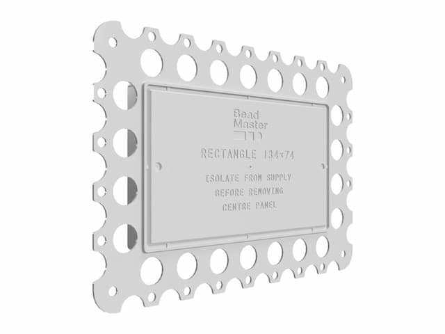

November 23, 2025Nov 23 I'd always go for metal boxes on noggin rather than dry lining boxes. I think they are too flimsy personally. If you want a good finish, I'd highly recommend socket and switch beads before skimming. They make a fantastic finish.
November 23, 2025Nov 23 These may be of interest... https://www.tlc-direct.co.uk/Products/FXTWB24.html And https://www.tlc-direct.co.uk/Products/FXBS.html And https://www.cmsdanskin.co.uk/refurbishment-noisy-neighbours/noise-reduction-for-building-elements/karma-putty-pads/ And https://www.youtube.com/watch?v=GWoK3iBatCc https://youtu.be/VltFR-kXtcw?si=zuMMtrpVDckEyvoK
November 24, 2025Nov 24 I do like them Beadmaster socket and switchbox covers, my only problem was cutting the holes for the backboxes too tight for them to fit so I had to spend a morning wizzing round trimming and cleaning up.
