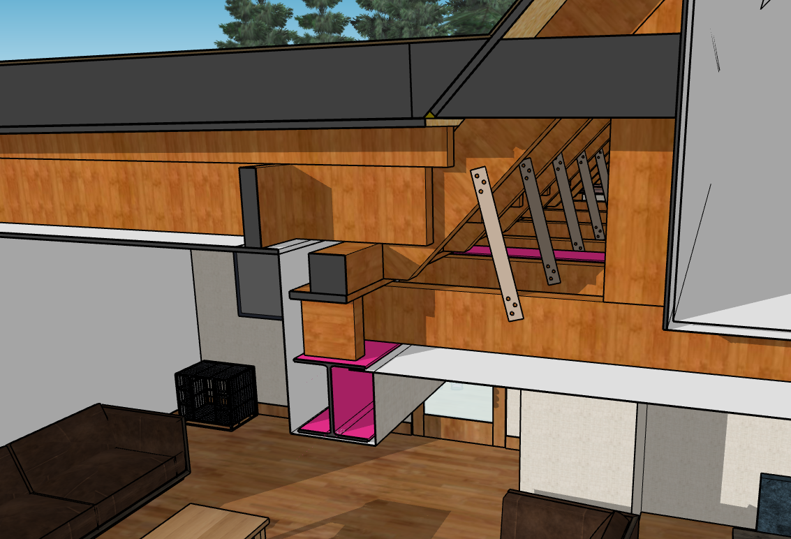

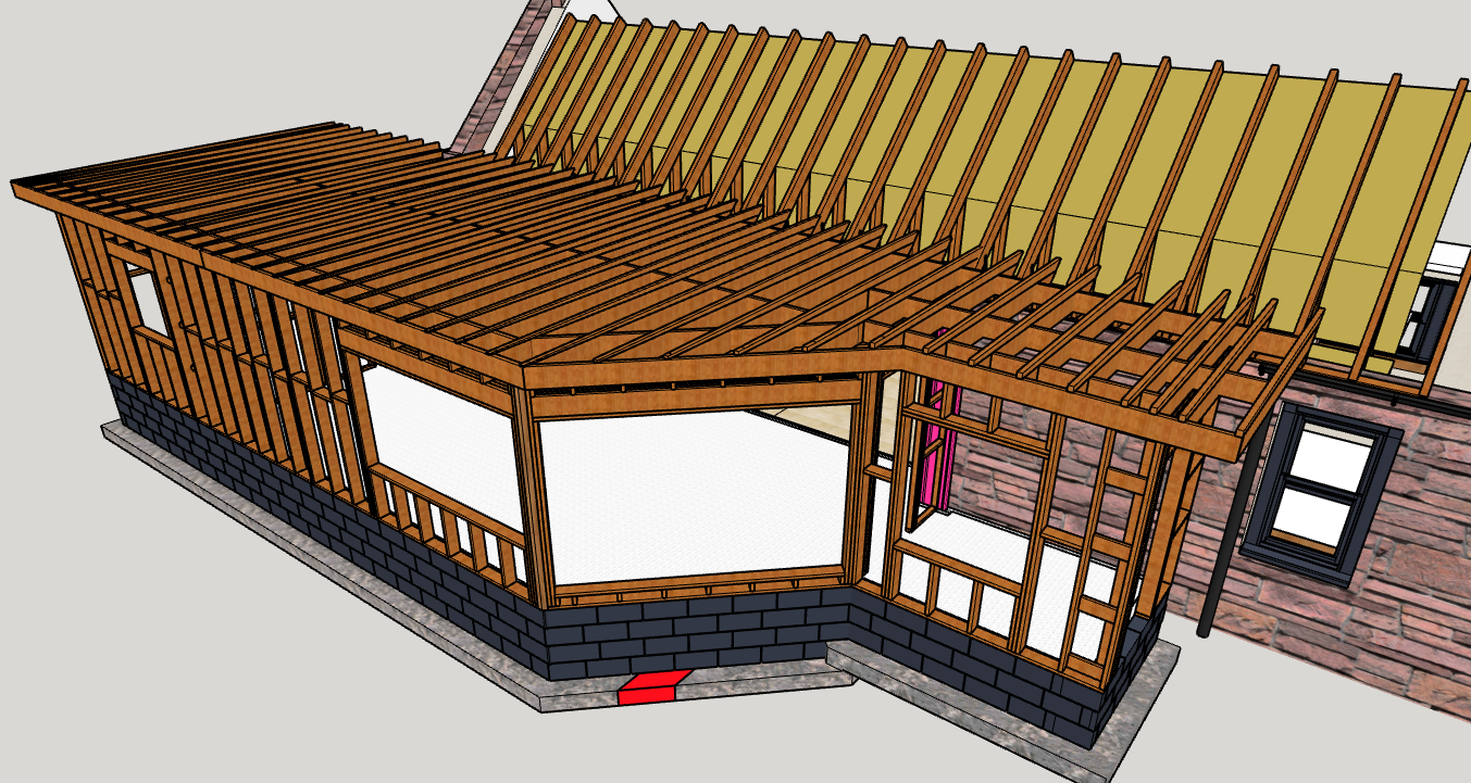

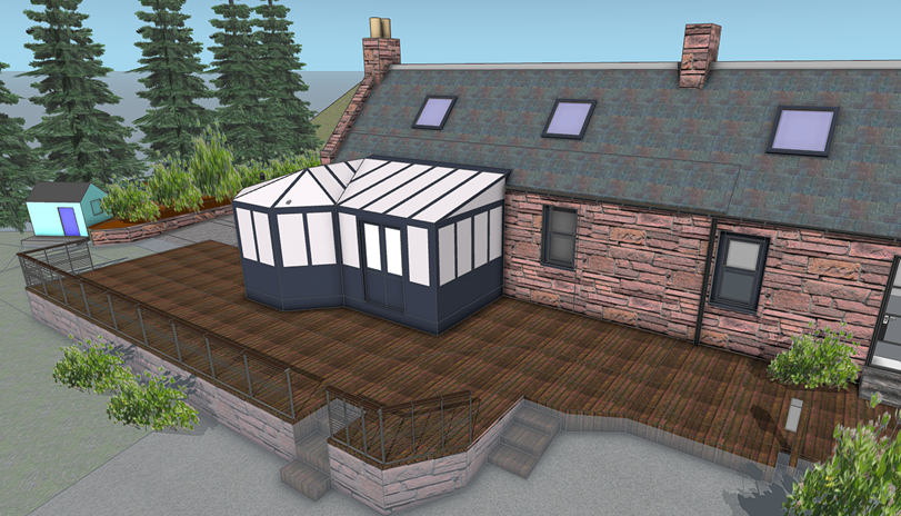

Ok, fair enough.  Not complete and meeting with structural engineer tomorrow, but here we go...attached are some of the drawings as they stand.
I'm based in North East Scotland so Scottish Building Standards apply.
I'll post some images too for reference.
Existing sunroom...
New structure...
If anyone wants to see any specific areas then just ask.
Oh, and please not that the steel has been reduced in size slightly so the flat roof timber looks like it's floating 50mm above it.  I'm not updating the structure yet as engineer might change things anyway.
All comments welcome!!

Posted
A few small points:
Maybe look at a fire resistant membrane on the walls.
The box gutter may fail at some stage and possibly rot out the walls.
The Kingspan phenolic insulation is good (better insulation and fire rating) but expensive.

I've also made a few changes.  Structural engineer recommended going with a beam under the existing roof joists to keep the build simpler and cheaper.  After chatting through and thinking of the implications of the old timbers being varying lengths and sizes I've grudgingly agreed and changed the design.  Means I have a boxed in steel in the middle of the room but after modelling it doesn't look as bad as I expected.
He also suggested landing the beam on the stonework and underpinning, rather than 'goalpost' steel supports and pads.

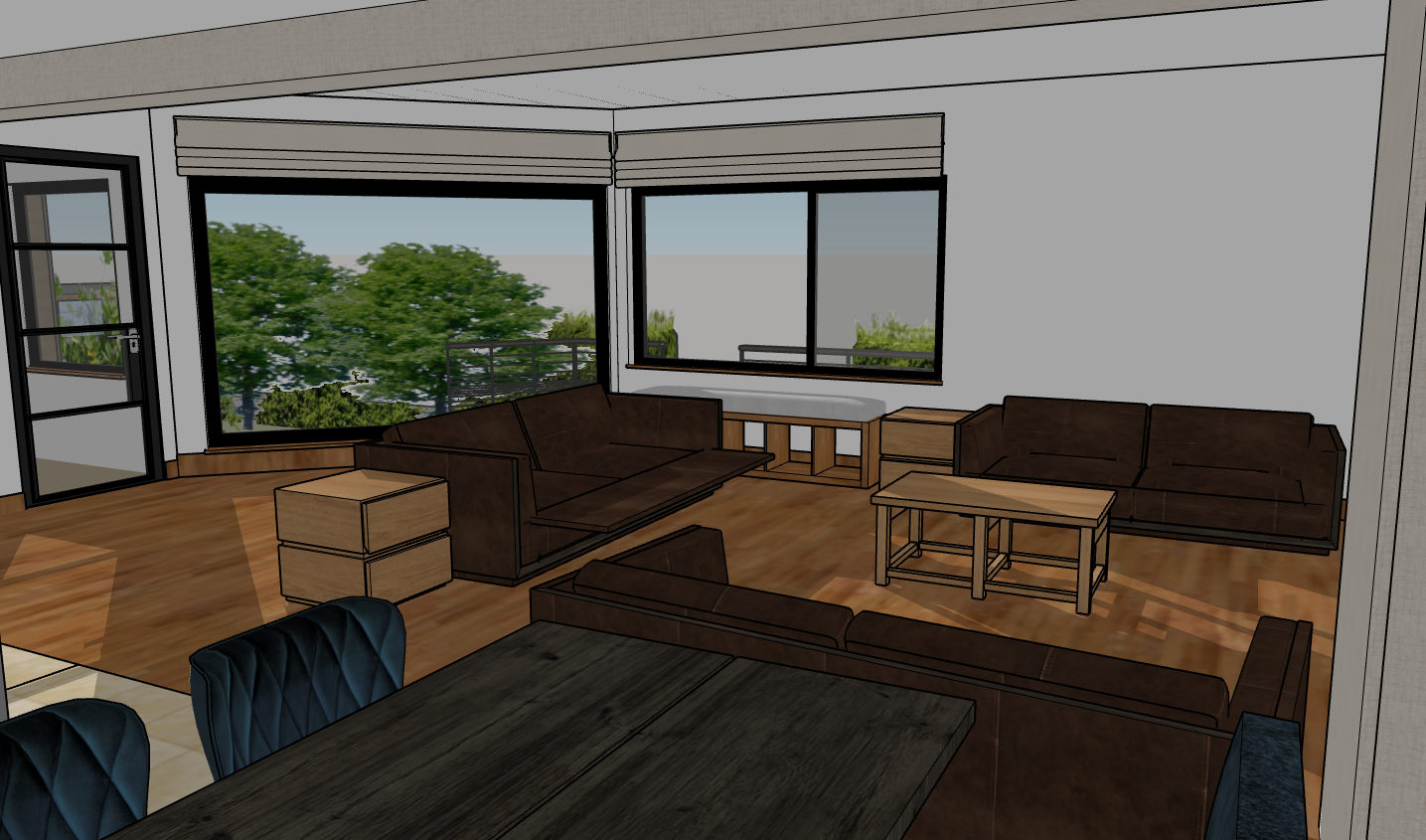

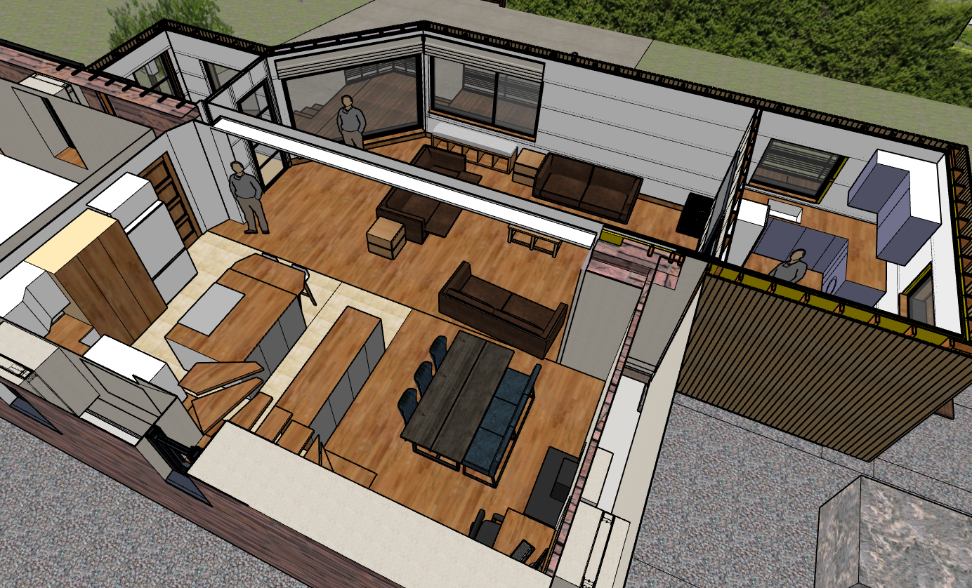

Posted
Some random thoughts...
Where will the TV go ?
Where will kitchen and utility extractors go ?
Outside tap and powerpoint ?
Consider creating a lighting plan now so you can avoid lights clashing with ceiling joists or steel etc
Consider the potential for rain noise from the flat roof - was an unexpected issue for us using single ply PVC membrane - perhaps EPDM is better for noise - acoustic insulation ?
Pity about the beam.
That new larch looks nice but will presumably actually be grey within a year or two ?
Don't fancy a rooflight then ?
Shame to have steps down onto the patio area - consider raising decking/patio ?
Does the big window have a view and would you want some seating that looks through it ? Seating seems to focus towards the utility door ?
Outside door to the utility ?
Posted
Basic comments - drawing for planning and warrant will be different, so you will not have combined drawings. So do you have planning permission already - if so drop the planning permission from the drawing title or vice versa.
All drawings are light on detail.  Should include details of proposed build-up etc or make reference to additional drawings.
 If this steel interacts with the outside world it will insulating. Not sure if it also need fire proofing - ask your structural engineer.

Posted
Very quick look:
Not keen on the clash of the old and new - would have been nicer (IMO) to keep the existing eaves.
Not keen on the angle in the plan - is there a reason?
CO to living room for stove.
Probably need eaves ventilation at roof junctions.

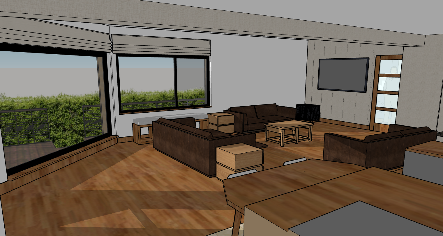

Thanks @Spinny.
TV like this, or wall adjacent.  Not ideal having the utility door on same wall as it takes away the 'cosyness' of the space.
-Outside tap and sockets - hadn't thought of this but they can go on existing wall near the front door.
-When you say 'lighting plan' and clashing, do you mean physically fitting them in or the way the light falls?  Admittedly I've not thought much about lighting yet.  So far assumed that the recessed spotlights from the existing living area would follow through to new space.
-Rain noise I hadn't considered either.  Can anyone comment on noise potential with this roof buildup?
-I was considering using the larch coating that greys it early and consistently.  I do also like cedar.  Ideally I'd like a trip to Russwood for my wife and I to have a look and decide.
-I had a rooflight in the model then I removed and increased the size of the front windows instead...cost, build complications, light wasn't getting to kitchen anyway due to roof thickness (and that was before I had the lowered beam in the room), maintenance issues (punching a hole in EPDM not ideal).  Windows in image above have open South West and West views and I'm confident that there will be plenty light.
-Patio area...I need a think about how to best use for a seating area.  Models just now simply reflect existing decking.  I suppose there's also an option of stepping down within the entrance area, but then I'd lose internal space.
-Big windows have great views across the countryside.  One sofa and dining table will have good aspect.  Have considered changing the left sofa for a swivel chair.
-Outside door...We considered, but thought it would not get used enough to justify the cost, loss of space and impact on insulation.

Posted
On 14/11/2025 at 18:17, ETC said:
Very quick look:
Thanks @ETC
-Not sure what you mean by keeping existing eaves?
-The angled window is the best countryside aspect.  My thinking was that this large, angled picture window would give a nice 'wow factor' and something different in what is otherwise just a box.
-CO?
-Thanks. Yes, I need to have a think about ventilation here.  Currently relies on 'leakiness' of existing roof/wall junction for ventilation I think!
