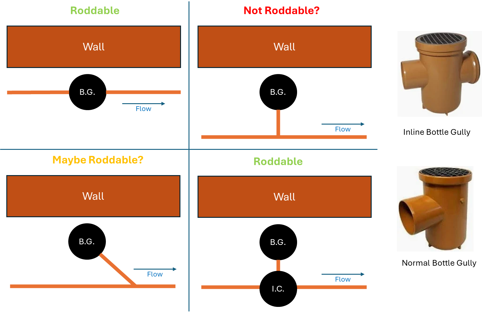

MortarThePoint Posted November 5, 2025 Posted November 5, 2025 (edited) Gullies or traps are essential if the rainwater joins the sewage system. That's not the case for me as it's a separate system going to a drainage ditch. I have shoes for the bottom of my downpipes. Bottle gullies on first look seem like a good idea, but I have seen people elsewhere saying they aren't the right thing to use but with no clear justification. I know they can be expensive, but that's not the reason. I think it may be that the bottle gully would need to be right up against the brickwork, rather than having a hopper arrangement like Marley's UG47 which they proposed to use with a Marley UG44 trap (shown at bottom of this post). These traps aren't roddable and bottle gullies are in theory, but would they be in practice? If you have a branch (tributary) coming away from the house at right angle, I suspect the rod wouldn't be able to curve down into the trap's outflow and so it ends up unroddable. A different matter if you use an inline bottle gully, but that requires the pipe run to be close to the wall and I am keen to have a bit of separation (also need to go round a chimney outcrop). Perhaps putting the branch at 45 degrees would help with rodding access, but the ultimate access would be provided by an inspection chamber of access where it joins the main pipe. That seems over the top though. Is rodding access a red herring for rainwater as the blockages are local to the trap and not in the pipe sections? What do others think if the right approach? Marley UG47 and UG44: Looks like you have to solvent weld a length of pipe to UG44 since there's no rubber seal and anyway the outflow is higher. Toolstation's Aquaflow has a ring seal but that feels like tempting fate as it's still below outflow: Edited November 5, 2025 by MortarThePoint

MortarThePoint Posted November 11, 2025 Author Posted November 11, 2025 Made a few calls. Polypipe suggested that Bottle Gullies are the standard approach. Wavin (Osma) said it was down to taste and Bottle Gullies are probably the easiest and neatest. I said I liked the idea of hopper and rested bend and that seemed ok but may be less roddable. In terms of joining the main run of pipe, it's standard to use a tee, as long as the main run is roddable (ie chamber at is ends). It's looking like I'll go with an Osma 4D960 with 2x45 bends at each corner of the house, straight runs between those and then Y-tee branches to each hopper or gully. 1

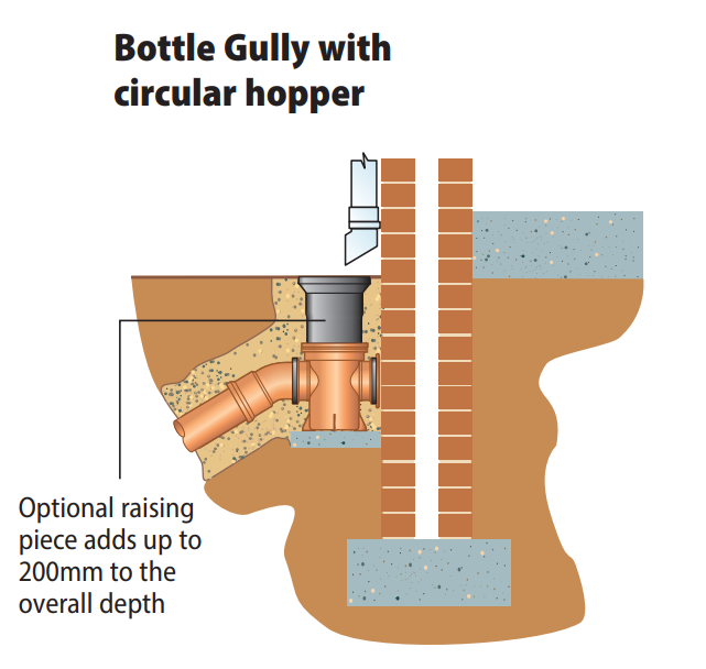

MortarThePoint Posted November 17, 2025 Author Posted November 17, 2025 This is what Floplast show as an example in their brochure for downpipes with shoes: 1

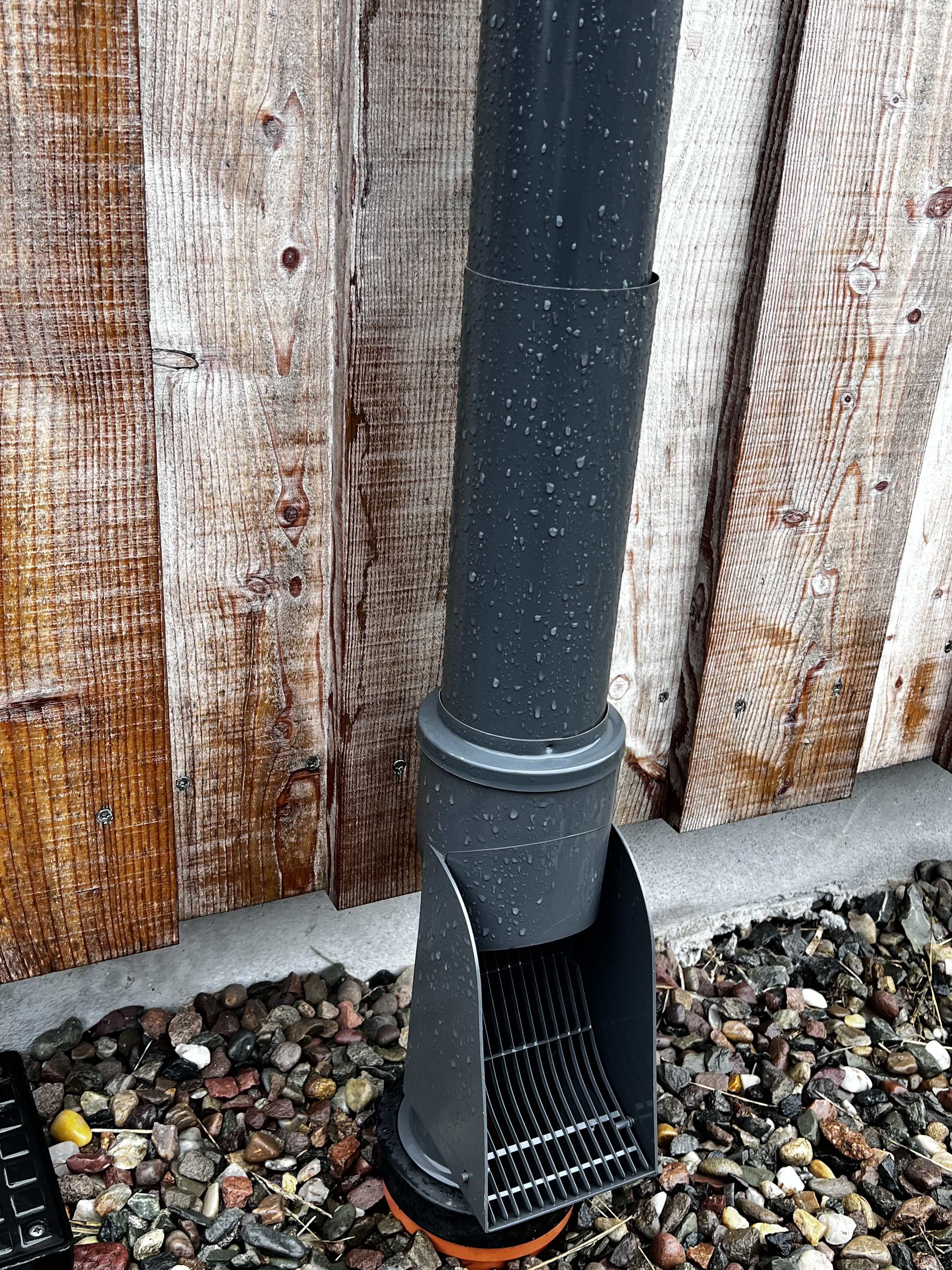

Oz07 Posted November 17, 2025 Posted November 17, 2025 (edited) I normally cut the downpipe into this grid then you can still take the main grid off to clean the gully out. Could also use a shoe. Edited November 17, 2025 by Oz07 1
saveasteading Posted November 17, 2025 Posted November 17, 2025 36 minutes ago, Oz07 said: normally cut the downpipe I prefer to catch leaves here.
MortarThePoint Posted November 17, 2025 Author Posted November 17, 2025 39 minutes ago, Oz07 said: I normally cut the downpipe into this grid then you can still take the main grid off to clean the gully out. Could also use a shoe. So do you cut a hole in the smaller rectangular grid? I was thinking of perhaps having the shoe over that part meaning the square section could be easily removed.
