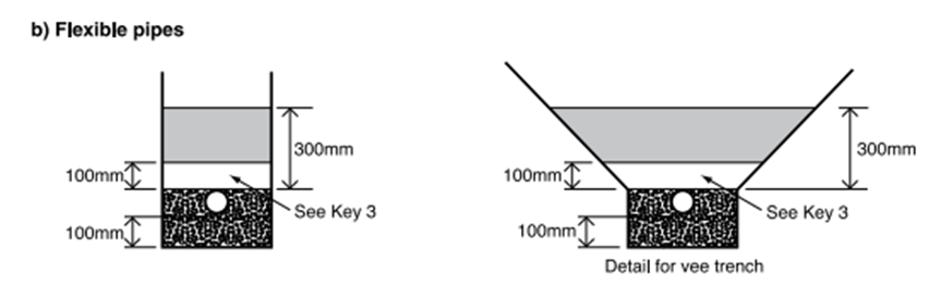

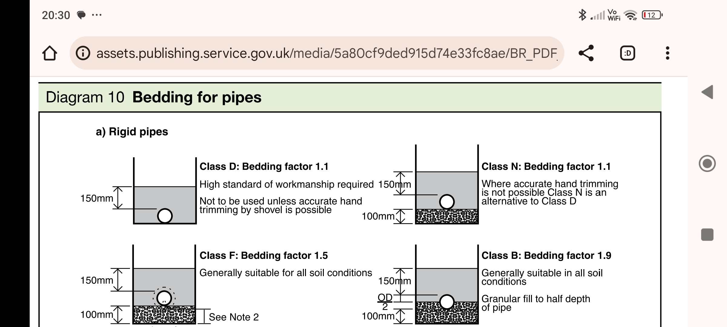

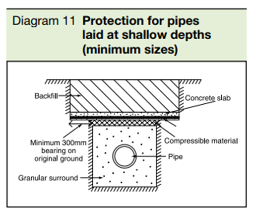

MortarThePoint Posted October 22, 2025 Posted October 22, 2025 For 110mm foul pipes running around the outside of the house I was expecting to dig a trench about 300mm wide, put down a bed of pea gravel and then fill to just covering the pipe with same gravel. Then topsoil over all that. Does that sound the right approach? If I understand part H diagram 10, this method meets or exceeds Class B as long as the top of the pipe is at least 150mm deep. Though not sure why the vertical sides of the trench continue upwards in the diagrams. I think my shallowest pipe would have it's top at about 150mm below the surface. What I'm less clear on is how far from the wall to have the pipes. All pipes are above top of concrete foundations. Further from the house feels like it leaves room for unknowns, but perhaps gets closer to somewhere the wife might stick a spade. I guess same question applies to rainwater drainage too.
dpmiller Posted October 23, 2025 Posted October 23, 2025 Bedding is only for supporting the pipe and the diagram reflects that. If the pipes are shallow then there's another section to read w/ concrete casing or slabs over the top for protection?

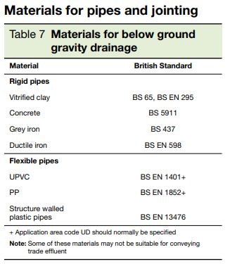

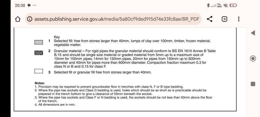

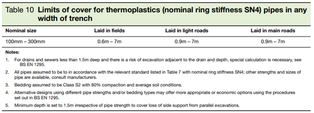

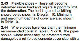

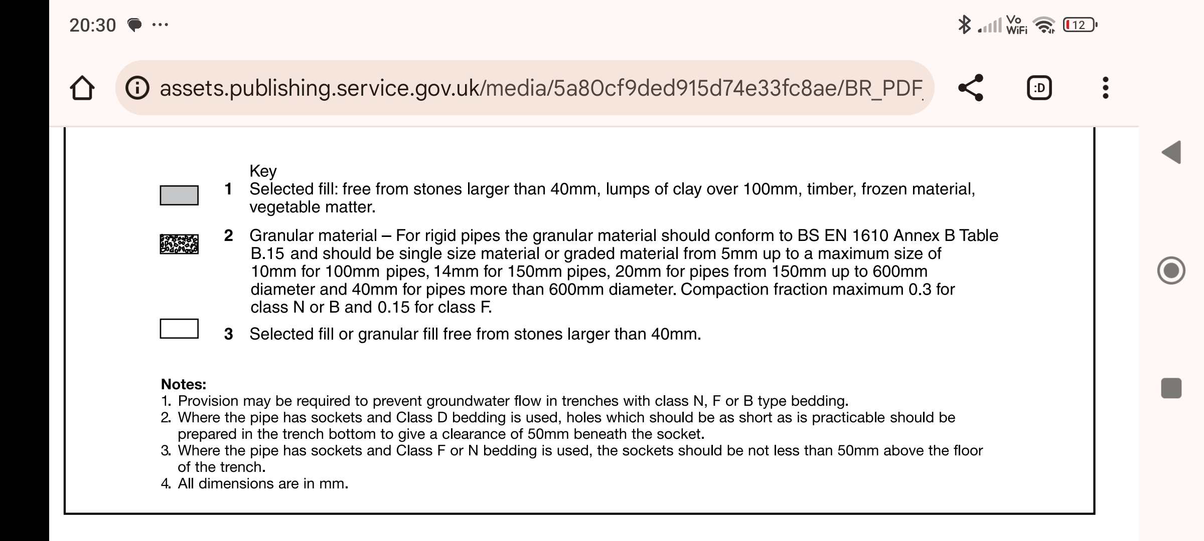

MortarThePoint Posted October 23, 2025 Author Posted October 23, 2025 Oops, those 'Rigid' pipes are only clay, concrete or iron. The normal brown/orange PVC pipes are classed as flexible. That changes the normal installation to as shown below, (b). That suggests a minimum depth to the top of the pipe of 300mm which could be tricky.
MortarThePoint Posted October 23, 2025 Author Posted October 23, 2025 3 hours ago, dpmiller said: Bedding is only for supporting the pipe and the diagram reflects that. If the pipes are shallow then there's another section to read w/ concrete casing or slabs over the top for protection? Depth information is only given for where vehicles may travel, like fields and roads: And if that can't be achieved, a slab used

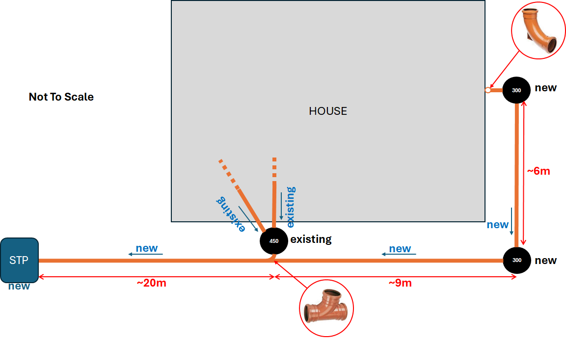

MortarThePoint Posted October 23, 2025 Author Posted October 23, 2025 This is the setup I am trying to work out. Unfortunately the 450mm inspection chamber exists in the wrong direction. I'm hoping I can put a tee right next to it to solve that, since the long straight run will be roddable from the 300mm inspection chamber bottom right of diagram. I'd prefer something smoother, but can't find a product that is a 'resting bend tee' equivalent. Does this look at all sensible? The existing 450mm inspection chamber has an outlet invert 600mm below the surface. 1:40 fall would necessitate 600mm - (15,000mm/40) - 2*(300mm_chamber invert steps) < 225mm. Noticed a product called a shallow access 90 degree chamber which avoids the steps at the two 300mm chambers: https://www.drainagesuperstore.co.uk/product/280mm-dia-90-degree-shallow-access-chamber-base-110mm.html @Nickfromwales do you get involved in the mucky pipes outside or just stay warm inside?
Nickfromwales Posted October 23, 2025 Posted October 23, 2025 2 hours ago, MortarThePoint said: This is the setup I am trying to work out. Unfortunately the 450mm inspection chamber exists in the wrong direction. I'm hoping I can put a tee right next to it to solve that, since the long straight run will be roddable from the 300mm inspection chamber bottom right of diagram. I'd prefer something smoother, but can't find a product that is a 'resting bend tee' equivalent. Does this look at all sensible? The existing 450mm inspection chamber has an outlet invert 600mm below the surface. 1:40 fall would necessitate 600mm - (15,000mm/40) - 2*(300mm_chamber invert steps) < 225mm. Noticed a product called a shallow access 90 degree chamber which avoids the steps at the two 300mm chambers: https://www.drainagesuperstore.co.uk/product/280mm-dia-90-degree-shallow-access-chamber-base-110mm.html @Nickfromwales do you get involved in the mucky pipes outside or just stay warm inside? Lol. I’m in the trenches, so to speak, at the moment. I’m not shy of anything, as no job is beneath anyone, afaic. 😉 1
crispy_wafer Posted October 24, 2025 Posted October 24, 2025 Shame about the existing 450, I know the image isnt to scale, but my thoughts before seeing the ‘existing’ text was spin it around, get it in line with the 300 and stp, have the two outlets from the house come in on side branches, with the main through flow run straight through from the 300 to the STP. Regards the tag on the treatment plant thread, Sorry, I’m still knocking my way through the build so it isnt in use yet. 1 1
saveasteading Posted October 24, 2025 Posted October 24, 2025 Do you have a drawing showing depths and gradients? I'm not following the problem atm.
ProDave Posted October 24, 2025 Posted October 24, 2025 I suspect you would want a new IC right next to the existing 450IC so you have rodding access.

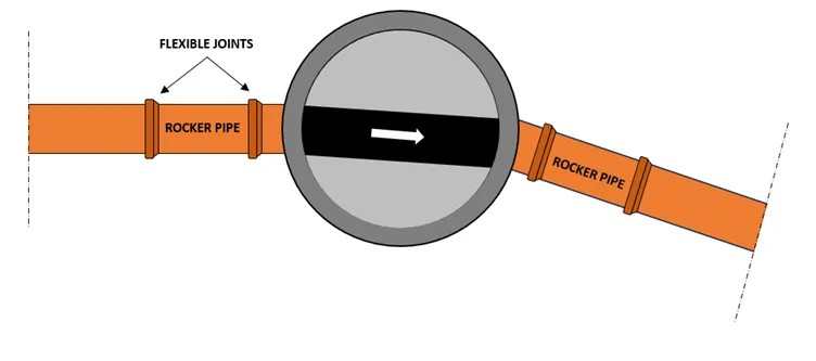

Russell griffiths Posted October 24, 2025 Posted October 24, 2025 My ten cents worth the inspection chambers on the two 90 degree turns, fit 45degrees bends to the chamber you then in effect turn the chamber into a slow radius bend instead of a sharp 90. 1
MortarThePoint Posted October 24, 2025 Author Posted October 24, 2025 1 hour ago, ProDave said: I suspect you would want a new IC right next to the existing 450IC so you have rodding access Should be roddable via the bottom right 300mm inspection chamber (IC). 1 hour ago, saveasteading said: Do you have a drawing showing depths and gradients? I'm not following the problem atm. The main challenge is the exit of the 450mm IC facing the wrong way. I spoke to my BCO and he said he'd be ok with a Y-tee and 45. I think I'd make the 45 by cutting a resting bend and that way I can fine tune the angle.
ProDave Posted October 24, 2025 Posted October 24, 2025 1 hour ago, MortarThePoint said: Should be roddable via the bottom right 300mm inspection chamber (IC). But that is 9 metres away and if the blockage is downstream you will need 30M of rods. I am sure BC wants rodding points closer than that? 1
saveasteading Posted October 24, 2025 Posted October 24, 2025 The bco prob hasn't had to deal with blocked drains. Multiple bends coupled with shallow or steep falls, and stuff gets left behind.
MortarThePoint Posted October 25, 2025 Author Posted October 25, 2025 Important to remember my rocker pipes, but less clear how to do that on the 450mm with Y-tee arrangement.

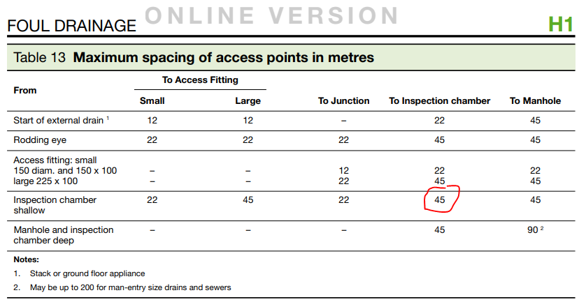

Russell griffiths Posted October 25, 2025 Posted October 25, 2025 19 hours ago, ProDave said: But that is 9 metres away and if the blockage is downstream you will need 30M of rods. I am sure BC wants rodding points closer than that? 30 m is the maximum distance between chambers if I remember rightly. 1
MortarThePoint Posted October 25, 2025 Author Posted October 25, 2025 1 hour ago, Russell griffiths said: 30 m is the maximum distance between chambers if I remember rightly. I don't want to go too far between ICs to make clearing blockages easier, but aren't the regs 45m between ICs: I think I'd break the ~20m section in half with another inspection chamber in case rodding through the STP was difficult
saveasteading Posted October 25, 2025 Posted October 25, 2025 39 minutes ago, MortarThePoint said: rodding through the STP You don't. So a chamber just before it is a good thing. In fact it's likely a standard detail for the STP.. I haven't checked. 1

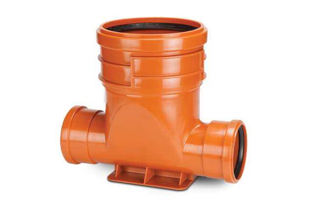

MortarThePoint Posted October 28, 2025 Author Posted October 28, 2025 (edited) This Polypipe inspection chamber is interesting. Only 200mm diameter so easier to incorporate in various places. Would need a 45 bend either side to be on a corner. I think it's only suitable for an invert level of 600mm below ground in domestic applications, despite the tube that attaches to its top being 2m. Only option for a cover is a square ductile iron one though. Edited October 28, 2025 by MortarThePoint
MortarThePoint Posted October 28, 2025 Author Posted October 28, 2025 Actually, this circular cover may be compatible

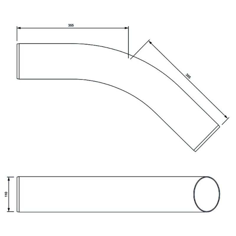

MortarThePoint Posted October 28, 2025 Author Posted October 28, 2025 (edited) 45 degree long radius bend: This may be gentler bend, or they've just used a picture of a 90: Floplast have a dimensioned drawing of theirs: Edited October 28, 2025 by MortarThePoint

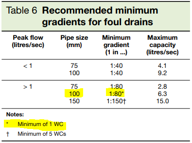

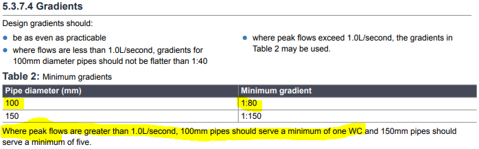

MortarThePoint Posted October 28, 2025 Author Posted October 28, 2025 (edited) In terms of gradient, most advice is 1:40 (1m across 25mm down), but often reality doesn't allow this. 1:80 (1m across 13mm down) is allowed if peak flow rate is over 1.0L/s and NHBC give a useful indication of what that means (actually, so does the Part H table): In my pipe diagram above, the branch with two 90 turns serves a stack from a bathroom with a WC as well as a bath so should have peak flows over 1.0L/s meaning 1:80 is OK. I'll probably try for 1:60 (1m across, 17mm down). Edited October 28, 2025 by MortarThePoint

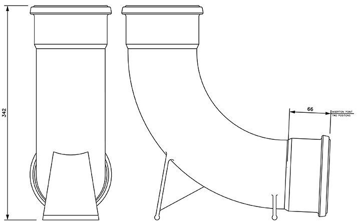

MortarThePoint Posted November 9, 2025 Author Posted November 9, 2025 On 28/10/2025 at 10:34, MortarThePoint said: I'll probably try for 1:60 (1m across, 17mm down). That makes for an about 15,000mm * 1/60 = 250mm drop from the stack's rested bend to the tee by the 450mm chamber which has an invert of 600mm. That means the rested bend can have an outlet invert (600mm - 250mm) = 350mm below the surface. That works about perfectly to have the Floplast rest bend at the bottom of the stack (D571, dimensions below). If it was available in black, I'd consider having the collar sticking out of the ground meaning the invert could be at just 300mm below the surface. The orange stuff isn't UV stable and would catch the eye, but I guess I could spray paint it black if I needed to.
