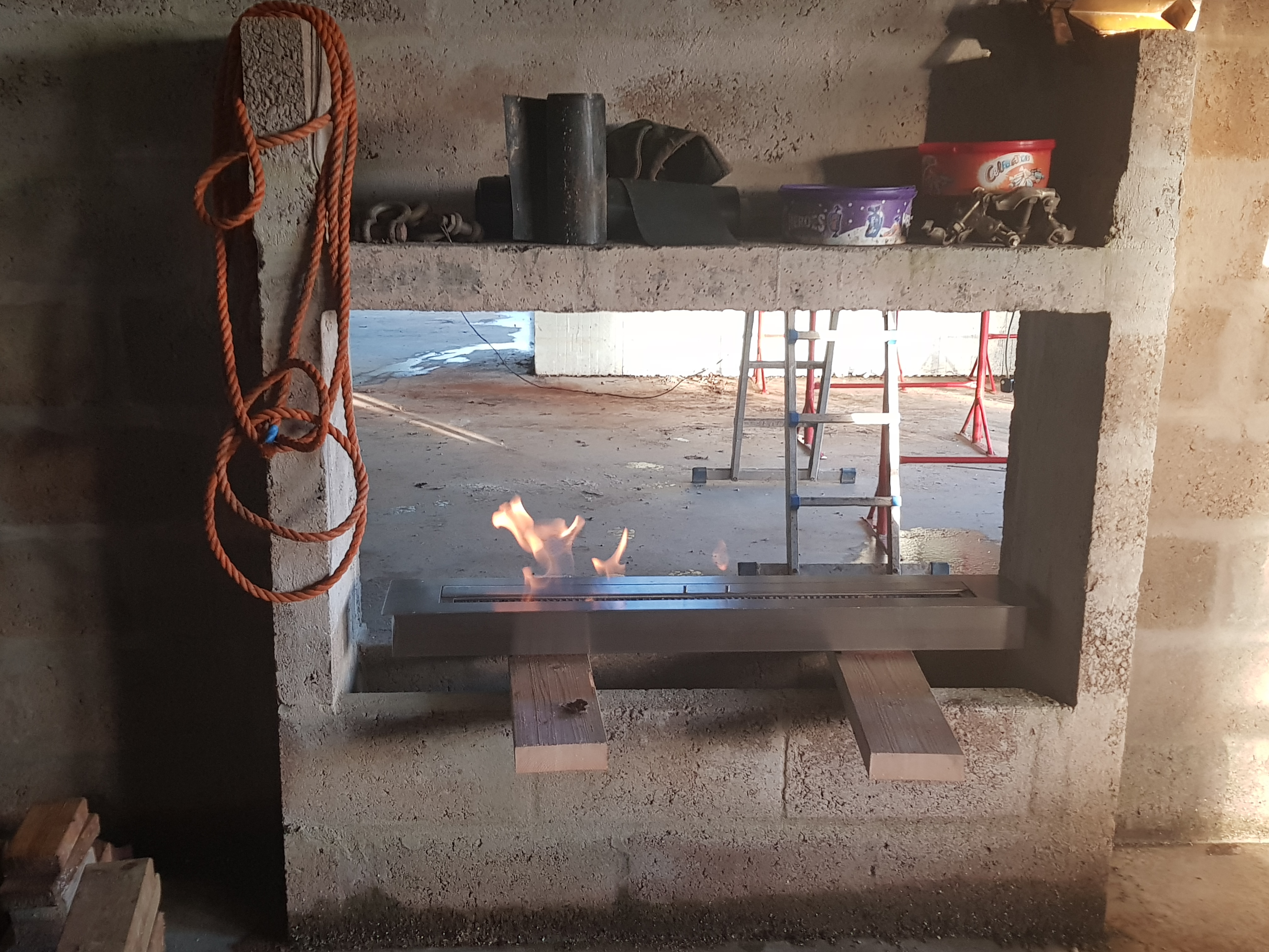

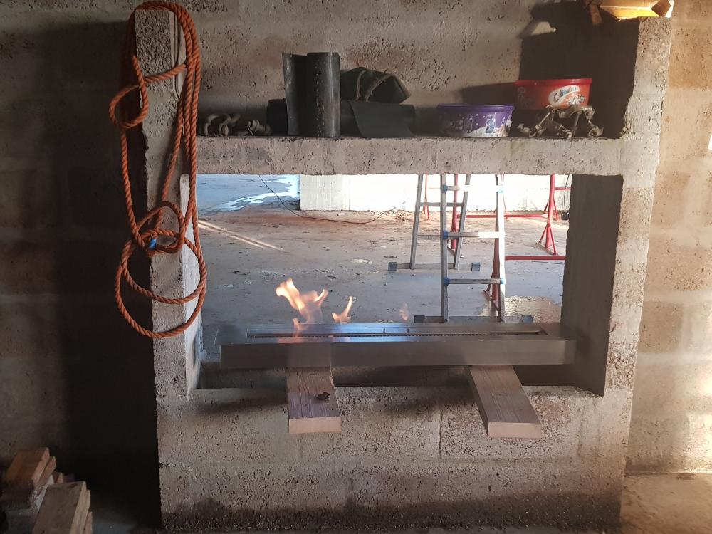

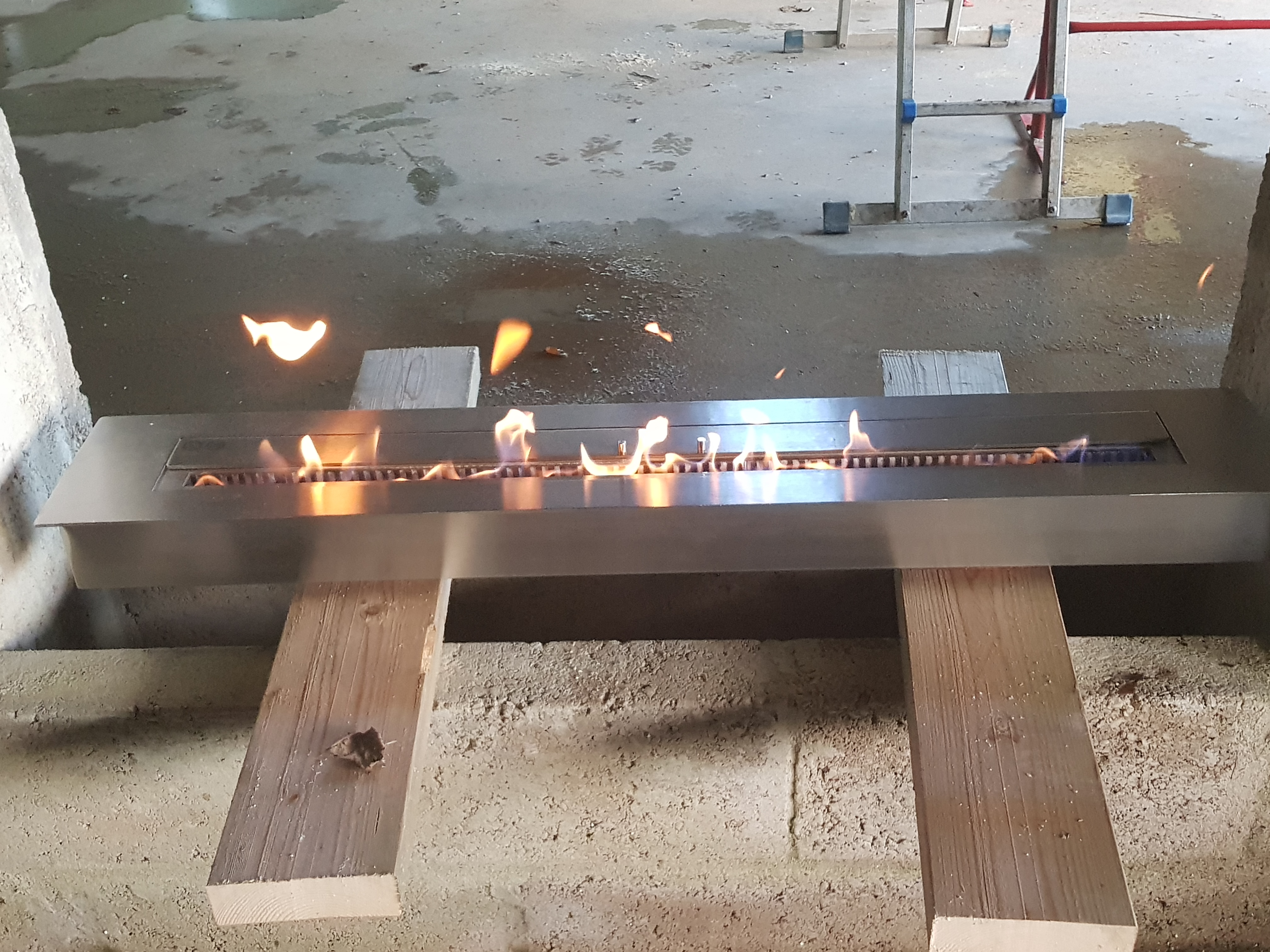

Alexphd1 Posted January 11, 2018 Posted January 11, 2018 Very happy with bio ethanol ribbon burner. Maybe a solution to some people on here. No extra ventilation or flue required and very little heat produced.
bissoejosh Posted January 11, 2018 Posted January 11, 2018 (edited) We're considering a bio ethanol stove instead of a log burner. The overheating risk puts us off a traditional wood burner but we would like something for the ambiance. How do you refuel it and what sort of consumption do you expect? Edited January 11, 2018 by bissoejosh
Alexphd1 Posted January 11, 2018 Author Posted January 11, 2018 We just bought 2l of fuel from national diy shed will report back on how long it lasts. We used a plumbers torch to lite and was very easy, would imagine a match would be just as affective.
lizzie Posted January 11, 2018 Posted January 11, 2018 I put one of the bio fuel burners inside the log burner in last house (it was new and unused for burning logs) my breathing cant tolerate smoke or burning of any sort. It was OK, looked good and the bottles of fuel lasted well enough but I gave up on it in the end because of the faint chemical smell from the fuel when burning. I moved it to outside and used as a garden feature where smells didnt bother me as much. In new house I am going for an optimist runs on water great flame effect, no smell and no fire risk, not cheap to buy though but there are no ongoing fuel costs bar a small amount of electricity.
Alexphd1 Posted January 11, 2018 Author Posted January 11, 2018 I have my nose almost touching the flames and can't smell anything but the windows are not in yet so effectivly its still outside. When I was in the showroom I didn't smell anything with multiple burners on.

Alexphd1 Posted January 11, 2018 Author Posted January 11, 2018 (edited) The burner unit is 1200 wide with the actual burner approx 1000 wide. 2l of fuel lasted approx 1h20m on full pelt so not exactly cheap. Didn't really notice a smell while burning but when slid the slider to kill the flame there was a strong smell. Overall really impressed with it but hoping with decent sized rooms and mvhr the smell will be fine. If not then will have a look around at more refined fuel. Cost was approx 400. The show room with no smell was in Denmark, maybe they where running slightly different fuel mix. Edited January 11, 2018 by Alexphd1

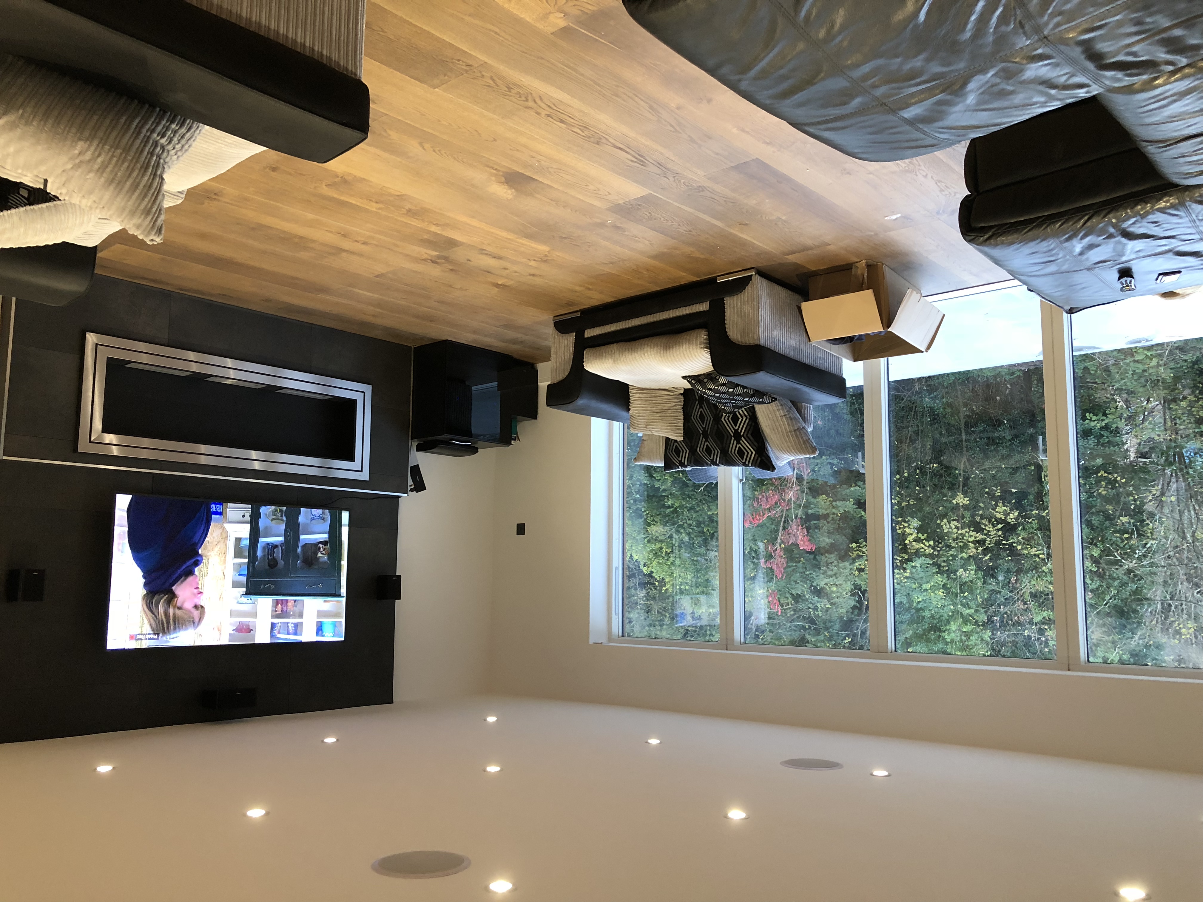

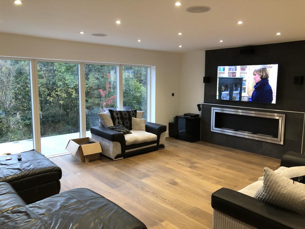

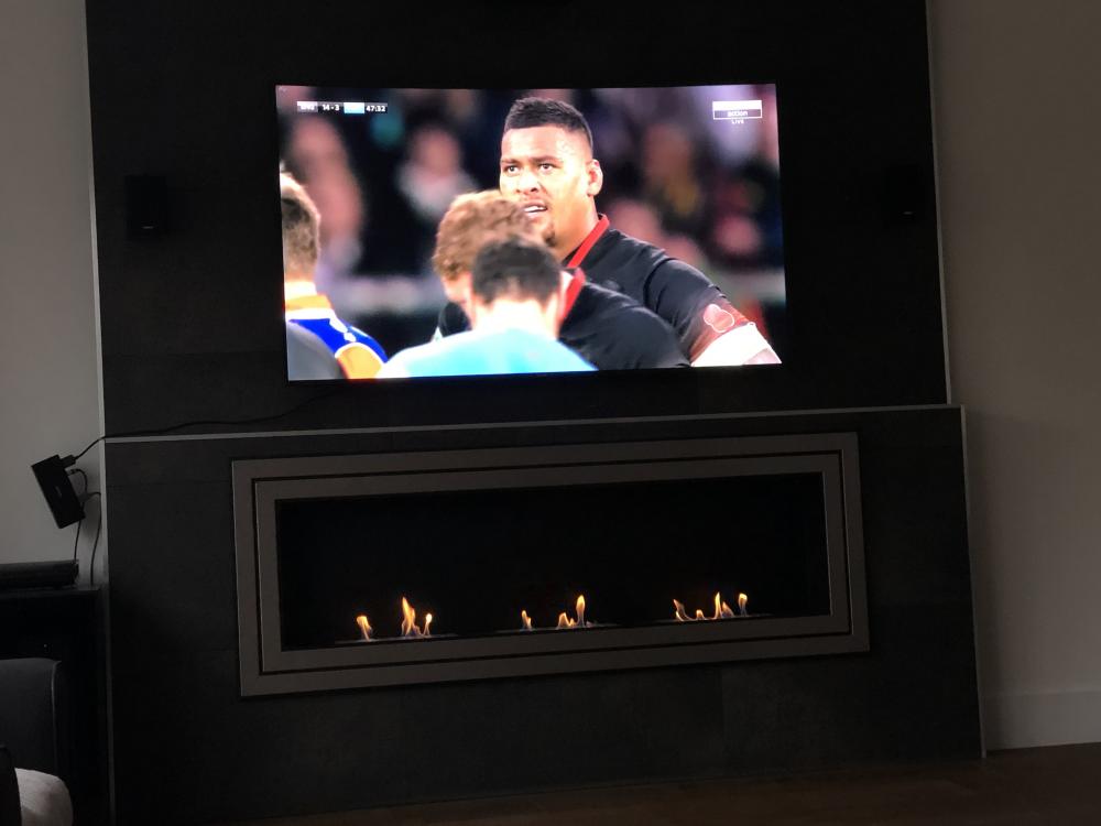

Grosey Posted January 12, 2018 Posted January 12, 2018 We put a bio ethanol fireplace in ours. Looks great, convenient, no smell, kicks out a fair bit more heat than expected and does heat the room up to borderline uncomfortable if the UFH has already been on. Probably does work out expensive as I just bought the ethanol from Amazon. However it’s only used as a feature when we have company. Dont believe any any of the fuel consumption claims, 1L lasts about 1hr30 in ours at full whack. 3

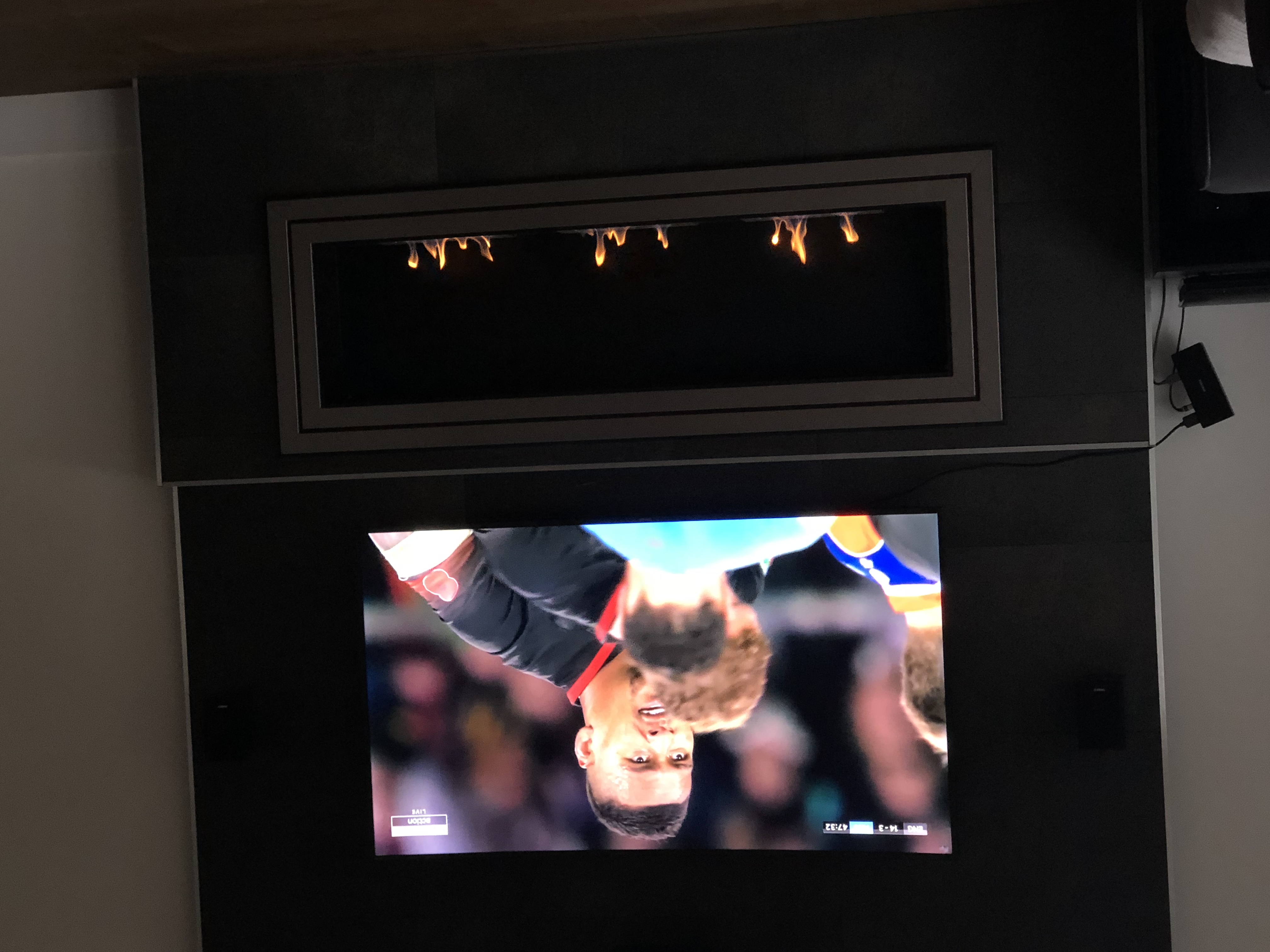

AliG Posted January 12, 2018 Posted January 12, 2018 (edited) That's very nice looking, as mentioned bioethanol would be an expensive heating source, but its OK if just used occasionally for visitors. Also you don't need any chimneys etc. The Optimyst will be see through like in @Alexphd1's picture, I have had the electrician put a couple of mini downlighters in the alcove so you can light it even if the fire is not on. They are already running and it provides a nice glow. We also have a gas inset fire in the kitchen and a stove in our bedroom. the gas fires are expensive to begin with but once you include the cost of flues, fitting, gas pipes etc I almost wish I hadn't bothered. They are at the opposite end of the house from the boiler, I will probably be over £1000 to get the gas to the other end as it has to be routed all the way round the outside of the house. I have had the optimist plumbed in so I don't have to manually fill it. Edited January 12, 2018 by AliG

Grosey Posted January 13, 2018 Posted January 13, 2018 16 hours ago, Alphonsox said: Looks very good - What make/model is the fire unit ? any idea on price ? Thanks Link below, I think I haggled about £100 off that price. https://www.easyfire.co.uk/lillian-3.html
Guest Alphonsox Posted January 13, 2018 Posted January 13, 2018 1 hour ago, Grosey said: Link below, I think I haggled about £100 off that price. https://www.easyfire.co.uk/lillian-3.html Thanks for the link - having dug a little more myself I think this is a rebranded Kratki Juliet unit, manufactured in Poland and sold under different names in the UK https://kratki.com/sklep/en/produkt/1700/juliet-1800-with-tuev-certified I wonder how much it would be to import one....
