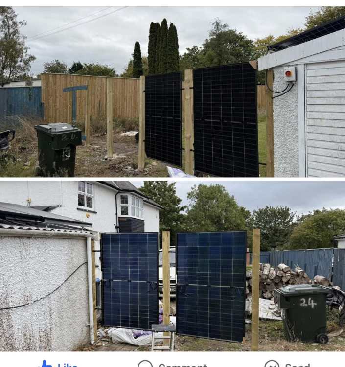

Pocster Posted October 7 Posted October 7 I thought there was some regs issue on these ? I.e feeding straight into the inverter like roof pv . Am I wrong ? . Just saw this on fb and got my interest !
Pocster Posted October 7 Author Posted October 7 A fence - which on your own property can be made of anything ?? . Under 6ft for building regs 😊 . Would a sparky happily wire these to grid connected inverter ? ( not mcs 😊😊 )
ProDave Posted October 7 Posted October 7 No problem at all. Particularly up here in the north, they can work very well taking more advantage of the low winter sun. You only need MCS if you intend to export and get paid for it.

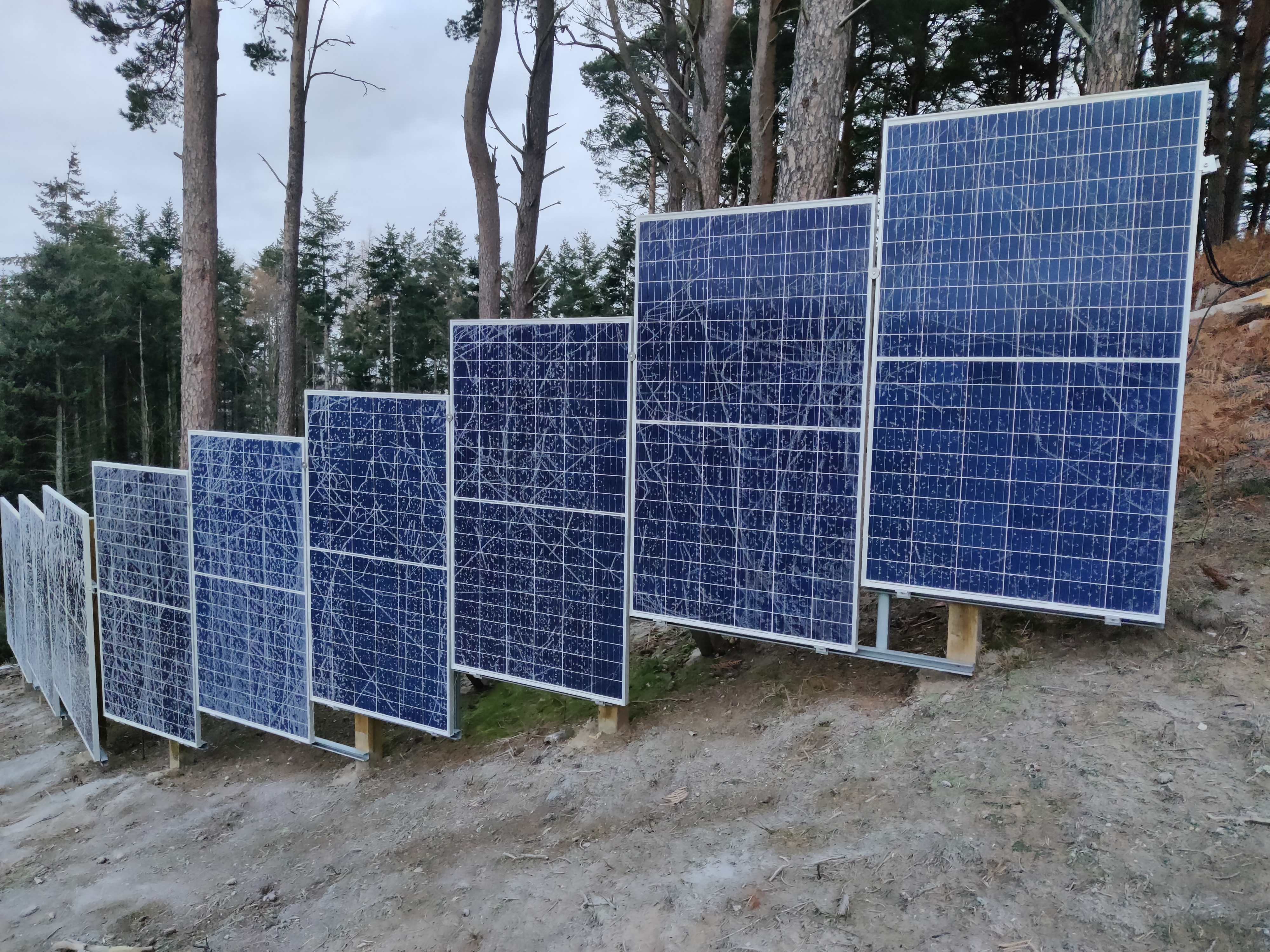

DamonHD Posted October 7 Posted October 7 I use mine for an off-grid system, and they are functioning as a privacy screen as that wall is quite low! 2
Pocster Posted October 7 Author Posted October 7 22 minutes ago, ProDave said: No problem at all. Particularly up here in the north, they can work very well taking more advantage of the low winter sun. You only need MCS if you intend to export and get paid for it. So can I get them simply added effectively to my roof pv ? . I don’t need to change inverter or anything - so do I need mcs accreditation install ? I.e my export limit hasn’t changed

DamonHD Posted October 7 Posted October 7 (edited) No footballs kicked in around in my garden, but they don't feel fragile, and have been up some years now. https://www.earth.org.uk/expanding-off-grid-PV-system.html#20160722 Edited October 7 by DamonHD 1
DamonHD Posted October 7 Posted October 7 3 minutes ago, Pocster said: So can I get them simply added effectively to my roof pv ? . I don’t need to change inverter or anything - so do I need mcs accreditation install ? I.e my export limit hasn’t changed If you add them to an existing system for which you are getting FiT then you should tell your administrator and they will scale down future payments from what your generation meter says to compensate, ie to only pay for the PV that went in under FiT. Also, in principle, you should tell the DNO, or ask first if you would go over 16A per phase, I think.

DamonHD Posted October 8 Posted October 8 Your existing system will have been signed off with the DNO, and possibly a FiT administrator, with a particular configuration and capacity. That is what you have permission for. Changes may require new permission or at least notification.
Pocster Posted October 8 Author Posted October 8 3 hours ago, DamonHD said: Your existing system will have been signed off with the DNO, and possibly a FiT administrator, with a particular configuration and capacity. That is what you have permission for. Changes may require new permission or at least notification. But why ? . I can’t export anymore . I can have as many dc batteries as I want - DNO doesn’t care . So why more panels require notification? What does it affect ??? . Understand for a new system you need it - but as my exports capped ….
-rick- Posted October 8 Posted October 8 I think you need to worry about notificatoin if you are on FIT. Non-FIT I dont think it matters unless you change the inverter. Adding extra panels to an existing inverter needs careful thought though especially if they are in a different orientation. If you have a spare MPPT then its easy, if not then needs careful thought. 2
sgt_woulds Posted October 8 Posted October 8 If adding to an existing sytem you will need to add them as a seperate string, due to the different orientation to your roof panels. You 'should' tell your DNO, yes. But if it is just one or two panels on an existing inverter and the extra panels don't significantly increase your export potential, then you'll have to ask if they'd ever know? 1

SteamyTea Posted October 8 Posted October 8 2 hours ago, Pocster said: But why ? . I can’t export anymore You are getting the power limit on the inverter and the energy exported confused. The mean power exported will be higher, which will raise the total energy exported. It is those kW and kWh again, those things that you don't think are important. 1
Pocster Posted October 8 Author Posted October 8 (edited) 2 minutes ago, SteamyTea said: You are getting the power limit on the inverter and the energy exported confused. The mean power exported will be higher, which will raise the total energy exported. It is those kW and kWh again, those things that you don't think are important. Ah it's all bollocks. My export is 3.68THINGIES . I can add a zillion PV panels and my export will still be limited to 3.68Boobies. So I do what the (expletive deleted) I want . Edited October 8 by Pocster
Dillsue Posted October 8 Posted October 8 1 hour ago, Pocster said: Basically I can do what I want is my interpretation 😊 If your still running solaredge then you can add more panels up to the max number of optimisers....24 if it's an SE3680H you've got. You also need to keep under the max DC input which is likely double the inverter rating. DNO is only interested in the max the inverter will produce so adding panels won't increase that. If you're getting FIT then you need to notify your FIT payer of the addition. If youre thinking of building a fence with panels, remember that lots of fences eventually blow down and pretty much all wooden fences eventually succumb with rot. Climate change ain't gonna make future storms any less intense and likely the opposite so use battleship engineering 1
SteamyTea Posted October 8 Posted October 8 Just now, Pocster said: My epos is 3.68THINGIES . I can add a zillion PV panels and my export will still be limited to 3.68Boobies But for more time. There will be very few hours a year that your thingy is 3.68, more likely 2.5. By adding a bit more juice to your thingy, it will be closer to the 3.68 than it was. So it is important to the local grid. If you were to export 3.68 24/7, your local wire would get too hot. (I am talking cm not inches)
Pocster Posted October 8 Author Posted October 8 7 minutes ago, SteamyTea said: But for more time. There will be very few hours a year that your thingy is 3.68, more likely 2.5. By adding a bit more juice to your thingy, it will be closer to the 3.68 than it was. So it is important to the local grid. If you were to export 3.68 24/7, your local wire would get too hot. (I am talking cm not inches) But that's not my problem. Because in theory without adding anymore PV I could export 3.68waggies all day long.
