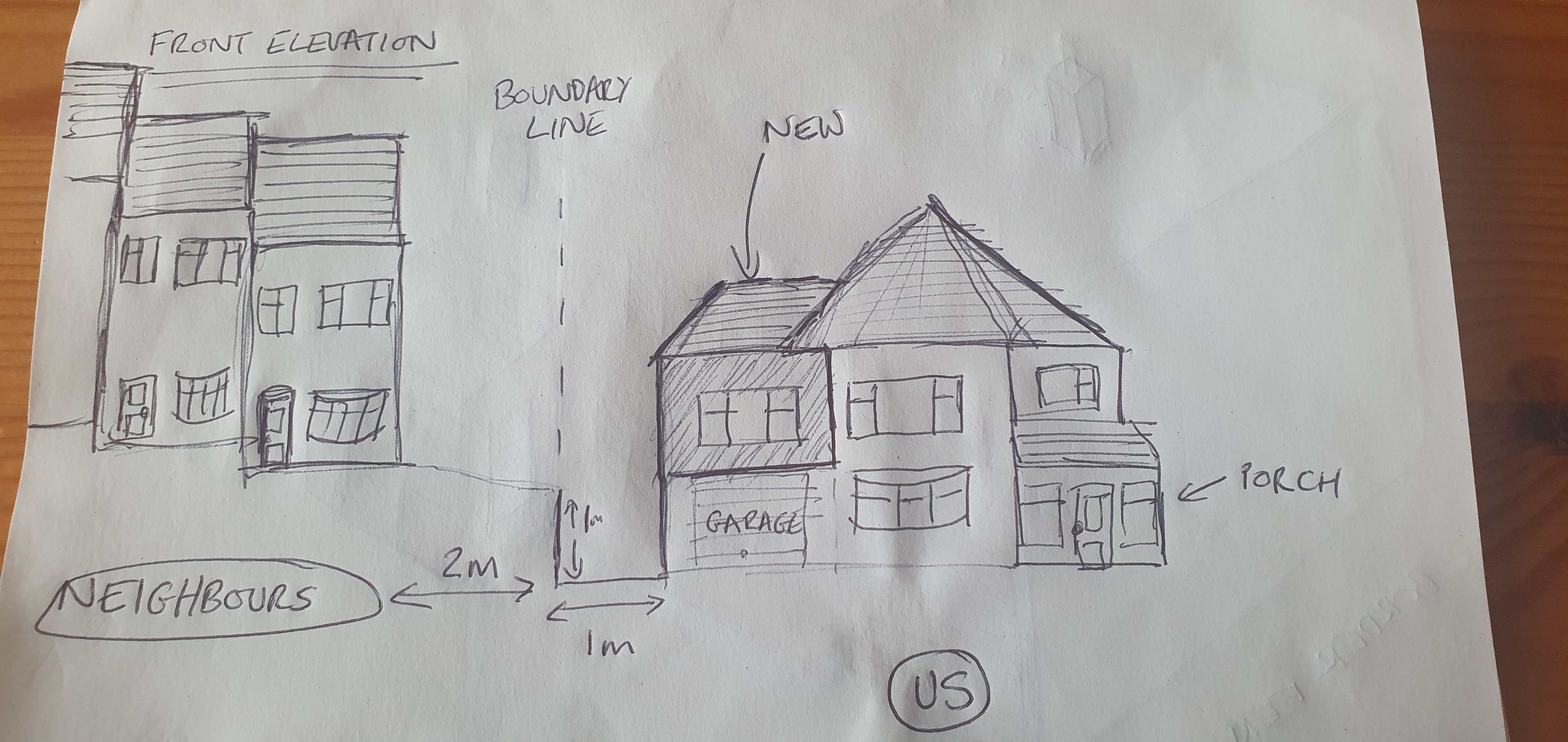

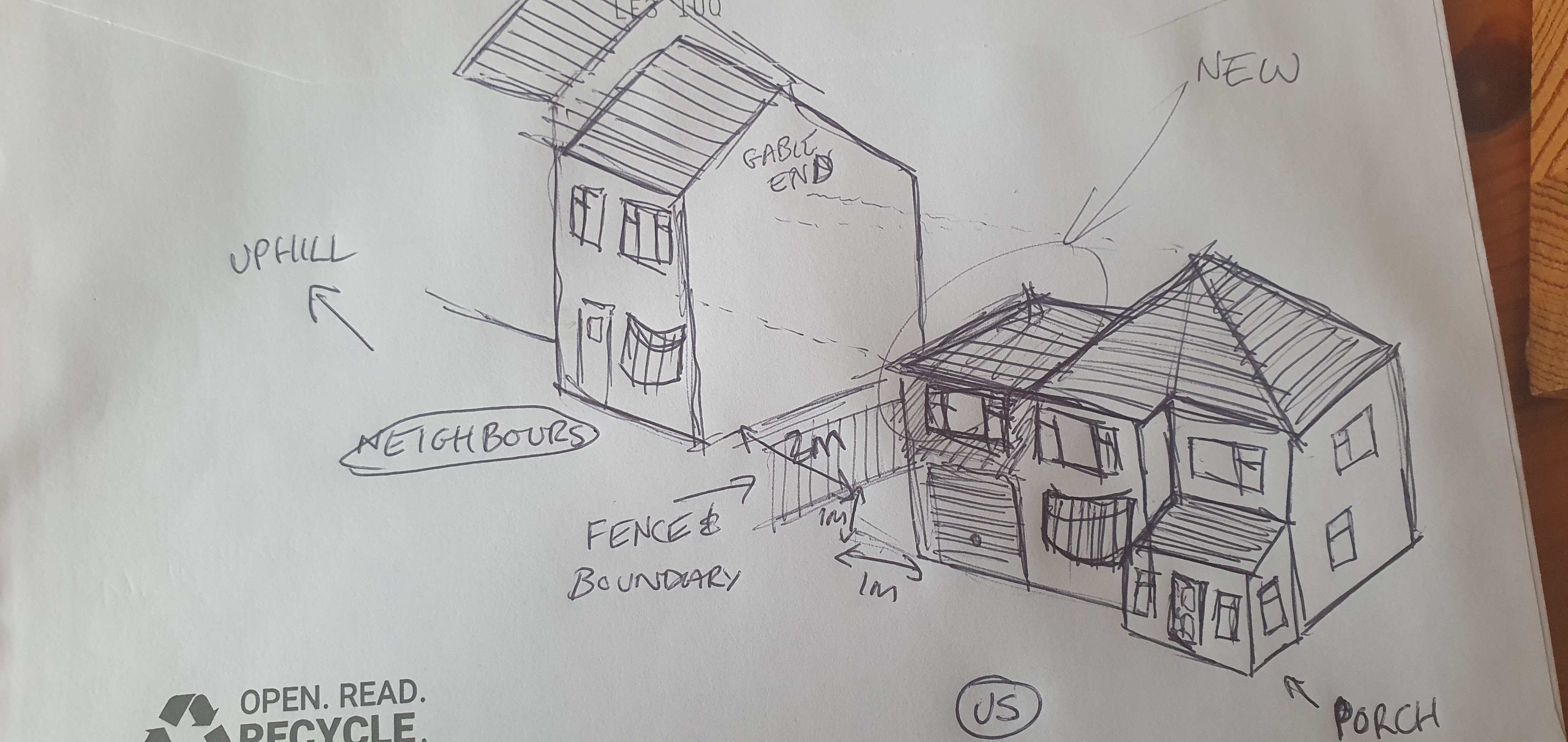

December 16, 2025Dec 16 On 14/12/2025 at 16:50, SilverShadow said: Is this pitched roof midpoint interpretation correct? Don't know as can't quite visualise what you have. Can you post some hand sketches of the elevations of both houses. Others on BH will likely chip in so you'll get a variety of views and comment. Glad the documents helped. Thee BRE on can be a bit heavy reading. For all. One way of keeping the professional design fees down is to try and get an understanding yourself of what he issues are and this save time / cost when discussing with your designers. Remember that designers need to know and remember a huge amount, it's just not possible for them to retain all that at their fingertips. what they do need is a big library and know how to find specialist documents when they need to. A well informed Client can thus often prompt designers and engage in a healthy discussion... you all end up working together as a proper team, sharing and discussing ideas and solving problems.
December 27, 2025Dec 27 Author Hi again, Gus - hope you had a great Xmas, buddy 😁 Apologies for the late reply, but it's always a hectic time of year! 🍻 I've enclosed some very basic drawings, which I hope help a little. Apologies, if they're a little crude, but hopefully they give a clearer idea. I can also provide a rear elevation if that helps - but maybe this already gives you a clear enough idea. Please ignore our property's exact roof layout, as it depends on final plans. But it should show it's (currently) a pyramid shape & the neighbours have a gable end facing us I've shaded our new extension a little, to highlight the changes we're hoping to construct I've also put a few rough measurements & projection lines on, to give an idea of overall perspective of us with the neighbour To recap: Their property front elevation is at least 2m forward of ours (& ours probably 2m further back from theirs, at the rear elevation). I'd guess their ground floor is 2-2.5m higher than ours. We also have the 3m gap between properties. The sun hits the rear elevation 1st & swings clockwise (the side away from the neighbour) to the front Hope that gives a better idea, buddy - feel free to ask anything else & I'll happily provide 👍
December 27, 2025Dec 27 10 hours ago, SilverShadow said: I've enclosed some very basic drawings Hope you had a fun time toooo! These sketch drawings are very good! Well done. In terms of the daylight to next door you're allowed a certain reduction before it becomes material. It's somewhere in the docs I think. The overshaddowing of the neighbours doesn't seem to be much of an issue, yet to see the rear elevation, I suspect that may well be ok. Your house is significanlty lower. On 14/12/2025 at 16:50, SilverShadow said: avoiding a 'terraced' effect with other properties & being overly imposing This is a good observation. But the houses are still well separated and you're proposed new roof still significantly lower. If you project a roof line of the terrace down the hill what you are proposing is stil below that. If push comes to shove you could set back the face of the extension a little and / or tweak the roof so the gutter is a little lower than the main house, makes it more subservient / less mass. Usually 1.0m is accepted but I would go for 500mm if pressed as a first offer. Don't offer this up to start with, stick to what you want. If you can sketch like this then have you thought about doing you own scaled hand drawings and submitting a planning application under your own steam? This at least will let you see, what if any, concerns the planners may have and leaves you in full control over the design process at your end. If you do your own application then there is other stuff you need to submit, but that applies in all cases. Here is a quick, but not comprehensive list of things that help build a planning application like this. 1/ A site location plan, OS or say from UK Planning Maps etc, main thing is that it has a copyright number, address and a grid reference. 2/ A block plan showing the site and as you have trees you need to identify these, both within and adjacent your site. Also hedges, fences and heights. I often do a little table and annotate the drawing. Also show existing parking and proposed parking provision, bin storage area and access (also width) to rear garden. The block plan should also show the neighbours with some basic dimensions where the planners might be interested.. You also need to show the garden area and that there is sufficient garden (curtilage) left after you have built the extension. You'll find a guide in the permitted development (PD) guide. In this case you may need to do a block plan on elevation similar to what I posted earlier. Like this: 3/ Site photographs. 4/ Drawings as a minimum. All existing and proposed: Elevations, ground and first floor plans with the rooms annotated, associated with parking provision not least. A roof plan with the roof slopes indicated. Make sure you add a drawing title box, scale bar, a north point on the plan drawings and identify each elevation clearly. 5/ Some water boards are a bit touchy about adding a roof area and connecting the rainwater run off into the existing drainage system. Do a bit of research on this and keep your findings under your hat for now. 6/ Try not to be overly helpful and avoid highlighting things that "might" be debatable say if you were trying to argue some wierd technical planning detail down the pub. Let the planners do their job and come back to you with any requests for more detail. If you fancy doing the drawings yourself then you'll get loads of tips on BH about what and what not to do and, also how to avoid excessive work. Edited December 27, 2025Dec 27 by Gus Potter
