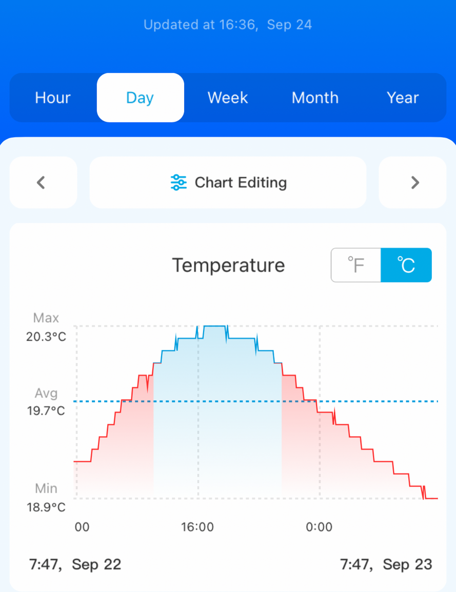

Nick Laslett Posted yesterday at 15:16 Posted yesterday at 15:16 (edited) 3 hours ago, G and J said: In the last week or so I’ve had my ear bent by three very experienced builder type people, all telling me I’ll really regret a fat screed. The consistency of their arguments is astounding, they are all saying that we'll hate how long it takes to heat up, it’ll be cold and it’ll never get properly warm as all the heat gets eaten by the screed, it’ll be impossible to control and if I had even half a brain I’d go for a 50mm flowscreed instead. @G and J, I’m actually expecting to put on my UFH tomorrow morning for the beginning of the heating season. Last week the house was still sitting at 20-21°. The ASHP will be left to do its thing and I won’t touch it till next spring. The temperature in these well insulated house is just very stable. Remember, your floor is your radiator. The heat is going into the house. You can’t lose the heat, it is impossible in a well insulated, good air tightness house. Your screed will only take a long time to heat up, if you let it get that cold. Otherwise you are just asking the ASHP to take the floor from 16° at the beginning of the heating season. Ground temp is on average 8° warmer than air temp. I will check my floor temps tomorrow before turning on the ASHP. I have 90mm upstairs and 150mm downstairs. The real challenge over the first two years is dialling in the weather comp curve. You will overshoot the ideal temperature and be opening the windows to cool the house down and be annoyed that 28° flow temp is overheating the house and you wish you had 150mm depth screed. Here is the temp curve chart from last week for upstairs. 8am to 8pm temp change, no heating, no people, just empty rooms, 90mm concrete floor. Here is the last week. Edited yesterday at 15:26 by Nick Laslett

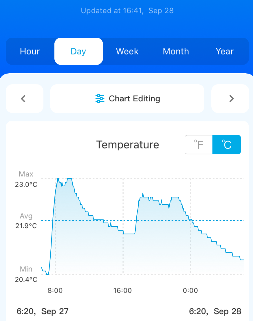

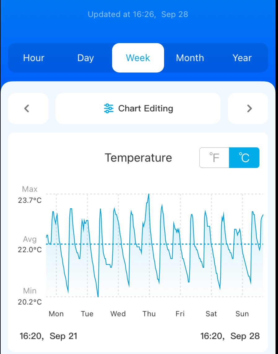

Nick Laslett Posted yesterday at 15:29 Posted yesterday at 15:29 (edited) This is the chart for the 1996 rental house, with no cavity wall insulation, 6mm double glazing gap, open trickle vents. In the same village. Oil fired central heating on for 8 hours each day. 3 hours in morning, 5 in evening. Set to 22° on hallway controls. Look at the swings in temp, compared to the new house with no heating. In the rental house over night all the heat is losted. In the new build, the house just heats up with no input, gaining 1° in temp from solar gain. I’ve never really look at the rental house chart with much thought in the colder periods. I was much more focused on house cooling issues. The reality is that in the winter you can easily put on another layer, or fire up a heater. Anyway look at the rental house heat loss across the morning. From 6.00am to 9.00am the heating gets the house to target temp, then by 4pm it has lost nearly half of that heat. The evening heating session gets the house back to target temp, then it plummets overnight. Edited yesterday at 15:58 by Nick Laslett

Nick Laslett Posted yesterday at 16:02 Posted yesterday at 16:02 43 minutes ago, Nick Laslett said: The red section where the temp is below 20°C, I had the windows open to try and cool the house down.

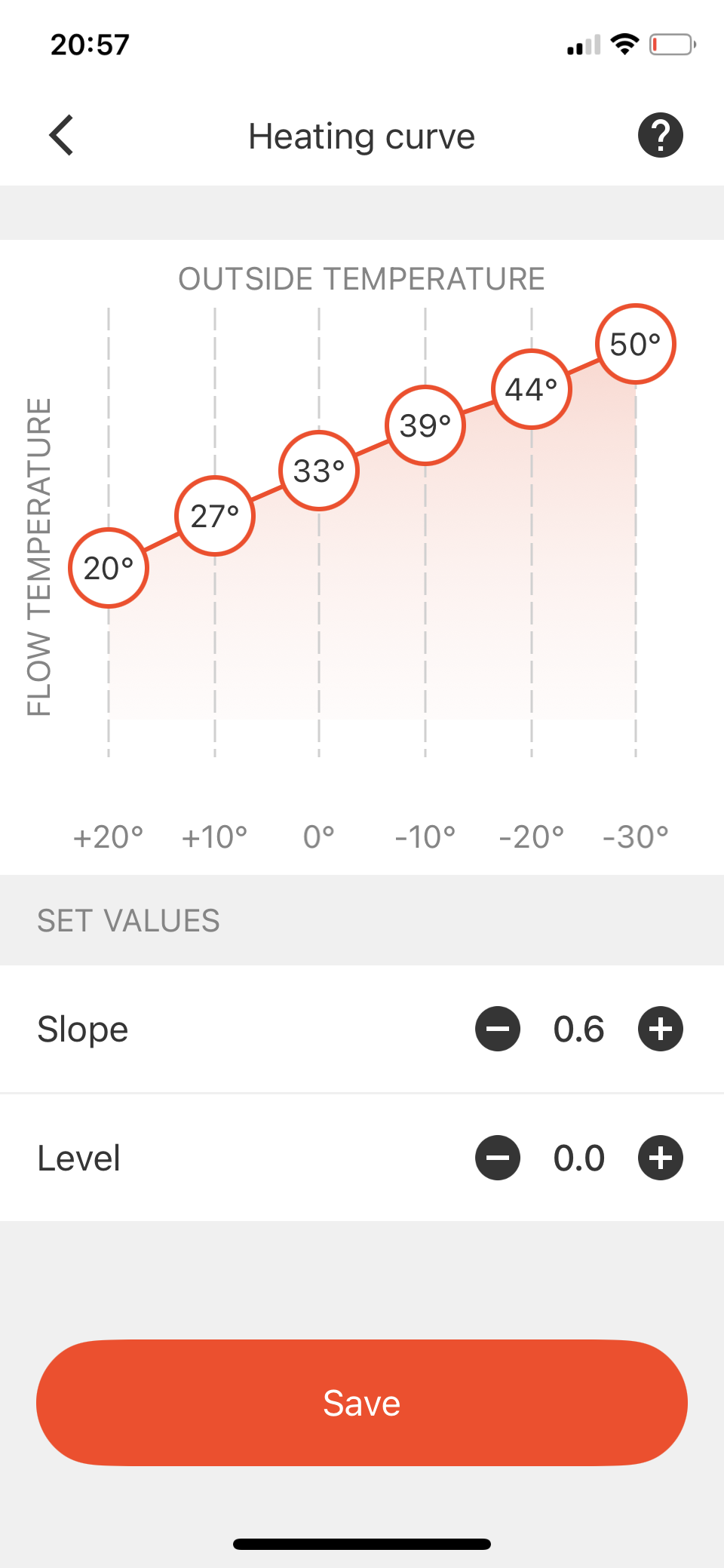

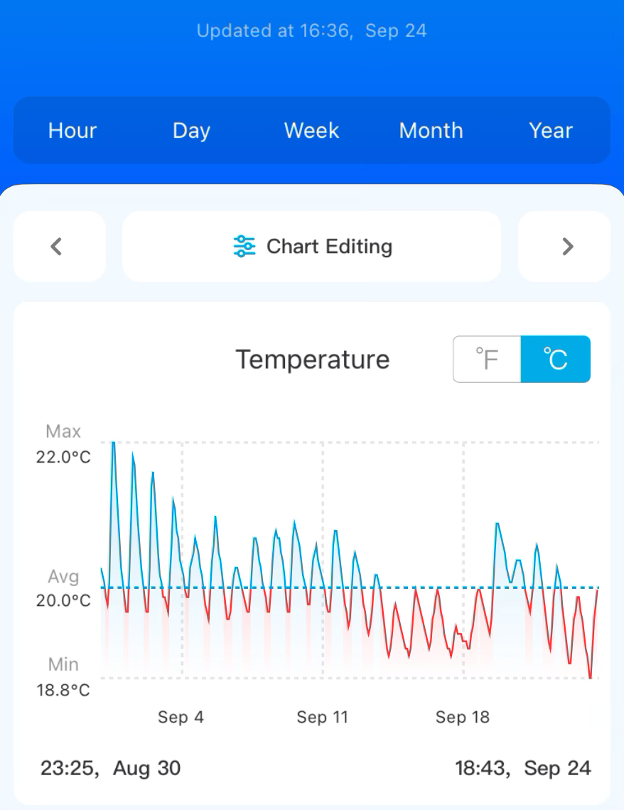

Nick Laslett Posted 12 hours ago Posted 12 hours ago (edited) Temperature updates. Upstairs room temp is currently 18.5°C Upstairs floor temp is currently 15°C Downstairs room temp is currently 19.9°C Downstairs floor temp is currently 15°C ASHP Water temp at Outlet & Inlet 17°C ASHP Outside Unit Temp 18°C (It is a very sunny day today) MET Office says temp is 17°C It is still a bit too warm in the new build to put on the ASHP. The house will probably gain another degree across the day as it is so sunny and there is no wind. We do not have especially high U-values, only double glazed. External doors are only 1.3 U-value. We are an ICF build. We don’t’ have our ACPH score yet, but hope to get below 1.0. The point being, imho that the thickness of your UFH substrate is irrelevant with a well insulated, low ACPH house. I will try to update with the heat up time when I finally switch on the ASHP. Edited 11 hours ago by Nick Laslett
