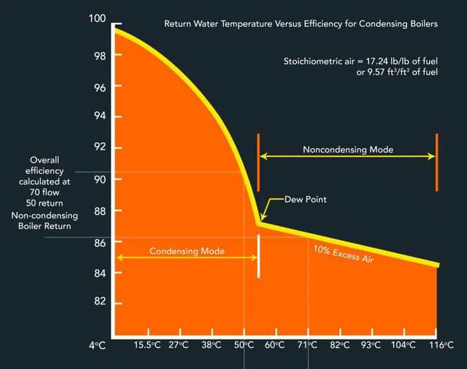

The aim of the condensing process is to recover latent heat from the exhaust gases. This process is not a fixed value of say 55 Deg C flow temp it's a scale of recovery
The lower the return temp the higher the % of heat recovery in the zone of condensing mode. I'm targeting flow temps in the mid 20's to low 30's and I've validated the boiler efficiency to be 97 % (that's quite a fun thing to do once you get your head around how)

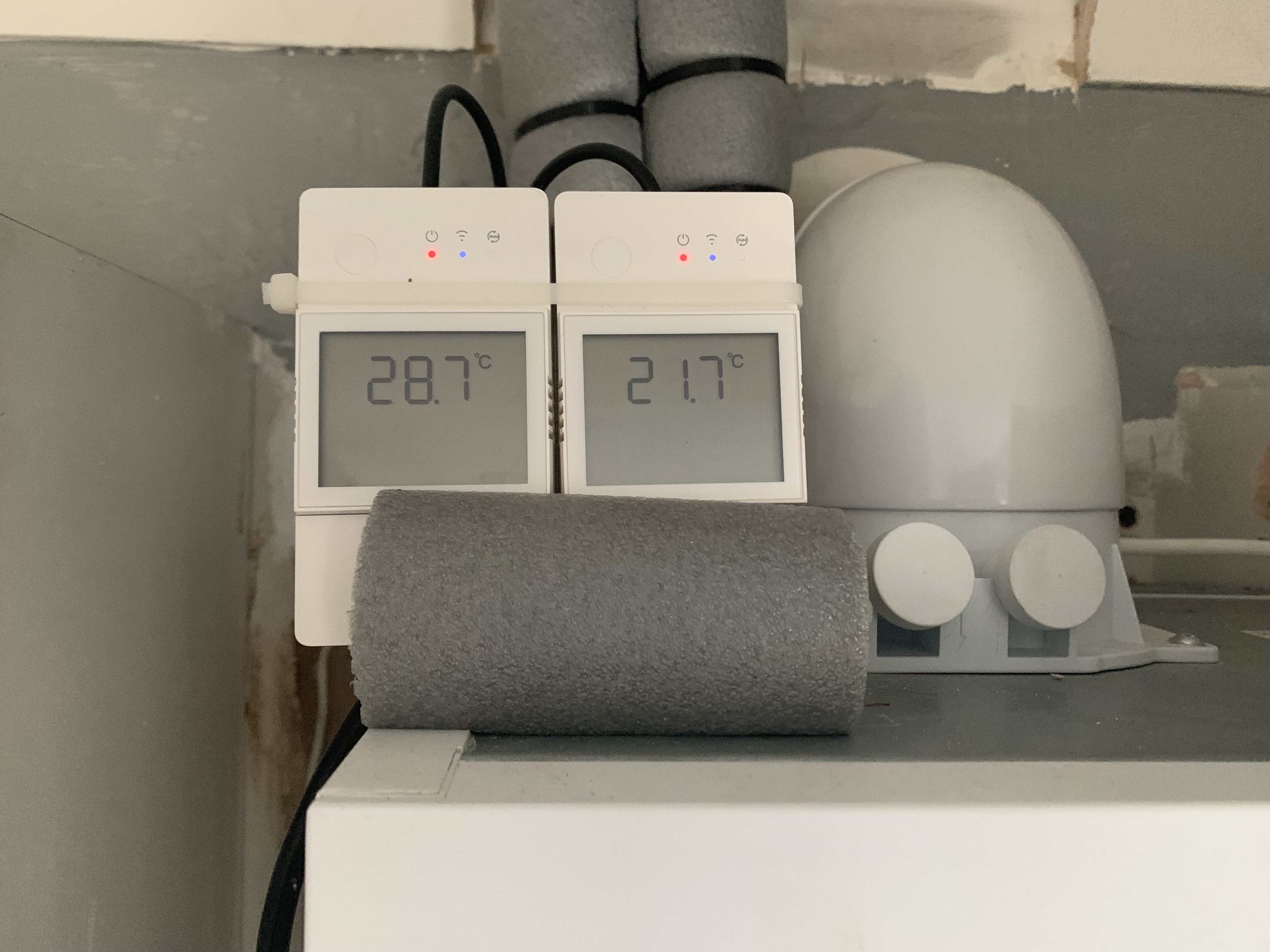

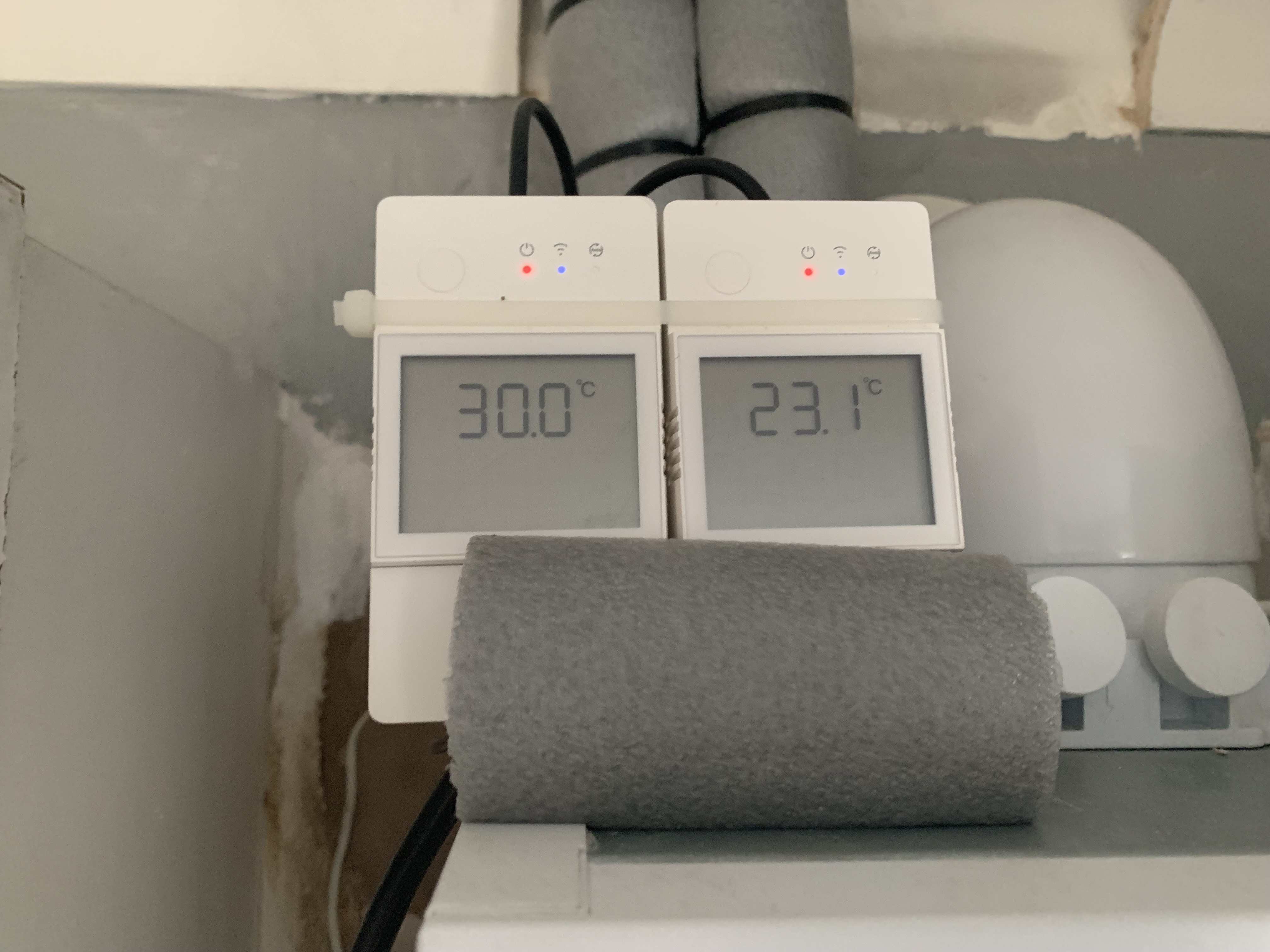

so OAT 7.0 Deg C - Weather Compensation curve says boiler should be targeting 27.4 deg C
3 mins after start boiler sitting happily with 7 deg delta (flow temp on left - return temp on the right) and maintaining a 28.7 deg flow temp at min modulation (10.4 %)
at 13 mins after start boiler reaches the overshoot temp (target temp plus 3 Deg C or return temp delta below 7 deg C - I haven’t worked out which it’s using it may even be using both on either or basis) either way the boiler shuts down and waits for restart temp (Flow = Return - at 7.0 deg OAT this will be around 20.8 to 21.2) this will be in about 50 mins time
It’s the 3 Deg hysterisis of the boiler that allows me to run low flow temps - it will keep a burn going for as long as it can as long as target flow temp doesn’t climb too high or delta between flow and return doesn’t drop below 7 deg.

That is correct for a non condensing boiler. It has been law that all replacement gas boilers are replaced with a condensing boiler since 2005 and oil boilers since 2007. So a non condensing boiler should no longer be able to be bought or installed. However nearly all new boilers are installed using the same mind set as a non condensing boiler. Even though the government at the spent millions on training.
A condensing boiler has a heat exchanger in the flue gas stream, heating return water passes through the heat exchanger. The Flue gas is cooled. If the return water is below the flue gas dew point (53 degs) the flue gas releases water - moving from a gaseous state (steam) to water. This phase change releases energy (latent heat) which is utilised by the boiler to add efficiency.

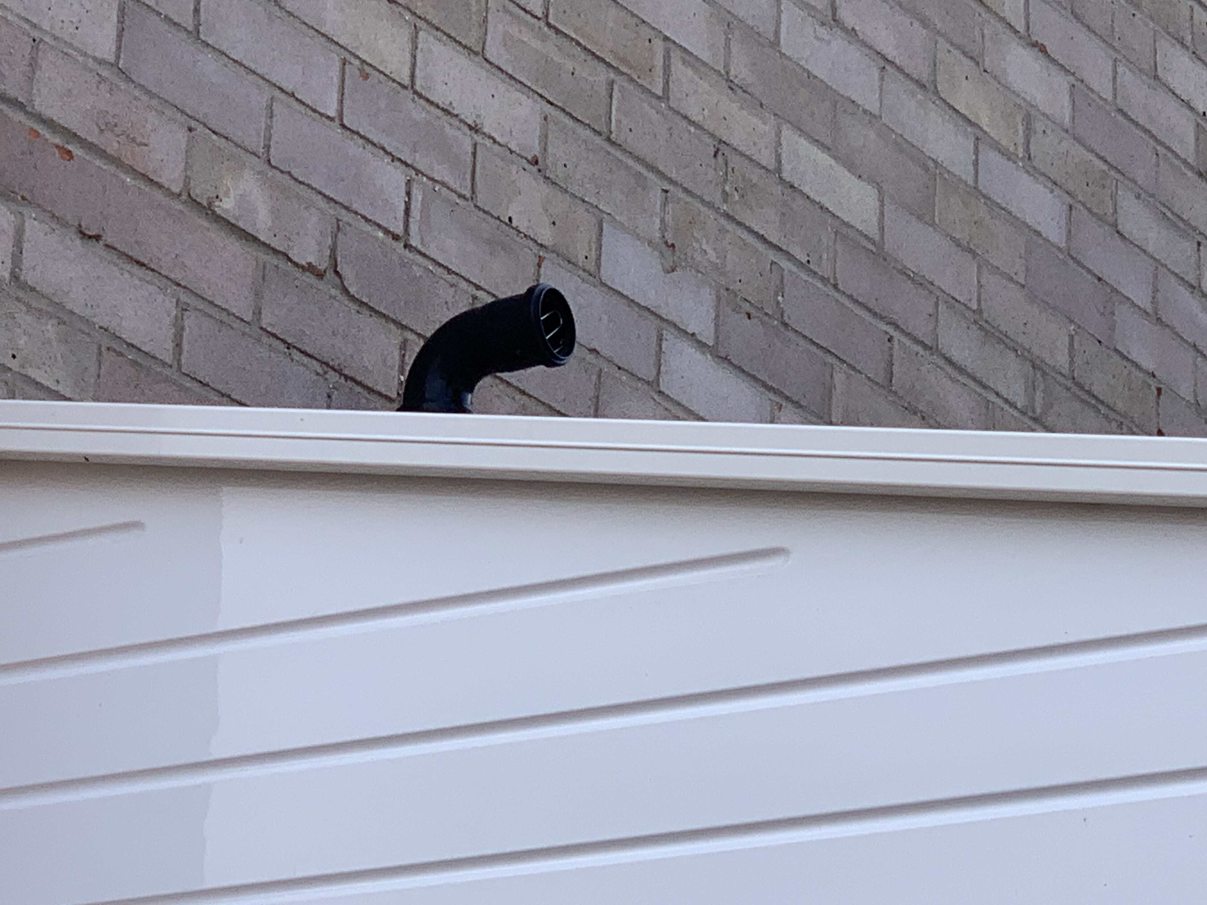

A boiler with big plumes of white smoke from the flue is running above condensing temperature. The white smoke is the water vapour escaping, with energy it carries. Efficiency drop 10 to 15%, compared to running as described above by @marshian. His flue gas will be invisible or almost.
Absolutely correct - most of the time it is impossible to tell from the flue gases that the boiler is running - When you can tell it's running is below 5 deg C OAT when a very thin plume is visible or when it's re-charging HW as the flow temp and modulation level is much higher (it starts on 50% modulation and ramps up to 100% before slowly ramping down to maintain a 7 deg delta between flow and return at whatever target flow temp I've set it to) - and after the first 10 mins of the HW cycle the return temp exceeds 55 deg C and the boiler is no longer in condensing mode and my boiler flue looks like all the other boiler flues around me - chucking out a white plume but that's mainly due to a small coil in the current HW tank meaning I can't heat HW to target temp without leaving the condensing mode.

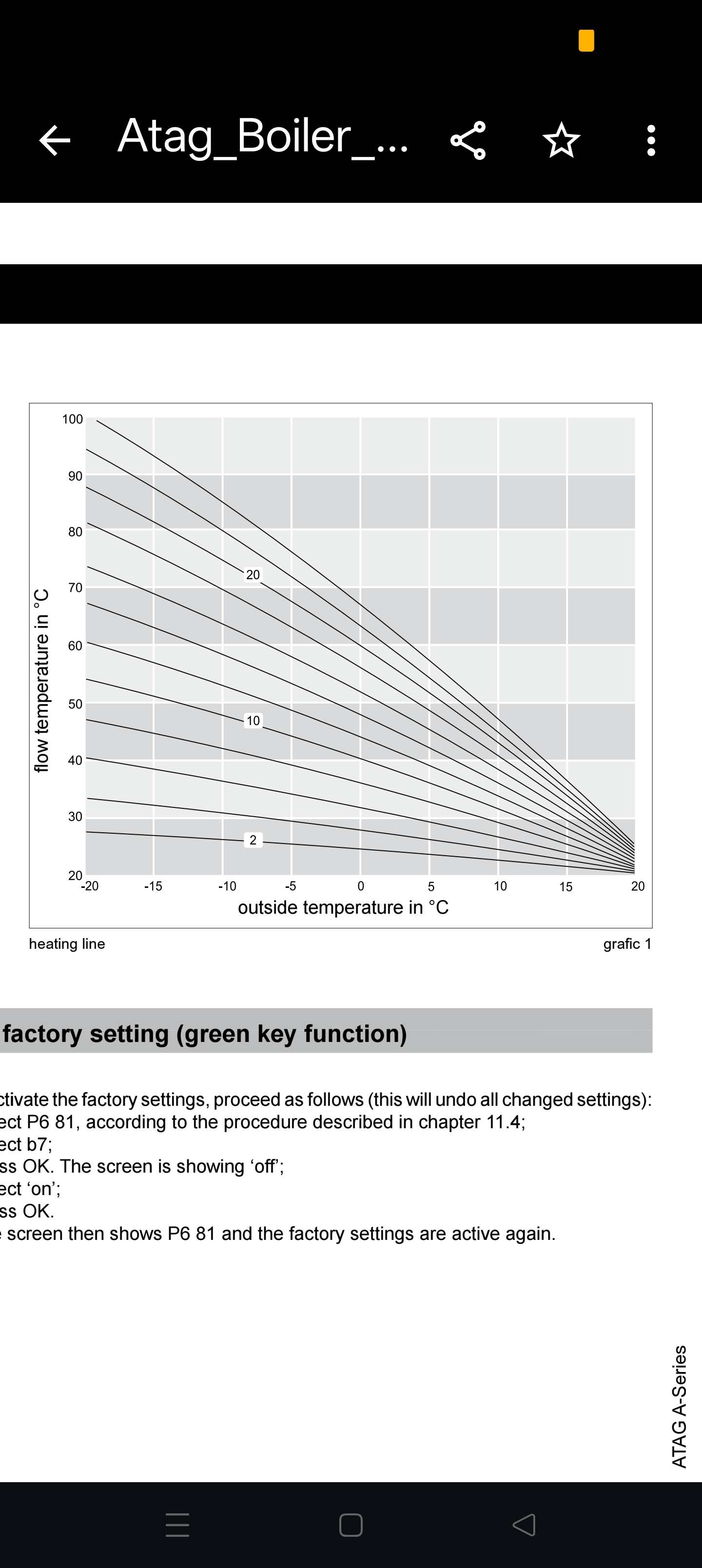

Here is an copy of the weather compensation curves for our Atag boiler, can be run as low as 20 degs.

Temp of the boiler can be set from 20 Deg C to 80 Deg C in non weather compensated mode
In weather compensated mode the Curve sets the flow temp and that will be between 20 deg and 80 deg

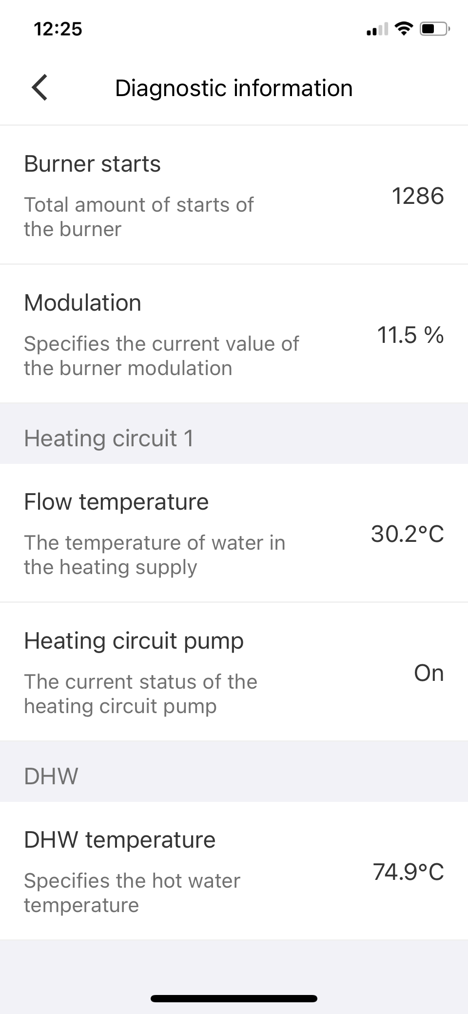

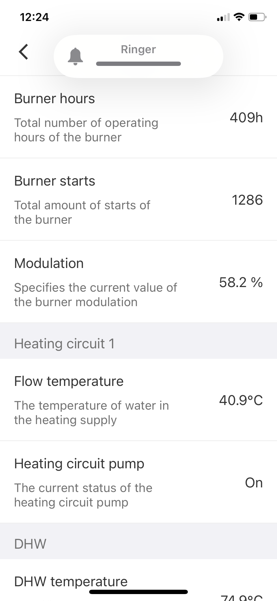

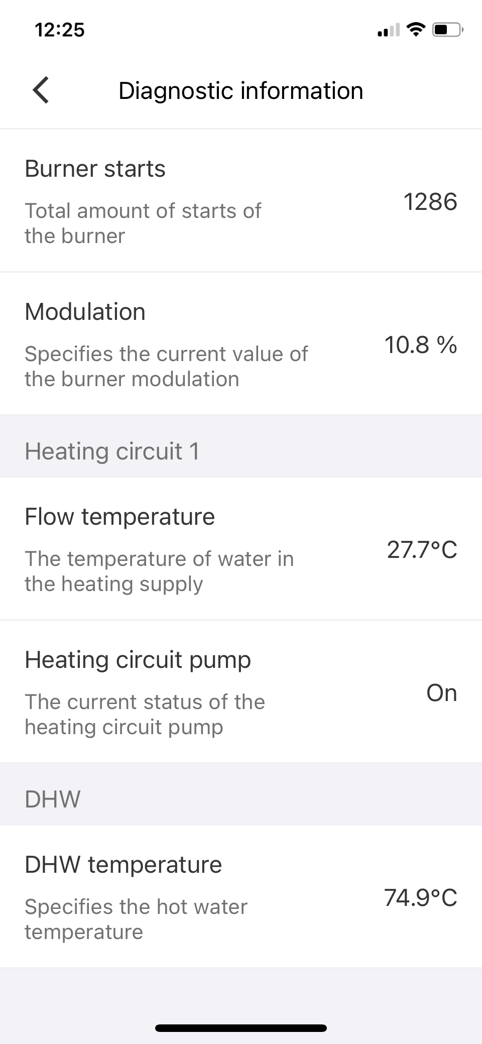

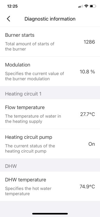

just by way of illustration have a sequence of screenshots on fire up
initial fire - boiler modulation is 58.2 % (58.2 % = ~12 kW)
flow temp is 40.9 Deg C

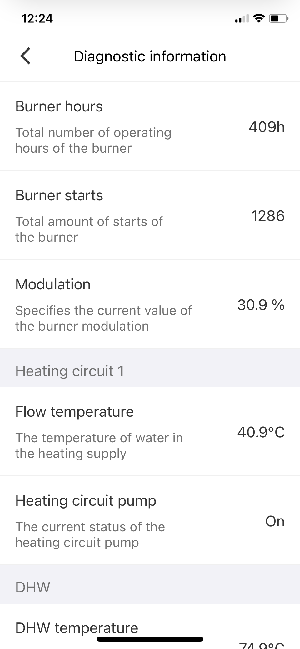

30 secs later
modulation has dropped to 30.9 % = ~8 kW
flow temp hasn’t dropped yet (due to initial heat up in HEX)
1 min later
modulation has dropped to 11.5 % (so ~5kW)
flow temp is dropping rapidly to 30 Deg C
2 mins after start up
Modulation is at min 10.8 % (so ~4 kW)
flow temp stabilised at 27.7 deg C
It’s 14 deg C outside on North side of the house where the OAT is taken so the boiler will do a burn of around 8 mins before shutting down for around 60 mins
Point to note - the boiler isn’t heating the house - it’s just replacing the heat that is being lost - all rooms are at or very close to target temp.
fires per day are around 15 right now
The burn and coast process is the same in shoulder season as it is in depths of winter (the only change is to the time the boiler runs for)
at -5 outside last winter the boiler was running for 55 mins followed by a 5-10 min coast
fires per day were 22 - 25
probably very similar cycles to an ASHP would operate in this house
