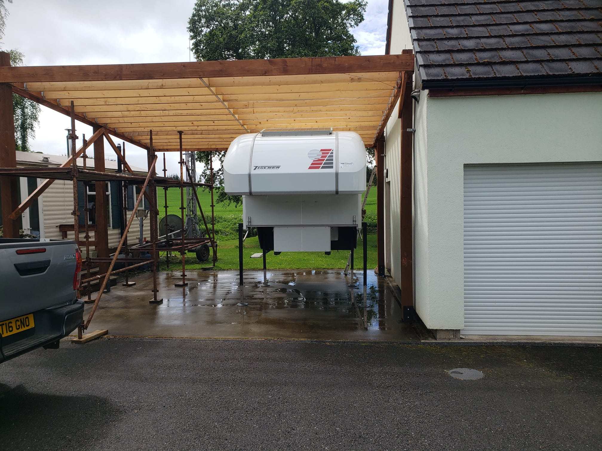

Back to the car port.  The final "test" today, demount the camper under the car port.  This involves jacking it up on it's legs clear of the truck then driving the truck away, this lifts it higher than in normal use and I had to be sure I had built it high enough to allow this.  And yes I have.
S next job, start looking at roof coverings.  It measures 602cm wide and 584 cm front to back.  Suggestions welcome.

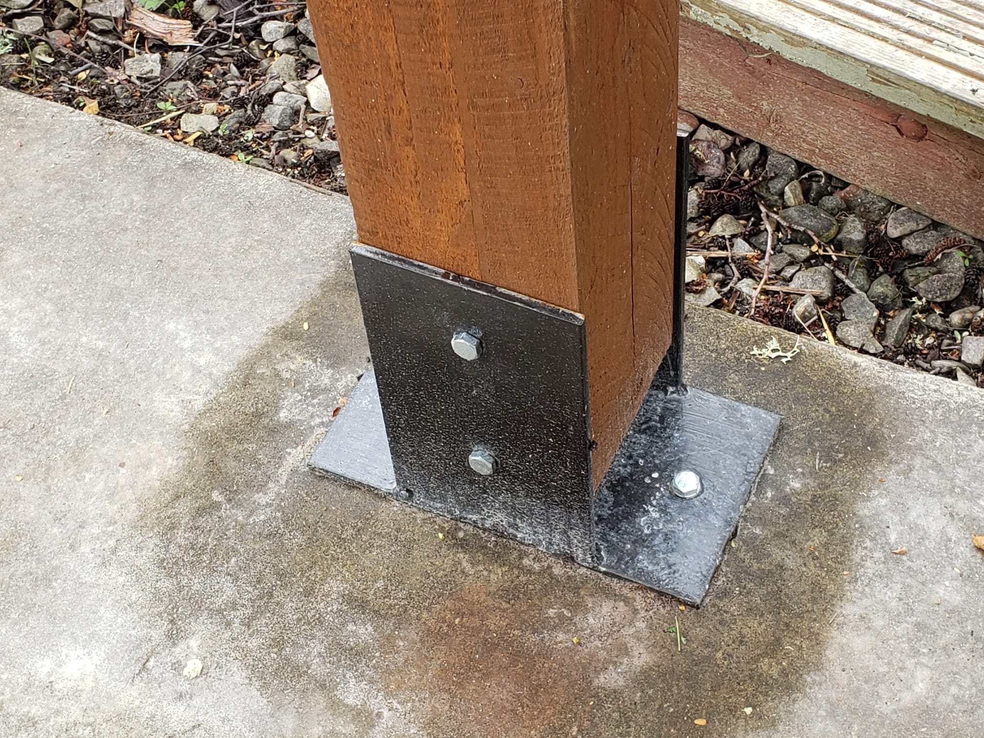

The posts are each fixed to the ground with two M10 rawl bolts into the concrete base, and the garage side additionally bracketed to the garage wall.  I can't see what more I can do to hold it down.
The bottom of each post sits in a bracket like this, bolted down into the concrete.

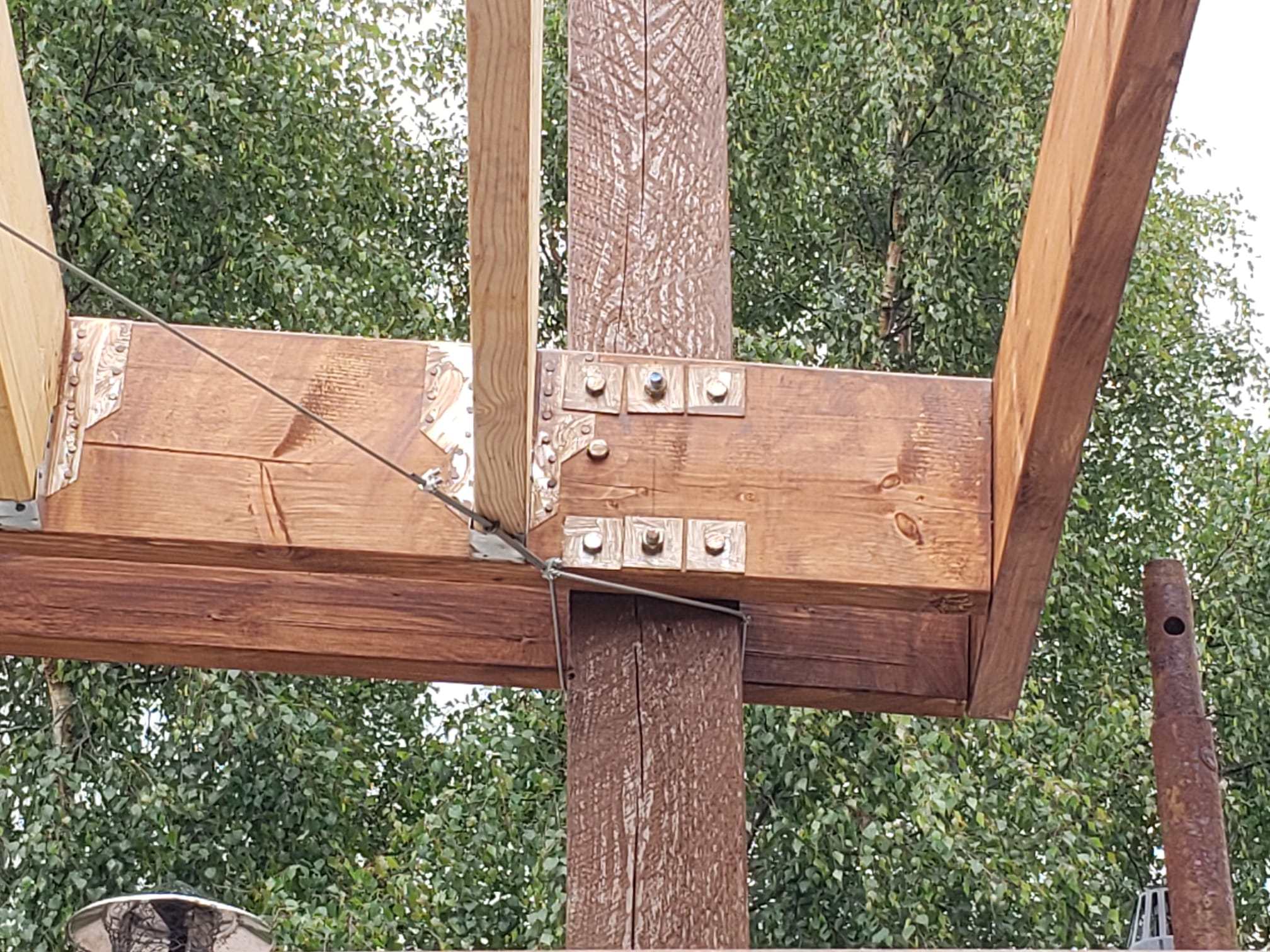

And at the top, each post attaches to the structure with 4 coach screws through into the post, and then two M12 threaded rods drilled right through with a nut and big washer each side.

Now I know the height is okay the tops of the posts will now be cut off.

And after another long break, it is finished.  I had been too busy doing things and going places to order the roofing until now.
I ended up ordering it from Steadmans, part of the SIG group.  Their quote was £300 cheaper than Plantex with the bonus they did the facings in long lengths where Plantex only do them in 3 metre lengths which would have meant a join.  The roof panels were delivered last Wednesday and today me and a joiner friend fitted them, which took us about 5 hours in total.
WhatsAppImage2026-09-26at4_37.25PM(1).thumb.jpeg.e0bc3681e755712c1c422f5b7857d369.jpeg
To lift them up there, we wheeled the mobile scaffold in the pictures out onto the grass, on 2 scaffold boards so stop it sinking into the soft ground, and used that as a staging post, lift them onto that, then both up onto the scaffold for the second lift.  It was actually easier than I expected it to be.
Tip for anyone doing this sort of job.  While the suppliers are happy to make the roofing sheets to any length you want, they only seem to supply them in "1 metre" width.  Great I thought, my car port is exactly 6 metres wide, I need 6 sheets.
Actually the sheets came 105cm wide.  There is a 5cm overlap.  So while it is true each sheet adds 1 metre to the width of the roof, with 6 sheets there are only 5 joints, so the finished width of 6 sheets of roofing is 605cm.  That is 5cm wider than my car port frame.
Quick thinking, by cutting a small piece off the top and bottom corner of the first sheet to clear round the garage roof tile overhang, that end of the roof ended up coming closer to the garage wall than originally planned, leaving the other end finishing mm perfect at the end of the framing.
There was also a few sheets of "spare" roof sheets used as packing and protection.  I am now scheming what I can use them for.

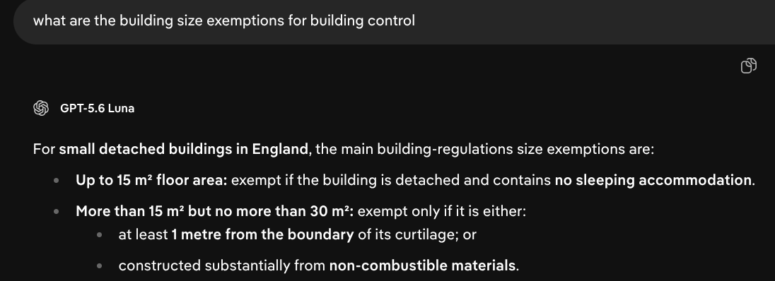

Do you have to have regs or a warrant for that? What's the total size 6m wide by how long? What size timbers did you use?
Im thinking of extending a garage from 5m wide to 6m and it's a bit of a can of worms. Think I might need to involve an SE. while it will only be 30m2 or just under I think if it joins a house it has to have b.regs in England?

For internal floor space up to 30m2, no building control required in England. Don't tell my friends about my uncalibrated tape measure.
Edited by BotusBuild
I've heard that before, but not been able to find the document. Do you have a link you could share?
Or use the exemption in Part 7 ....
CLASS 7
Extensions
The extension of a building by the addition at ground level of—
(a)a conservatory, porch, covered yard or covered way; or
(b)a carport open on at least two sides;
where the floor area of that extension does not exceed 30m2
