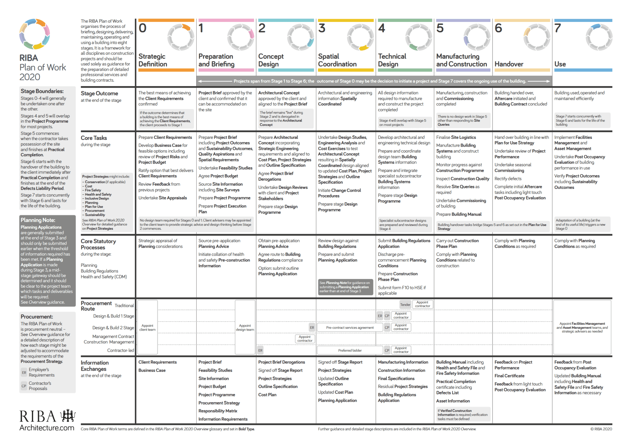

This is pretty standard. If you haven't retained the Architect through Stages 5 + 6, and he hasn't supervised the build, then you can't expect him to sign a document and put his PII on the line.
You only need building control to sign it off
You don’t need your builder to do anything
You certainly don’t need your Architect to sign it off
Speak to building control

Architect’s don’t supervise. They inspect. Builder’s supervise. Just saying.

Isn't this to do with the new changes related to building safety where you need the Principle Designer to sign off on the design and the Principal Contractor to sign off that the building has been built to the design?
In which case it shouldn't matter that the architect wasn't involved beyond the design stage?
As others have said they have recently got sign off without this but it may depend on when construction started? Not sure of the date off hand but vaguely recall late 2024.

Did your planning (note small 'p') include designating duty-holders under the Bldg Regs and Building Safety Act? There should have, AFAIK, been a Principal Designer at the outset and if, at any stage that person withdrew, there should be a trail stating to whom the PD role has been passed. That ('legacy') person is the one to sign off, and the person taking that role has to be able to prove that they have the required experience and competences.
I was under the impression that for low risk buildings the Principal Designer role was only about the design phase, not build phase. I quickly googled and this came up which seems to confirm but I may be missing something:
https://www.ribaj.com/intelligence/navigating-the-role-of-principal-designer-building-safety-act
From that article it suggests that I was wrong to say 2024 above, in which case I'm not sure how I square it with others here saying they didn't need these details on recent projects.
