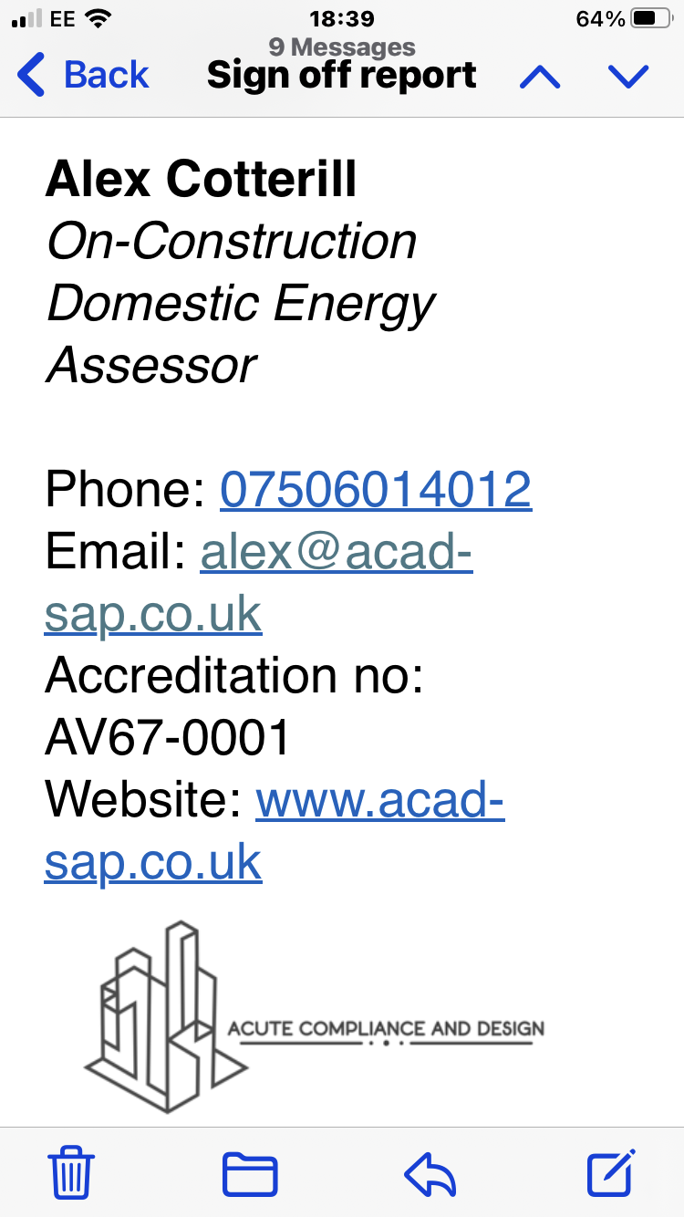

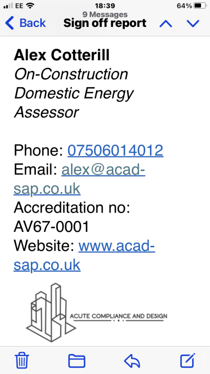

Absolutely
plus 1
The ones we’ve used are online  no photos are required
Call tomorrow Done by Friday image.thumb.png.2b1b1166d68d19f6dd5263a36d732df7.png
