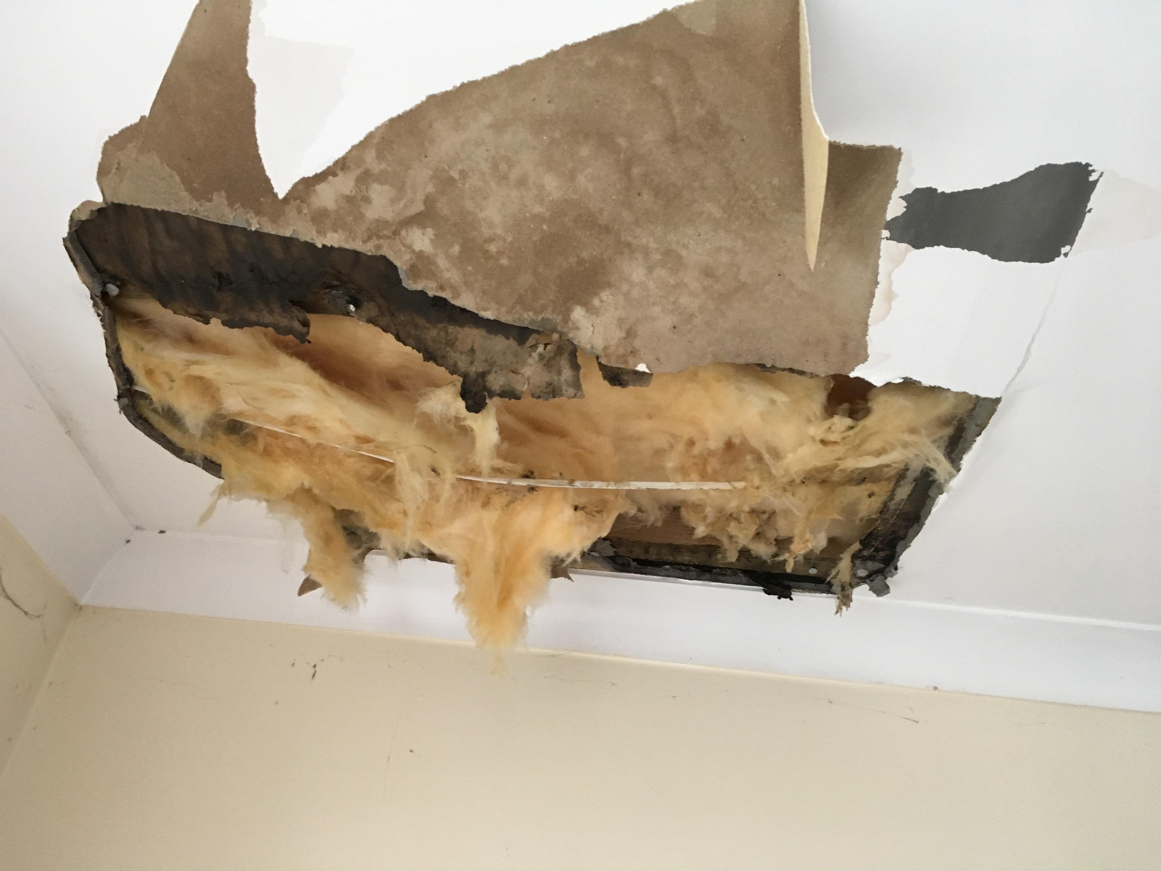

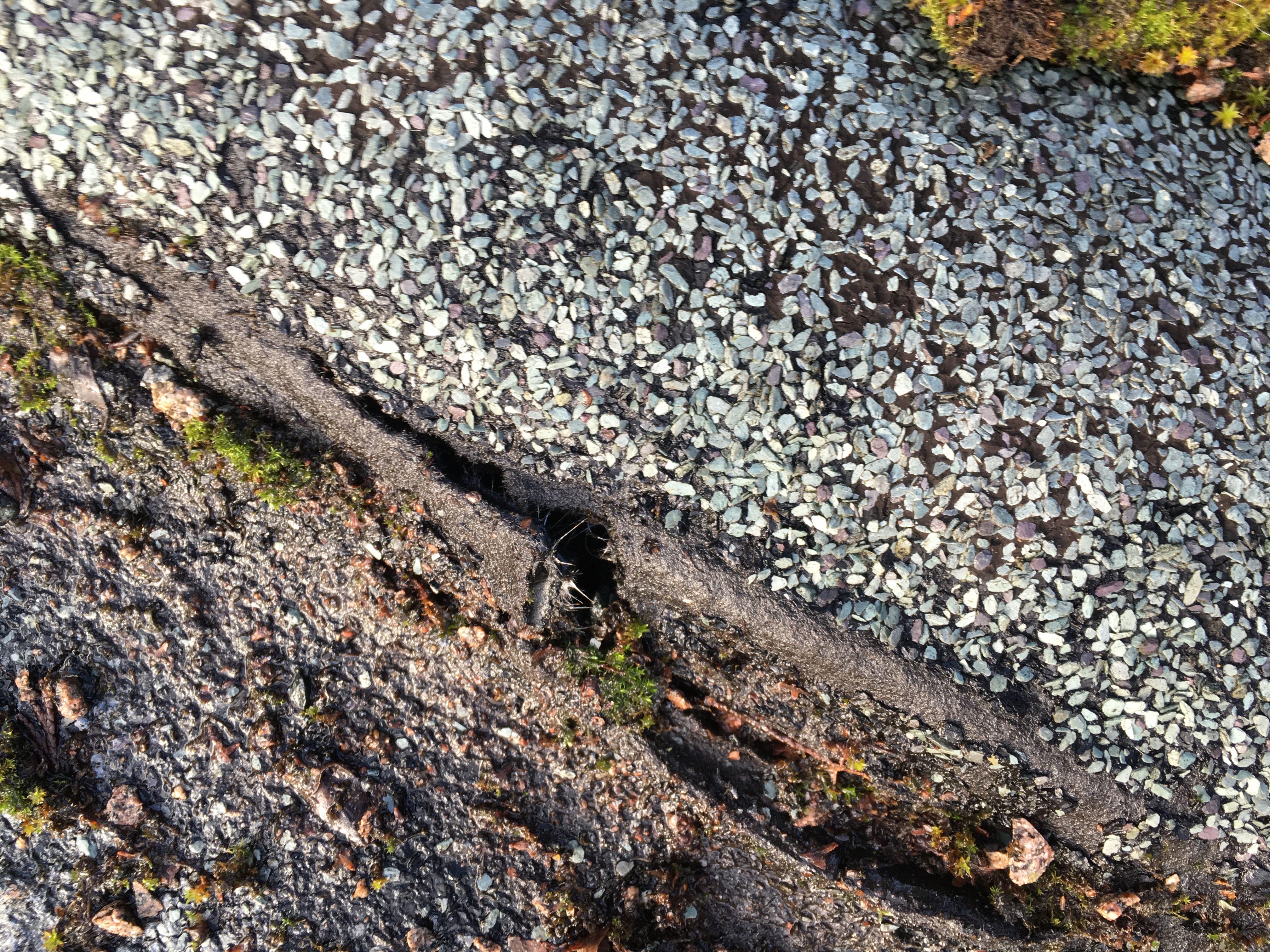

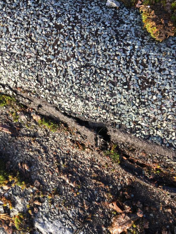

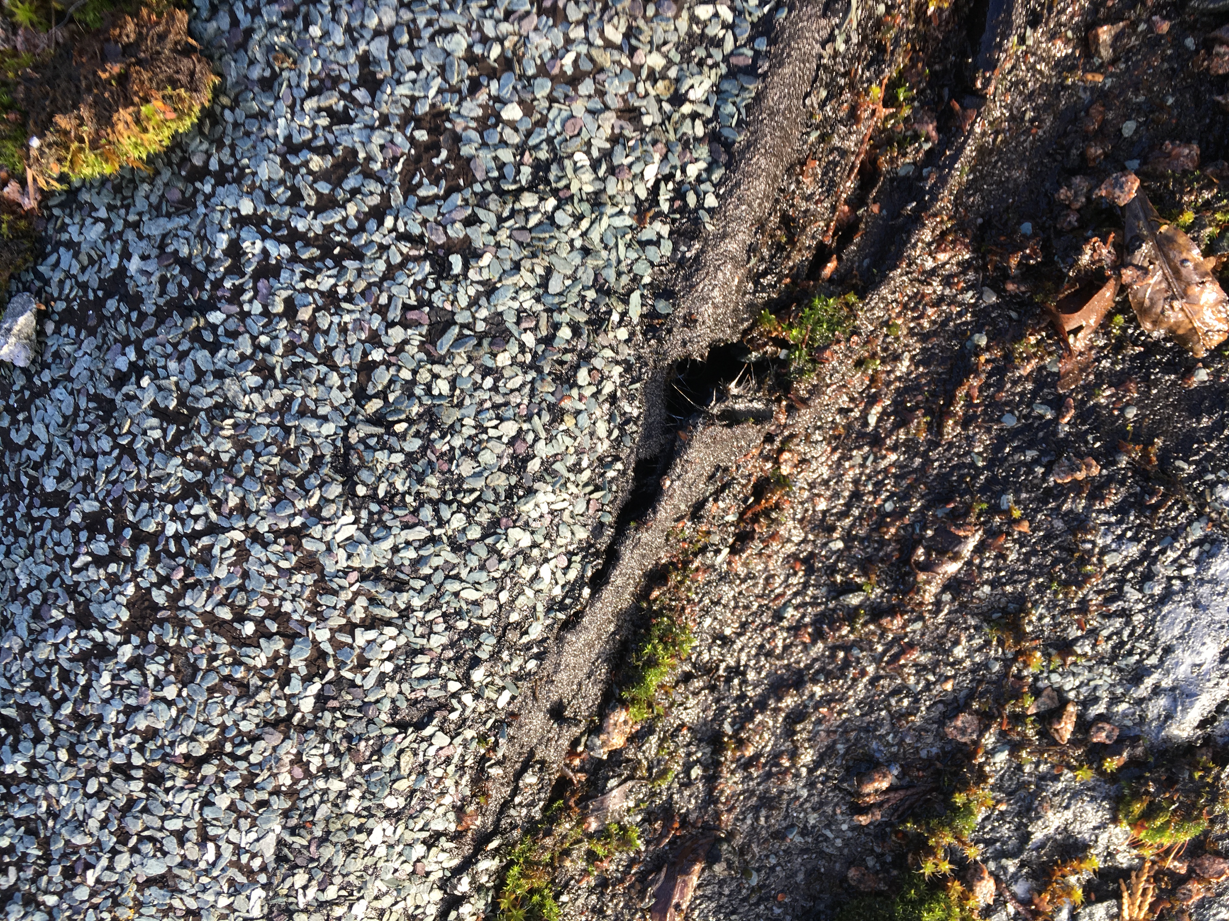

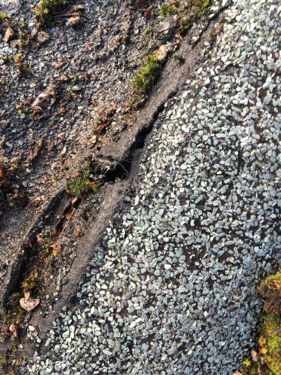

Jml Posted January 7, 2018 Posted January 7, 2018 Been away for a few weeks over christmas. Came back saw we had few drops of damp above dining room table and table was damp. Today, few minutes ago, ceiling collapsed (see pic). Flat roof above is due to be replaced when we do our extension. Is there a quick fix to stop water getting in? What about expanding foam along crack, which joins two sctions of the flat roof ( see pic.) or any other suggestions welcomed, especially before it starts to rain again!
Onoff Posted January 7, 2018 Posted January 7, 2018 (edited) Get a trowel on roof repair compound. Wickes do a load of them. Like a thick mastic. Careful as not all can be applied to a damp/wet surface so read the tin. Yard broom the area of all the loose crap then trowel / smear the stuff on. It does work but is a stop gap. I feel your pain. I've two flat roof dormers that are disintegrating. Spent a fortune on brush on watetproofing compounds like Flexacryl but it only buys a bit of time. The brush on acrylic type is different from the trowel on compound which is bitumen based. I found the top layer of felt butted together rather than lapped! I've resorted to this at the moment: Edited January 7, 2018 by Onoff
Onoff Posted January 7, 2018 Posted January 7, 2018 (edited) I went from this: To filling the edge splits with compound and localised painting over that and the old felt: To painting a bit of the roof: Then a bit more, then the whole roof even buying a 20kg drum. (I used Cromapol last time). Probably done £500 over a few years. And it still leaks. Oddly, my leaks are confined generally to the edges (touch wood). It's a 3/4" plywood deck under mine. I reckon OSB would have long since fallen through. This and the mirror image other side might have to be my next project but I want to sort the roof slope (raise), insulate the dormers better at the same time and maybe do fibreglass or EPDM. (Quite fancy a go at how @Barney12 did his hidden gutters). £££ & time! Edited January 7, 2018 by Onoff 1
Jml Posted January 7, 2018 Author Posted January 7, 2018 Many thanks for the quick response, roofs look much like ours, ours look in worse state though! Have made emergency run to nearby toolstation and bought some stixall which have appliled liberally over obvious cracks. Hopefully have found correct crack and will hold if rains tonight, otherwise will have waterfall in dining room! Will look at your suggestion later today, pretty damp up there so will check instructions carefully, many thanks for that tip. Our flat roofs desperately need replaced, usually leak through light socket from internal drain in ceiling, which is cleared by hosing drains. This is much worse though, not the most attractive ceiling feature!
ToughButterCup Posted January 7, 2018 Posted January 7, 2018 +1 to @Onoff's advice. The only thing I'd add is use a blower if you can to clean off the roof: a broom takes ages, and will never be as thorough. As luck would have it, my repair lasted a few years - long enough for me to forget I had repaired it. But you are right, it needs doing thoroughly.
Onoff Posted January 7, 2018 Posted January 7, 2018 (edited) If you've "filled the crevasse" then ideally you need to put a waterproof layer over that and the adjacent felt. The acrylic ones I think can generally be applied to a wet substrate but are more expensive than the bitumen based ones. If doing a large area I look on the tin as to the square metre coverage and pour x litres dead centre of each square metre. Then use a cheap, soft bristle broom. Much quicker. Keep a litre back for contingencies! The acrylic stuff is weird, goes on like hairy paint (that's the fibres) then settles out smooth. If it's still hairy you're spreading it too thin! Cromapol was the worst I've used for "spreadability" and working time compared to Flexacryl, Acrypol and Wickes own version. I would expect Evercryl from TS to be pretty good as most EverBuild products I've had are: https://www.toolstation.com/shop/p80073?table=no I'd use Cromapol again though purely on price. Shop around. You might want a 5kg / 5L tin as once you start sweeping and investigating things might look worse! Edited January 7, 2018 by Onoff
Onoff Posted January 7, 2018 Posted January 7, 2018 (edited) Rather than acrylic. This might be a cheap "overcoat", says in the tech data it can be applied to damp roofs: https://www.everbuild.co.uk/product/906-bitumen-roofing-emulsion/ Thinking it's CHEAP to throw 5L at the area: https://www.toolstation.com/shop/Roofing+%26+Drainage/d250/Roof+Compound+%26+Waterseals/sd2809 Edited January 7, 2018 by Onoff

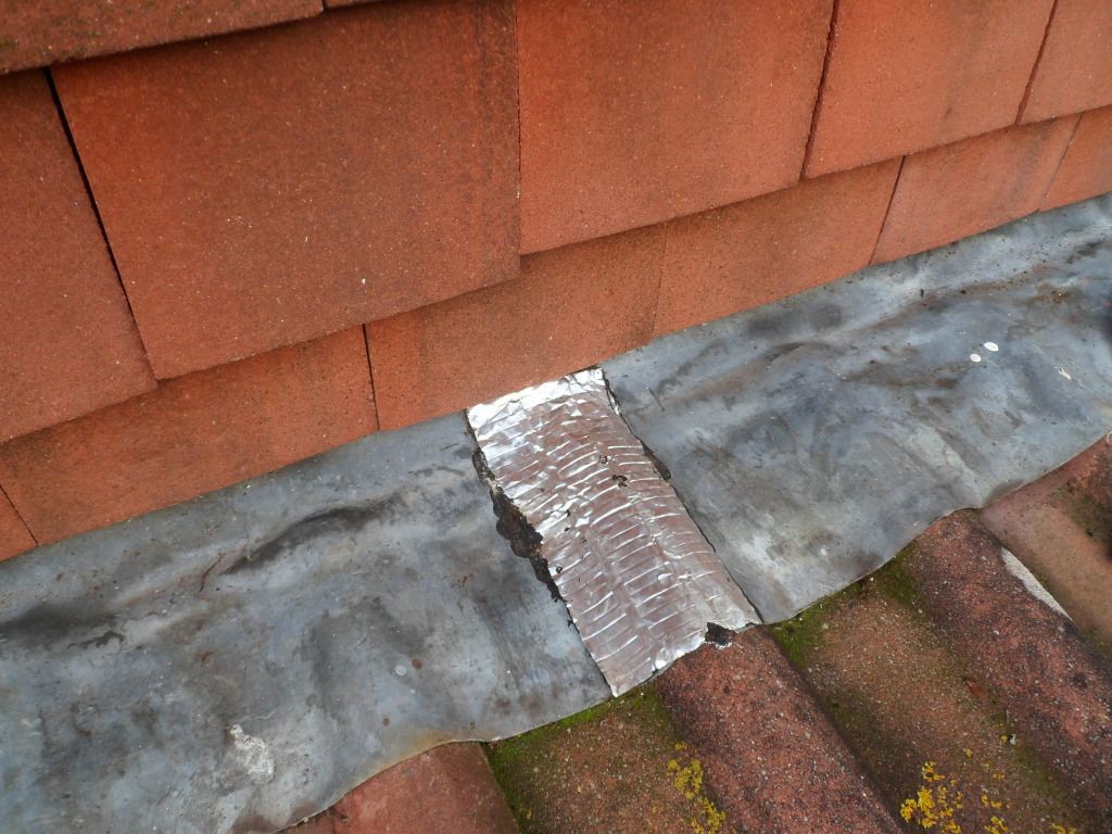

Onoff Posted January 23, 2018 Posted January 23, 2018 16 minutes ago, Simplysimon said: this is the beauty of torched on felt, burn it straight onto the board and it can only leak where punctured This stuff is good, torch on, embossed, aluminused "felt". Heat it up with a hot air gun. The backing goes molten and sticks like the proverbial:
