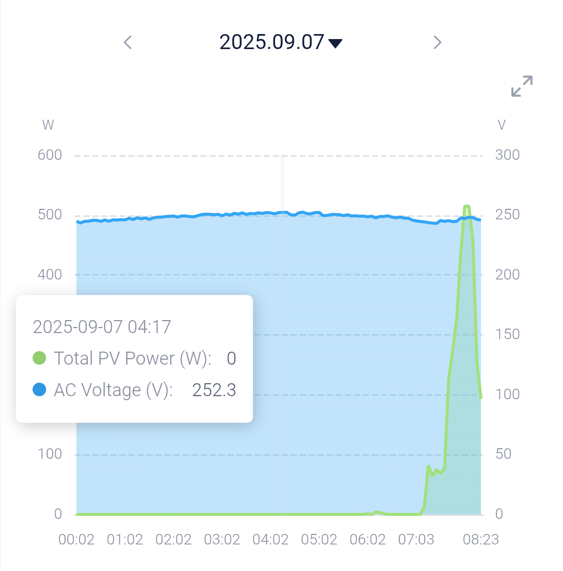

Beelbeebub Posted yesterday at 07:37 Author Posted yesterday at 07:37 So at midnight the grid voltage was 245v, but just after 4am (ie no PV generation in thr UK!) it peaked at 252.3
Dillsue Posted yesterday at 08:49 Posted yesterday at 08:49 If you look at the voltage line through the night you can see it rises as everyone gets into bed and the load reduces. Around 6am the voltage starts to drop as people wake up and the load increases. As your PV starts to generate around 7 you can see the voltage start to rise and then drop off as your generation drops off. You can see your PV pushing the house voltage up as it generates. The rest of the fluctuation will likely be the load from you/your neighbours being awake and using stuff??

Beelbeebub Posted yesterday at 12:59 Author Posted yesterday at 12:59 Thanks all. I'm just a little worried as my inverter shuts down if the voltage goes too high (253.6 for more than a certain time) - nothing dramatic, it just dumps me back to grid power - which is annoying as I then start consuming grid power even though my panels and battery are able to support me. Currently my export is set to 2kw limit pending the paperwork coming through for higher (waiting on installer). But the other day it threw some warnings and shut down briefly. It's nit the end of the world if I can't export much, though I do have a bunch to spare, but having the inverter shut down from time to time because the operators are running to close to the upper limit would be annoying.
