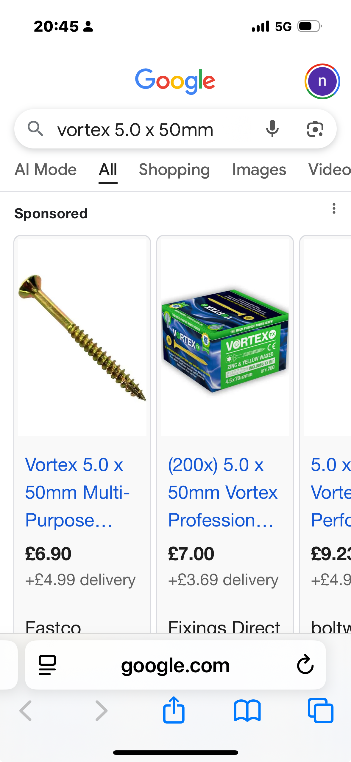

September 1, 20251 yr Glued and screwed every damn time! 100% defo need to be screwed down before the glue cures or the board won't ever pull back down, the glue will win that fight. I use 5.0 x 50mm screws which are partially threaded, to prevent 'jacking' that a fully threaded screw promotes. No need for a pilot, as the impact will send these through and out the other side with complete ease, plus you want the meat left intact to maximise on the purchase of the screw. If you're at all worried about weathering, then just fill each screw hole with a scraper and some cheap clear silicone, seriously unnecessary imho though unless this is going to be open to the elements all winter?

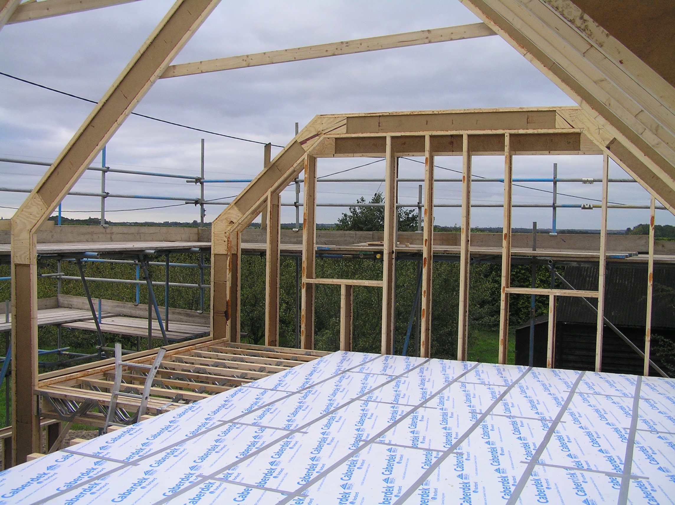

September 2, 20251 yr Our 22mm Caberdek flooring was glued and ring shanked nailed and only the T&G joins were taped. It was open to the elements for a couple of weeks and had puddles on it at times but when the covering was peeled off it was fine.
September 3, 20251 yr Author On 01/09/2025 at 21:42, Nickfromwales said: I use 5.0 x 50mm screws which are partially threaded, to prevent 'jacking' that a fully threaded screw promotes. No need for a pilot, as the impact will send these through and out the other side with complete ease, plus you want the meat left intact to maximise on the purchase of the screw. Can you elaborate on the partially threaded screw so i can look for some. Not quite understanding why it would jack up? I thought 22mm boards would require a small pilot to get the screw started easier as they're quite hard but ive never used my impact gun on them. Nothing worse than cursing screws that wont start and end up with the driver head slipping into the fingers 😂 I had been looking at 4.0 x 60mm. Ill be laying them next week if its dry then exposed for 4 to 6 weeks. They are 60 day boards, no peel off, anti slip and protected both sides. @LaChab After you posted the Egger fitting guide, i looked for a krono fastshield one and it also tells you to fix the board on all 4 corners and 2 in the middle so I've no idea why their tech support said to just glue only. @Gone West what tape did you use, any old duct tape? kb-fast-shield-fitting-guide-final.pdf

September 3, 20251 yr 56 minutes ago, ruggers said: How many srews did you put in a 2400 x 600 board? My guide shows 3 per sheet i thought it was 6. Ive 90 boards to lay. I do 5 of 5.0 x 50mm. One each end, about 50mm in, one in the middle, then one in each gap in between. Fully threaded screws can leave the deck boards and the joists separated, but still allow you to countersink the screw head in, thinking they’ve pulled together. If you look at the tip of the screw you’ll see a self cutting slot in the threads, which acts like a pilot cutter. A bit of weight behind the impact and these will shoot in with ease. I defo wouldn’t use 4.0 screws as they’re very skinny and can snap easily.

September 4, 20251 yr 13 hours ago, ruggers said: @Gone West what tape did you use, any old duct tape? The installers used what looked like standard duct tape. It did the job for a couple of weeks.
