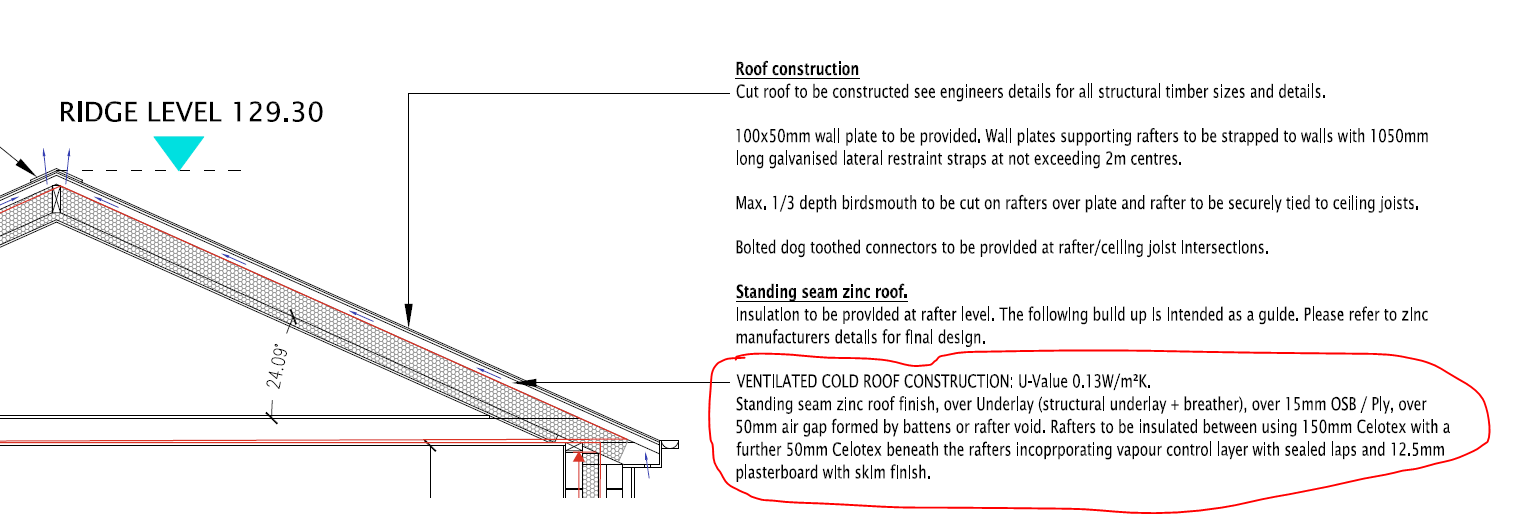

flanagaj Posted yesterday at 15:07 Posted yesterday at 15:07 (edited) Can anyone advise here. Our architect has specified 150mm celotex between the rafters and then 50mm between the rafters, finished off with VPL and a plasterboard skim finish. The interesting thing is that the roof space has a maximum height of 1.2m to the underside of the ridge and it's not a vaulted ceiling. So not sure why there is plasterboard and a skim finish. Any ideas as to what I can say to this. Yes, I am getting a U value of 0.12 W/m2K, but that is not actually achievable. Edited yesterday at 15:07 by flanagaj
BotusBuild Posted yesterday at 15:24 Posted yesterday at 15:24 16 minutes ago, flanagaj said: Our architect has specified 150mm celotex between the rafters and then 50mm between the rafters ?? Seems strange wording Care to clarify or change this? 🙂
JohnMo Posted yesterday at 15:27 Posted yesterday at 15:27 16 minutes ago, flanagaj said: 150mm celotex Good luck cutting that straight and square. I would fill with cellulose or mineral wool. A drawings may assist visualisation. Why not make it vaulted? 1
flanagaj Posted yesterday at 15:43 Author Posted yesterday at 15:43 17 minutes ago, BotusBuild said: ?? Seems strange wording Care to clarify or change this? 🙂 My mistake. 150mm celotex between the rafters and then 150mm below the rafters. eg
flanagaj Posted yesterday at 15:44 Author Posted yesterday at 15:44 16 minutes ago, JohnMo said: Good luck cutting that straight and square. I would fill with cellulose or mineral wool. A drawings may assist visualisation. Why not make it vaulted? MVHR pipes and I don't like vaulted ceilings. What is the U Value difference between mineral wool and PIR?

JohnMo Posted yesterday at 16:06 Posted yesterday at 16:06 Looking at the drawing, not sure how you will be able to assemble without loads of joints. The material between the rafters will be fine, just a pain cutting. The under drawn sheets you will never get them in big sheets in place there isn't the space. Needs a bit of a constructability review 1
BotusBuild Posted yesterday at 16:08 Posted yesterday at 16:08 20 minutes ago, flanagaj said: My mistake. 150mm celotex between the rafters and then 150mm below the rafters. eg If that's not a vaulted ceiling, as you say you dont want one, then it doesn't make sense to me. I would "move" the insulation/PB/skim part to the ceiling of the room (the red horizontal line). This would probably also address the fire risk mentioned above by @-rick-. Might be worth a chat with the architect if you can 1
-rick- Posted yesterday at 16:20 Posted yesterday at 16:20 (edited) You had another thread recently about trusses vs hand cut roof. If you aren't trying to vault the ceiling or preserve the option to build additional rooms in the roof then going for bog standard trusses is more attractive than otherwise. If planning a future expansion into the loft then I understand the placement of the insulation. If not, is it possible that the architect is working of old or incorrect assumptions? If so could be building in extra cost/complexity in other areas too. Edit: Also note your plans say zinc roof whereas another thread suggested youd choosen something else. Edited yesterday at 16:22 by -rick-

ADLIan Posted yesterday at 18:15 Posted yesterday at 18:15 If the roof space is not being used and there is a horizontal ceiling use mineral wool at horizontal ceiling level. Will save you £1000s!!!
Iceverge Posted yesterday at 19:37 Posted yesterday at 19:37 A 25 deg roof will be near impossible to insulate correctly to the eaves and airtighess will be a mare too. As @ADLIan says you could do a cold attic. You could still store stuff there. I would put an airtighess membrane and then a 20*70mm battened service cavity below the joists before a double layer of plasterboard. The MVHR could penetrate the membrane but you'd need to be diligent with taping the penetrations. Mineral wool or preferably cellulose over the top.
Iceverge Posted yesterday at 19:39 Posted yesterday at 19:39 If you do want a warm attic I would move the airtighess layer to above the rafters as a taped sheet of OSB that wrapped around the rafter ends and through the wall plate to the inner wall. Have you a plan view or your roof and a bigger cross section?
flanagaj Posted yesterday at 20:15 Author Posted yesterday at 20:15 36 minutes ago, Iceverge said: A 25 deg roof will be near impossible to insulate correctly to the eaves and airtighess will be a mare too. As @ADLIan says you could do a cold attic. You could still store stuff there. I would put an airtighess membrane and then a 20*70mm battened service cavity below the joists before a double layer of plasterboard. The MVHR could penetrate the membrane but you'd need to be diligent with taping the penetrations. Mineral wool or preferably cellulose over the top. That's not possible. I only have 2350mm of ceiling height as it is.
Mr Blobby Posted yesterday at 20:41 Posted yesterday at 20:41 (edited) 3 hours ago, flanagaj said: Fair point regarding the amount of time I actually have. Trusses will be much quicker and make it easier to install the insulation. It's the air tightness part I am struggling with. If you use wool, then that is obviously not going to perform as well as PIR which is taped along the rafters. We have a similar roof construction to your design. Cold roof, warm loft, standing seam on top. It works well giving us a warm space in the loft and plenty of space for the MVHR in a warm space, but is not the cheapest option. As others have said, use wool between the rafters and PIR under. No way you will cut the PIR to fit snugly. Fix and tape membrane under the PIR with battens. If you want to plasterbard then fix the plasterboard to the battens, thus keeping the membrane intact. We attached our cieling joists to a timber fastened to the wall under the joists so that we could run the airtight membrane behind it without being penetrated by joists. Like this: Frget about GSE inset panels on a standing seam roof. Use S5 clamps instread. And Standing seam is too nice for panels so install them at the back only. You will understand as soon as the roof is on. I'm assuming you have a timber on top of a steel ridge beam. Its not clear from your drawings. You need to keep the steel on the warm side, not in the middle of the insulation. Assuming you have gable ends then build the inner leaf lower than the outer so that you can pack some insulation between the top of the wall and the timber directly under the standing seam. We used sarking instead of ply or osb. More time and cost but the roofers loved it. In retrospect I would have rn the airtight membrane vertically instead of horizaontally. I think it would have been easier to install crease free. And better if the roofers had cut battens to install the membrane in sections but, for whtever reason, my roofers hate cutting battens. Edited yesterday at 20:41 by Mr Blobby
JohnMo Posted yesterday at 20:46 Posted yesterday at 20:46 By far the easiest is to put the insulation on top of the rafters, is that possible? 1

flanagaj Posted 15 hours ago Author Posted 15 hours ago 9 hours ago, Mr Blobby said: We have a similar roof construction to your design. Cold roof, warm loft, standing seam on top. It works well giving us a warm space in the loft and plenty of space for the MVHR in a warm space, but is not the cheapest option. As others have said, use wool between the rafters and PIR under. No way you will cut the PIR to fit snugly. Fix and tape membrane under the PIR with battens. If you want to plasterbard then fix the plasterboard to the battens, thus keeping the membrane intact. We attached our cieling joists to a timber fastened to the wall under the joists so that we could run the airtight membrane behind it without being penetrated by joists. Like this: Frget about GSE inset panels on a standing seam roof. Use S5 clamps instread. And Standing seam is too nice for panels so install them at the back only. You will understand as soon as the roof is on. I'm assuming you have a timber on top of a steel ridge beam. Its not clear from your drawings. You need to keep the steel on the warm side, not in the middle of the insulation. Assuming you have gable ends then build the inner leaf lower than the outer so that you can pack some insulation between the top of the wall and the timber directly under the standing seam. We used sarking instead of ply or osb. More time and cost but the roofers loved it. In retrospect I would have rn the airtight membrane vertically instead of horizaontally. I think it would have been easier to install crease free. And better if the roofers had cut battens to install the membrane in sections but, for whtever reason, my roofers hate cutting battens. Thanks for explaining the build up detail. as I am most likely going to go with trusses, I don't think I can use the same build up as you have. Point taken regarding the solar, but sadly, we have either a north facing roof or a south facing roof, so I think the decision is made on that one. I am sure it will grow on us using the clamps. I was hoping that we won't require a steel ridge beam. The technical architect hasn't made mention of it and I am still trying to find an SE who responds to my request for a quote.
flanagaj Posted 15 hours ago Author Posted 15 hours ago 9 hours ago, JohnMo said: By far the easiest is to put the insulation on top of the rafters, is that possible? Not without increasing the ridge height and I am reluctant to put in a change for that at this late stage.
Nickfromwales Posted 15 hours ago Posted 15 hours ago 52 minutes ago, flanagaj said: Not without increasing the ridge height and I am reluctant to put in a change for that at this late stage. If you’re overlooked that is a possible issue, if you’re not then a ‘tweak’ of the ridge height often goes unnoticed. If it’s < +200mm then I doubt anyone will care tbf.
