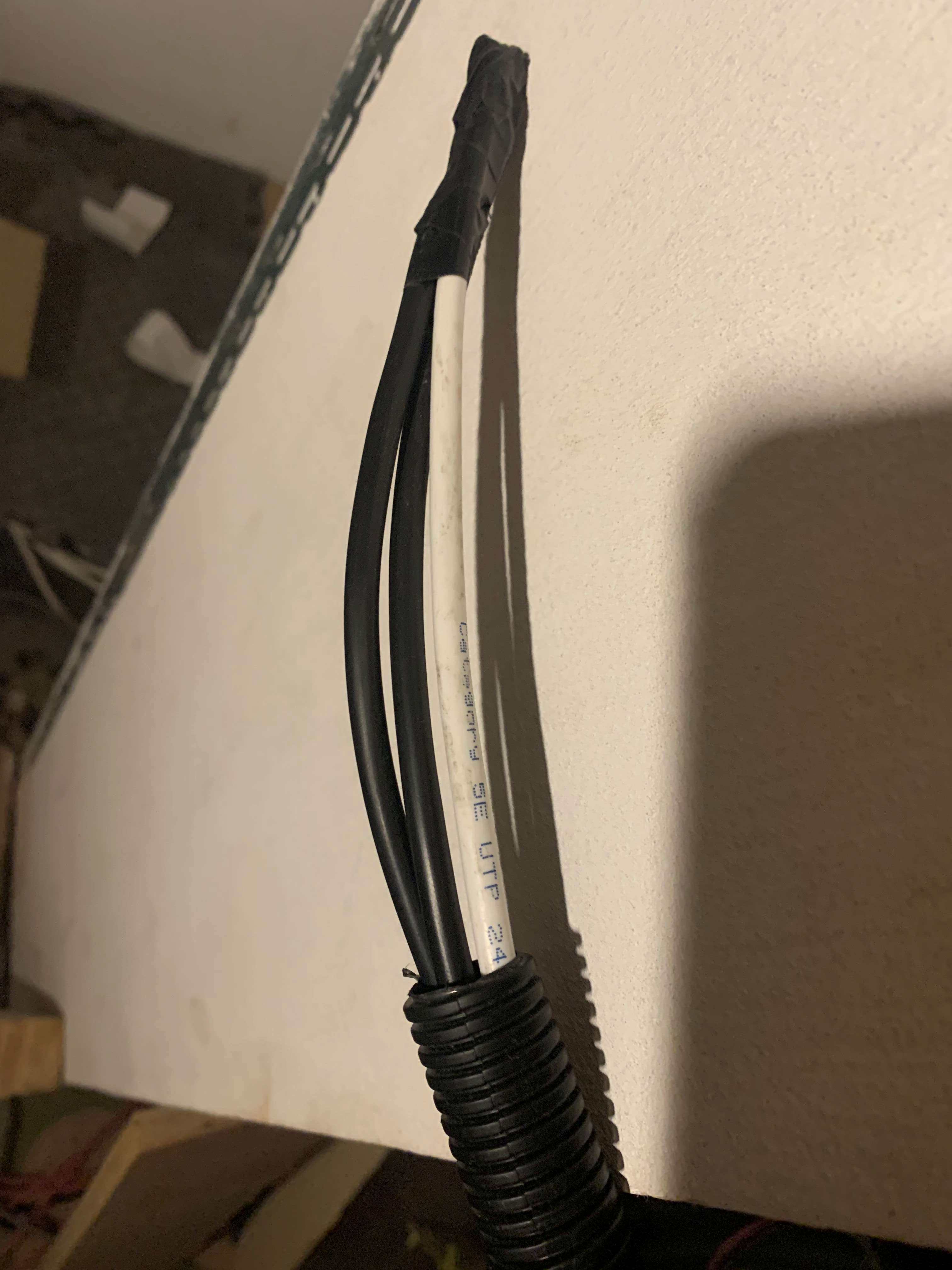

-rick- Posted September 1, 2025 Posted September 1, 2025 2 hours ago, Spinny said: if I tape up and silicone should I be aiming for a particular shape - I guess a shape wider than the rib width by 3 times perhaps ? Surprising they done sell some sort of rolling ball end to attach which would revolve as it is pushed around corners. (I claim that patent). Show us a photo of what you have? If I were doing it I would look to space each additional cable quite a way away from the the previous join. Bundling them all together will make for an inflexible section. Are you using stranded or solid core cable? 2

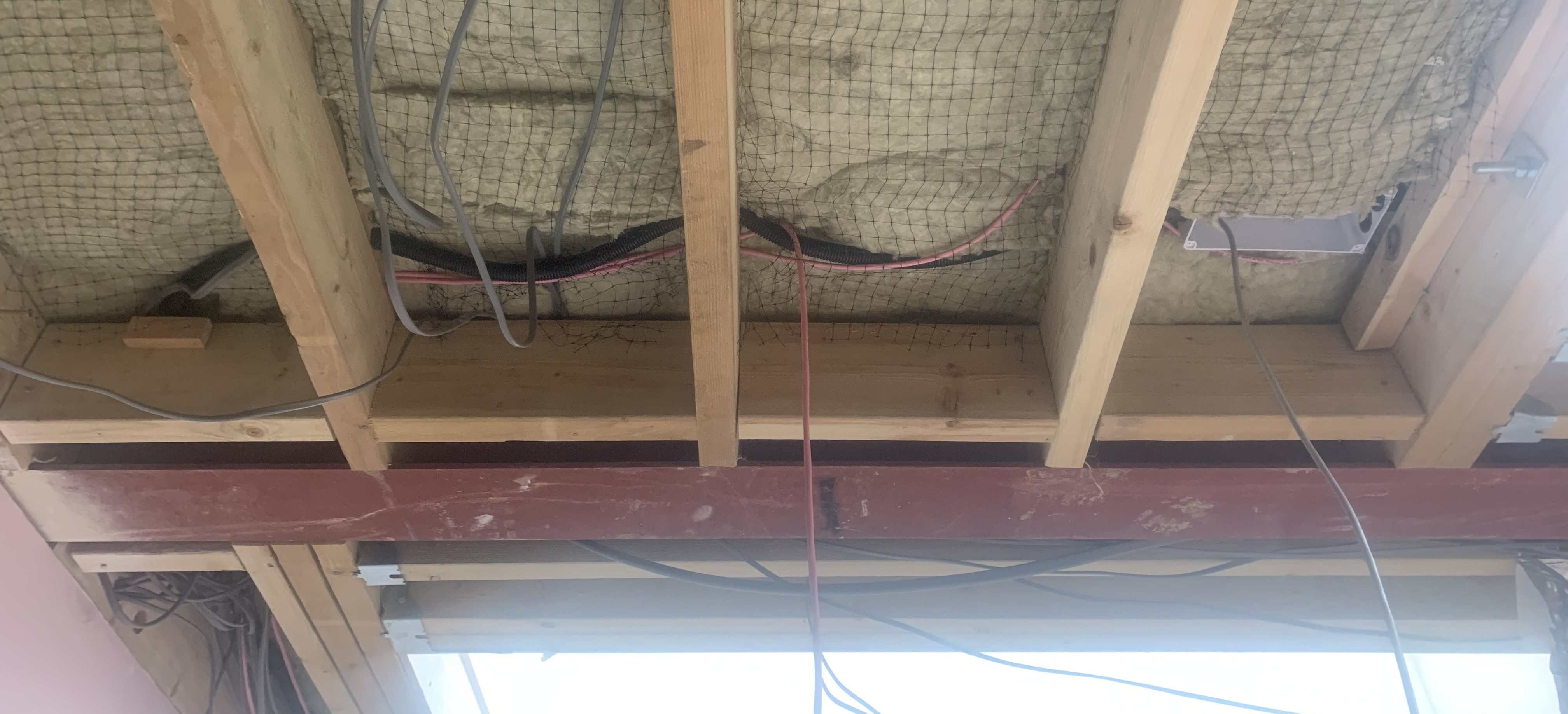

Spinny Posted September 1, 2025 Author Posted September 1, 2025 Here is a photo of 1 run, I have flexi conduit running to 3 roof lights with a box placed adjacent to the rooflight - as in this one you can see the box on the right. Sparky put the flexi in with a lan cable stuck through it. I am running 2 cables for each rooflight - both 4 core 0.75mm cables because I am going to put two LED strips into one plaster-in alu profile around each rooflight. 1 cob addressable 24V RGB and 1 cob addressable 24V CCT. (Yes strictly I only need 3 core cable, but a spare core seemed ok as a reserve). So ultimately I need 2 cables and a pull wire running through each 20mm black flexi conduit run. Really don't want to be pulling the ceiling down if a new cable has to be run to a rooflight. No doubt I can find a way to get the cables through in one way or another, especially as I have access to the conduit until it is boarded over. But it being tough to get through worries me for future fishing through. Worst conduit has 2 90 degree turns to make - two horizontally and then one vertically to escape into the electrical cupboard.
-rick- Posted September 1, 2025 Posted September 1, 2025 I meant show us a photo of the cable bundle you are trying to pull, especially the lead in (where you tape together cables). Are these cables sold or stranded? In any case, sounds like a lot to stuff down a 20mm conduit in the best conditions. Can you share the 4 core cable between the two strips. Vcc, Gnd, Sgl1, Sgl2? Obviously the Vcc/Gnd would have to take twice the current?
-rick- Posted September 1, 2025 Posted September 1, 2025 More thoughts: Can you tie the conduit to something straight to get rid of those bends at the joists? They really aren't helping. Really want the conduit to be very straight until it turns the corner. A Stranded CAT5 cable would be much easier to pull than that chunky CAT6. 2

andyscotland Posted September 1, 2025 Posted September 1, 2025 26 minutes ago, Spinny said: I am running 2 cables for each rooflight - both 4 core 0.75mm cables because I am going to put two LED strips into one plaster-in alu profile around each rooflight. 1 cob addressable 24V RGB and 1 cob addressable 24V CCT. (Yes strictly I only need 3 core cable, but a spare core seemed ok as a reserve). So ultimately I need 2 cables and a pull wire running through each 20mm black flexi conduit run. Really don't want to be pulling the ceiling down if a new cable has to be run to a rooflight. Plus the existing network cable? I agree with @-rick- that sounds quite a bit for 20mm with bends. It won't be helping if they're 4 core sheathed - you'll be losing space to the sheath and also that makes it more rigid around bends. If the whole run is in conduit between boxes you could use singles, starting each one staggered after the other as @-rick- said.

andyscotland Posted September 1, 2025 Posted September 1, 2025 1 hour ago, Spinny said: I will only use the led tapes one at a time. Either colour, or white, but the transformer, power switch and WLED controller will be in the electrical cupboard so two power leads do need to run to the rooflight. I could use one 6 core cable. But the 2 cables are around 5mm diameter so fit ok, the third white cable here is LAN and not needed, am going to replace it with something thinner as a pull wire. That does look relatively full to me. A 6 core cable will be even more rigid round bends I think. Also as @-rick- mentioned that does look like you're trying to pull them as one big lump, it will be much easier if you spread out the point where each one joins onto the one before so that you get as much of a taper as you can. The thinner cable will help to lead the following cable round the bends and so on. 1 hour ago, Spinny said: I am wondering whether 20mm smooth walled conduit would be better, but never used it before - saw a spring for bending it - how does that work - do you heat it up with a hairdryer then bend it with the spring ? Possibly, it will have fewer snag points on bends and obviously will sit dead straight in the sections where your flexi is dropping - but you can potentially solve those without swapping it all out. Also the smooth conduit might actually have more friction along the length (the cable is in contact with the wall all the way, unlike flexi where 50% is on a ridge and 50% over a valley) so might not end up much different. For bending you don't need a heat gun (and can easily over melt it that way), just insert spring, rub up and down the outside with a rag a bit to gently warm it a little, then bend. Bend it slightly over the angle you want then you can ease it back to the exact angle as you fix it into place. 1
