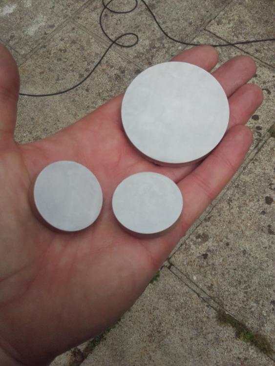

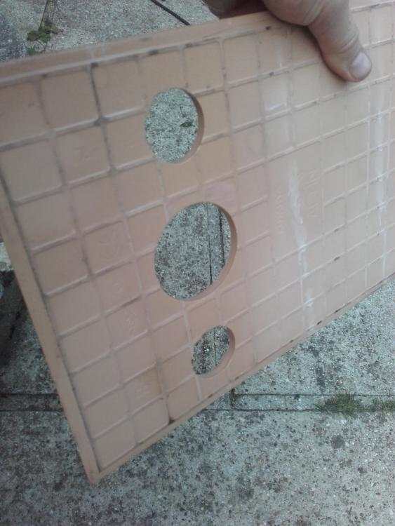

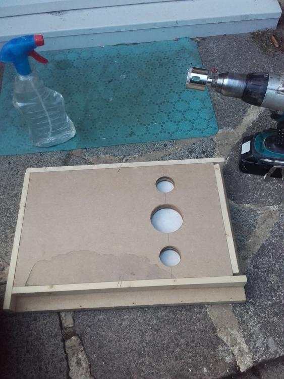

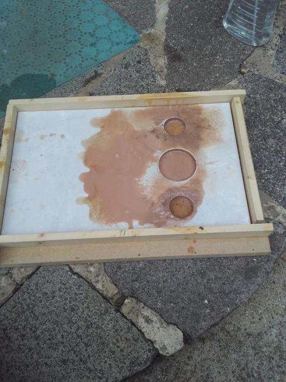

Onoff Posted August 31, 2025 Posted August 31, 2025 Use a guide. Lidl sometimes stock a set of drills including a vacuum type guide like the one below that you stick to the tiles. Did all my bathroom with a set of drills like this and just drilled bits of timber to make a guide

crispy_wafer Posted October 2, 2025 Posted October 2, 2025 33 minutes ago, Onoff said: I've made jig boxes before to hold tiles: Oh yes, I like this, genius.
